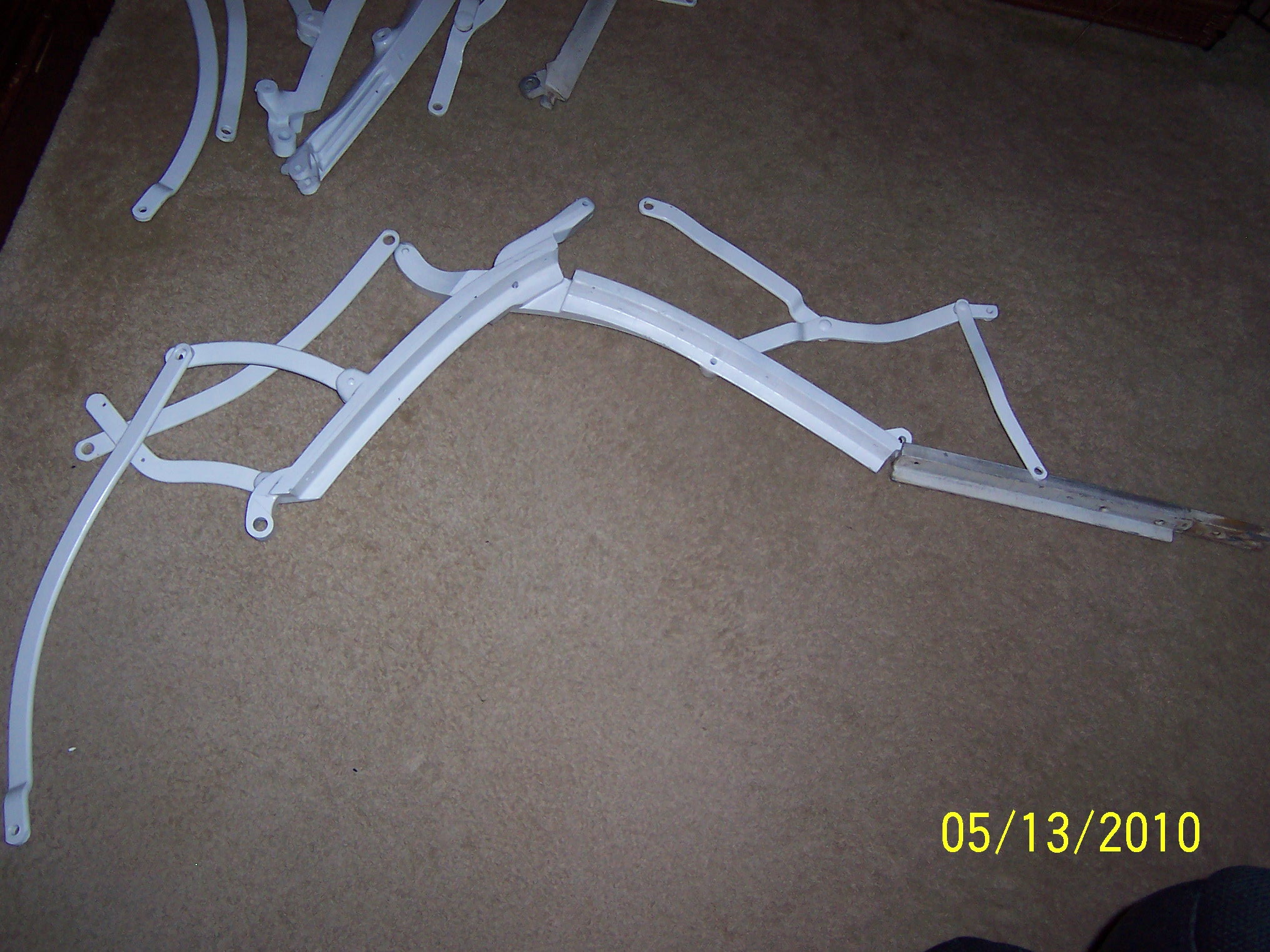

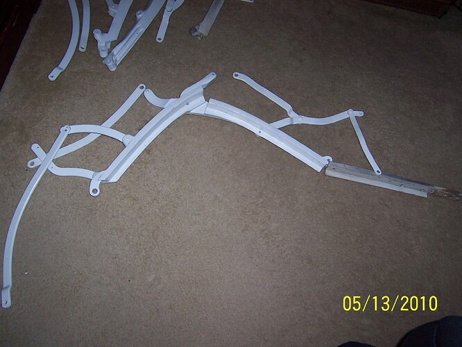

The other parts did tweak up a bit. So they will need to be straightened up in the correct plane. Was the top being lowered or raised when it bound up? Looks like it was going up to me…

the assembly (three bars riveted together, as John’s picture shows) is the same for Ply and Dod 1957, 58, 59.

Johnny, if you could do that you will make me very happy! And the top was going up indeed.

He will need to know precisely WHICH parts need to be made…(it is not absolutely clear to me from the photos what was damaged or broken.)

I received Matthew’s photos, and have a few boxes of spare convertible parts to look through.

Just to make sure we are talking about the right section, in the picture I posted with the assembly in a basket, it is the long part with the other two smaller irons attached to it, Right? :nerd:

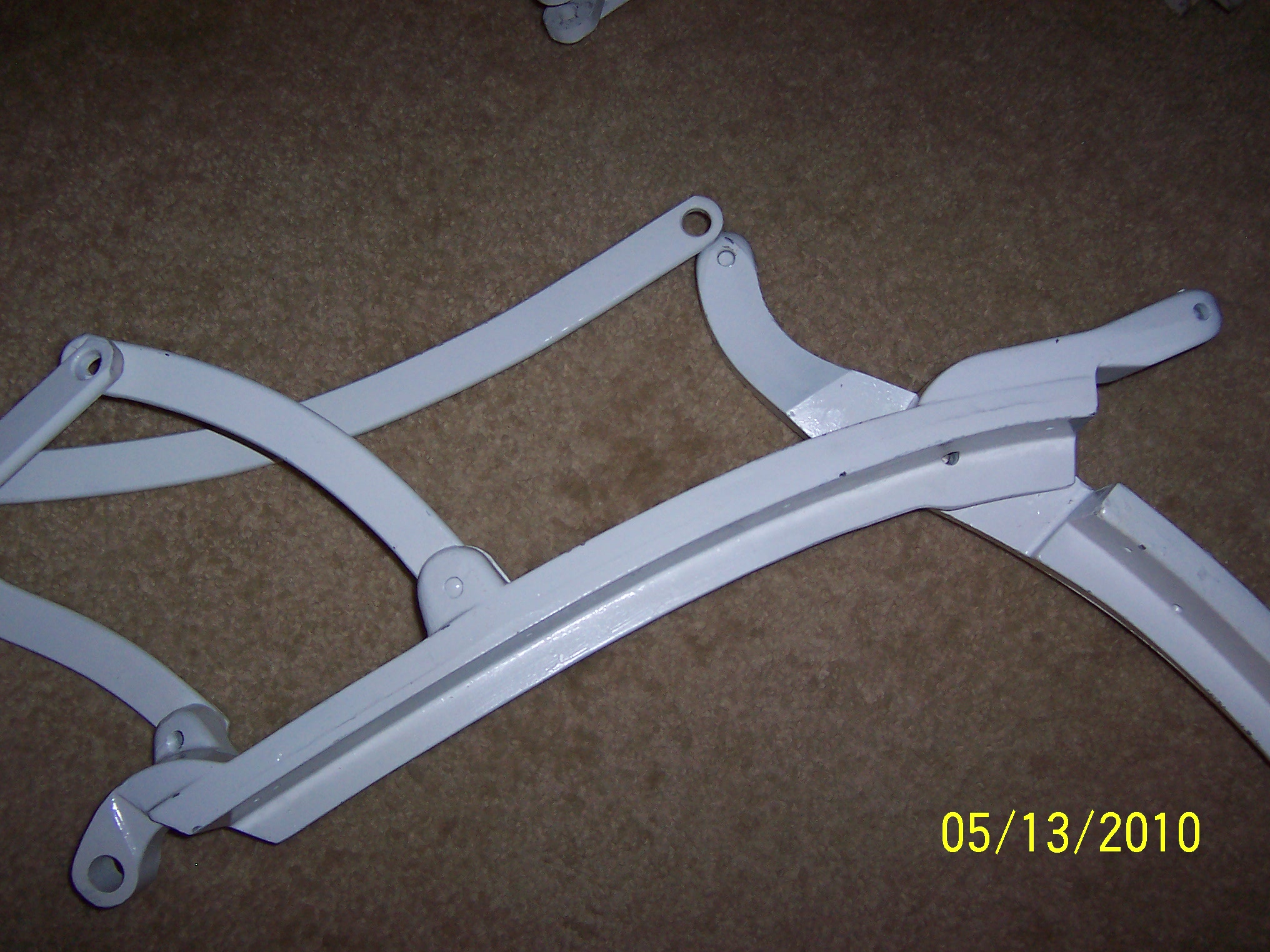

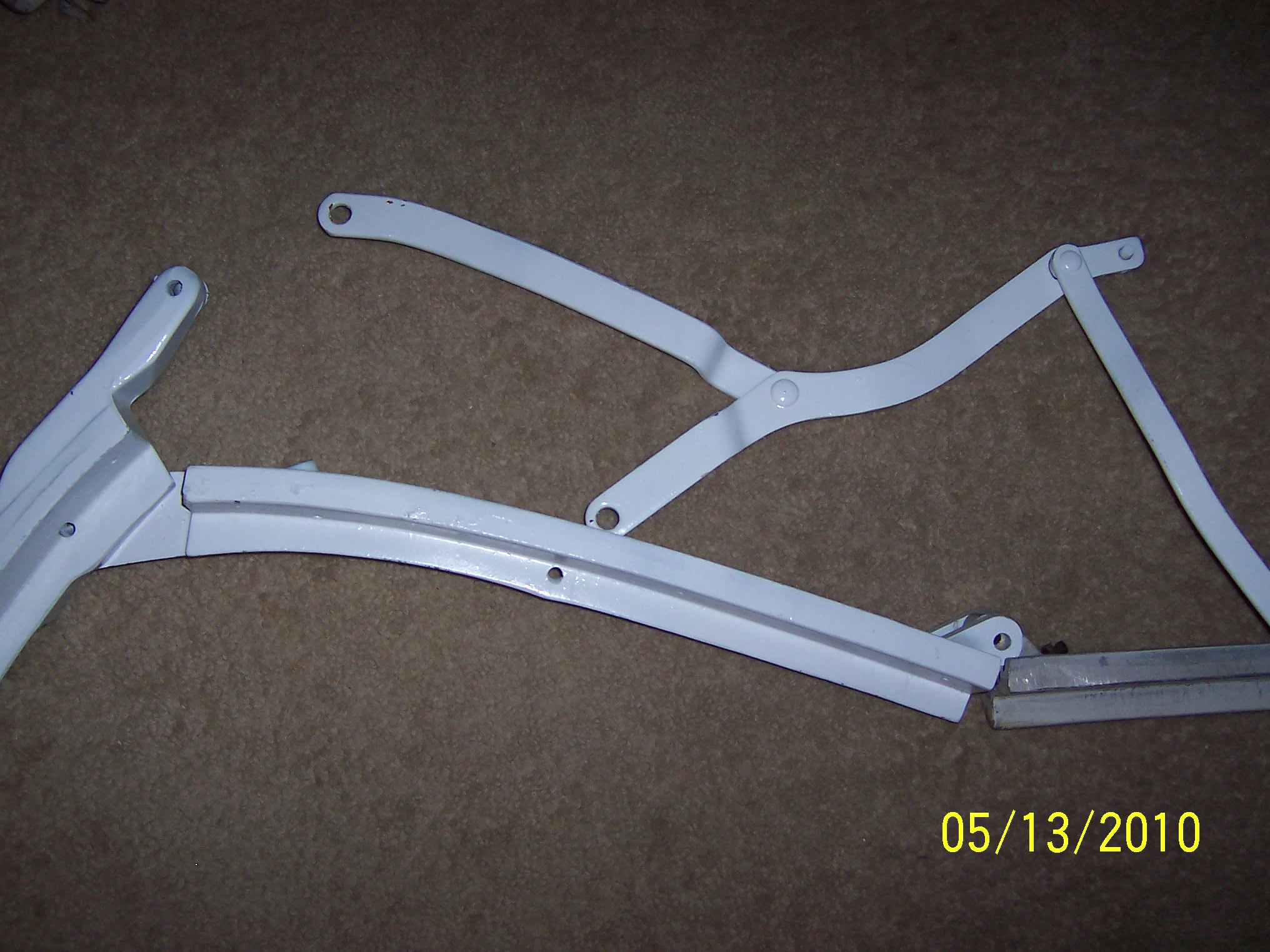

Of course you will need Matthew to tell you exactly which pieces need replacing; however, from the pics, it looks to be one broken piece and one severely bent piece.
Looks to me that if that one bent piece were straightened, it would break, thus I think they need at least TWO pieces.
Roger, you are proabably right on that one piece that is bent up so badly, It may have weakened it a bit. I will make paper templates of the pieces individually. I don’t want to mess up with my rivited sections but can work around the rivit.
Lets see of young Matthew can tell me what parts he wants me to have made for him. Glad I had not assembled my top yet but was going to do so soon, but will hold off for a month till I have these parts duplicated for the Keijs.
As I said, just my carpenter’s opinion…someone wise in the ways of metalworking might be able to heat this part, then hammer it back straight all the while maintaining its integrity. If it were in my hands, it would break!
It is bent in TWO places, and the bend at the pivot looks pretty severe…
The pivot area would be major pinchpoint and just bind up again. You sure you are not a Tool and Die guy? :slight_smile:

I am pretty sure it is the linkage that is on pic 2 of your parts.
It broke right at the little arm that bolts to the middle section that holds the weather strip
