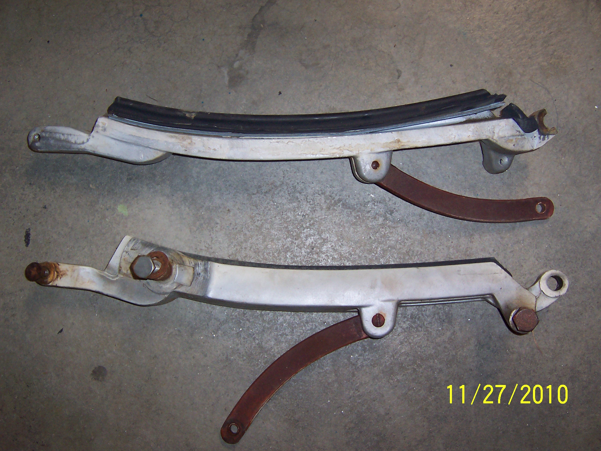

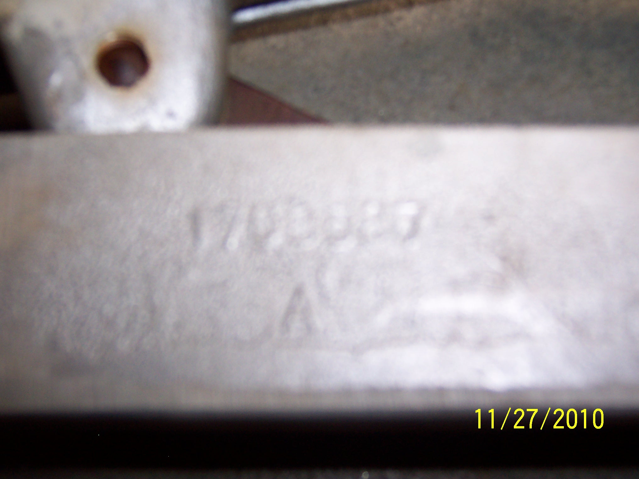

Matthew, there are part number that were cast into each convert frame arms and sections. They are raised numbers.
Teh first picture is of my original main pivot arms. You can see that the bottom one had the bottom part of the pivot hole broke away. It was never found in the bottom of the car quarter window area. The other picture is of the Drivers side main pivot arm with an undamaged main pivot hole.
Here is a close up of the cast in part number of #1708387 (from what I can decipher) the broken passenger side has a part number of 17830686.

John, I don’t know what sort of metal these are. Do you think they can be welded?
Roger, It is just an old convert frame that is over 50 years old, don’t be so hard on yourself, You babied that convert and kept it alive to see another day.
Hopefully it is the part I think it is and I will just send it to the Keij’s free of charge to make everythink well again.
The metal is cast aluminum and it could be TIG’ed or if it is like my broken one I would have had a machine shop make me the other half that is missing and pin the parts together.

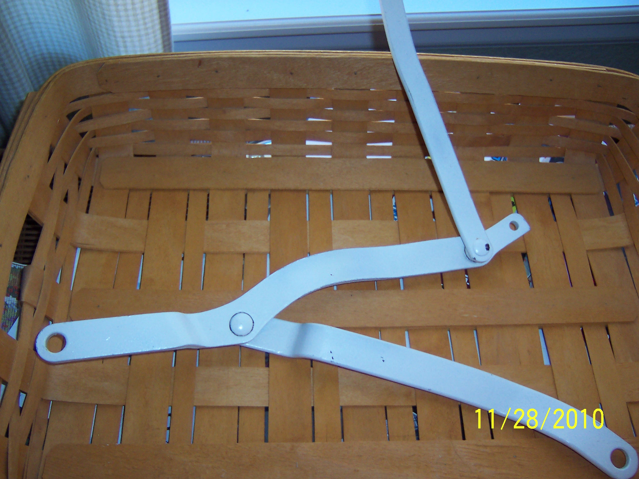

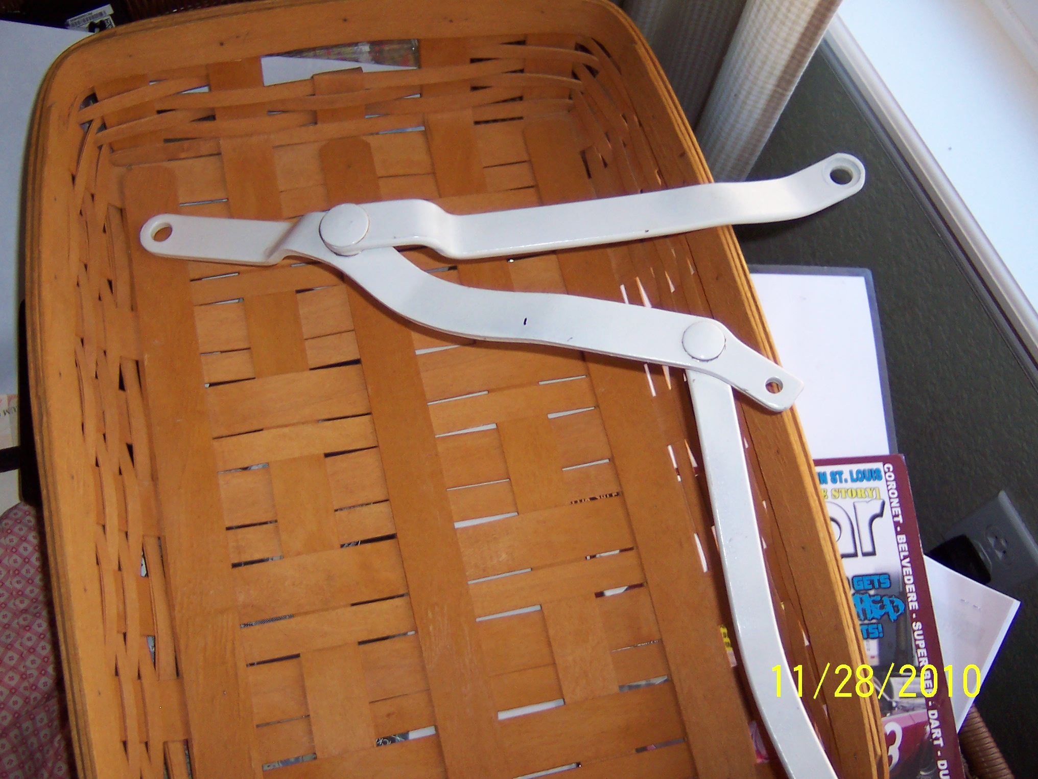

Here are my parts of the joint that failed. Luckily these sections of the top are not aluminum but heavy steel. So the can be welded back together again. The pivot point is a hardened rivet that would have to be drill out or ground off. Another rivet could be reinstalled but you might just want to put a dowel rivet in its place would be quicker and easier. Use teflon washer or a bronze thin washer if you do. Helps on the parts slipping together.
The picture you have that you had a caption that says 'making a weird angle.." is suppose to pivot a little when the top is actuated. It is part of a normal opening and closing function.
I do not have this part as a back up. (there goes my Diet Orange Sunkist) but that can be repaired or a replacement fabed up. Just keep the bends in the correct orientation of you are going to fab a replacement part. Heating of a replacement stock like a Blacksmith is needed to do the bends.
one view of the riveted parts
opposite view of the riveted parts
