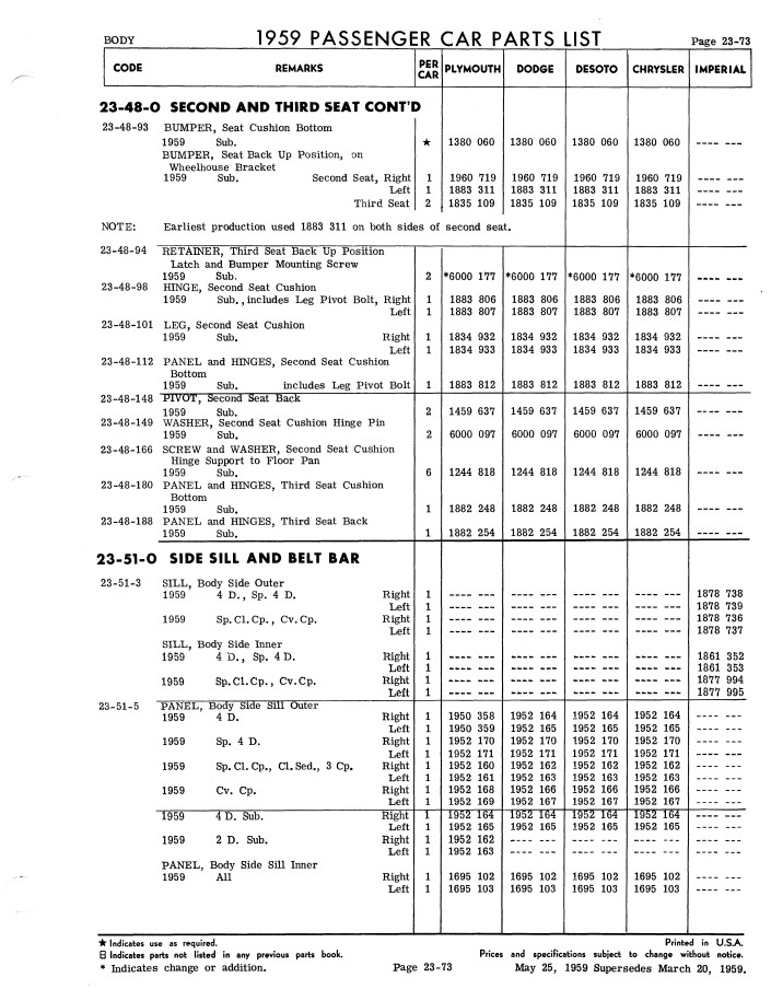

Am wondering… are the rockers on a 59 sport fury (inner and outer) essentially interchangeable with those of the belvedere and savoy? Mine is a 2 door hard top SF… I can find replacements for the other two for days, but when I reach out to the manufacturer, suddenly no one knows nothing… I do realize any replacement part will require some massaging but generally speaking, I would assume the originals to not be model specific.. but one never knows..

Hi Henry, here are two pix from the Parts Manual that pertain:
As you can see, the outer rocker part number varies by body style, not by model - and the inner rocker part number is the same across all models and body styles. Hope this helps.
yes perfect!
