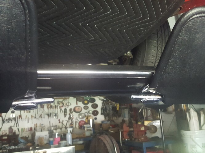

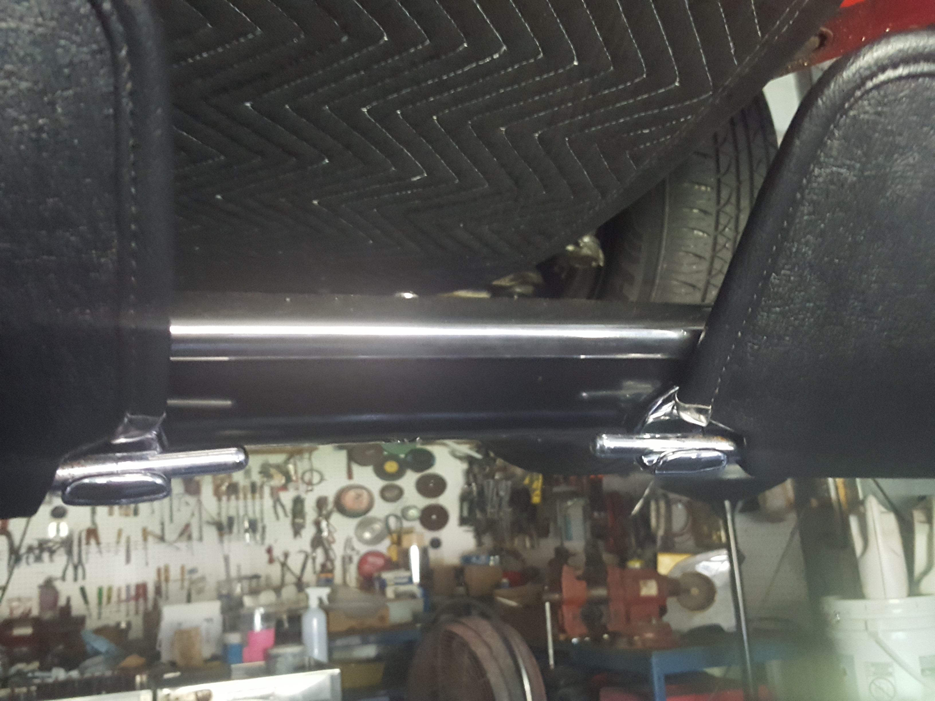

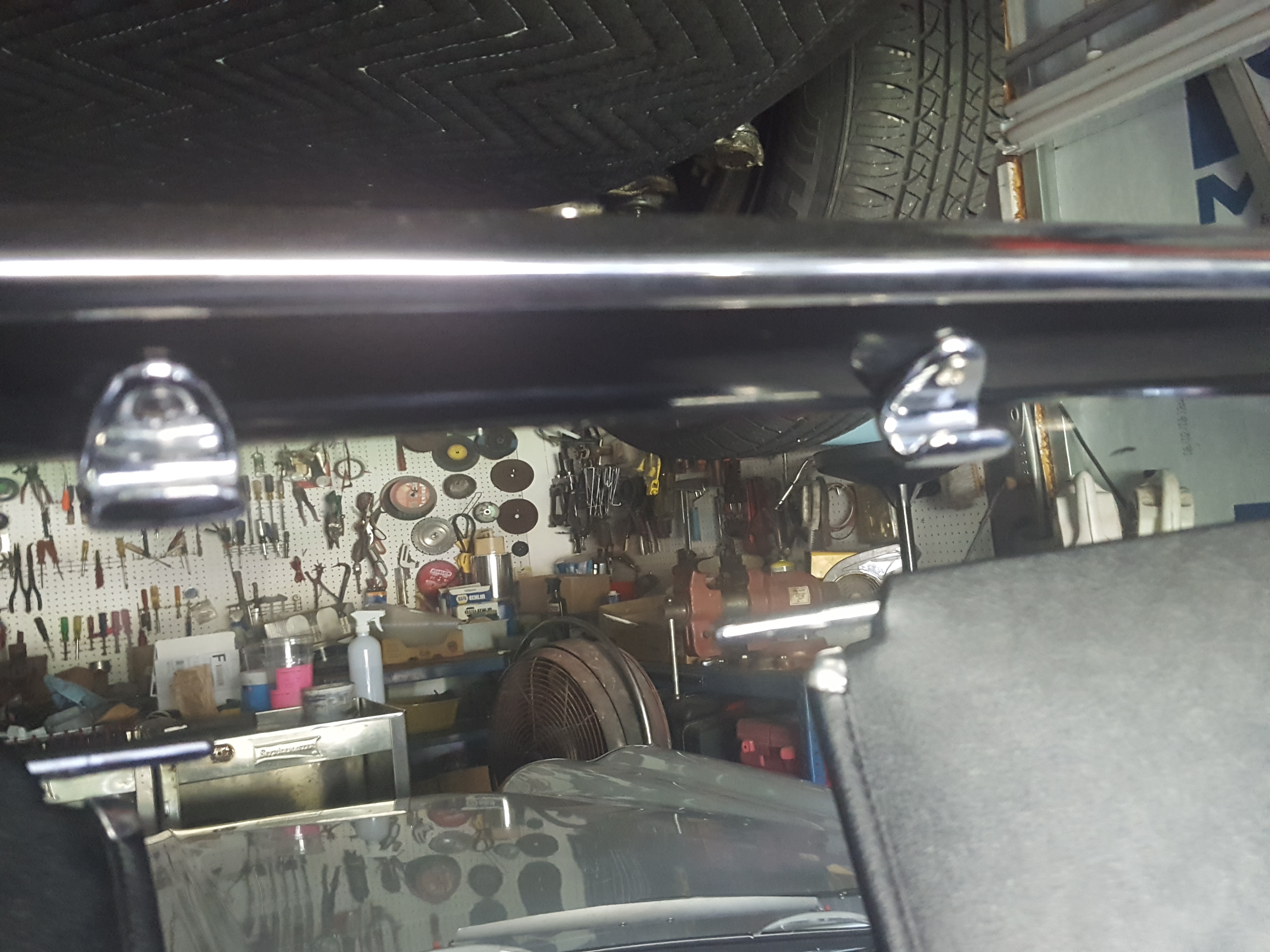

I can see why, 1st picture is chrome plated retainers mounted where plastic retainers were mounted, second picture is visors resting in new chrome plated retainers. The Desoto is on the lift with the convertible parked underneath, that’s why you see a tire and a small blanket to catch any oil drippings.

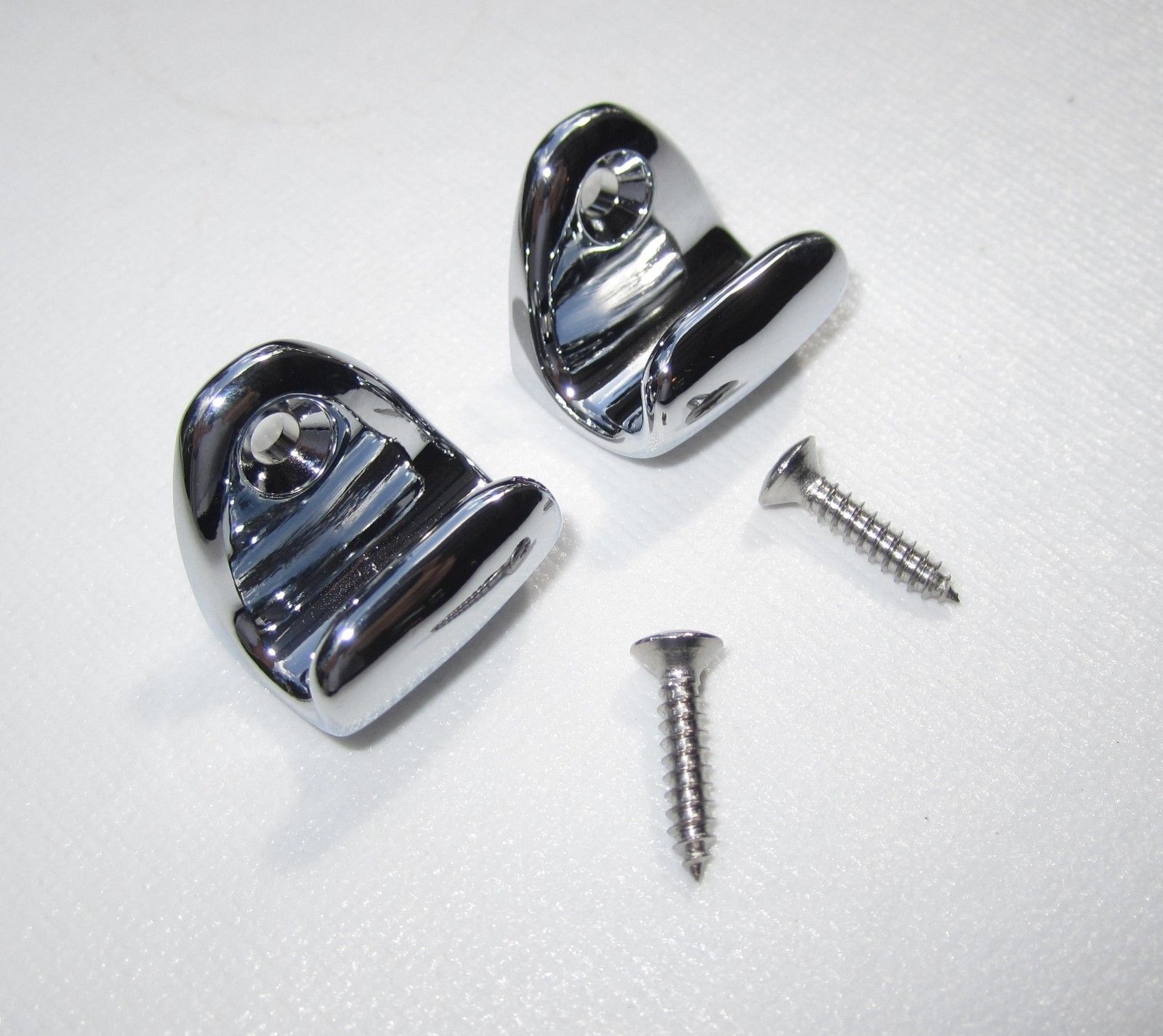

Here’s a pic from the eBay page…
Thanks Dan. I didn’t know how to post that picture.
