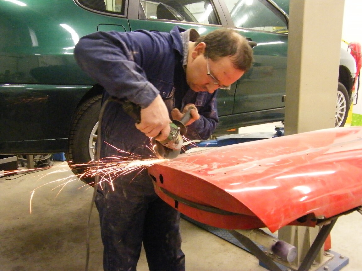

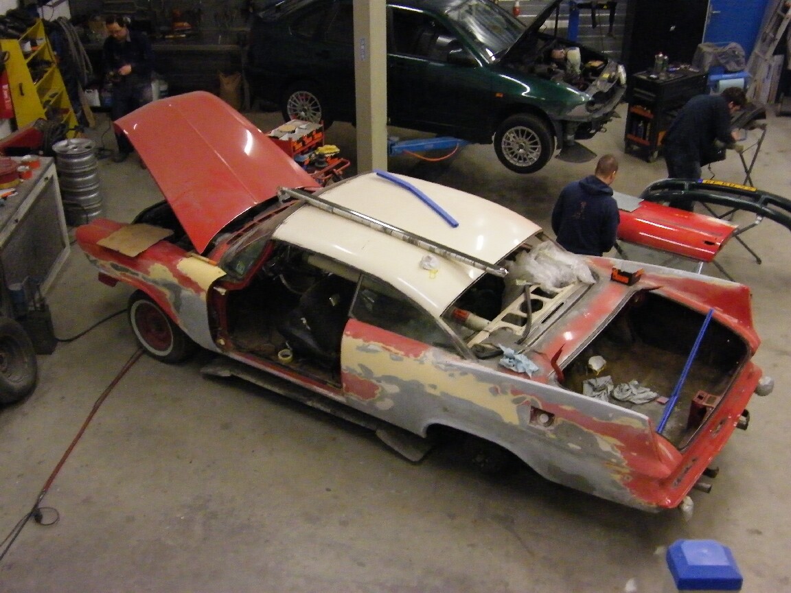

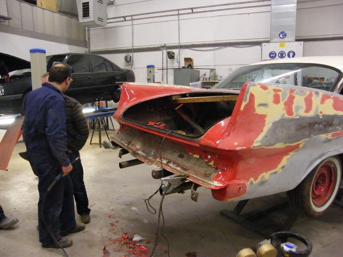

As the sanding progressed they found some more rusty spots in places we hadn’t expected it :frowning: But in a few weeks I’ll have a rust free car in my garage.
rusty door

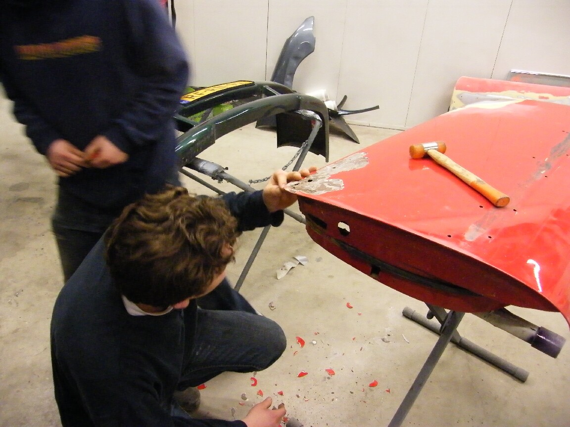

making the patch panel

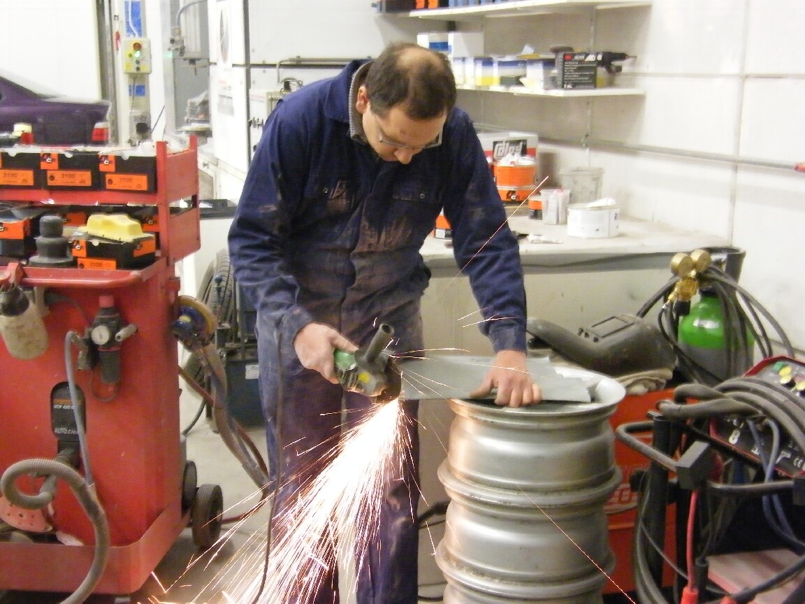

cutting the bad spot from the door
a little rust on the rear valance
the shop

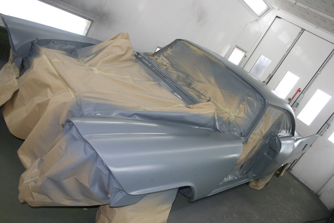

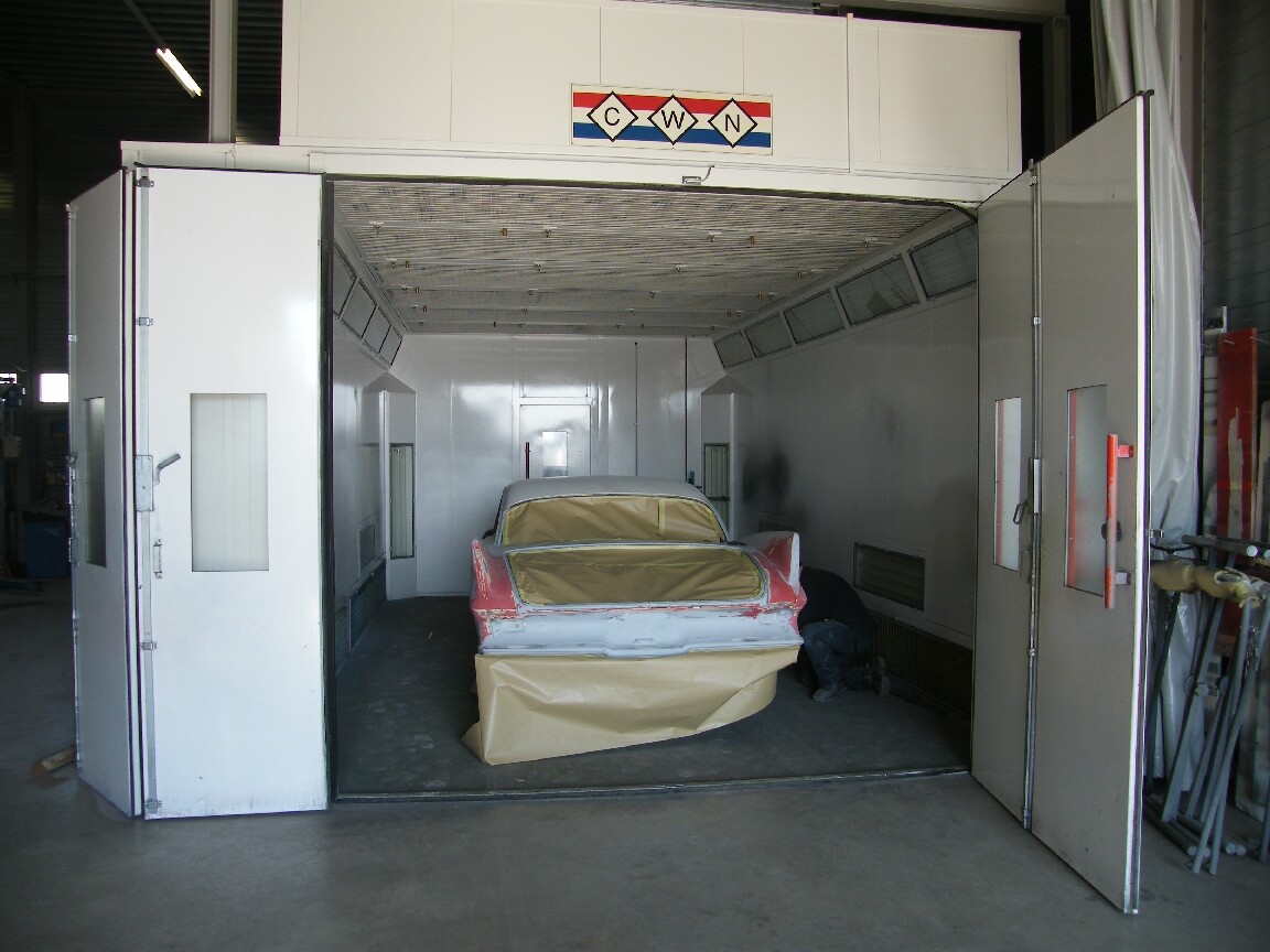

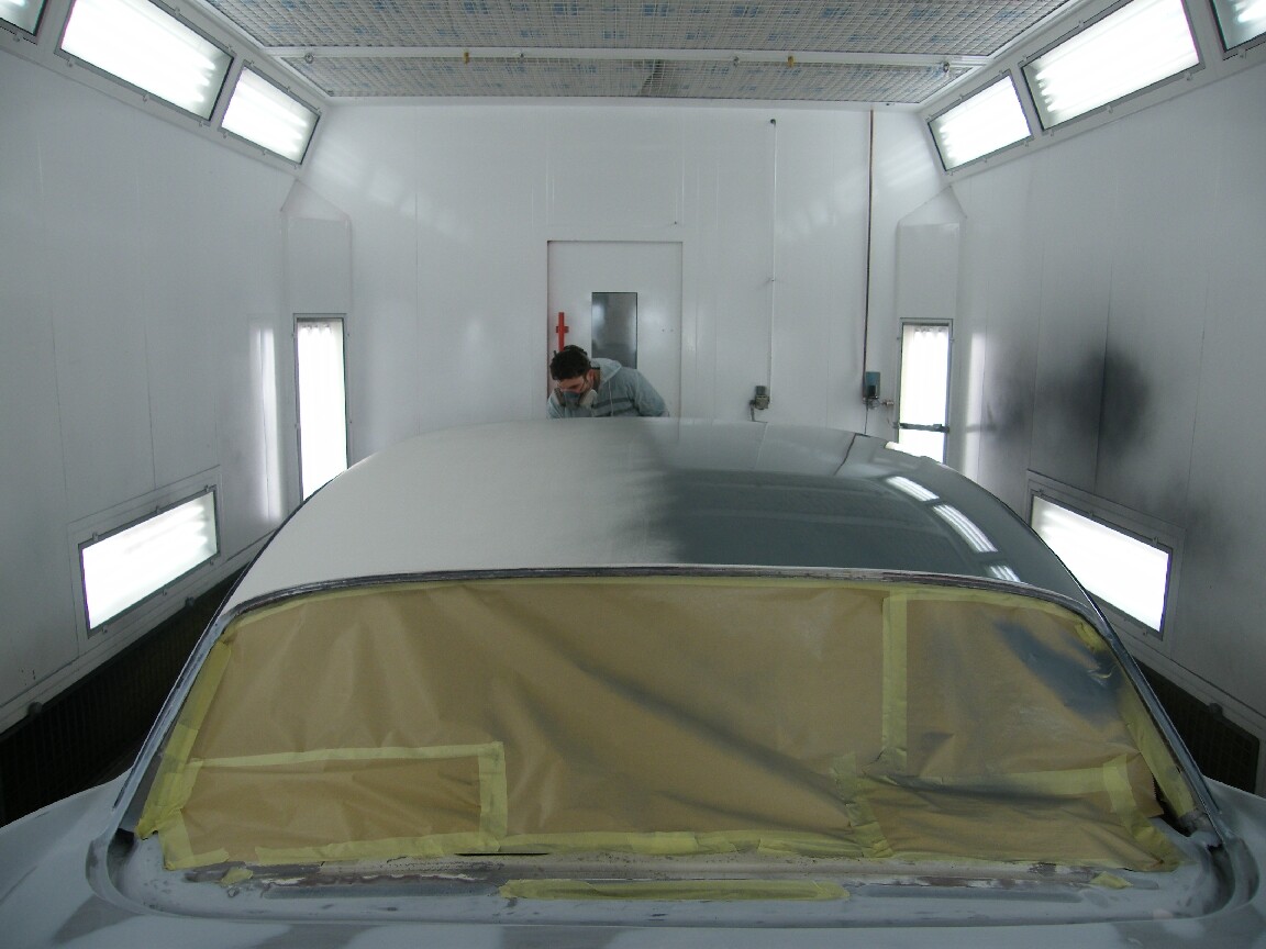

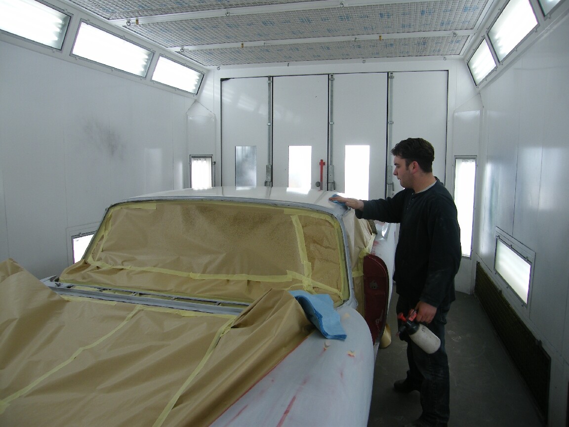

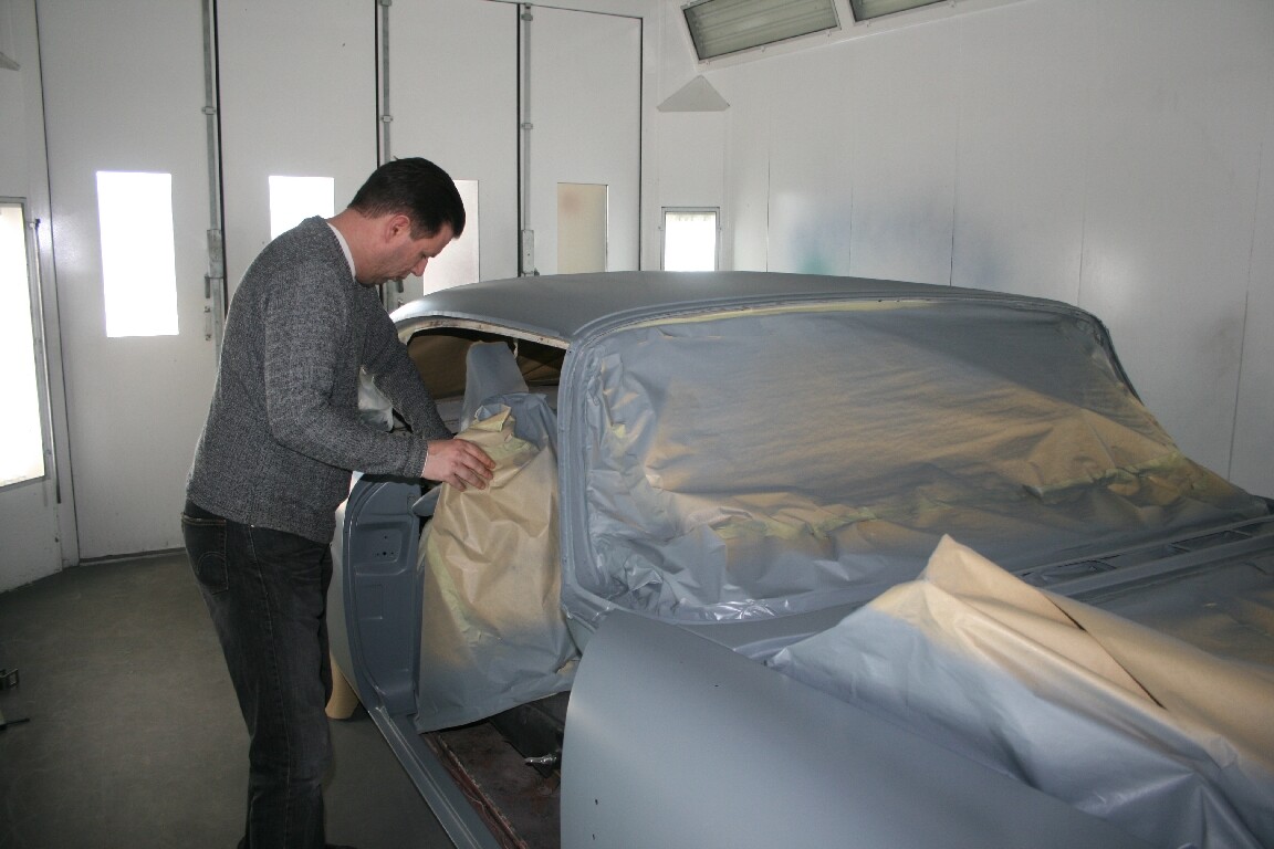

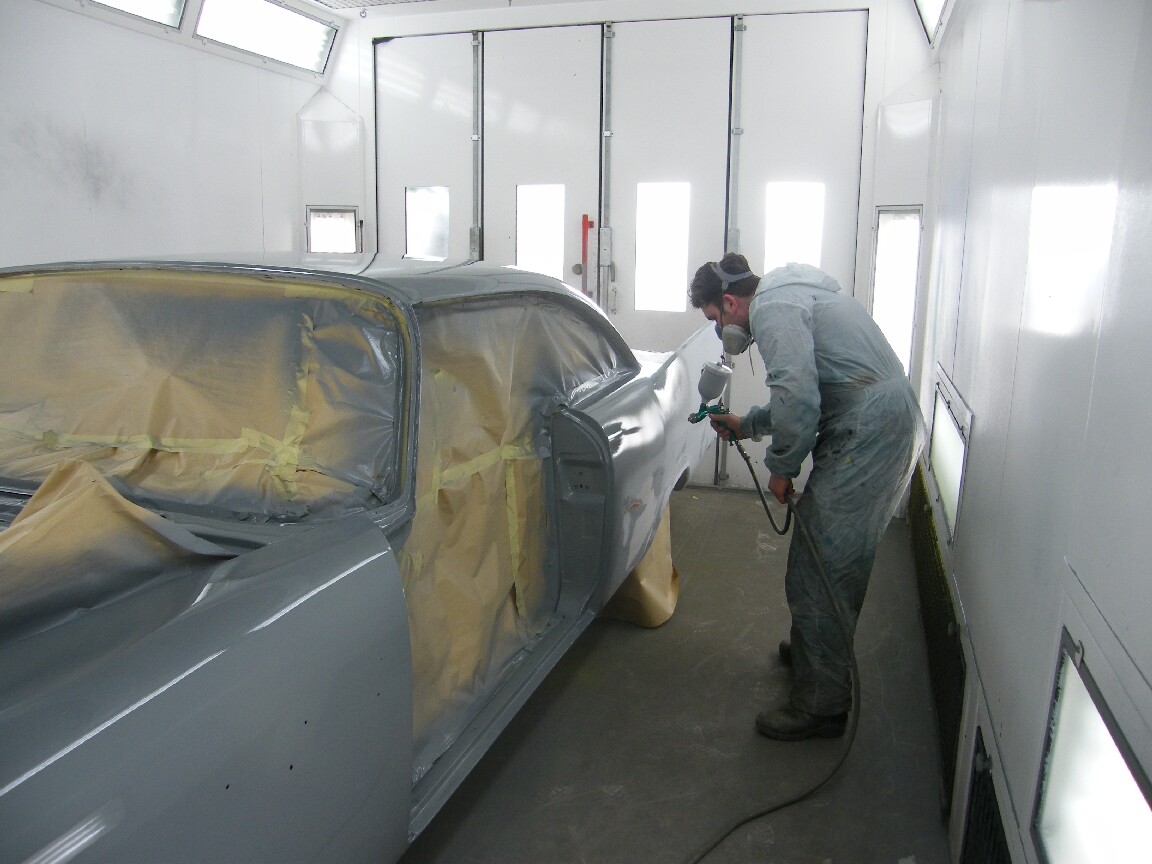

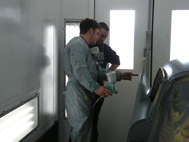

Today the first (base) coat of paint was sprayed on the car! Well actually it has 3 coats of paint now and it is really starting to look good. I have been in the paint booth all day and I even did my share of the work, masking everything and I had my first lesson in professional painting. It wasn’t too bad but it is certainly not as easy as it looks.
Next Saturday the car will be ready to get a nicer colour and get finished with clear coat.
in the paint booth
cleaning and degreasing

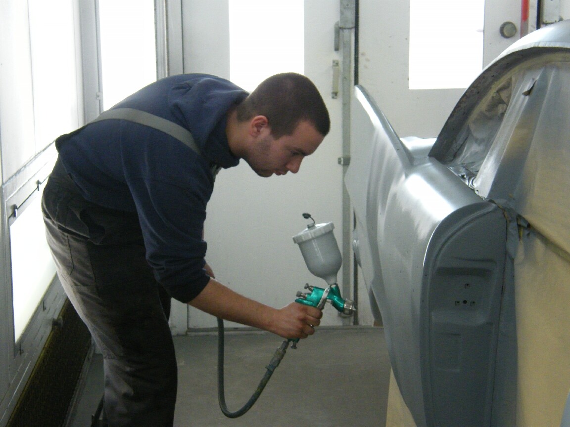

the proffesional at work

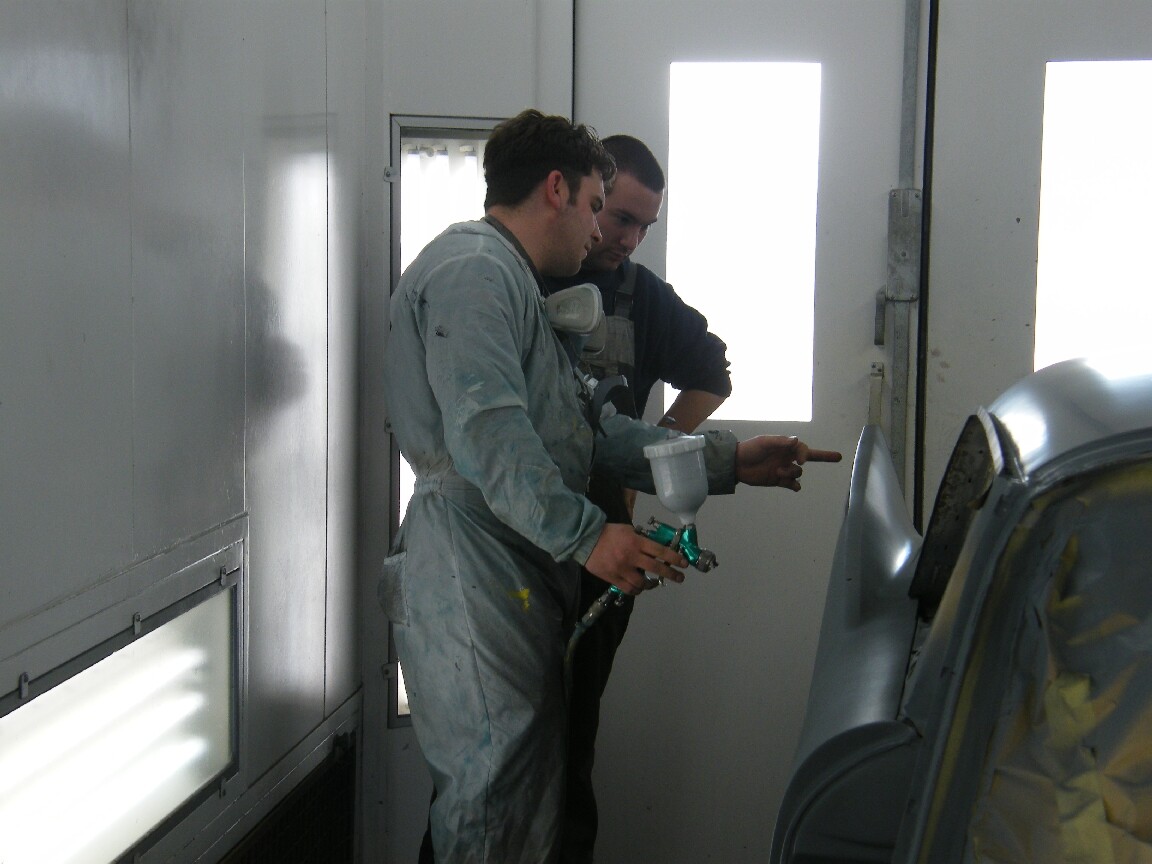

Matthew has to do his share too!
and gets some instructions
must have been good instructions

(why doesnt Matthew wear a respirator while painting?)
It is wonderful to see the progress!
Roger
Roger,
There was no need to wear a respirator. The booth is so well ventilated and fitered that we didn’t even smell the paint while we were in there.
Sprying one layer takes only 10 to 15 minutes and then you get out of it while the air is filtered. When you get in again you can’t even smell the paint.

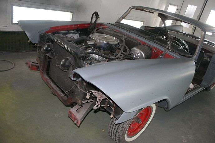

I notice you are not painting the firewall at this time. Hopefully the new red paint won’t clash with the existing red paint?

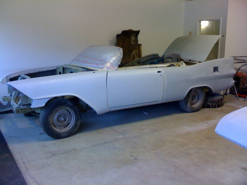

I have the 413 RB done and am detailing it now, This 413 has AC on it so the brackets are all mixed up! Alternator on the Drivers side and AC on the passengers side. It was a 1960 413RB out of a New Yorker. I am keeping the AC to have an underdash delivery of Cool air.

Hey, Roger, My car did not come with a motor in it when I go the car in Montana, My friend here in Denver area, who has a 61 300G, had a spare rebuildable 413 that he taken out of his sisters 60 New Yorker back in the early 90’s. The car had only 85K on the odometer but the motor had sat so long the oil went to solid sludge. So time to rebuild!
I dropped the motor off after breaking it down last summer and had it bore .040 (it only needed .010) but I got a deal on some .040 pistons, so we did it to that size, Crank needed only polishing, Heads were good but put unleaded seats in the valves after boiling them out, Motor was assembled at the machine shop and was painted a bronze color with black valve covers, I am running a 4 bbl carter on it with the 1960 cast Iron TF that it had originally come with (the 413 that is). I will post a picture of the motor in day or so.
