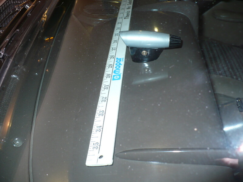

Here is a photo of my SF eye. It is mounted at the center of the instrument cluster, about i/2 inch back of a line across the fromt of the ribs (see photo) With the unit having a curve in the mount and the dash being curved, it would appear the sensor would be mounted to be level.
John Q, please notice the Mopar yardstick!
Tom
Thank you so much!
That pic is super helpfull. I will try and mount it this week and put back in the instrument cluster. Pics will follow :smiley:
