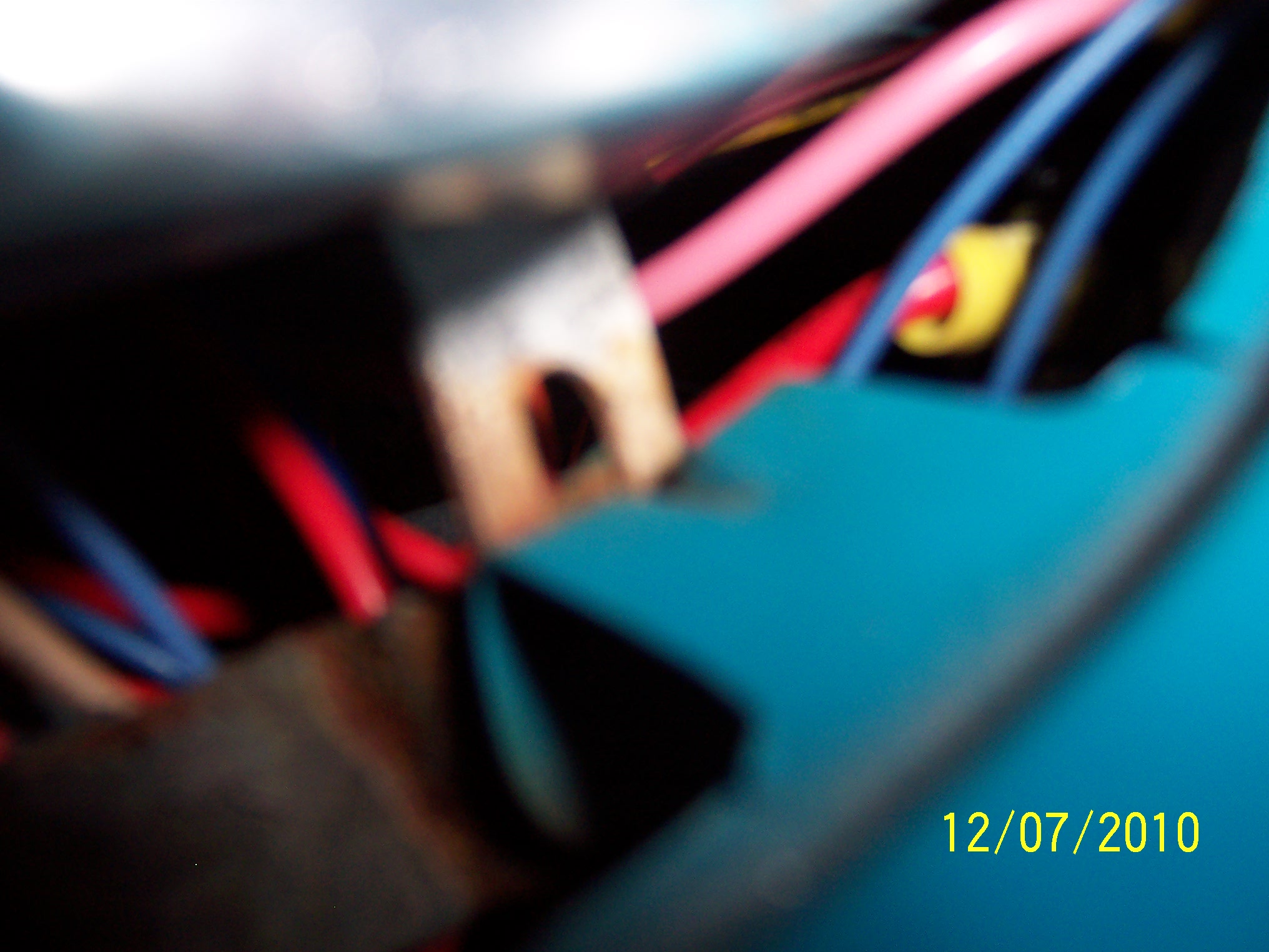

Here is a picture of the lower U shapped ear that Roger drew and showed in the pdf of the manual. (I failed in art class!)
Sorry the picture is a little blurry on this close-up of the Instrument panel lower mounting ear. The stud it rests on is right underneath it but can’t be see at this angle.

Take extra care when removing the two nuts from behind the dash, when I did mine they were frozen tight with rust and started to twist the metal attaching points of the dash (very thin) :imp: I ended up spraying them with anti seize and let them be for a day then they came off a little easier but I still had to reshape the tabs…Hope all goes well for you
