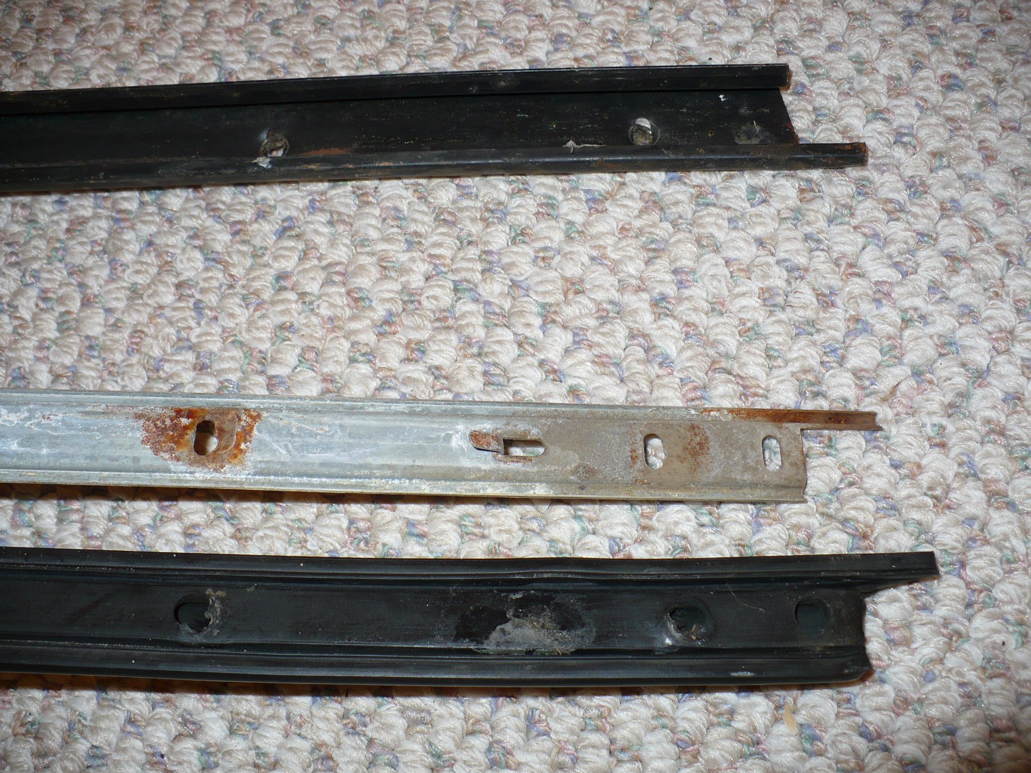

I have now solved the sticky roof rail weather strip problem that made if difficult to roll the quarter windows up and down. Dan had mentioned that Gary Goes had the weather strip in one piece and flocked. I have purchased and installed these and they look and work perfect. I have the earlier type that screws in.
Here is Gary’s email to me:
Hi Tom,
The set is $195 plus $10 shipping. Please be aware, many '59 car had a precurser to the '60 type roof rail strips. They were a sponge rubber extrusion on the front half over the door glass and solid rubber extrusion on the rear half. The strip fit into a stainless molding, not screwed up into the top rail like the earlier type. This type takes a molded piece in the front corner. I have this type, but not flocked and in separate pieces easily glued and mated to each other when installing. So, check for sure which type you have.
Tom, can you clarify what Gary meant? I have the steel rails that screw into the roof – does that mean the flocked set will work in my car, or no? And, is the front corner piece built into the flocked set, or do you still need it?
Dan here is a photo of the two types. The one is a metal strip that is put into the grooves in the rubber and then screwed into the roof. This is the type I have and the type that Gary has in one piece and flocked. The other piece is a channel and is is screwed into the roof, then the rubber is rolled and tucked into the channel. He say he has this replacement rubber in two pieces but not flocked. The front piece is extra to both types. My front pieces were in good shape from my original replacement , so I just left them there.
Tom
I see. They really aren’t interchangeable, then. I have the channel type, not the strip – so I can’t use the one-piece flocked type. Guess I’ll have to stick with a light touch of lithium grease…

With manual cranks you can probably get by with the rubber seals you have. If they need replacing and you really want the flocked one piece type, you might look around locally for a pair of the strips so you could mount the rubber. The mounting holes in the car are the same as your channel, as I compared this with the two pieces in the photo above. I only have an extra left strip and also the shipping would be a factor.
