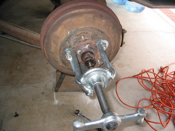

You need to get yourself a puller that looks like this:
Nothing else will do. You won’t mess up the threads, if you put the crown nut back on the threads backwards, without tightening down.

But I would ask around old shops, or tool rental companies. Or consider buying one - here’s one on eBay.
