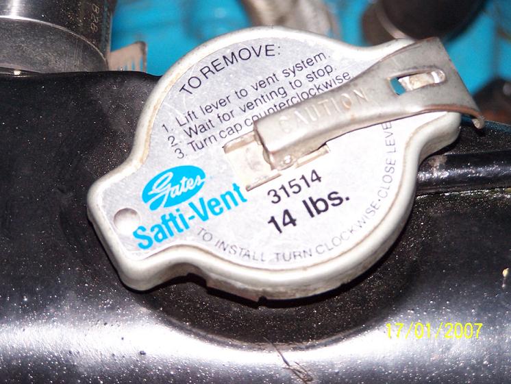

  1. What should I be using for a radiator cap? Got a Stant part number, or other recommendation? (I suspect my 12 lb. cap is what caused my radiator to blow out)

Dan - I know about radiators, just finished repairing the 59 green Plymouth, and my 60 Desoto. The red 59 Plymouth was done about a year ago. I would suggest you add another row of cooling tubes to you radiator if possible. My radiator man was able to do it and my engine runs a lot cooler than before. Besides that car had factory air that I’m going to re-install so I will need more cooling anyway. The radiator cap should be 13 lbs. NAPA should have everything you need including hoses. As a suggestion NAPA should have a shallow tub about 6 to 8 inches high - 24 inch diameter made especially for draining radiators. you can also get a smaller version at Home depot that will work very well. Some good news, the wife (relunctlantly) agreed that I could add more garage space to the end of the garage I recently built on the side of our house it’s 14’ x 50’, two cars end to end. The new addition will be 14’ x 28’ x 12’ high to accomodate a two post lift. I think I got a pretty good deal. Metal building including slab, 140 mile wind. $12,000.00. All I have to do is move my 10’ x 20’ shop/storage shed to a far corner of my lot. It can only be 14’ wide because of county restrictions on one side and the wife’s restrictions on the other side. You know what I mean. I’m shure this is going to cost me dearly in the future. I’m definetly going to have one of those mats under my lift. Good luck with Faulkner. I’m sure you are anxious to get him on the road.

Regarding the radiator cap. I bought mine from JC-Whitney a long time ago. It has a pressure relief valve, so it doesn’t really look original, but it works just fine. The hose should be a standard part, any Napa Store should have one.
