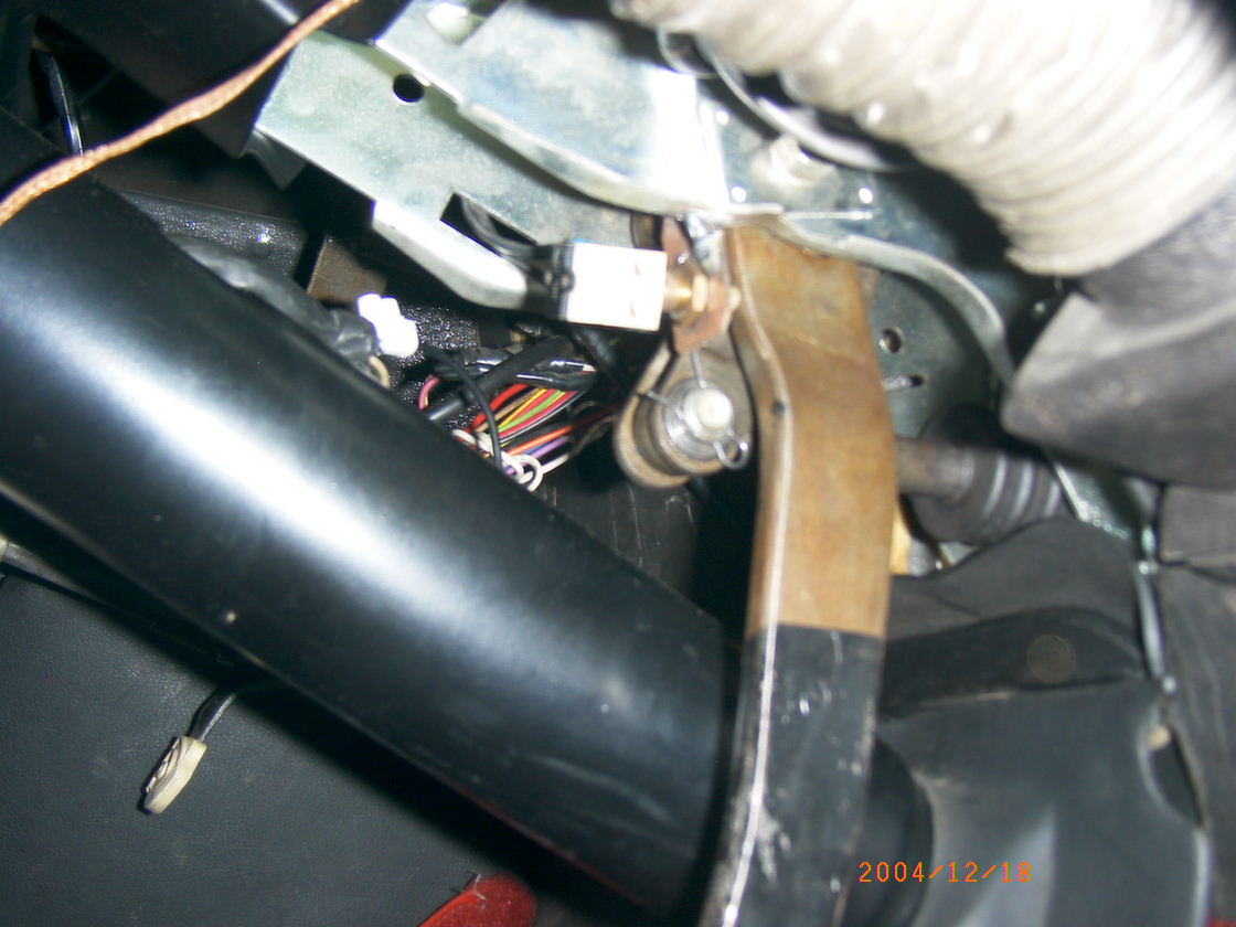

Don’t give up Graig!!! Your problem is easy to fix. Roger and Matthew are right with their posts: Wires broke, bulbs broke or finally brake light switch shot! The first two possibilities you can check very easily like this:
The brake light switch is attached on the bottom of the Master Brake Cylinder. Remove the two cables from the brake light switch and put them together – with battery hooked up and ignition on. Now there are two possibilities:
  1. The brake lights work now! – That means your brake light switch is shot
  2. The brake lights don’t work! – Change the bulbs and if that doesn’t work check the connectors of the taillights.
I bet the brake light switch is shot. I had the same problem with my SF a couple of years ago. I changed the switch and half a year later it happened again. The problem is, that every time a switch must be replaced, you have to bleed the Master Brake Cylinder. But for now, try it! If switch is blown, let me know I have a cheap and better way to solve this problem once and forever.
Stefan
PS: Meanwhile I’ll try to find the picture.
I installed a brake lite switch under dash by pedal so pedal activates switch. Push pedal down and that releases the button on switch and brake lites come on. I’m using a switch from a 75 Ply Duster but I think others would work as long as they have 2 connections on switch for your 2 wires that come from your old switch. I think a new switch costs about 2 or 3 bucks in a parts store. If you buy one from a parts store most likely you won’t get the braket with it to attach it to car so you have to make one. You can trial fit it to car using a really small C-clamp before drilling. I put mine on 2 years ago and the C-clamp worked so well it’s still holding it together. I guess you’d have to leave old switch attached to master cylinder to act as a plug and look original.

John, what a coincidence John! We life thousand of mile from each other, never talked about this matter and yet we had the same idea – amazing!
Graig – We are all waiting for some new pictures of your SF, how about it? :confused: :slight_smile:
Stefan
Here we are: I found the picture! :smiley:
