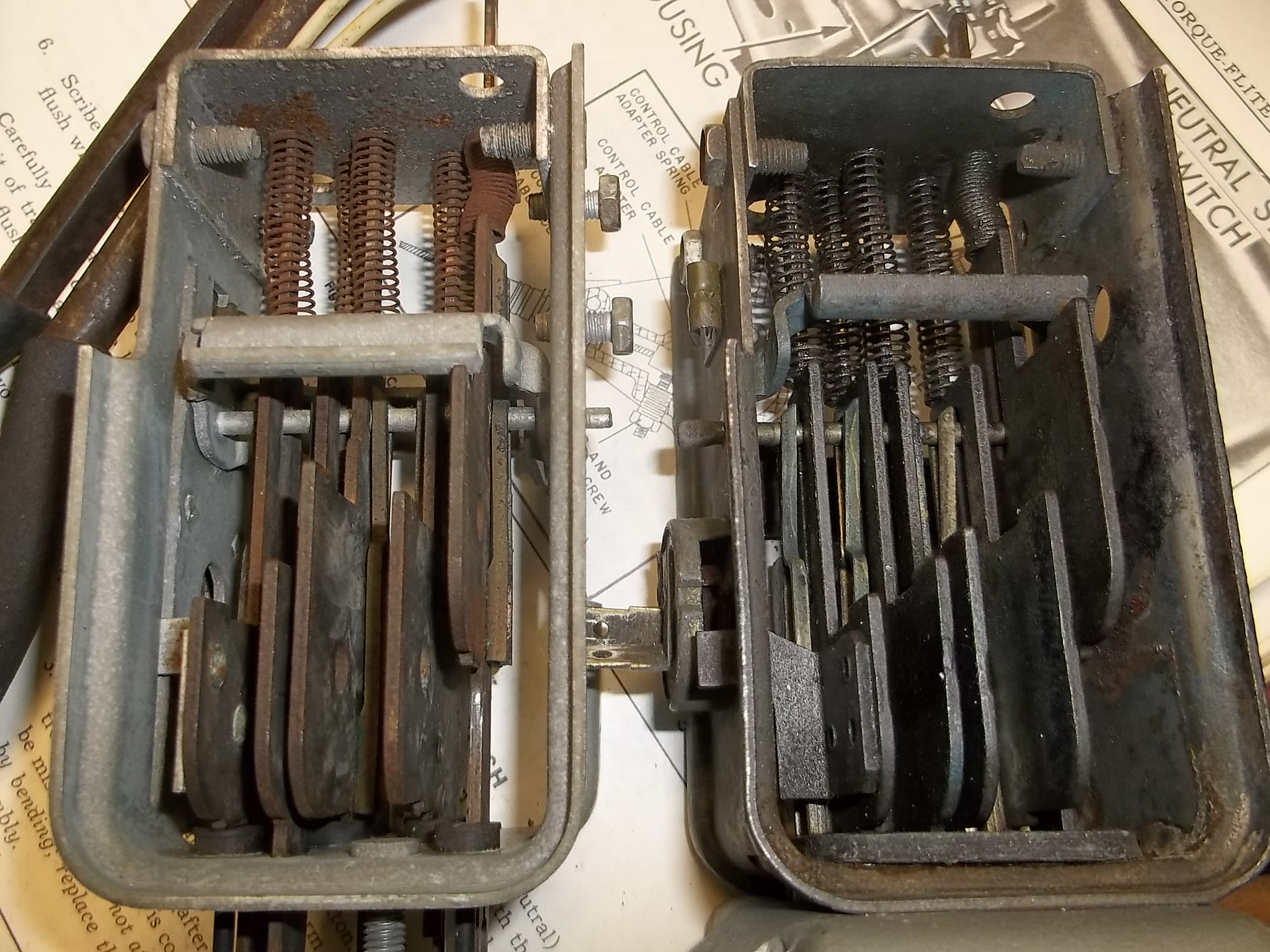

Dammit, tried to attach a picture and lost everything. So here goes again. Got the shifter from the 59 Desoto installed. The one I took out was quite different in the length of the slides which moves the bar that determines how much the cable moves. I assume is makes a difference because of the fine tuning of the shifter cable. It works better but still not right.

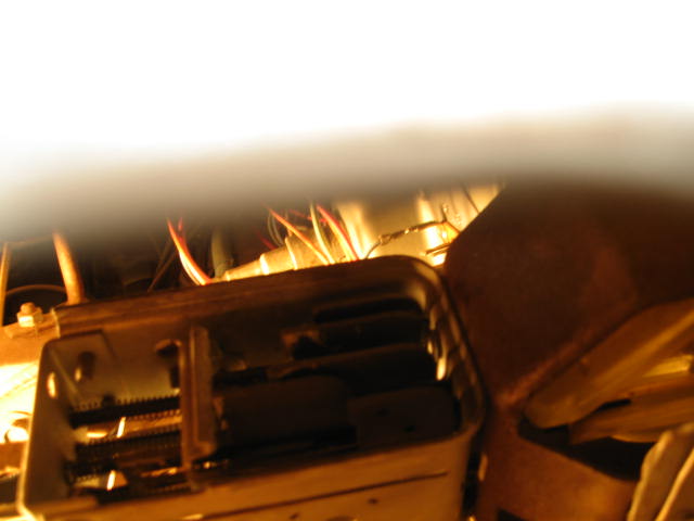

Shift beautifully but still not happy. I have included a picture of the shifter from the Desoto which matches the first on I had in that worked beautifully and the one I just took out. Notice the length of the sliders.

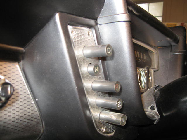

Dick; Starting at the top (D) and going down (N R 2 1 ) does the cable length keep increasing? Or does it go out then pull back A little on one of them? Just trying to remember how it worked,I thought on one of the button pushes it retracts A little .It is funny the two that are off are the ones next to each other. Mark

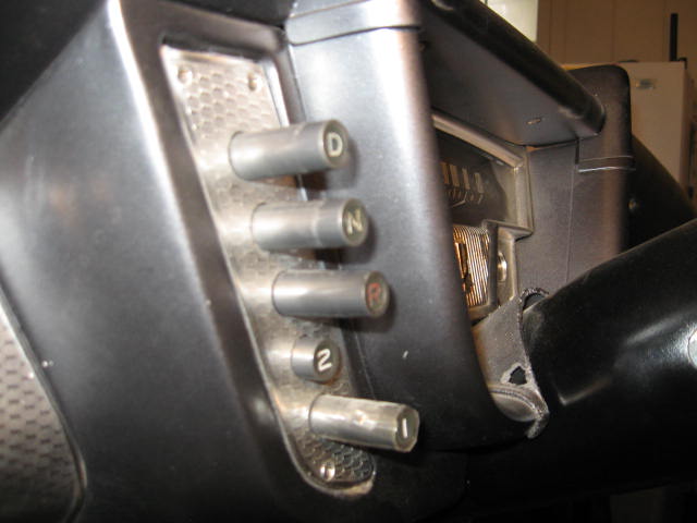

Mark - Put the seat back in and took a drive. Pushed neutral and took off, shifted where supposed to, the buttons all feel about the same pressure when pushed. drives beautifully, I may just leave it alone and drive it like it is. The drive button should be in the 3rd. detent and the Neutral button should be in the 4th. detent. Mine is just the opposite.
Looking at the pictures drive is in the 3rd. detent, neutral is in the 4th., reverse is in the last, 2nd is in the 2nd., and 1st. is in the 1st. So the shifter cable pin should move toward the driver when pushing 2nd. and a little bit more toward the driver when pushing 1st.

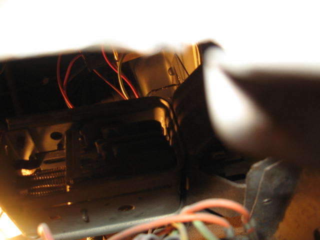

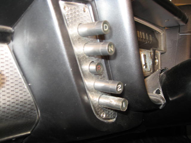

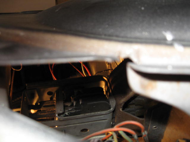

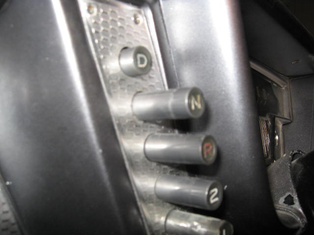

Dick; there must be some kind of play at the striker bar(the part goes across the two sides of the assembly and attaches to the cable).When the button D is pushed in how far is it sticking out of the trim garnish,and when N is pushed how far is that one in/sticking out? Pics are not to good but #5 and #6 are in N, #7(last shot) is in D I was thinking of taking mine out and lubing it anyway,the car is not going anywhere,I do notice that the striker bar when D and N are pushed moves very little,A little play would not be good.Hope this helps A little, Mark
Mark - Strangely the buttons protrude the same amount from the faceplate and have a definite click or clunk when engaged unlike Charlene that has no feel when pushing reverse or neutral but is in gear. Drove the Convert 40 miles to a show yesterday in neutral with no problems.
