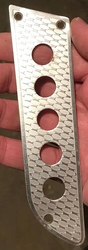

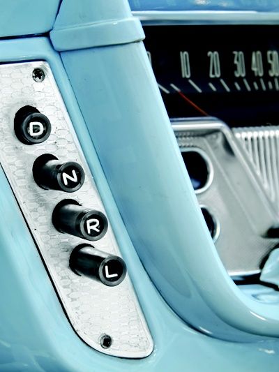

We may have a solution to Roger’s problem. He has a automatic delete plate from a '59 with a manual transmission. It appears to me from these photos, that there is no difference in the position on the plate between the PowerFlite buttons and the TorqueFlite buttons, apart from the fact that the TorqueFlite has an extra button (and hole):
That’s my spare TF plate. I’m sending it to Roger - if it slides over his buttons and aligns with the mounting screw holes, he’s got a perfect template for drilling the delete plate.
Just remember to drill the top four holes, Roger, and not the bottom four :laughing:
Well all be danged! Good call Dan, I never noticed that they are the same pattern minus the the last hole. I always assumed they were more centered top and bottom. Looks like a good solution.
