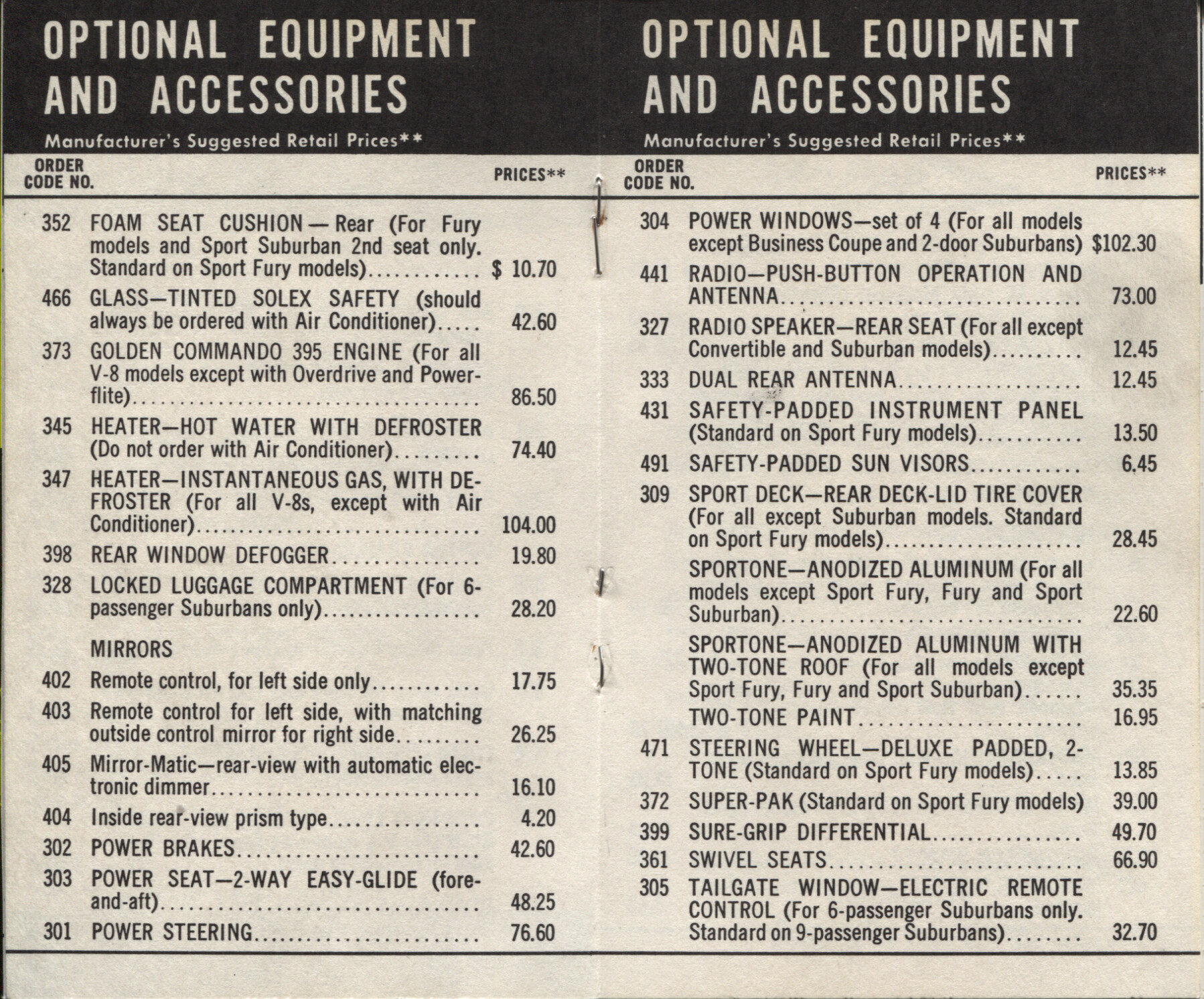

Thanks, Mark. I’ll pass that on. This site suggests that the control valve for 1959 was different than for other years, but was the same across all 1959 models.
Regarding power steering: The “Plymouth Value Story for '59” says that a V8 is required for some options (e.g., instantaneous gas heater), but there’s no such disclaimer for power steering. This suggests to me that it might have been available for the flathead 230.

The only direct interchange to fit power steering is '57-'59 Chrysler products, although Imperial may use a different column. The early '58 to '59 units are preferable to the '57 units. '57 are aluminum, '58-9 are cast iron.
He will need the pump and brackets that match his engine, crankshaft drive pulley for the same, hoses, steering gear, column and stub shaft, and horn contact on steering wheel.
I used the power steering gear box from my 59 Desoto parts car in my 59 Plymouth Convertible, works perfectly. Rebuilt power steering boxes can be had from Rock Auto with exchange.
