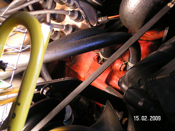

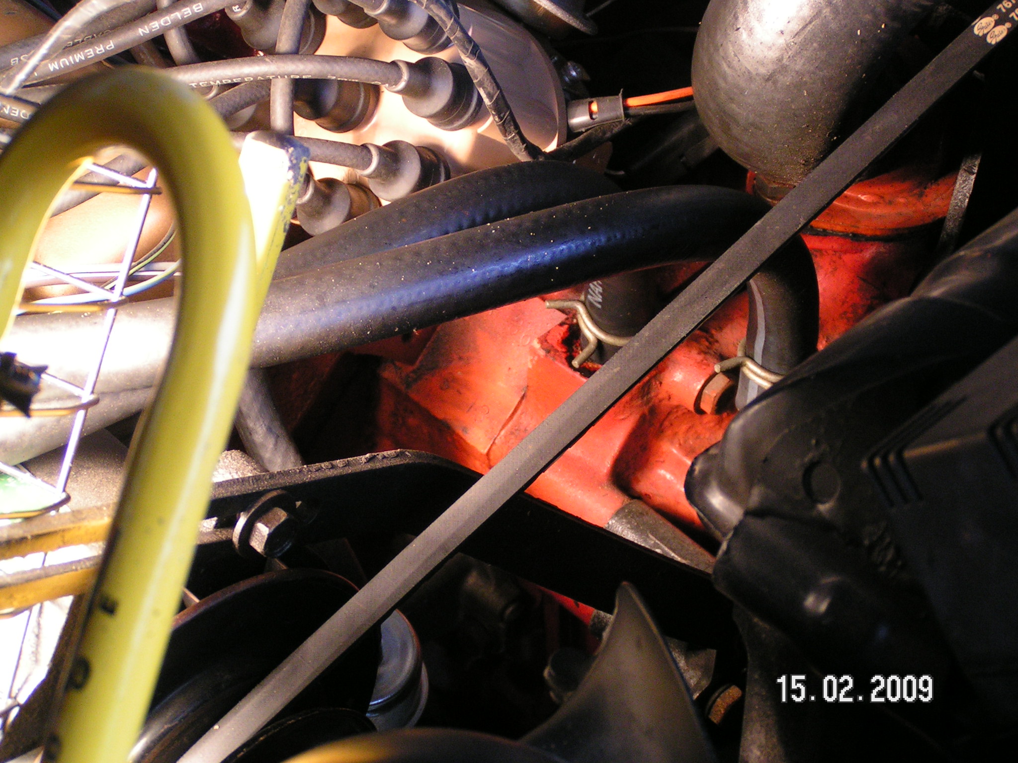

…attempting to post a photo here..]
ID number location on 361
The number sisnt show up in the photo..well, it is in the red area just above where the generator bracket and fanbelt cross.
Oh, and the above is a photo of the ID number on a 1961 Chrysler Windsor engine. This is the engine in my car. But I have a '59 block in the garage too, and it also has teh ID number in this location, so the Parts Book information is (gasp) wrong?
Actually, if you click on the photo, Roger – you can see much more detail. Of course, you can’t make out all the numbers stamped – but you can see exactly where they are.

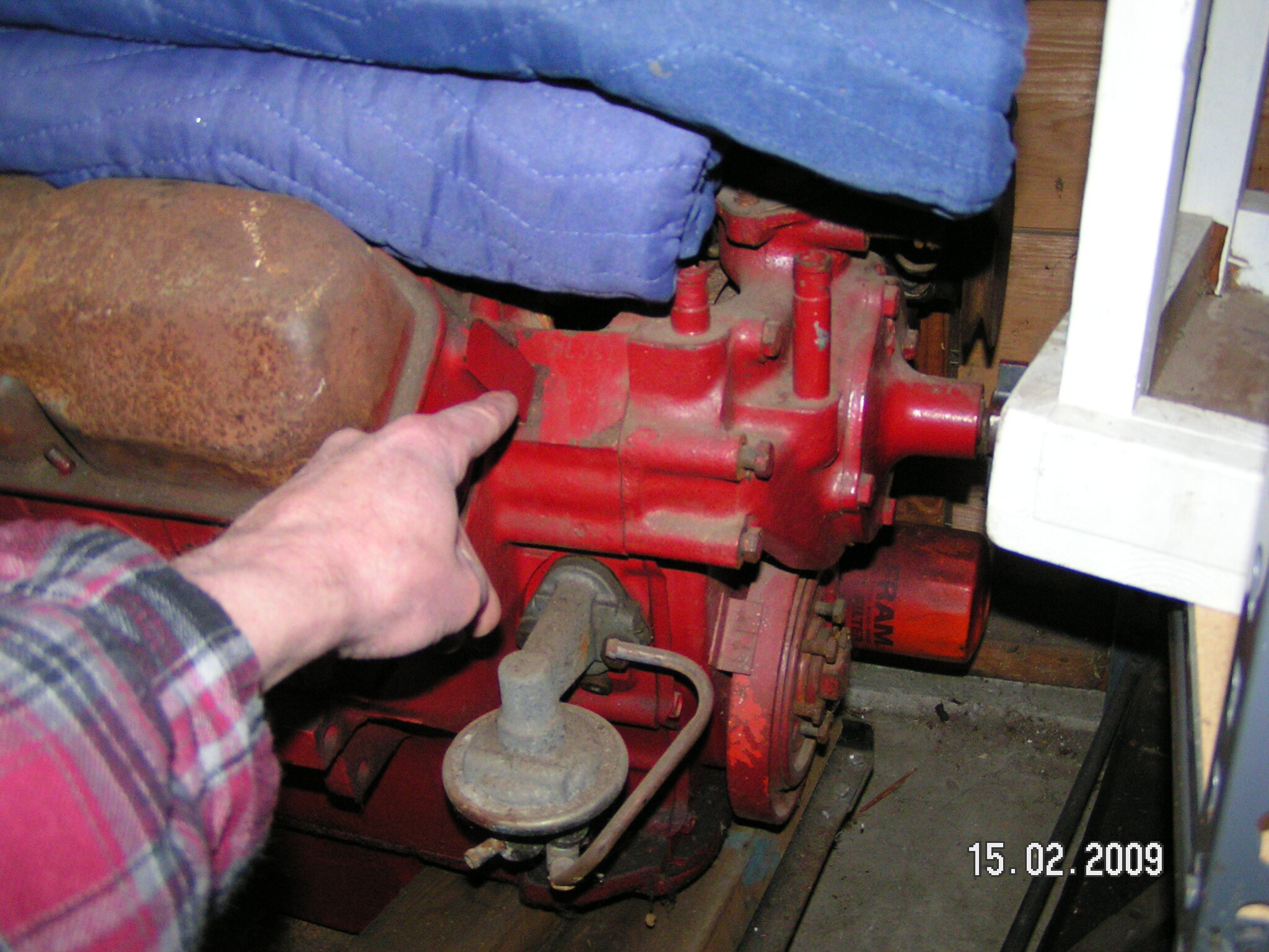

here (hopefully) is a pic of my '59 block-
