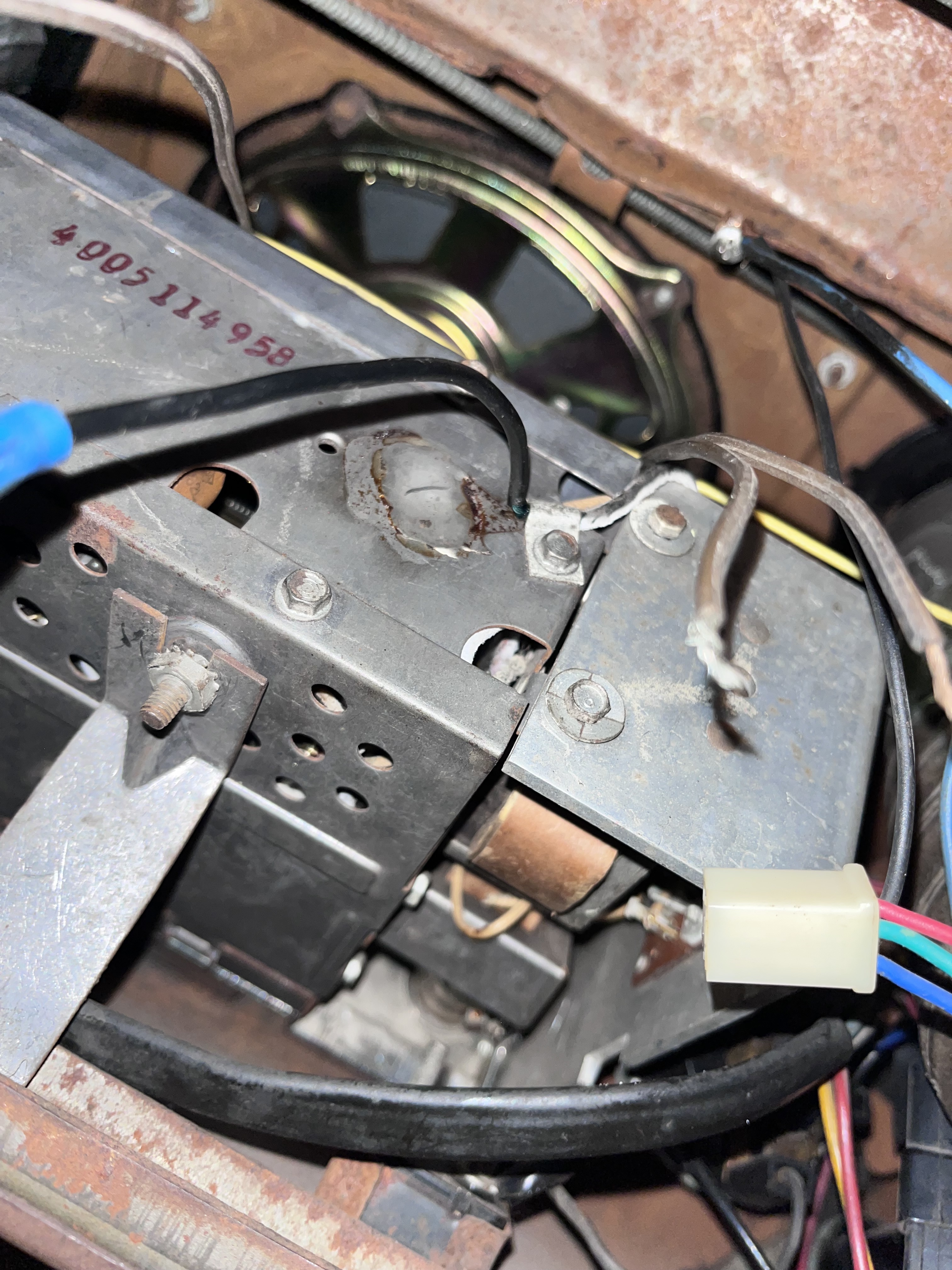

Hi all, I have my father in laws original 59 Sport fury .. he altered the am radio and I want to reconnect .. I have a black wire coming off the back , two what appear to be brown wires out of the top and two speaker wires .. can anyone help with what original wires were connecting to radio would be. Pics would be most helpful.

It’s not much help, but there is a diagram. I’m quite sure that single black wire is the power lead - the chassis of the radio is ground, and is grounded when connected to the dashboard. I would have thought those two brown wires were the speaker wires, but you suggest the speaker wires are separate. Can you take a picture and post it here?

Looking at radio is the black wire power and two brown wires connect to two wires from speaker ???
Sorry, @ginog01, I misread your initial post - you mean to say there is a pair of wires that connect to the speaker, and a pair of brown wires coming out of the radio. Correct, these wires connect. Since the speaker coil is electrically isolated from the dash, which radio wire in the pair goes to which speaker wire doesn’t matter.
And yes, that black wire is the power wire. You want to make sure there’s a fuse in the line (the diagram indicates it should be a 7.5A fuse) - you don’t want to directly connect it to a hot line under the dash.

Okay, black wore connected to power with fuse , two other wires connected to speaker, key turned on , nothing…:weary_face:… that was disappointing.. either the wires aren’t correct or the radio stopped working, therefore the new cassette radio installed in glovebox, which doesn’t work either and disposed of years ago … :face_with_diagonal_mouth:.. back to the drawing board ….
Do you have a VOM, @ginog01? I’d check for power at the fuse, to see if the radio’s being energized.
I do and will check it.. thanks again for all the responses !

black lead should definitely be 12v switched power through the fuse block. make sure the chassis has a clean ground to the dash bracket or it’ll just hum or not power up at all. if those brown wires go to the dial light they usually tie into the dash illumination circuit. good luck with the sport fury
