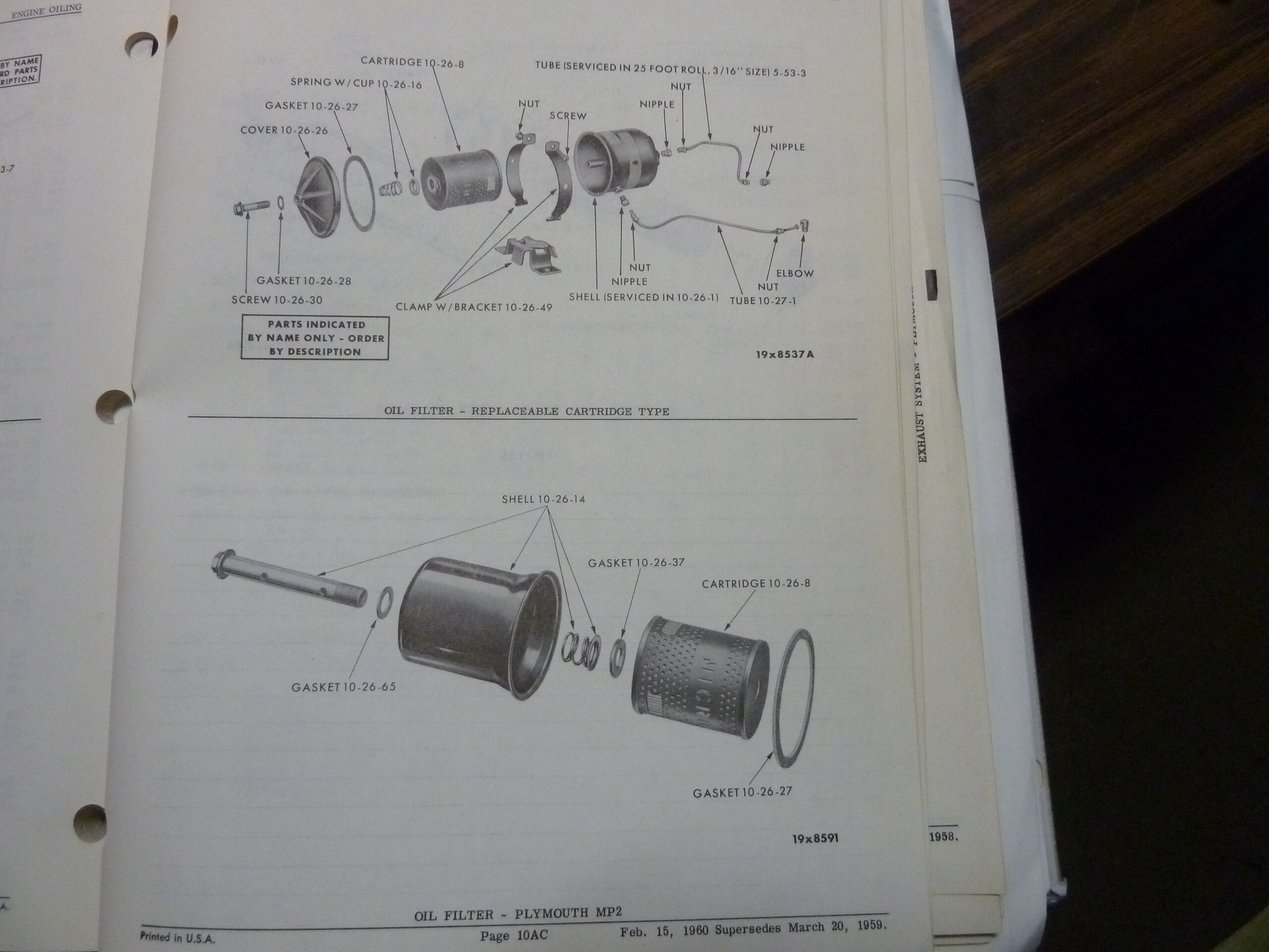

Besides the filter, is there supposed to be a spring inside the canister unit ? Mine has a spring, but when I looked in the service manual, I did not find an exploded parts view that showed a spring. When I took the canister off, it fell down before I could grab it. It seemed like the spring was underneath the filter, and then it was a pain to get the threads to push through the filter, so you could thread it on. I replaced the seal under the bolt head, and the rubber washer under the filter, and of course the block seal. When I took mine off, it appeared that the rubber washer was under the spring at the bottom, so that is how I put it back in. Is this the proper assembly of this filter canister with the filter, seals, and spring ?

A photo of the Parts Book is all I can offer: (Clicking on my photo will enable you to zoom in.)
Was the leak down the side of the cannister,or out the bolt hole? There is supposed to be A spring at the end of the filter/bolt at the cannister,the bolt will be tight through the seal,just turn the bolt like threading A nut till the threads are through.I think the old cannister may have stuck still inside the block face,or may have stuck at the cannister creating A double gasket(sandwich) and can leak,just some thoughts Mark M

That picture from the parts book is what I was looking for. That particular page in my parts book, 10AC, is dated March 20, 1959, and the picture at the top is the same, but my bottom section just says notes, and there is nothing but blank lines there. I notice your page is February 1960. I think I need to find a bit newer manual, as I wonder what else may be missing from my parts book. There are no pages in my parts book newer than May 25, 1959, and most everything is 1959, but some sections go back to late 1958.

The NAPA Gold 1076 filter, I am using, is the same one that was in it before I took it apart. It was not leaking a drop before I took it apart. You can tell even in the picture you posted from the parts book, that the sealing surface is flat, yet it is on a bit of an angle, and then the edge falls away to the sides of the canister. The cavity in the block does not have a lip to hold the gasket in place, so I have put some sealer on it to hold it in during assembly. Companies make a lot of things anymore that are so cheap, that they are barely adequate to do the job. That is why I am thinking the gasket supplied is too thin, and with the shape of the canister at the seal, that you have to be just right on how tight you make it. I could be wrong, but was thinking that the gasket is pushing to the inside, and is also more likely to move, because of the shape of the sealing surface. The gasket lays in there nice and flat. There is nothing hard about this assembly, but I am sure having trouble getting this to seal.

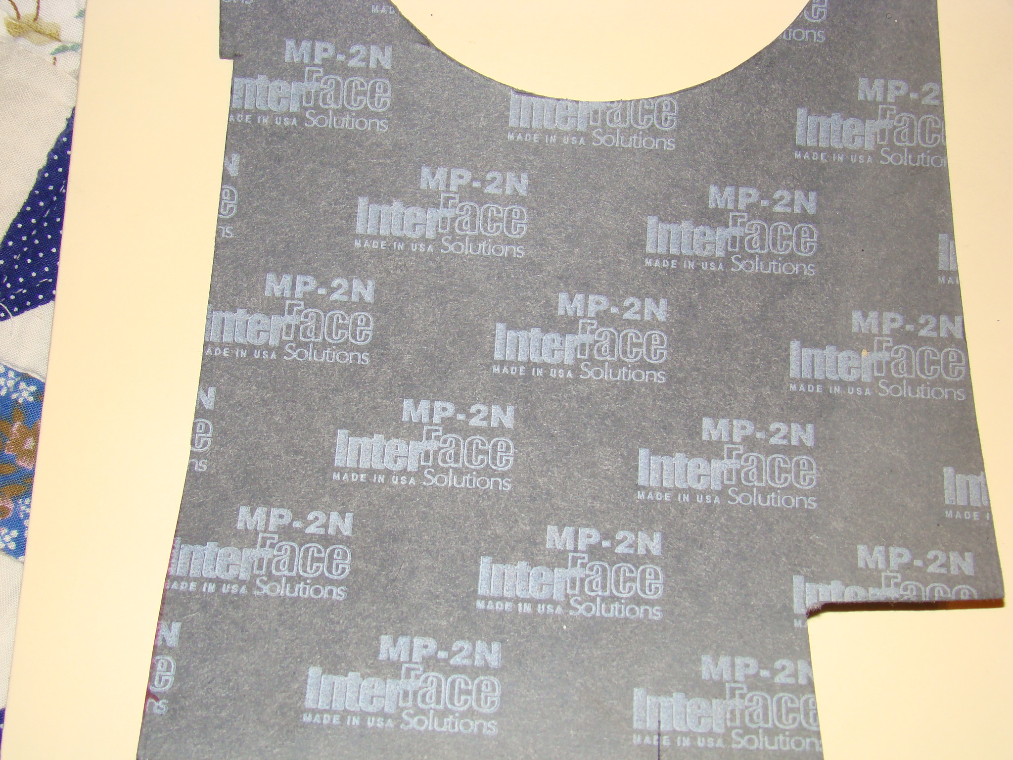

I really wanted to keep the original oil canister setup, and did finally solve the problem with the oil leak. Using the NAPA Gold filter 1076, the block gasket supplied with this filter is garbage. I used some commercial grade fiber gasket material that was about the same thickness, maybe slightly thicker, and used the NAPA gasket as a template, and cut my own. The gasket stayed up in the block cavity, and I just wiped a bit of oil on the front and back. I installed it first time, and no leaks what so ever. I will cut my own gasket from here on out. I have attached a picture of the gasket material I used. This is not the cheap crap from the auto parts store. Hopefully this will help someone else who wants to use the original style canister.
