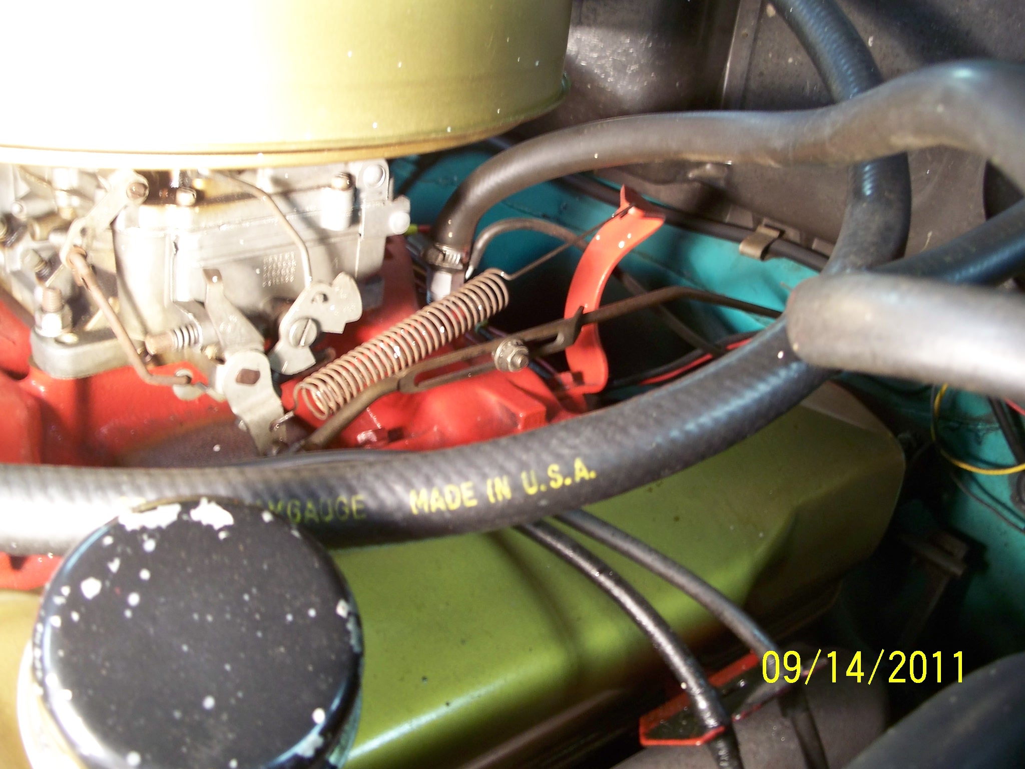

The picture you requeste is attached.

The ignition system you have looks to be stock Mopar. I have been using Petronix systems for over 10 years and have never had a failure. Your ECU box that is in the picture located near your exhaust manifold is stock Mopar. The Petronix unit replaces the points and breaker plate with a new plate and magnetic pick up. Only a red and black wire come out of the distributor and go to the ignition coil. There is no external ECU.
Dave
Yes, it is a Mopar electronic ignition used from 72 to 80.
