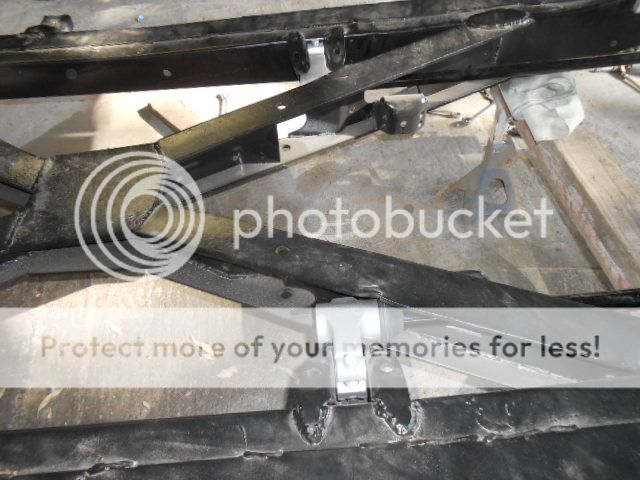

Here is a photo of the top side of the torsion bar mount on a convertible. The head of the bold you need to turn is facing the ground, not horizontal.
Hope this helps.
