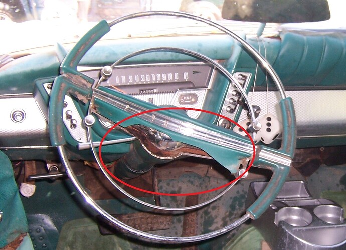

I am sure looking forward to sharing info – really learning all I can from you good folks since I am a newbie. I have wanted to jump into the '59 pool with both feet all my life and decided that I’m definitely not getting any younger so here we go. Right off the bat, my very first project car is a soon-to-be-beautiful 1959 Belvedere, which needs a lot of work, but the thing that has me running around in circles is the steering wheel which is in need of a major restoration or replacement. After checking as many resto places as I could find,it looks like I’m going to have to sacrifice one arm (preferably the left one), but I really don’t want to give up a leg as well… I have also tried online databases for salvage yards but came up empty. I don’t suppose anybody out there has a parts car sitting around with a decent steering wheel… I’m not sure where to “turn” at this point so any advice or words of comfort would be greatly appreciated.

Are you looking for the deluxe wheel, or standard wheel?
If you have your old one, you might consider getting it recast, as originals seldom have any plastic remaining after all these years. The standard type wheels held up better than the deluxe ones.

That is the optional deluxe steering wheel :sunglasses:
John has a good address to have these recast. The center is some sort of vinyl.
Maybe you can have that part redone too by an interior specialist?
As far as options, on that pic I see the steering wheel, dash pad, heater,torqueflite and windshield washers

Your car’s steering wheel is known as the Deluxe steering wheel. It was an option available for the Belvedere.
The standard wheel isn’t awful to look at, they are more commonly available and way more affordable.
Where your deluxe wheel shows bare chromed metal, it used to be covered with clear, sparkley resin grips. The re-casting of these grips is costly.
In your photo you circled the damaged center section of the wheel. This part has a foam base with molded vinyl covering.
Heat, sun, and time cause the foam to decompose, and the vinyl to shrink. It is not easy to find a decent replacement, and I do not know who might be remanufacturing them. Just Dashes in california is remanufacturing the dashpads ($800, maybe more?), and might have answers.
If you find a good center section, in the wrong color, take it to your auto upholstery shop…maybe they can dye it to your needs.

Hawkeye - I was very lucky and found the complete horn ring assy on ebay. with a very nice Blue vinyl pad. My original one was black and was shot bigtime. Go to the forum SHOW YOUR RIDE, then DICK’S 59 RED & WHITE FURY RESTORATION. Click on page 12 and see how mine turned out. The vinyl was blue and in excellent shape. I used SEMS bright red vinyl paint and it turned out beautifully, I also used the same paint on my Dash Pad. I covered the chrome bar with a piece of heater hose (cut with a razor blace on the inside curve) and then covered that with one of those covers that is laced on. When I have a little extra money I will send the wheel out to have it recast with the clear plastic. I understand KOCH’s in California will do it for arount $6 to 700 dollars. In the Search box at the top of this page type in “Steering Wheel” and you will see pages and pages of discussion about this subject.

  1. I did find a brown horn ring cushion #1856322 for $295, which is encouraging since the rest of the non-metal parts of the wheel look like I could clean them up and SEM paint them along with the new cushion. I would still have to figure out what to do with the chromed metal on the outside wheel though, which Rogerh said was originally covered in clear sparkly resin grips. Dick Koch used rubber hose and some kind of wrap to cover part of the wheel for his Fury. He did a really good job with his, and although I don’t prefer that route I suppose I could try to find some clear plastic hose or something and give it a go.
  2. I found a brown steering wheel #1943622 but I think it is the standard model and might not include the horn ring and they want $760 for it. Seems like a lot of dough for something I don’t really want, but may have to do it.
  3. I found a parts car that is supposed to have a really nice interior. Since I need to completely restore the interior in my car i might buy that one also and transfer things over (what are the odds the trim codes will match up???), and that might be the way to go especially if the steering wheel is a deluxe model in good shape. The cost of the parts car might not make much sense at the end of the day, however.

You need to keep looking. The prices you quoted are outrageous.
The standard steering wheel has no vinyl, no padding, no clear sections (sorry for my earlier flub, the Deluxe grips are solid color while the clear sparkly sections are smooth), and no full-circle-appearing horn blowing ring. There should be plenty of the standard steering wheels out there. Have you contacted John Fowlie (dba Big M Auto Salvage in Williams, CA)?
Your idea of using clear hose isn’t so bad! You’d want to glue the split hose (clear silicone or similar) to the rims rather than covering it up with wheel wrap as Dick did.
