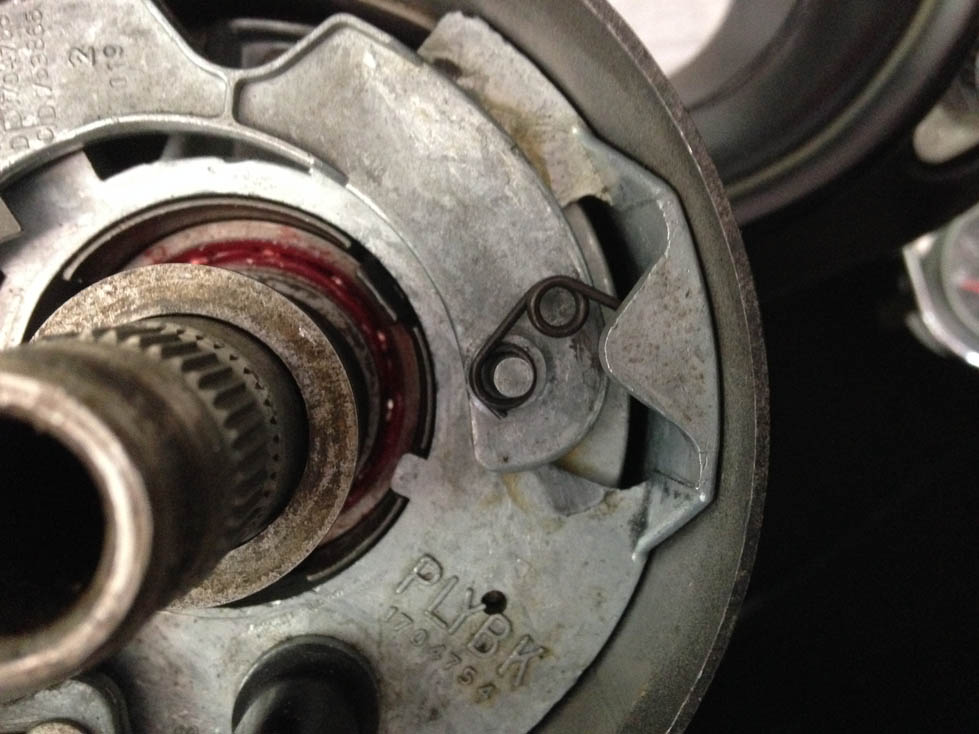

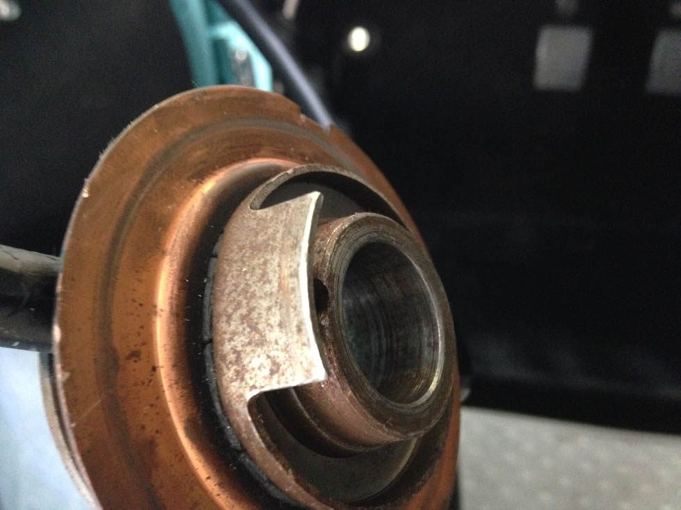

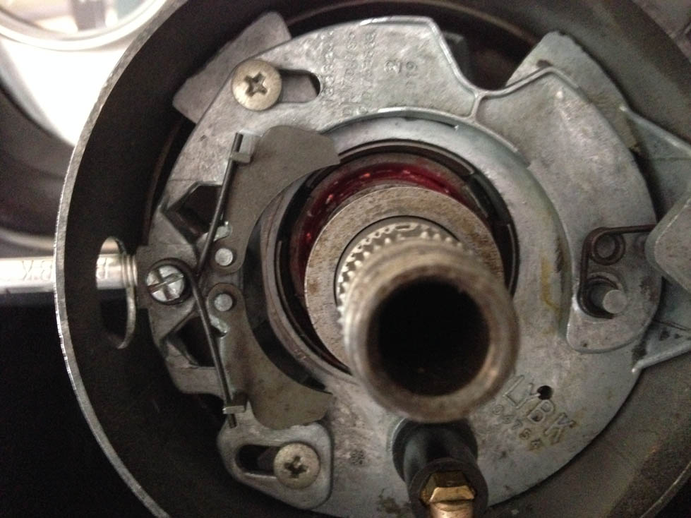

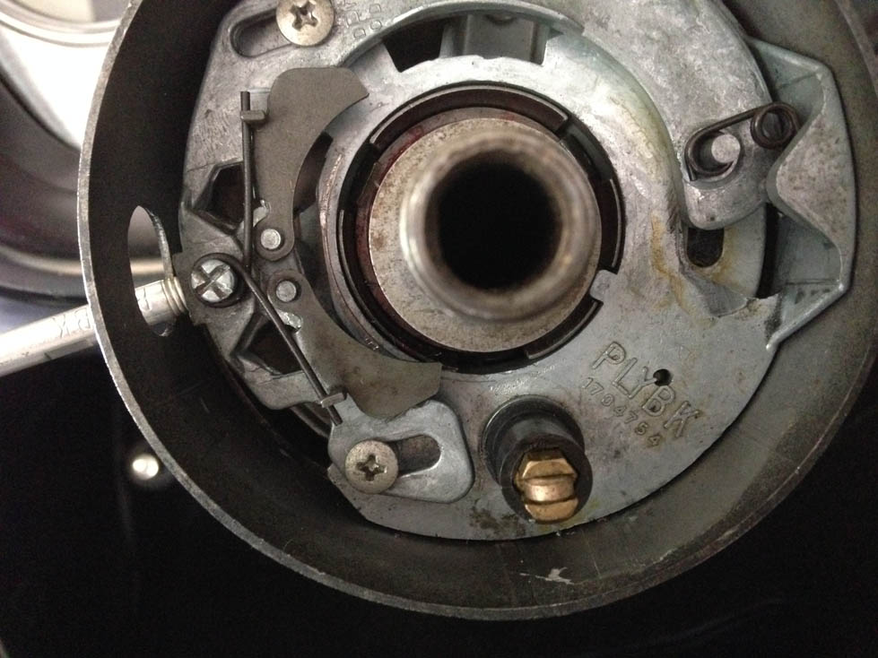

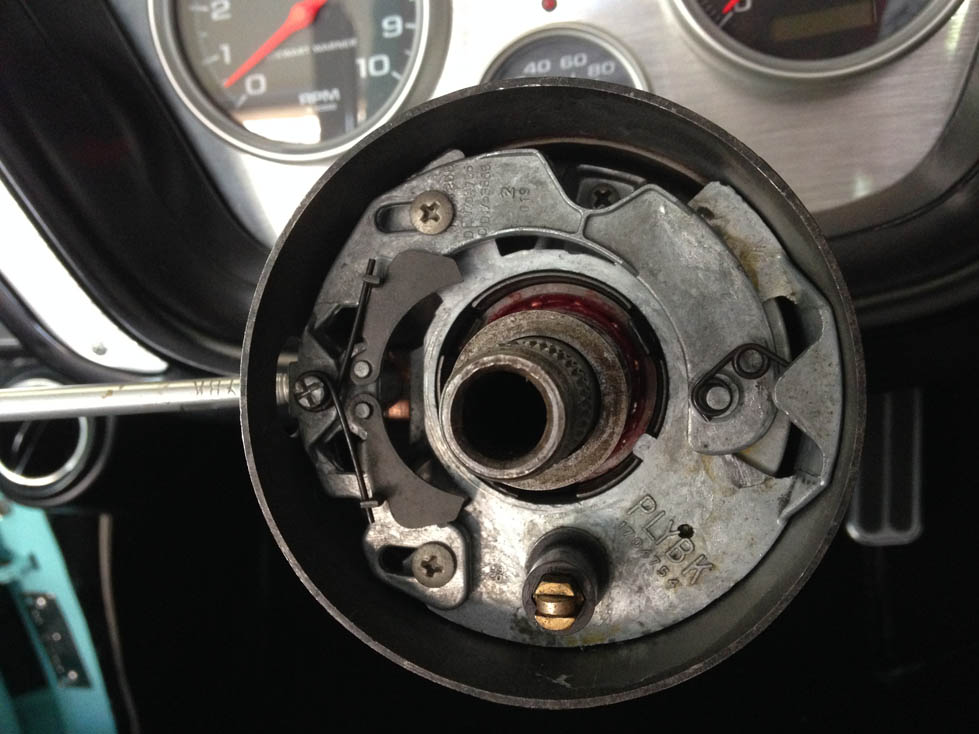

I drove my car today for the first time in over a year after a frame-off restoration and now the turn signal switch does not work properly. It worked fine before I took everything apart. When I move the lever for a right or left turn it engages solidly like it always did, and the lights flash properly. However, when I start to turn the steering wheel it immediately cancels the signal. I pulled the steering wheel and took everything apart but it looks like it only goes together one way. The cam on the steering wheel sits between the two spring loaded levers that look like they should move and let the cam pass by and then pop down so that when the turn is completed and the steering wheel reversed direction to straighten out the car the cam should then hit the lever and cancel the signal. Since it worked before I took it apart I hate to start modifying things to make it work. I did clean and grease everything…maybe that made it move too easy!
I will post some picture and hopefully someone will spot what I have done wrong!

Left Signal
Spring
Steering Wheel Cam
Right Signal
Turn Sig Off
Hi Jim - Every thing looks OK to me. Make sure the actuator protrusion under the brass plate in picture #3 fits into the spring loaded cam in picture #4. That is what actuates the cutoff after you make a turn. Also make sure the steering wheel goes onto the splines correctly, there is an index groove to line up then the wheel goes on the splined shaft. Jim it’s a good idea to grease the contact roller and the brass plate librally with diaelectric grease. I had a roller wear flat one time. Another thing is to make sure the outer shaft cover is seated properly at the steering box. Loosen the clamp down at the bottom of the outer cover and the strap at the dash then with a piece of 2 x 4 give the 2 x 4 a couple of whacks with a hammer to make sure it seats properly because that affects how far down the bearing is on the shaft and for the turn signal mechanism to work properly. All I can say is if that doesn’t work, do like me, try something else.

Dick may have hit the nail on the head- I had the same thing happen in my '57, and found the mast jacket was not seated all the way down. Everything you have pictured appears to be correct.
Over the weekend I examined the column jacket and it was seated at the bottom by the steering box. I then re-examined everything and noticed the steering shaft seemed to be a little off-center to the left. by pulling hard on it I could wiggle it back an forth about 1/8 of an inch. So I pulled the column jacket off the shaft and found that I had place the bearing/shaft shim on the bottom of the bearing next to the C-clip on the shaft instead of on the top of the bearing where it is pushed in by the spring under the steering wheel! I put the shim back on top and now everything works! I am surprised I didn’t notice that the steering wheel felt loose when I drove the car. I guess I am lucky that this is one of the few silly mistakes I have found so far with sorting out the car. :unamused:
