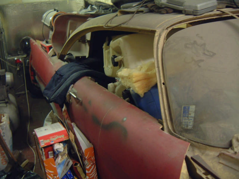

The pic is of the Fury that we looked at. You probably won’t be scared for it! I think you saw them worser
Matthew,
Thank you for the photo. You have already saved time..someone already took it all apart for you! And you have the family Sport Fury to copy as you re-assemble. I hoe you can find a decent storage spot.

Yeah, that saved time. Lots of time!! The engine is also out.
