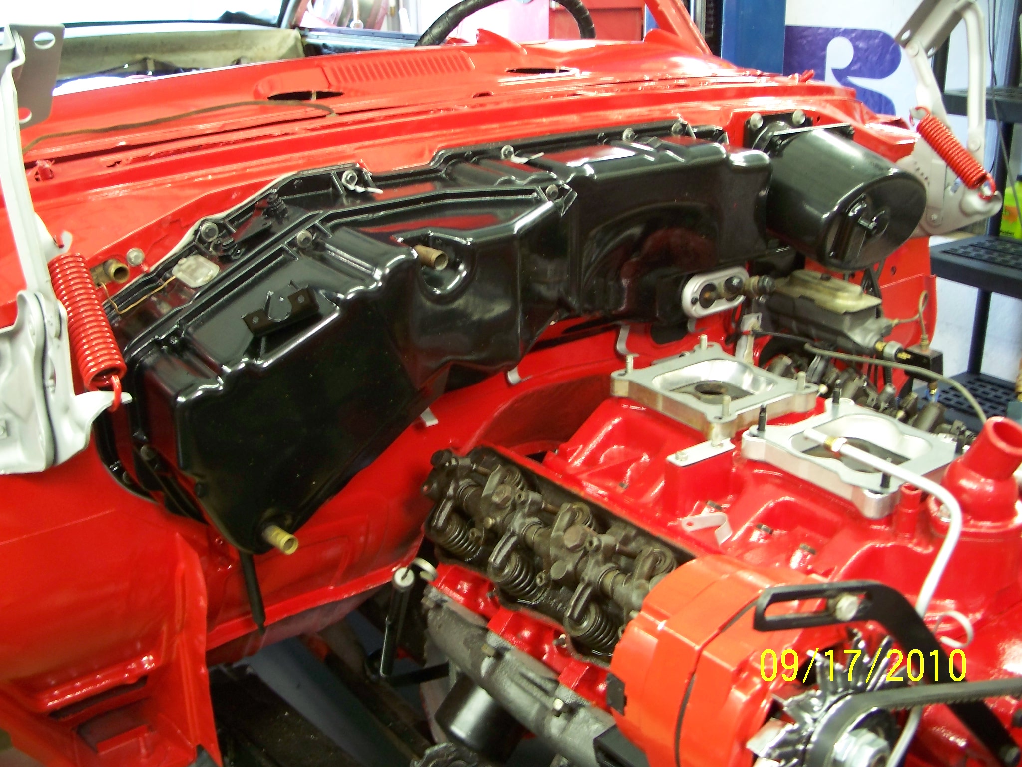

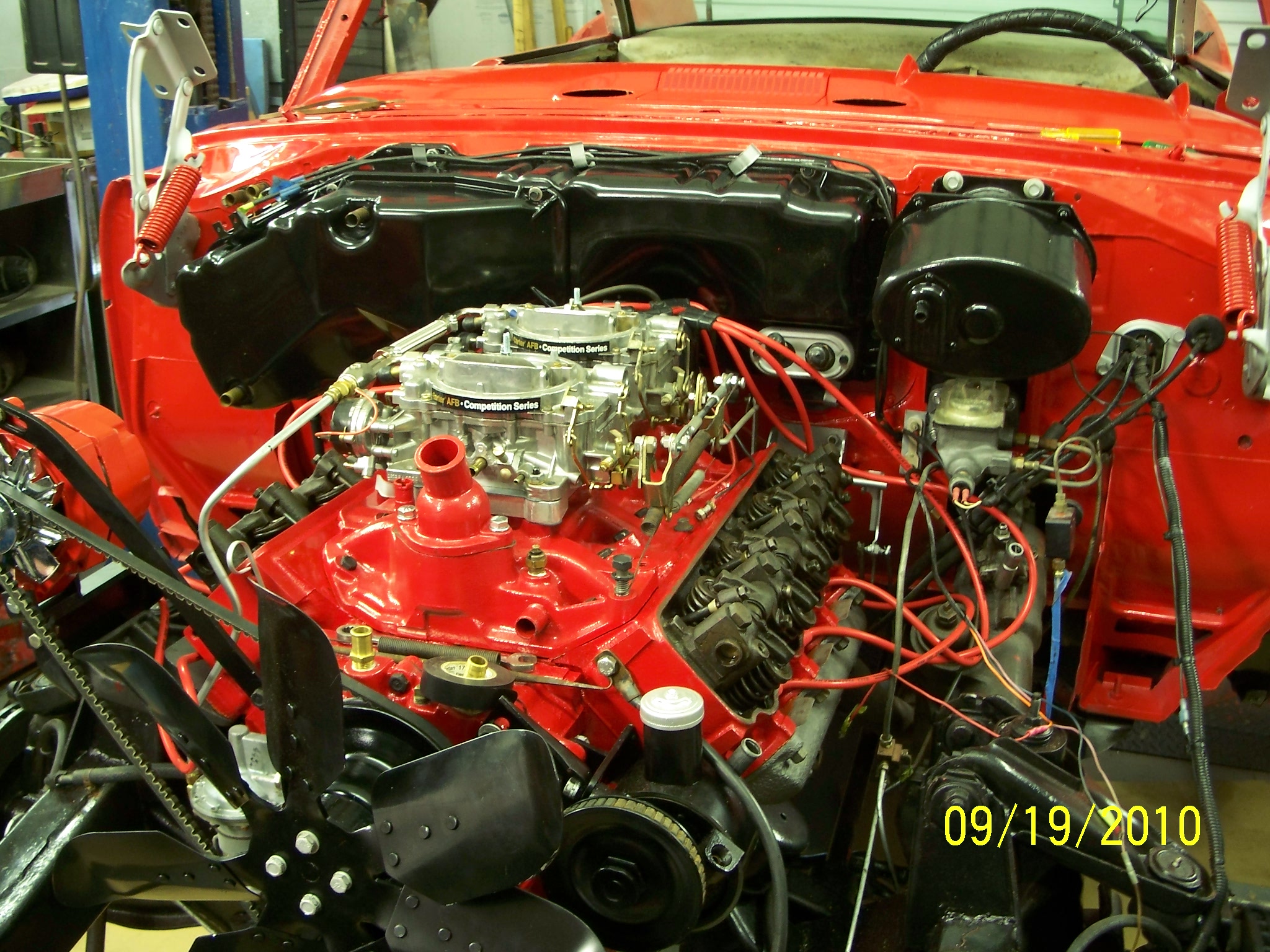

Mark - I replaced a AAJ supplied master cylinder with Hyd switch with a NAPA master cylinderthat I drilled and tapped for 1/8" pipe thread. Works great, I tried installing a non-hyd. switch in my Desoto but gave up, it was a freaking nightmare. You will need the patience and past experience of a John Q. to get it right. See pitchuhs.
AAJ SUPPLIED MASTER CYLINDER.
NAPA SUPPLIED MASTER CYLINDER THAT I DRILLED AND TAPPED FOR 1/8" PIPE THREAD.
NAPA -DITTO-

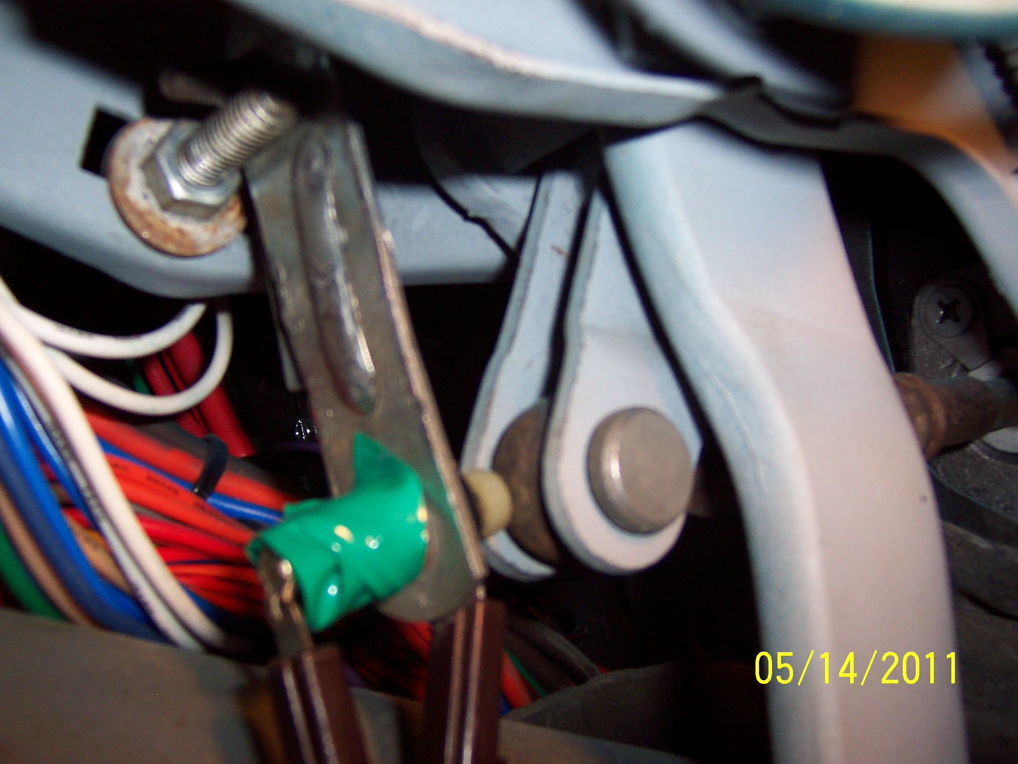

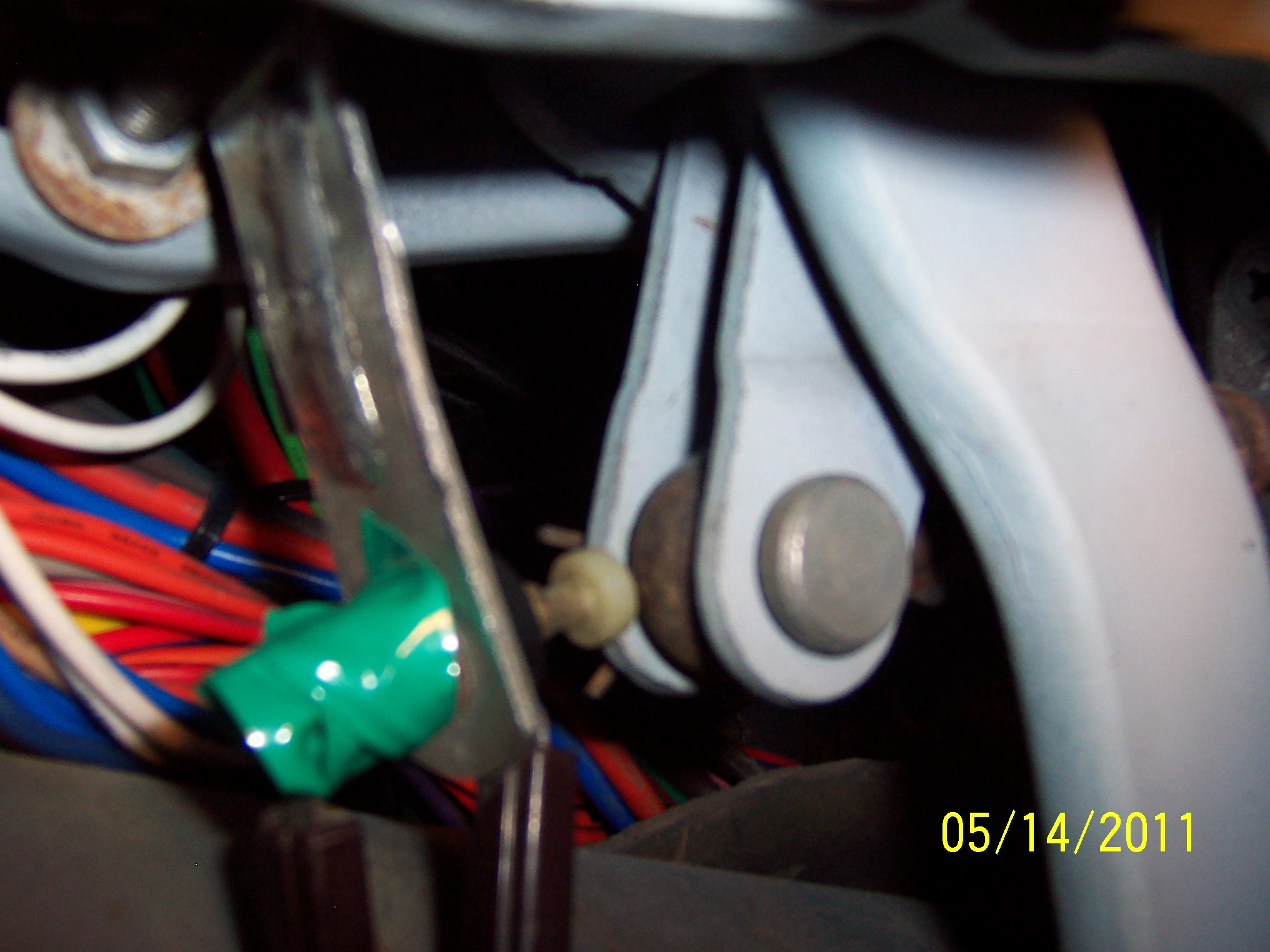

“Obi Wan” Koch flatters me! (I like it!!!) but I took a conventional 60-70’s mopar switch similar to this one. (mine had a angle in it, but I straightened it out like this one on Ebay. Pardon Our Interruption...
I then place in in the middle of the brake pedal assembly so the switch would make contact with the end of the brake rod. I did not drill any holes at all. I used small nut and bolt assembly to anchor the brake light swich assembly and then used another nut/bolt assembly right behind the switch to give it an positive pressure of the switch end so it would not deflect out of alignment.
Again no holes drilled and real simple to do. I will go out an take a picture as best I can of how mine looks installed so you can see what I did.

mark, though it took a while to remember to take these pictures, here is my 60-70’s mopar brake switch installed on my convert. I use all existing holes for mounting the bracket. The bold behind the metal braket is to keep pressure of the assembly on to the knob of the MC push rod as it pivots. That area was pefect for it since it was slotted anyhow.
The braket I took had a 45 degree bend to it and I hammered it straight and the fromed a 90 degree bend down to the pivot head of the push rod.
Hope this helps even though it is overdue to you.

Mark, those type of switchs are activated when the switch is allowed to move out of the depressed position. As you brake, the swich is then allowed to be un-depressed and the brakes circuit is closes the electrical circuit and turns on the rear brake lights. Take your foot off of the brake and the plunger is depressed again by the knob of the push rod, opening up the circuit which tuns off the current.
In sparky terms it is Normally closed switch, but by adjusting it to have the plunger pressend in (with no brakes applied) the switch is then opened.
