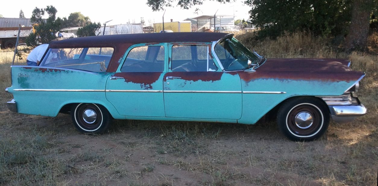

Just wanted to say hi and post a few pics of the new project.
A bout of weakness on Ebay and she is mine.
4 Dr Suburban Wagon-
She runs and is getting new disc brakes up front and new power assist via AAJ Brakes in Portland
(Roger is a great guy and a pleasure to work with).
Should have the lines replaced tomorrow and the rear cylinders as well. Hopefully on the road for a test drive friday or sat.
Going to leave the paint as is and redo the interior to original specs (more or less) and rebuild the engine this winter.
Plan to use her as a daily driver until the snow starts to fly.
Will post more pics at things move along.

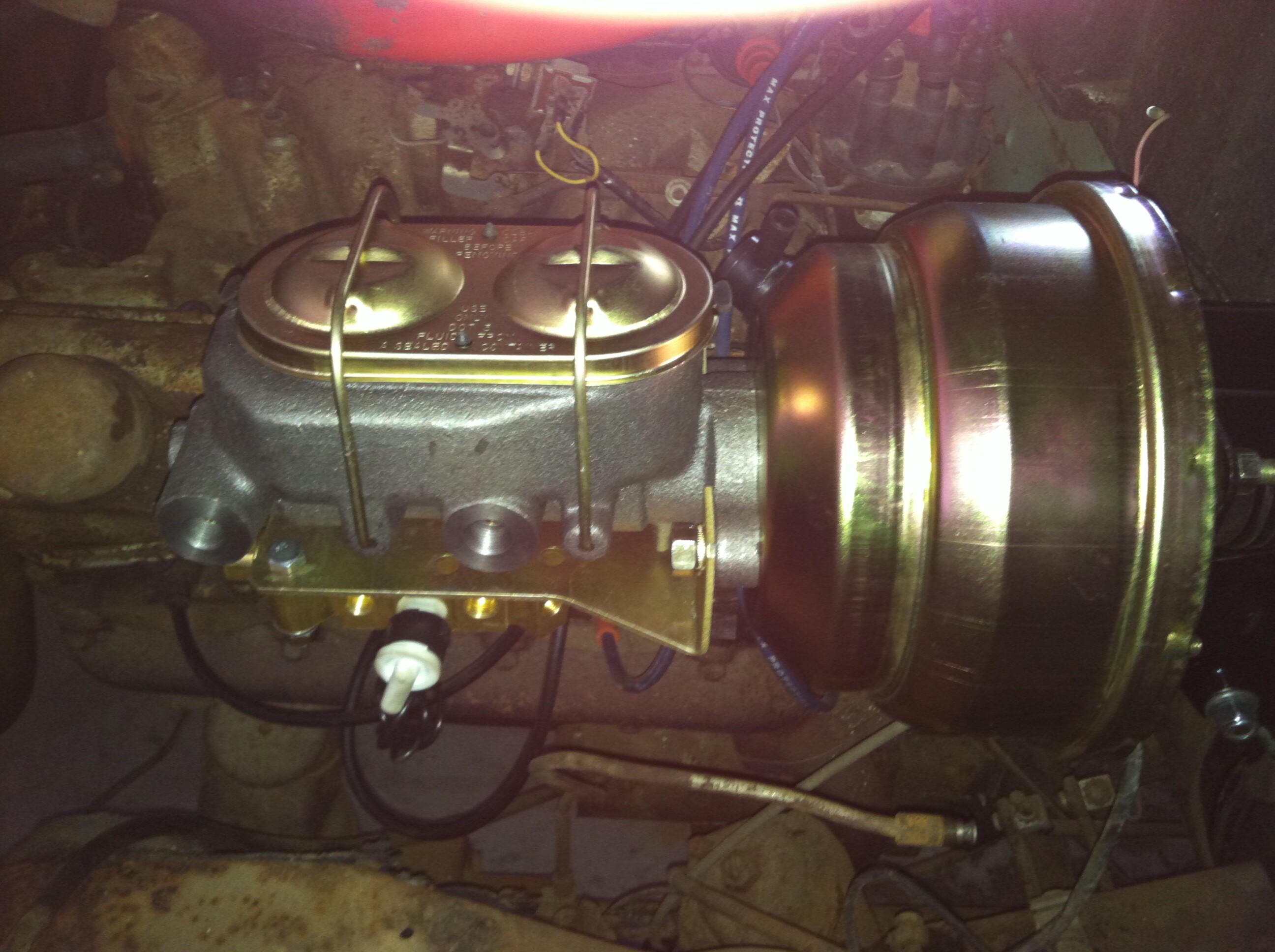

Welcome to the site Jaydogg - Nice station wagon, good luck with it. The power brake booster and master cylinder in the picture, can you tell us a litte about it, how it’s mounted, any alterations required, etc., etc., etc. I see these units on ebay quite frequently but always have been skeptical about using one.

The disc brake set up and power booster is from Roger at AAJ Brakes in Portland Or. I originally got the disc brack conversion brackets from him and the rest of the parts from NAPA etc. I got the power assist unit from him as well as the dual master.The power assist comes from MBM brakes and the dual is a corvette master cylinder. It comes with a bracket to attach to the firewall in place of the original single master and more importantly a piece that slips right in and attaches to the brake pedal. It has a bracket with the proportioning valve underneath it and all the hardware to plumb it. It took me an hr to get it all in and fits good. I have the rear lines to do today and get it bled and I will hopefully get it on the road next week to test them out. Gas tank is rusty so taking it to shop today to get fixed :angry:

Welcome to our site. Also remember the car on ebay as well as the model. She almost got me bidding as well. I’m also curious how your booster set up works out. I could never envision how the pedal activated the booster/mc. Enjoy!
