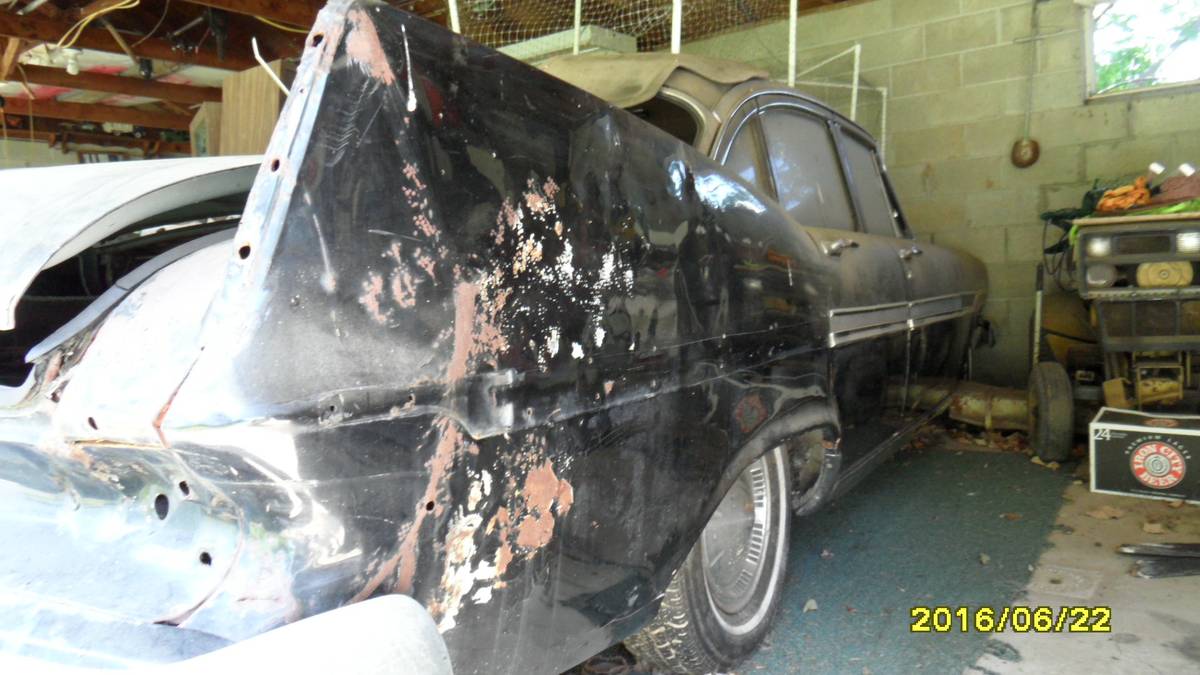

Almost time to start my latest project she was hit hard in the right rear i tried to save the right quarter but it was damaged beyond my ability to fix it so i found a Nos quarter panel and trunk lid
Just the way i found her

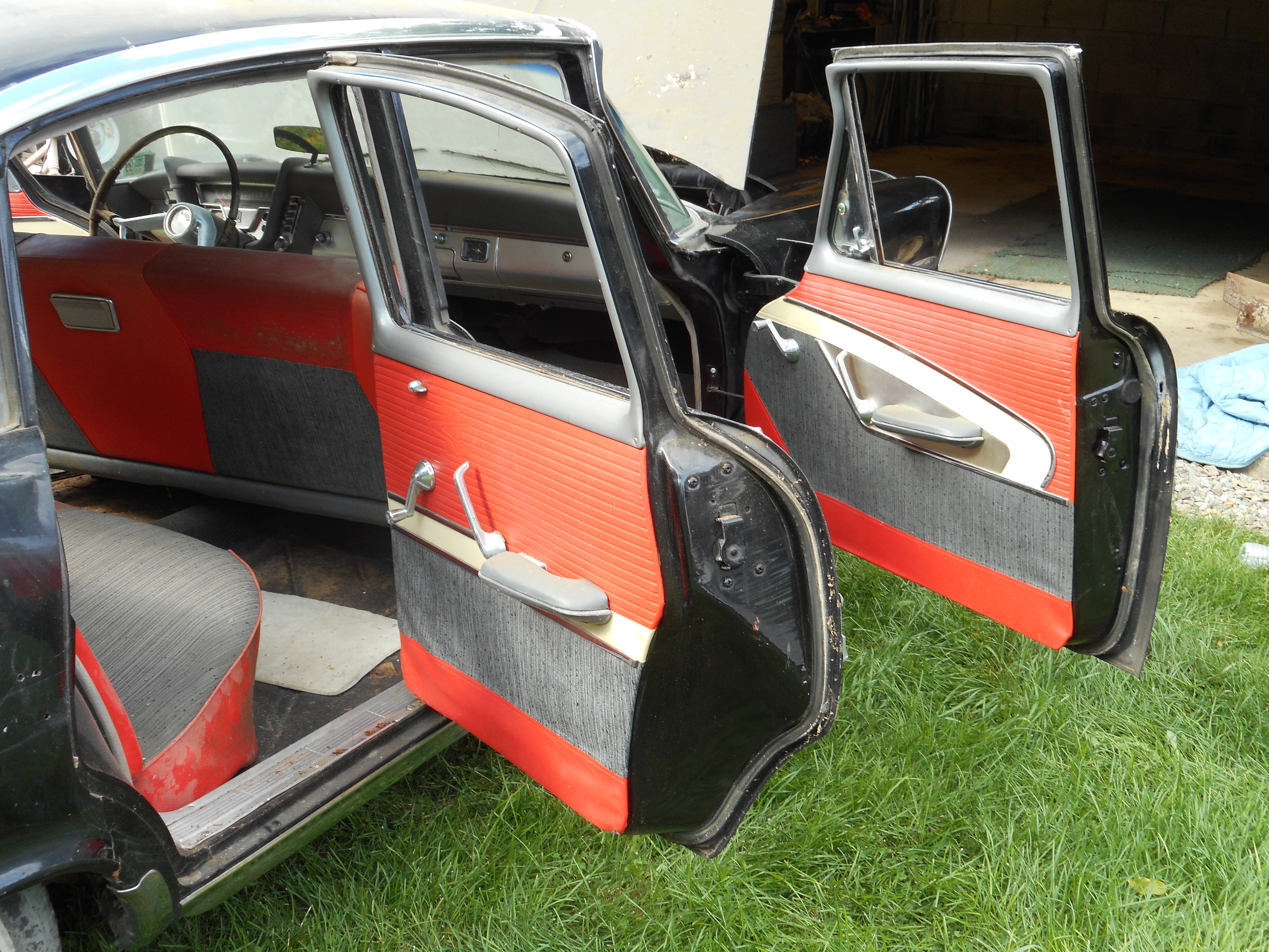

only medium wear on the drivers seat bottom

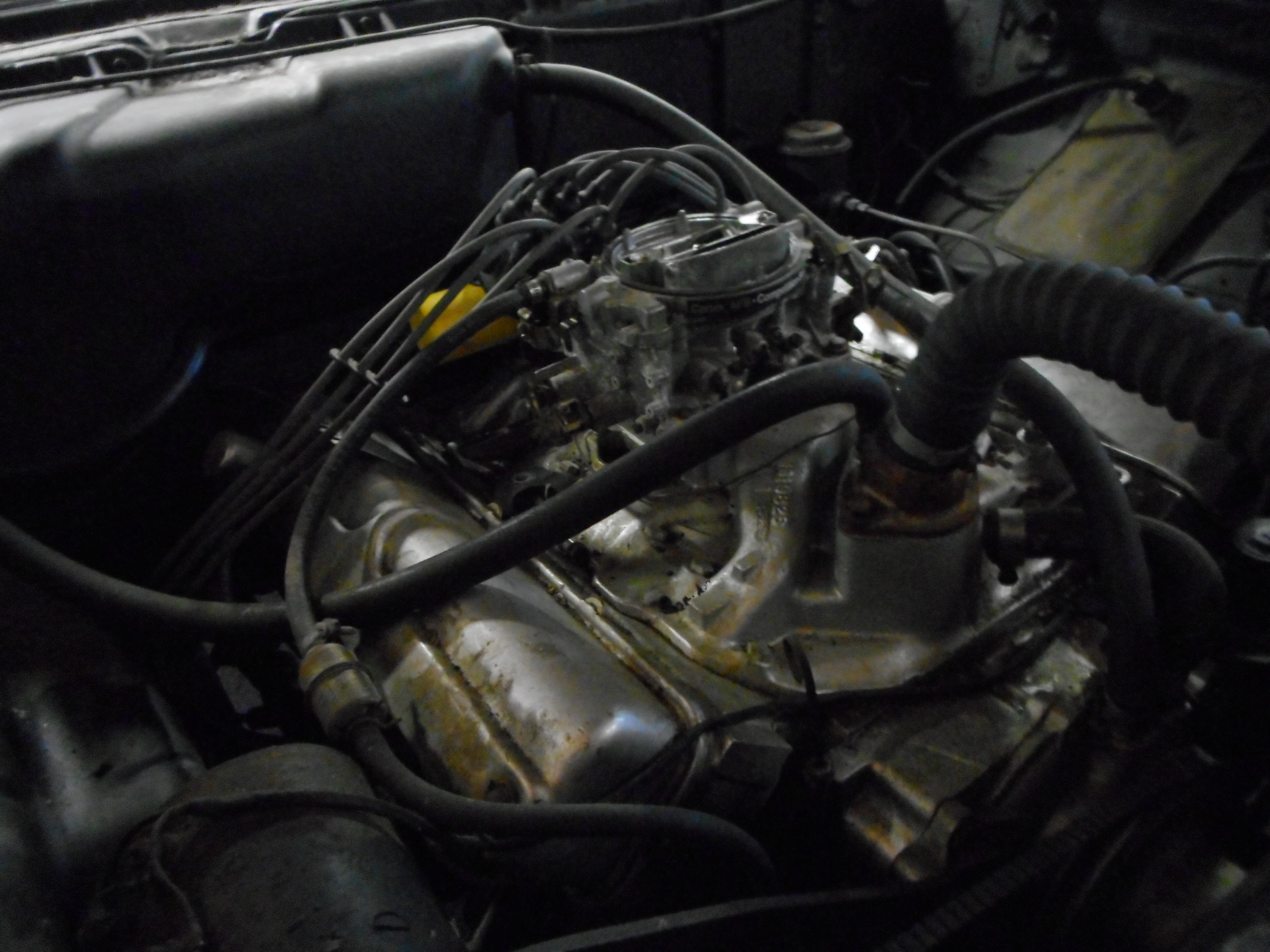

Rebuilt motor and transmission

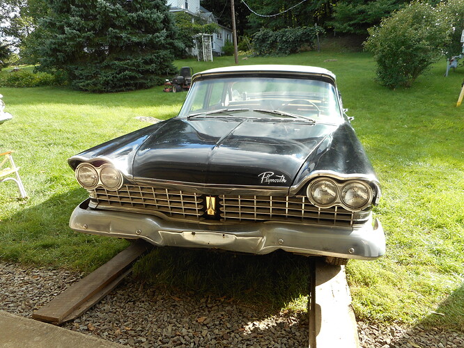

Got this from Randy Gardner Jr
Got this from John fowlie

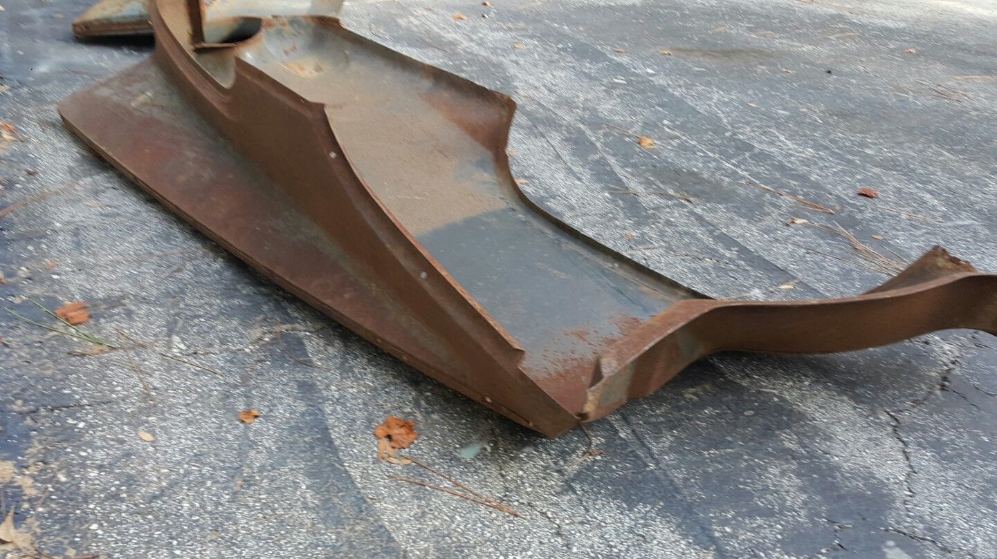

It looks a lot better in this pic , but it is a1/4 inch short of were it needs to be due to being crushed

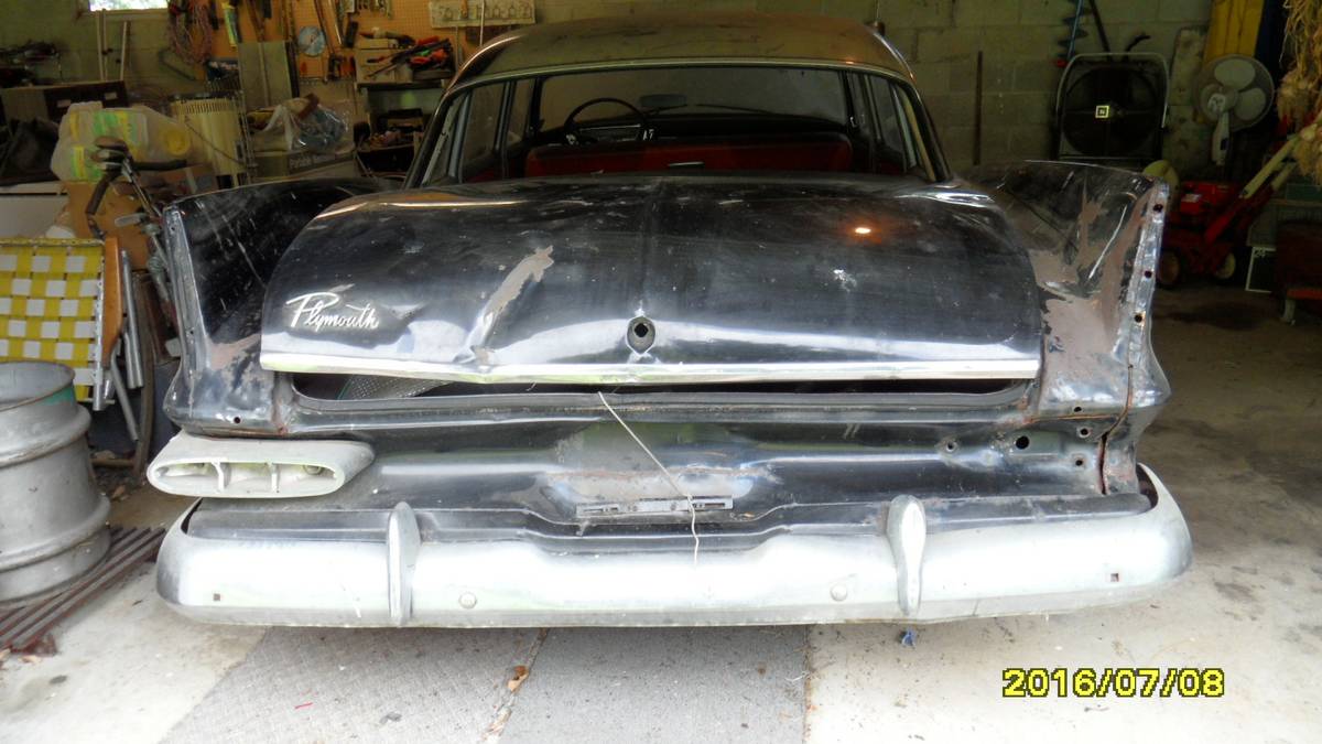

As you can see the trunk is bent every which way from Sunday also
That interior looks like mine did and mine was originally iceberg white. A heads up if you remove the doors do not forget to PRICK PUNCH the hinges for later location reference when they get re-installed.I forgot to do it and 4 doors is twice the frustration!! You are not too far from me as I see. Good luck,hop on the site if you need to know something. Mark
