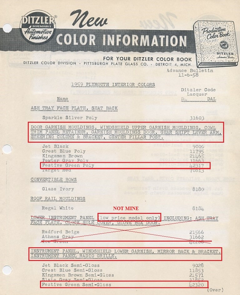

I’m beginning to think none of these exist anymore, and am hoping someone can prove me wrong. The exterior chips are plentiful but I haven’t been able to find any for the interior after searching for a couple of months now. I have two colors to match up on a Belvedere project car: Festive Green (Poly and Semi-Gloss) and Shell Green. I can get by with the Festive Green parts I have, but I don’t have any Shell Green. If someone has an interior item that is Shell Green (not badly faded) I would like to buy that as an alternative to a paint chip chart, but I would much prefer the chart since I’ll be starting a SF project later this Spring and don’t know yet what I’m going to need for that one.

Both are good ideas John and Roger. The garnish molding is actually Festive Green, and basically the package tray (that I apparently am going to have to make myself) and radio speaker grille. Maybe Big M can come up with one of those in the right color, but even if so it will have no doubt faded considerably being located in a spot subjected to direct sunlight…

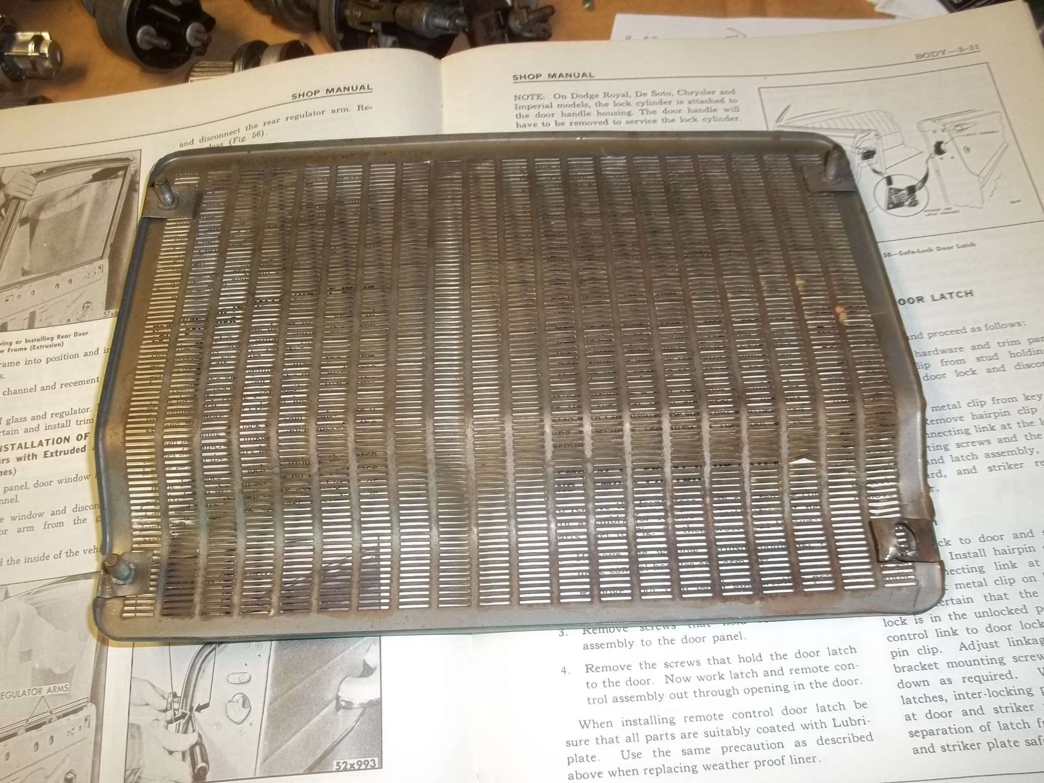

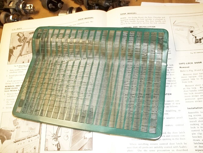

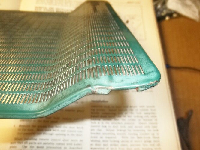

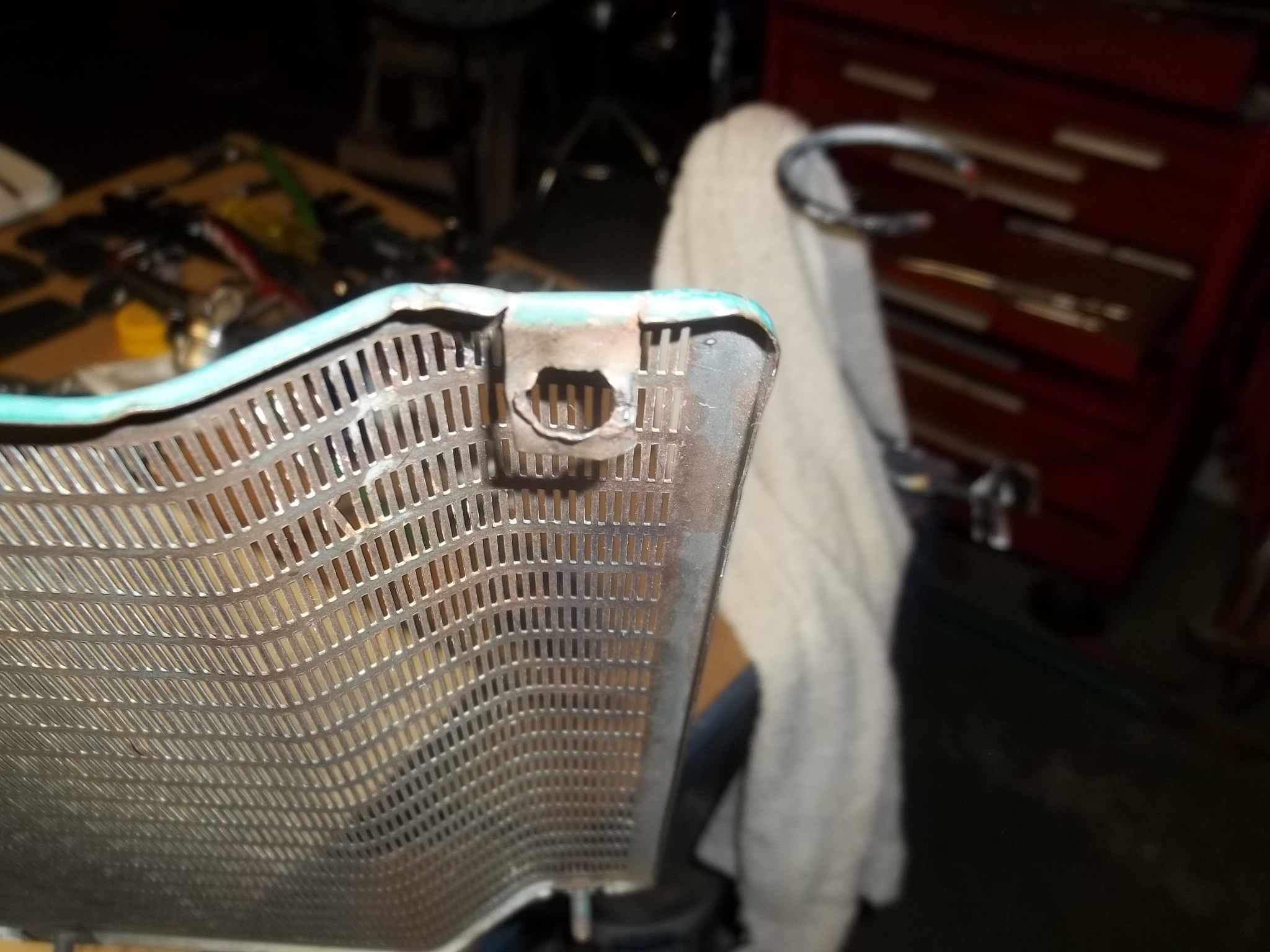

Jim - This is the best I can do. Used GREEN speaker grill (dare you be so luckey it’s the right green) with slight damage on one corner that you could repair easily and one bolt missing on bottom. That is, if you need the grill??? $10.00 bucks plus $6.00 bucks shipping. Click on picture to enlarge.

Dick’s speaker cover would be pretty close too other then it was in the sunlight for a long time. All of these would be a good close match. If you are into series Concours Points, not even a show judge has a chip that he can compare to what you would paint on your garnish molding or dash frame.

Dick: SOLD. Do you have a PayPal account or should I mail you a check? I’ll PM you my address.
