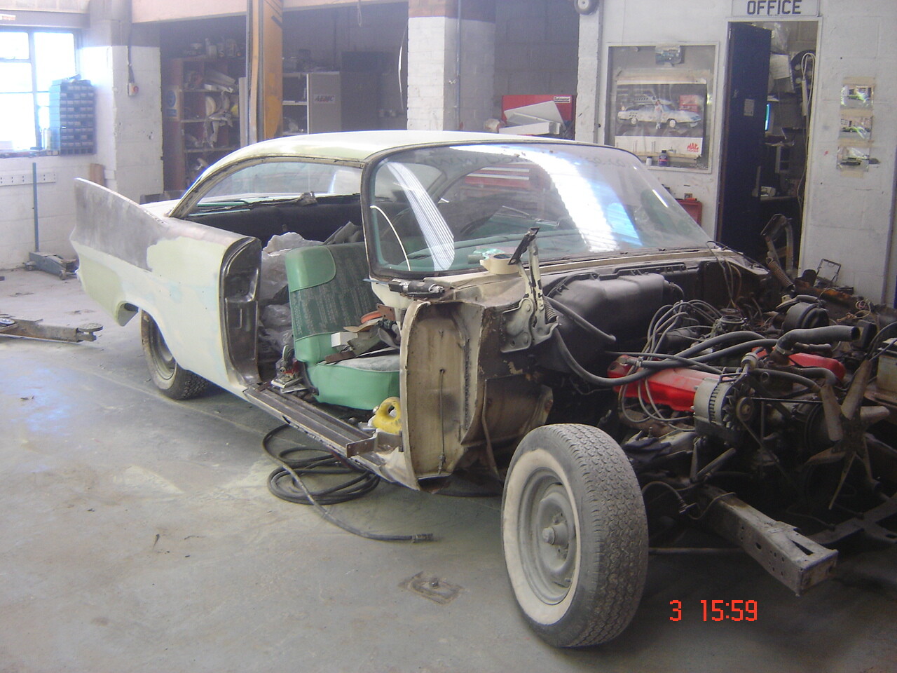

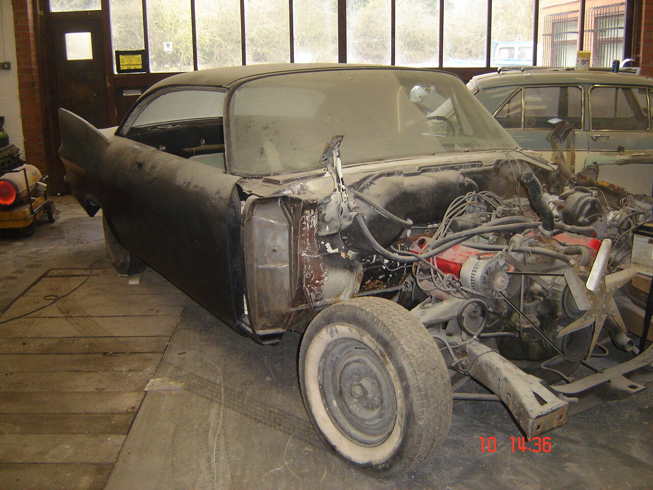

My car.
The cars a bit further on than this so i will get some more picks.
HERES ANOTHER :slight_smile:

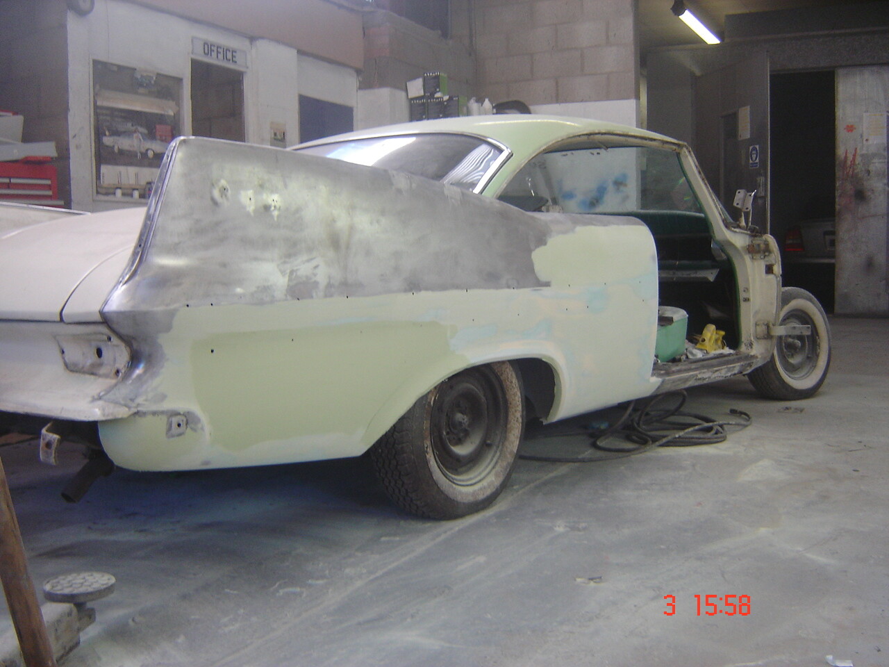

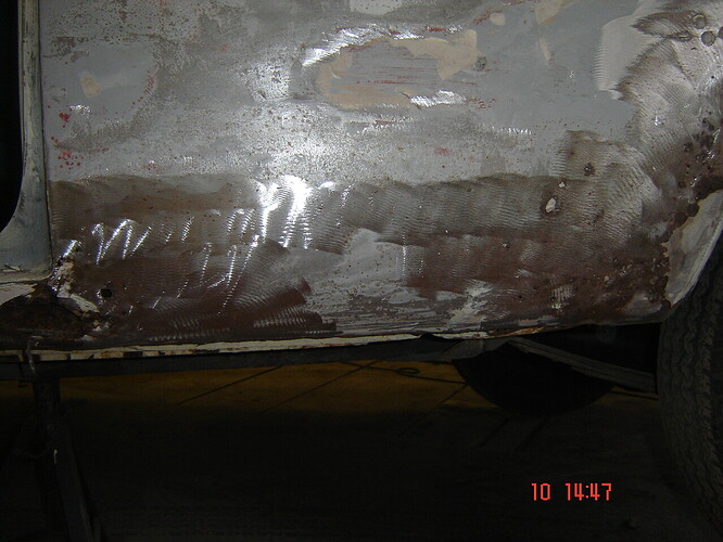

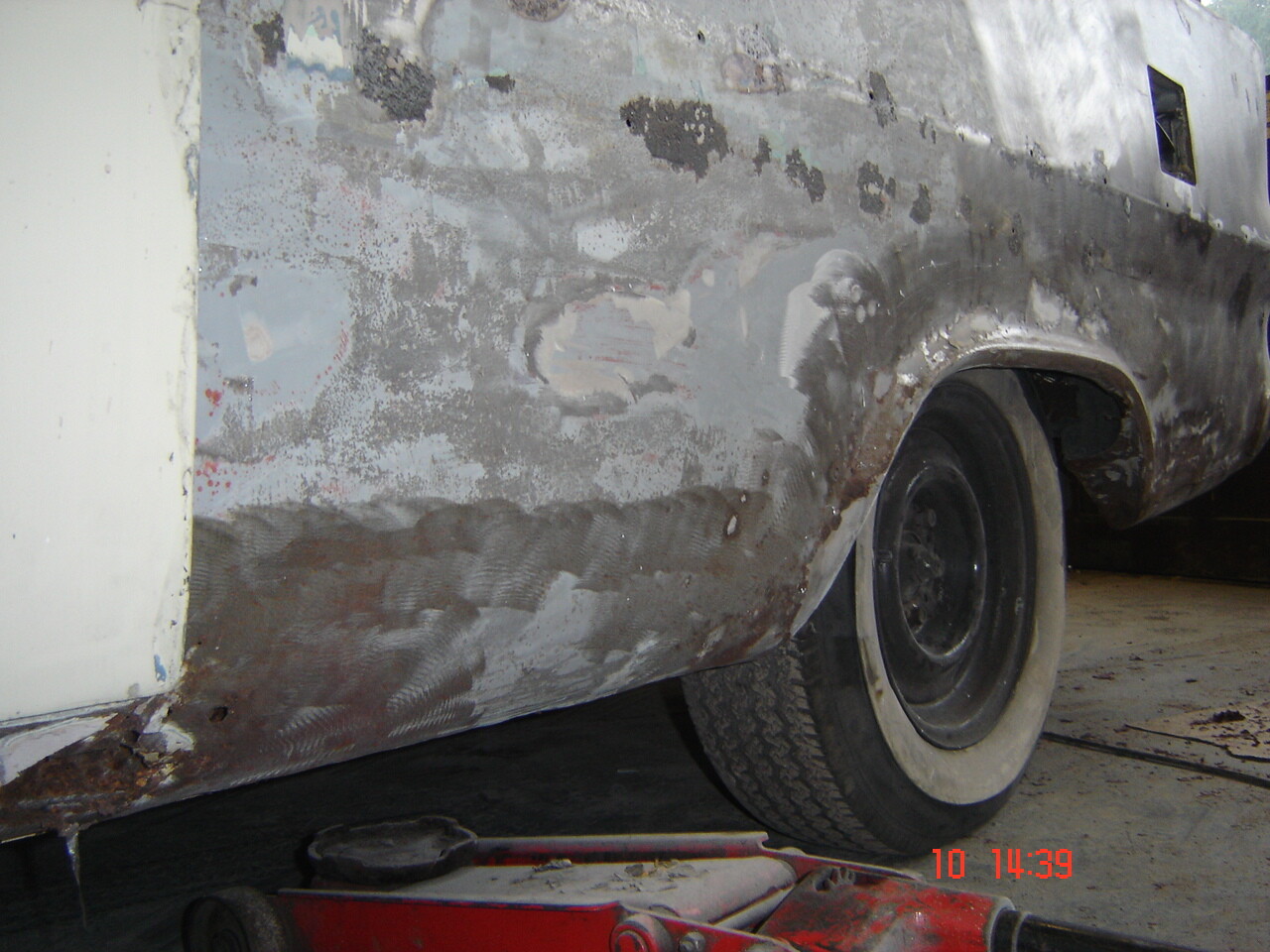

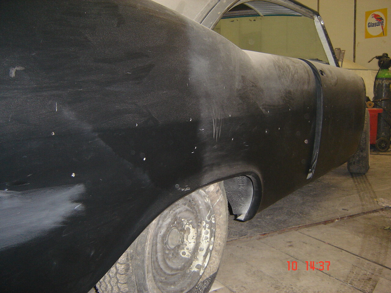

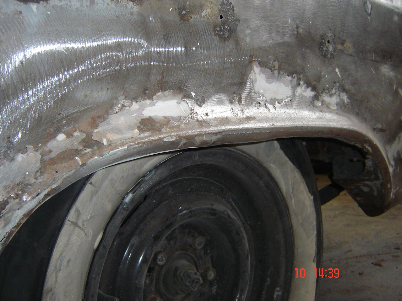

This old car is taking some ironing out AND SOME SERIOUS METAL WORKING!
It didnt look too bad till i started taking the paint off!

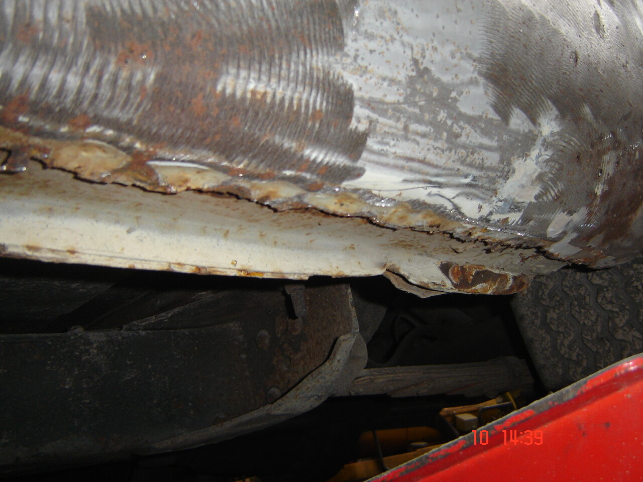

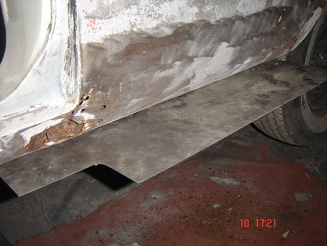

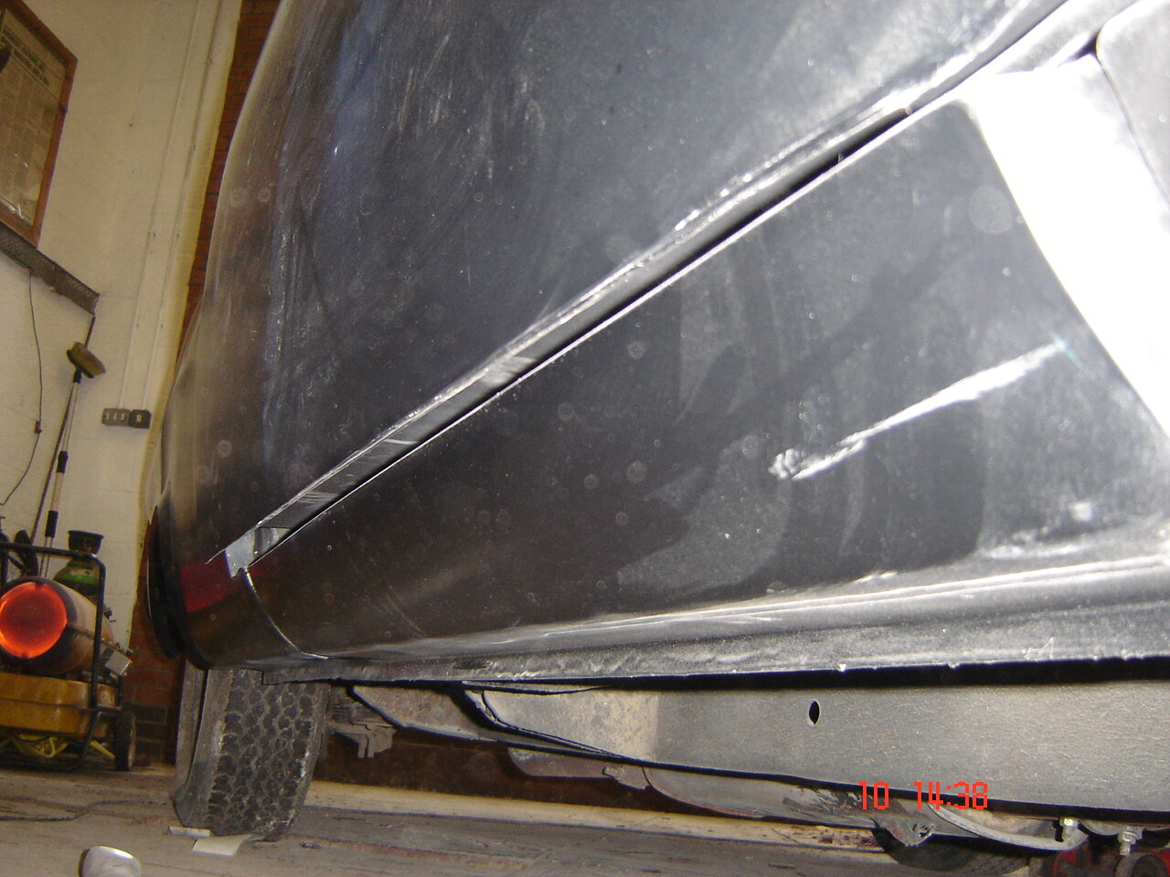

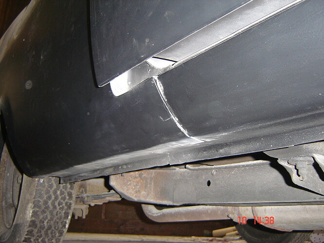

I had to remake the rear wheelarch, the trailing quater, about 12" of the lower quater before the wheelarch then i found all the structure in the lower quater was dust and someone had cut a 3 foot hole in the rocker pannel and glued a horrid bit of steel in its place with sealer so that meant remaking the sill!
Then i started poking holes in th inner sill so i had to remake that so now i have the front floors to contend with and the webbing under that!
Does anyone know were i can get this webbing?
WHAT A NIGHTMARE! :open_mouth: I will keep you all updated on the cars progress from now on, talk to you all later.

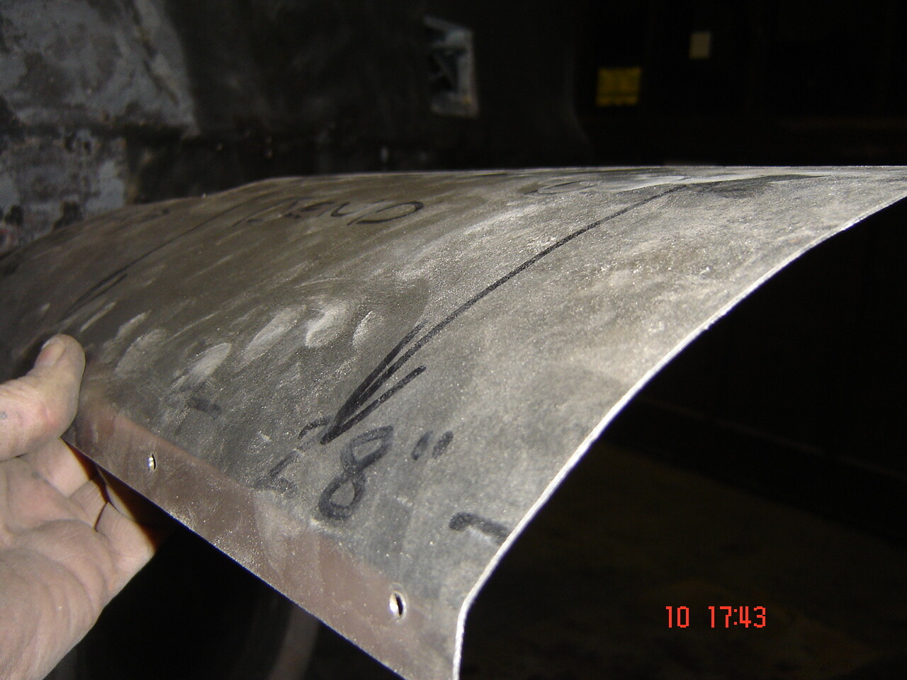

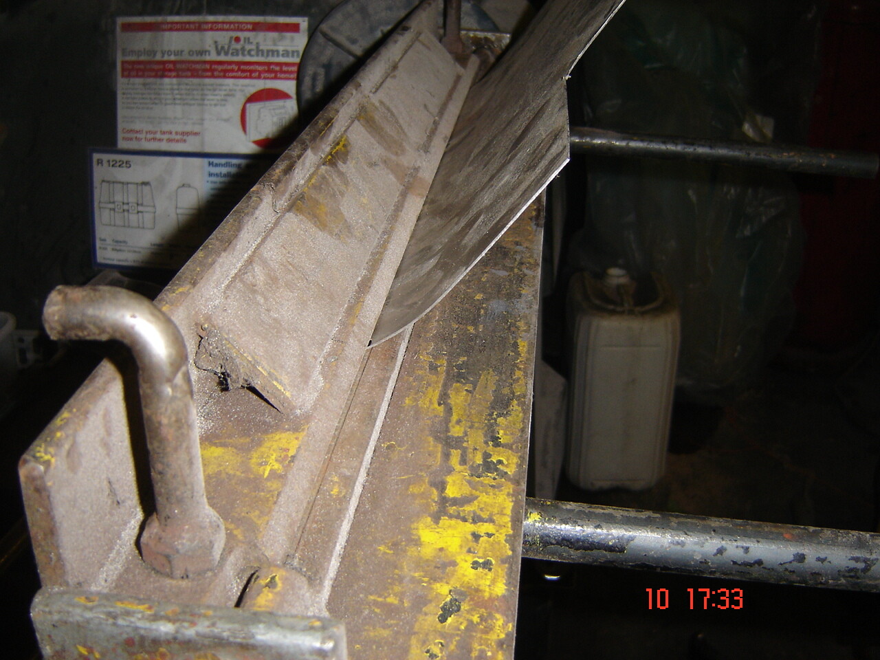

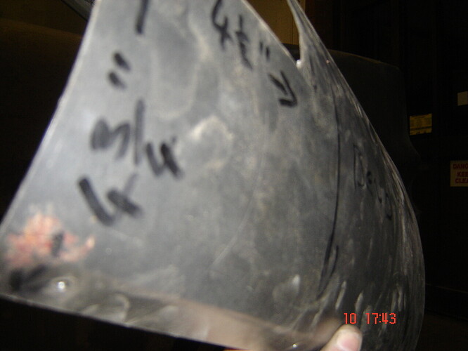

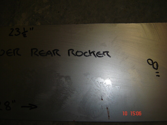

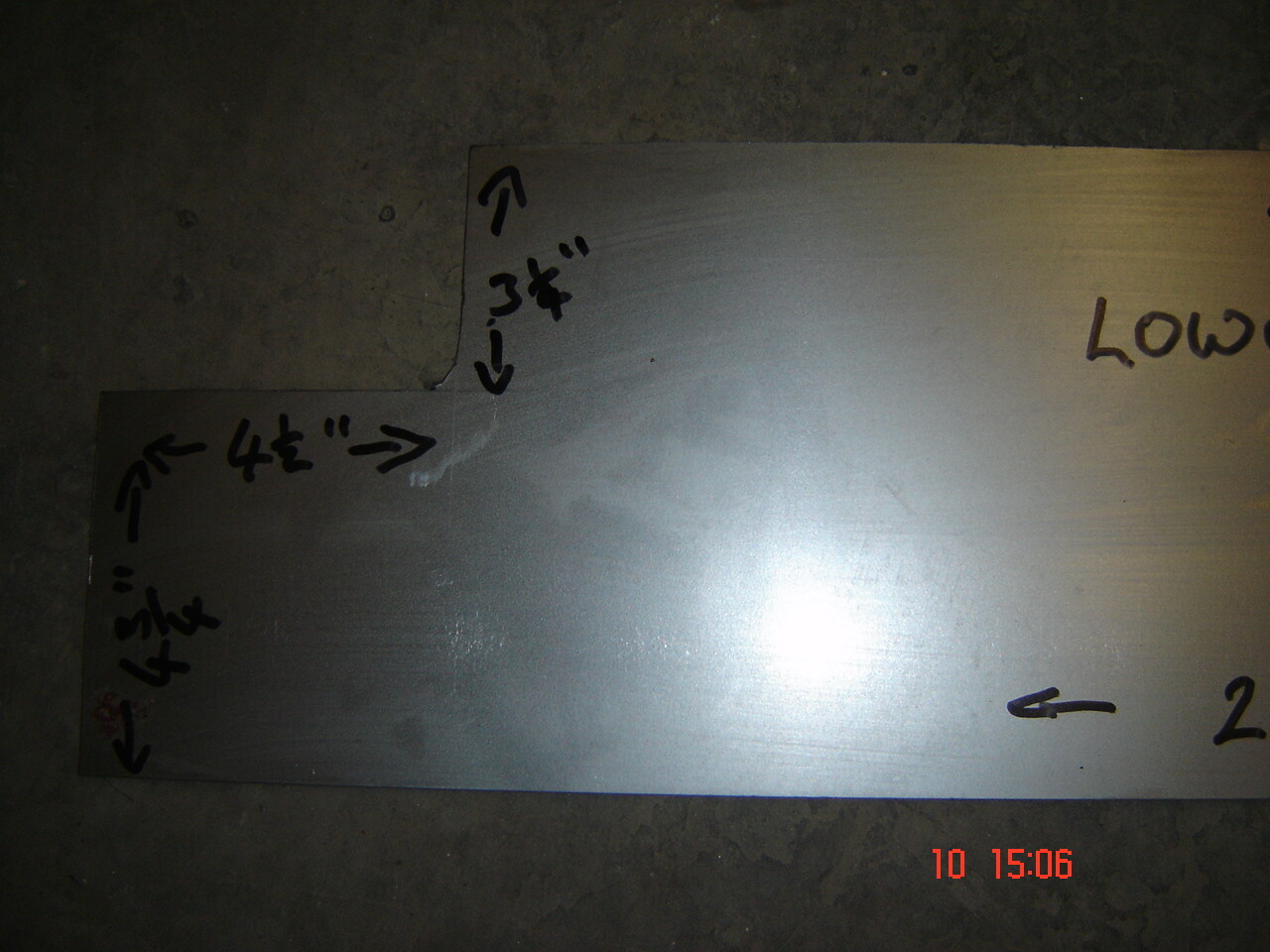

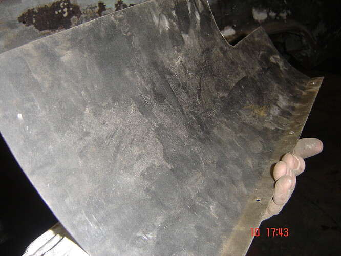

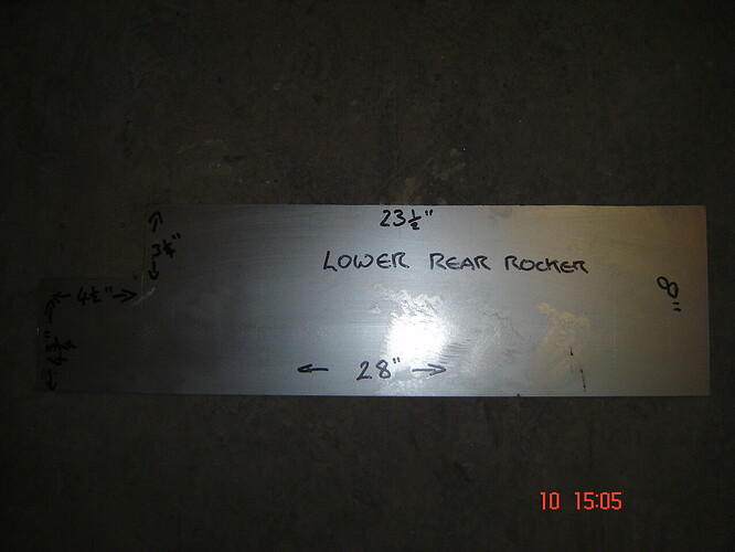

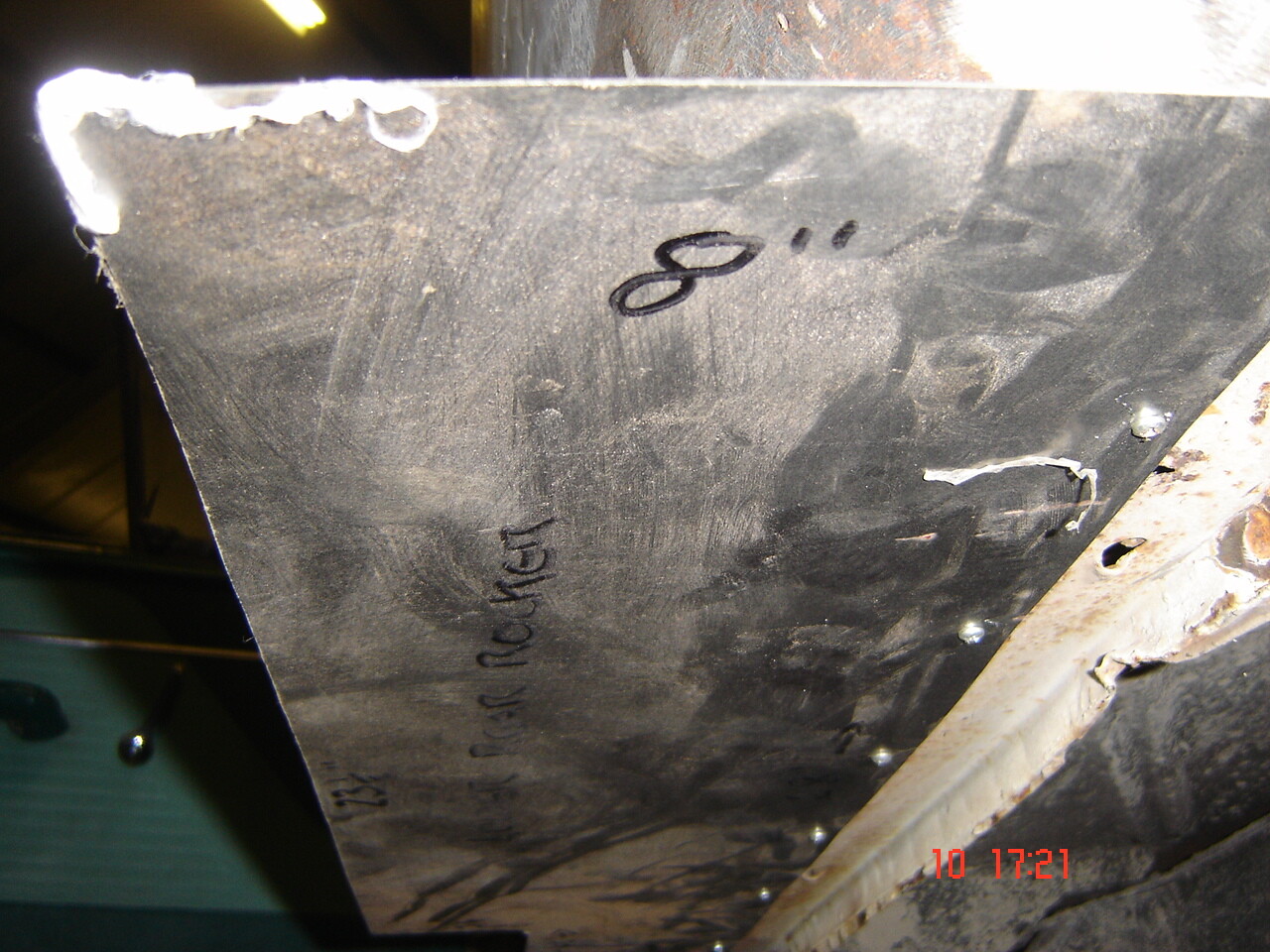

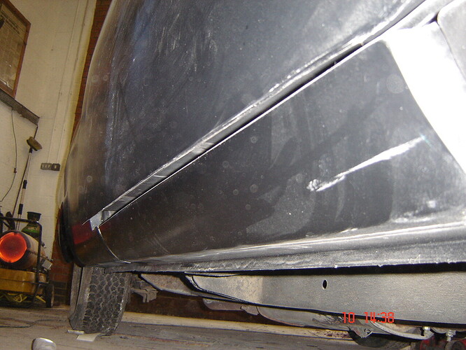

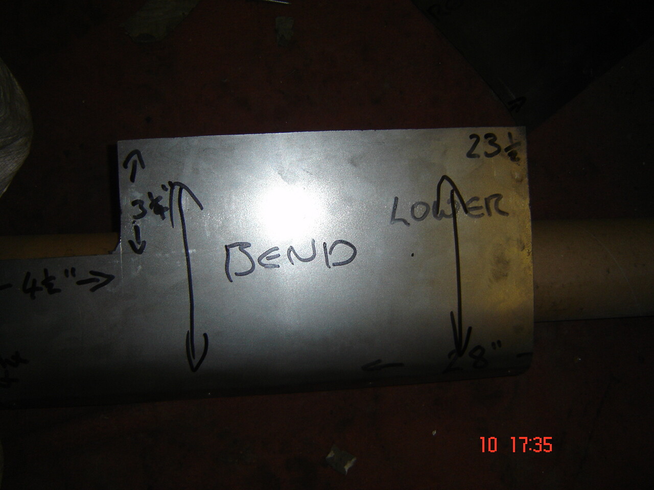

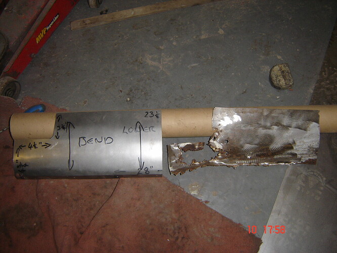

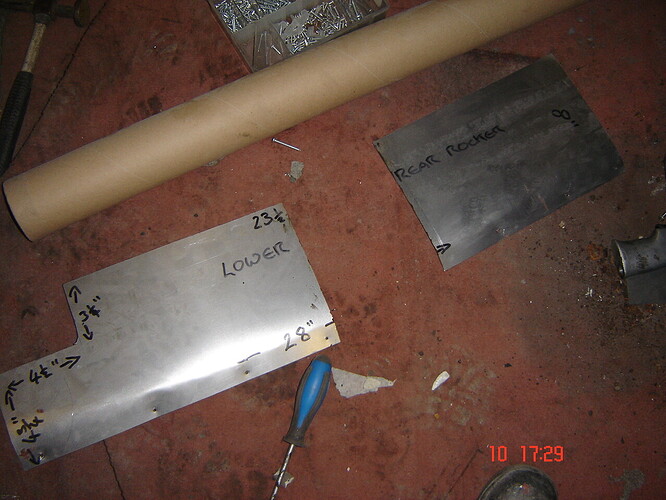

Heres some picks taken today, showing how i formed the lower quater pannel i will post more good stuff as i go along.

I am trying to show that making certain pieces of a car is not really hard, its time consuming more than anything, :smiley: so anyone with half a brain can do it, if anyone needs advice on how they should go around fabricating with basic tools i will try and assist!. not too many 59s in the uk i would say less than ten so its really worth the effort to get this old car up and running again.
