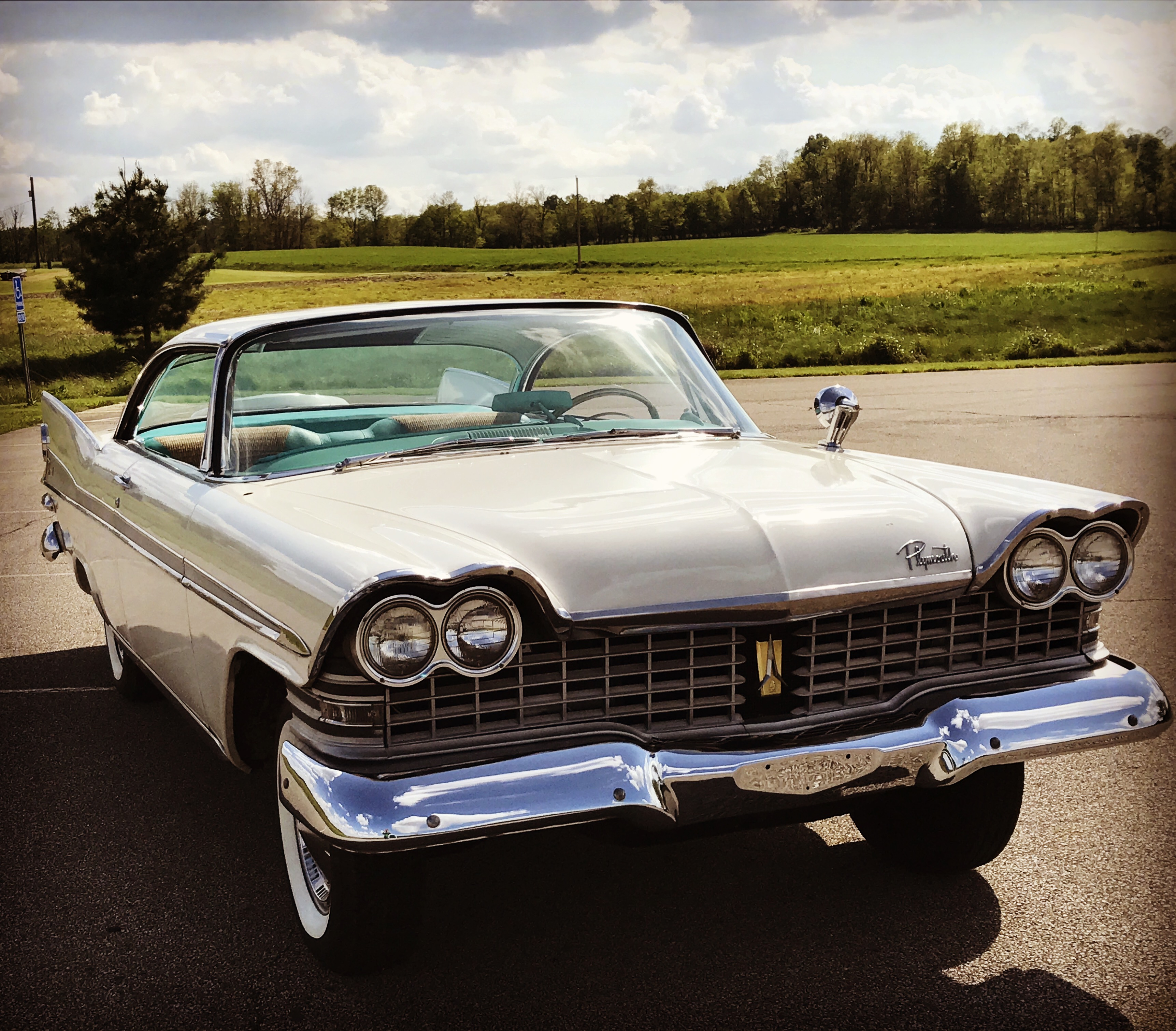

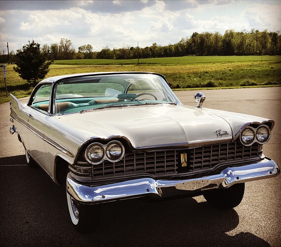

New member here- I actually bought my Sport Fury in spring 2017, just now joining here. Not new to the Forward Look, I once had a '57 Chrysler Saratoga 2-door hardtop and a '56 Dodge Coronet Lancer 4-door hardtop. Looking forward to spring and getting my Plymouth out- '59 has always been my favorite! Oh, and I am dire need of the lower front bumper stone guard, the one I have I’ve been told can’t be repaired… Anyway, glad to join and more pics this spring.

Hello and welcome Steve!
That is one gorgeous SF!!! I love the color combination and she looks to be in fantastic shape. Looking forward to seeing some more photos.
-William
Welcome aboard Steve! Yes, a classy looky 59SF, indeed.

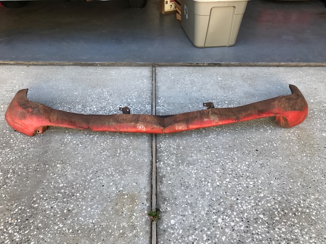

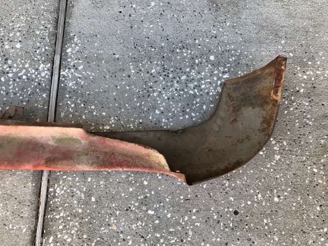

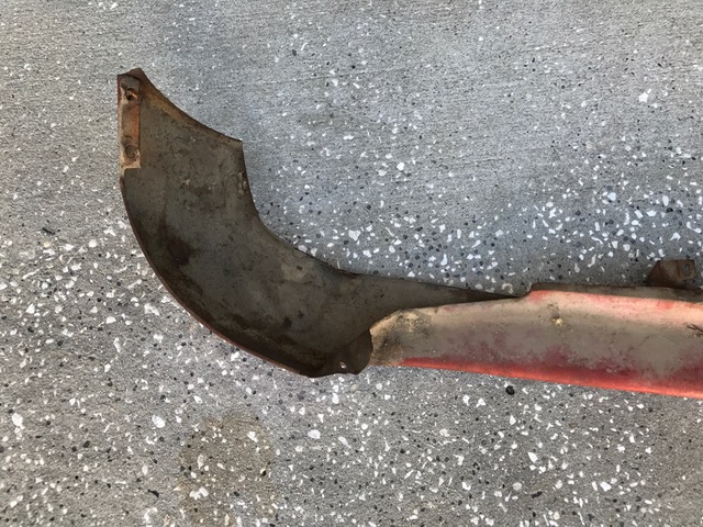

Oh wow, that looks great! I do have one, it is in similar shape. I took it to the guy redoing my air cleaner and he said it was in too bad a shape, maybe I can find someone else to do it. Here’s some pictures of mine.

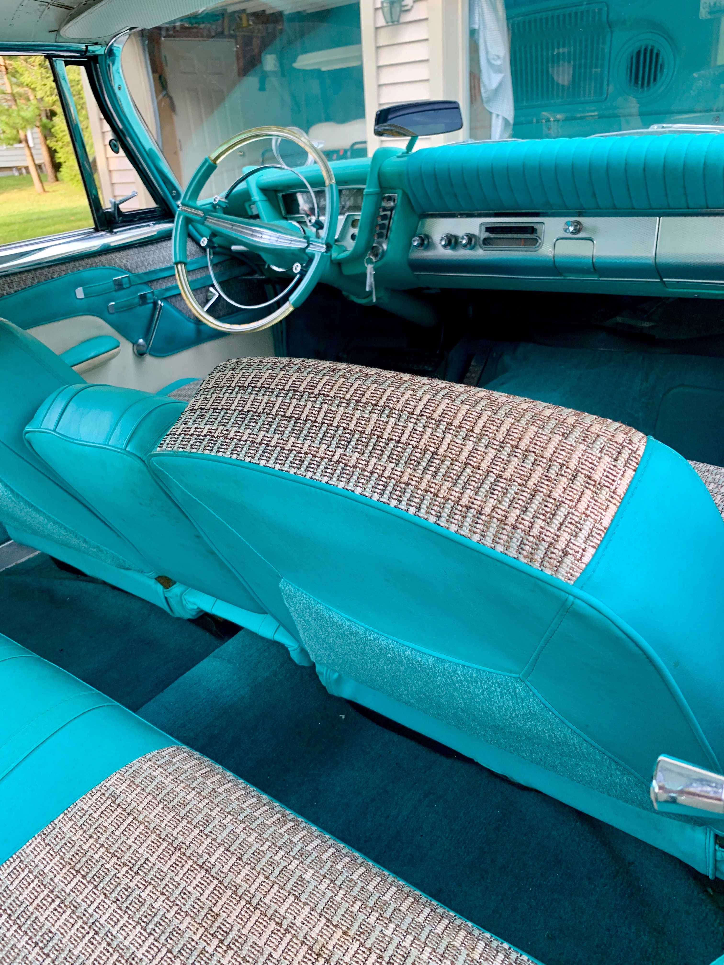

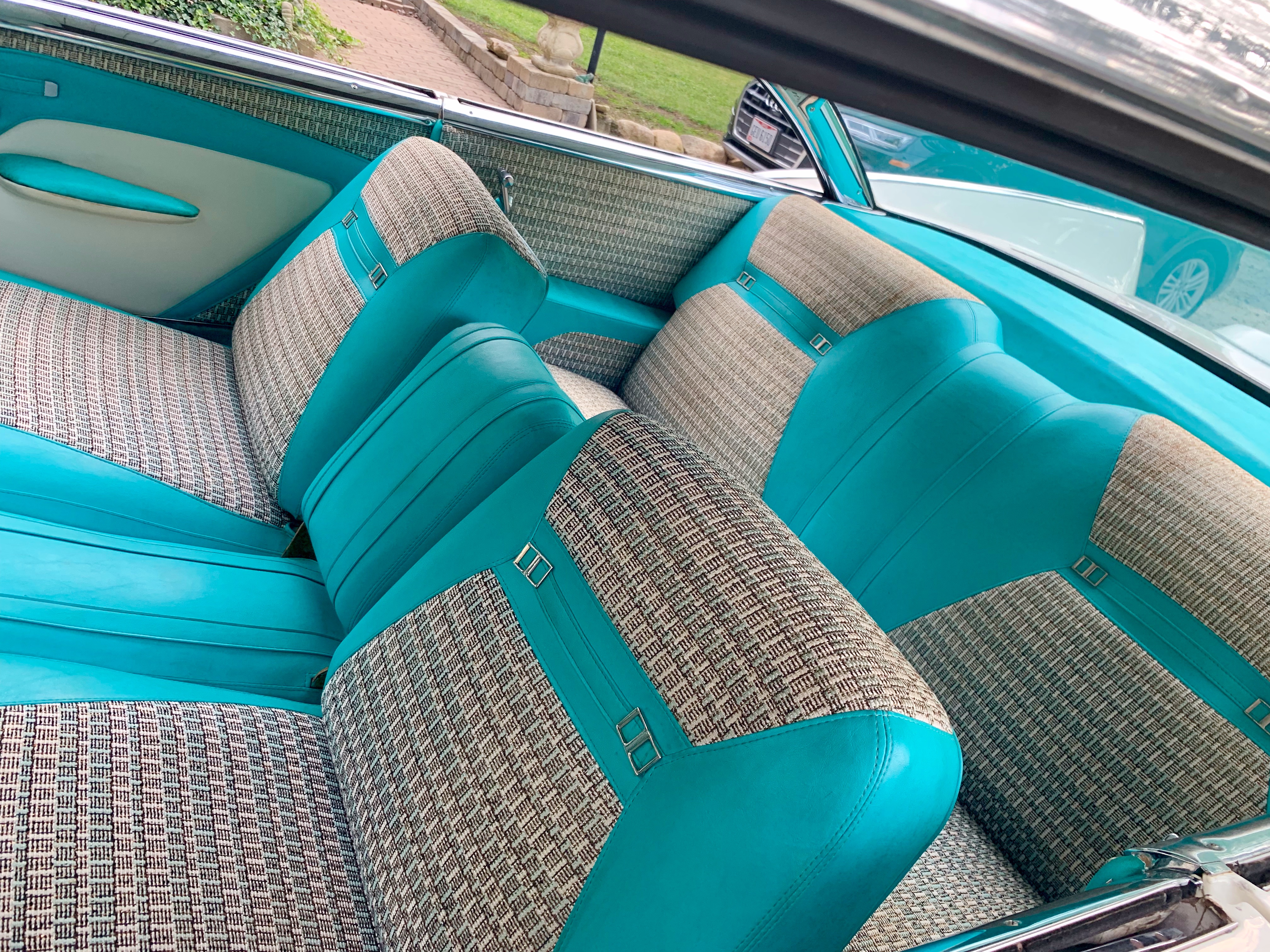

Thank you everyone for the kind words! I definitely fell in love with the colors- mainly the interior being the spring color of turquoise, really pops with the white exterior. I also verified it is the correct color combo via the tag on the firewall and the build sheet I got from Chrysler. The car looks good, but I definitely have some bugs to work out on it- turn signals aren’t working right, driver door doesn’t close quite right, and then the middle section of the headliner missing, and the radio is not hooked up. Thinking about doing the conversion with the original radio, I saw a post about that on here. More to come as soon spring has sprung!
Steve, I’d say that valance is definitely salvageable. Now, I know a guy… :wink: Yo Dick, you lurking in this topic? :astonished: :unamused:
There is definitely enough left of that valance to work with. Much better shape then some of them out there. Being that low they tend to always be dented / Smashed. Wonder what the story is on it being red? From a donor car maybe? I believe they were all argent silver from factory… either way with a little hammer and patch work I’m sure it can be saved. Also, fully agree on your taste in color! :mrgreen:

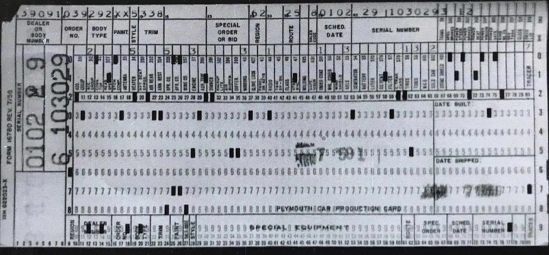

Post that build sheet if you can, I can decode that :smiley:
That is good news, hopefully I can find someone to repair it and bring it back to life! It is from a donor car that came with it when I bought it, so it’s not the original one. I was wondering why it was red, too- must have been painted at some point many years ago.
Hi Matt!
You were an amazing help last summer, you already decoded my sheet and I thank you again! But here it is with your comments:
312- accessory group which included back up lights, windshield washers and variable speed windshield wipers $27.85
305- front and rear rubber bumper guards (don’t see any holes in your front bumper so it’s been changed over time, your rear guards were missing if I remember) $1350
373- Golden commando $86.50
345- hot water heater $74.40
403- remote control mirror including a matching passenger side mirror (also known as the deluxe mirrors) $26.25
301- power steering $76.60
302- power brakes $42.60
441- radio $73
13- 8.00x14 white walls $41.75
293- torqueflite 3 speed automatic $226.90
502- undercoating including fiberglass hood pad $12.85
533- axle ratio 3:31 (standard was 2:93)
602- sold car, your car was a car that was sold and the ordered
With the price of the Sport Fury hardtop $2927.25 it’s a total of $3629.45 back in 1959.

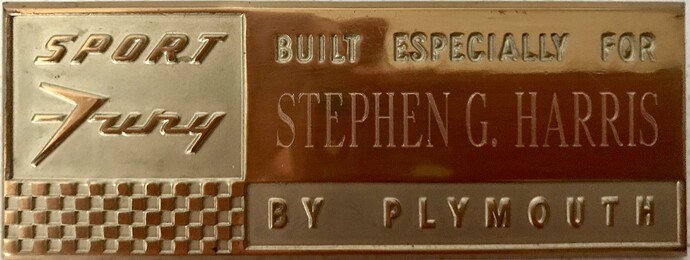

Also, a pic of my plate I had engraved with my name (since it was blank):
Damn! I beat myself to it :laughing:

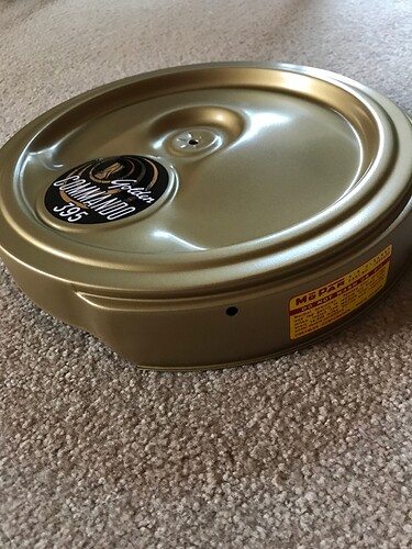

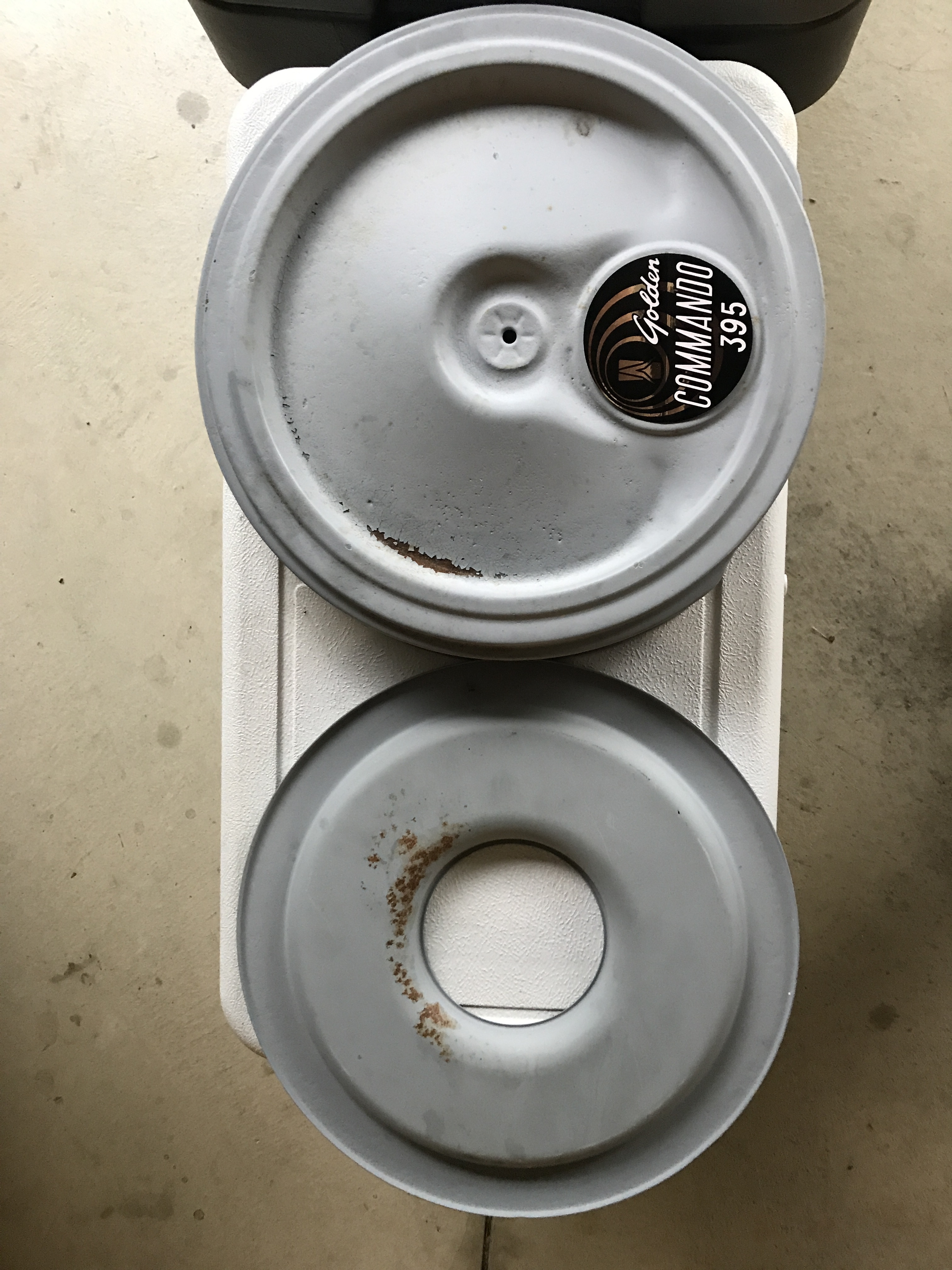

I got the air cleaner all ready to go.
That cleaned up beautifully!!! Love the look of the satin gold!
Classy! You deserve an atavar on your posts - and so it is done!
Thanks, guys! Next step is to get rid of the Edelbrock carb and get the original rebuilt so I can actually put the restored air cleaner on! :laughing:
