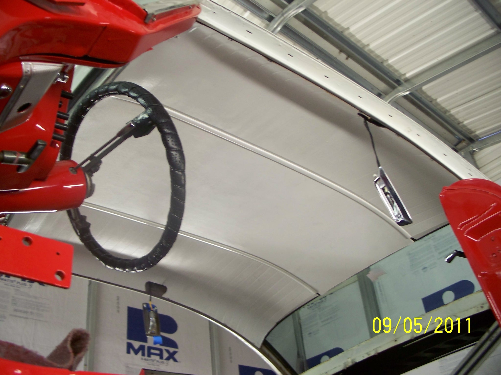

OK, i’m ready to install the interior moulding around the back glass, windshield and along the sides at the edge of the headliner.
Questions are:
- Do you install the moulding around the front and rear glass and then the side pieces or visa-vera.

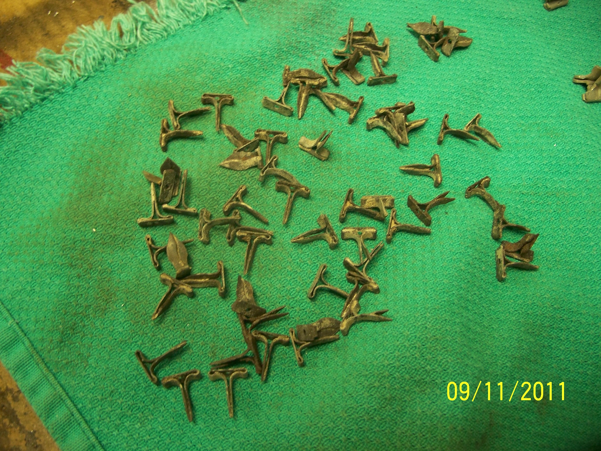

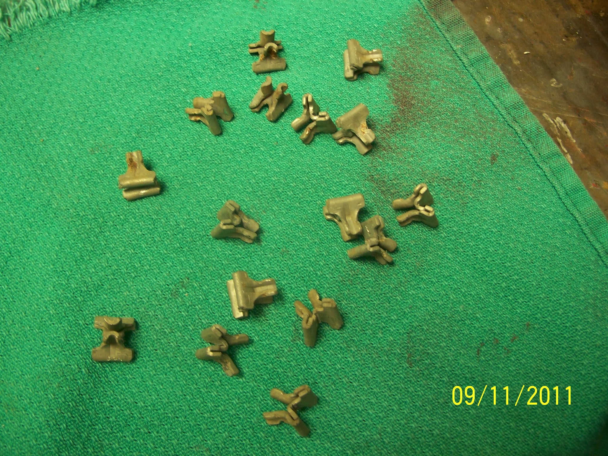

- Below are some pictures of clips. Where are they used??? Maybe the side moulding, inner and outer.
Reason for asking I did not remove these mouldings when I originally took the car to have the windshield replace back in 2006.
I have a reasonable idea looking at my green car on some of it, but it is totally impossible to see how the two front to back mouldings on each side are attached.

I CAN tell you the first picture showing your clips (the little bow-ties) are used to install welting (foam-core upholstered door edging). I do not recognise the second set of clips so maybe they clip the side rails to the steel roof flange in some way. ![]()
Hey Dick,
Roger is right those aluminium clips in the second pic hold the steel roof rails in place but you’ll find they will break
if you try to install them as they are use once only!! You might have to use screws or rivetts to hold the rails in place.
Jason - Thanks for solving the mystery. The only thing I have left to install is the outer roof rail moulding and it makes sense that those clips are for that, The new weatherstrip I got did not have holes in the rubber over the rear window to install with either clips or screws so I drilled the rubber to accomodate screws, but either way the rubber had to be drilled. I may try the clips first???

Fins 59 - I agree, they have always been most helpful. About the clip in the 2nd picture above, I found them in Restoration Specialties 2005 Blue Catalog on page 121. It’s #2564 for Ford, Lincoln & Mercury, but they could have other applications. I tried to see if I could use them on the roof rail weatherstrip but couldn’t see how they would ever work. They were too big to fit into the slot so I used stainless steel screws. The passenger side rear window goes up and down with no problem but the drivers side grabs and pulls the rubber. I applied silicone grease to the rubber so now it goes all the way but is way to tight with a lot of strain on the regulator. Now that I think about it they could have been used for the welting, all I know is they were in with all the other clips for the car but I don’t remember where they came from.
