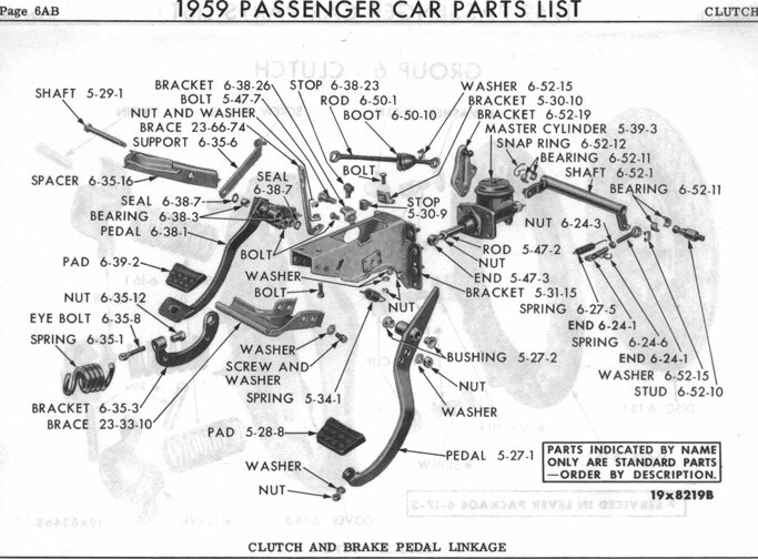

I’ll scan a pic of the clutch from my parts manual tonight, we can narrow down what you’re looking for.
Mike, here’s an explosion diagram of the clutch. Can you identify from this diagram the part you need?
sorry, computer died. is that a '59 manual?? it looks more like my buddys '54 setup (my clutch pedal “hangs” from under the dash instead of sticking out of the floorboards). I don’t see what i need on there… were the linkages the same if that’s and older drawing? If i had to make an educated guess i’d say my part would go in place of bracket (6-53-5) and bearing (6-52-11). Mike

Oops, quite right. The pic I originally posted was for a truck! Sorry 'bout that. I’ve fixed the post with the correct picture.
lol it’s ok. the part i need is “stud” 6-52-10.

OK – those are catalog numbers that are listed. When I get home tonight, I’ll look up the part number – then there are places we can check for the part.

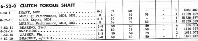

OK, here’s what I know: The part is definitely a new part for '59. It does not cross check with the '55 part I could get my hands on.
Furthermore, there are two parts. Here’s how it’s listed in the book for Plymouths:
(The funny symbol in front of the “1829” denotes that the part has not appeared in any previous parts book.)
Now, Mike has a 318 – but I don’t know if it is a V-800 (or, even if it was available in the Savoy) – the special power pack for the 318. Is that considered high performance? Or, is only the Golden Commando high performance?
I don’t know. But, the answer to that question will determine which part Mike needs, and then we can figure out where to get it. I’m going to send a note to Ed Eckerson, he will undoubtably know.

Still poking around, for clutch part 1829 377…

The teflon bushings are part 6-52-11 in the diagram. They weren’t teflon originally, of course, and surely are worn out.
