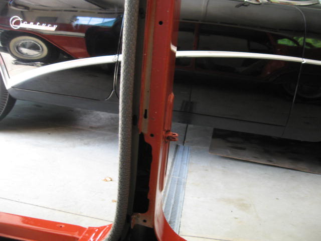

Used Xmat from eastwood. Thought I would try it.Anybody else done it before. It does make it sound dead. I tried to use the scrap pieces and get it inside the corners but I don’t think that is that neccesary.I am going for sound more so than insulation. Going to do the floor later and if any left over pieces it will go in the trunk. XMAT from Eastwood#15841. My face did not even get dirty!!! Mark
Veeeeeeeeeery nice. How many timers did it take, Mark?
Good stuff, l used it in Charlene and Bertha Irene.
It took 2 Mark

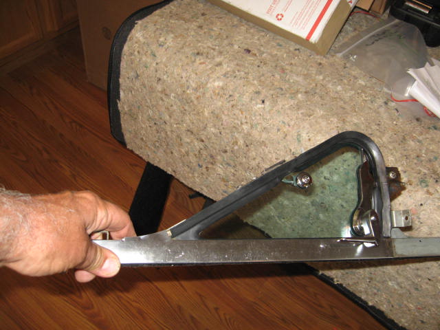

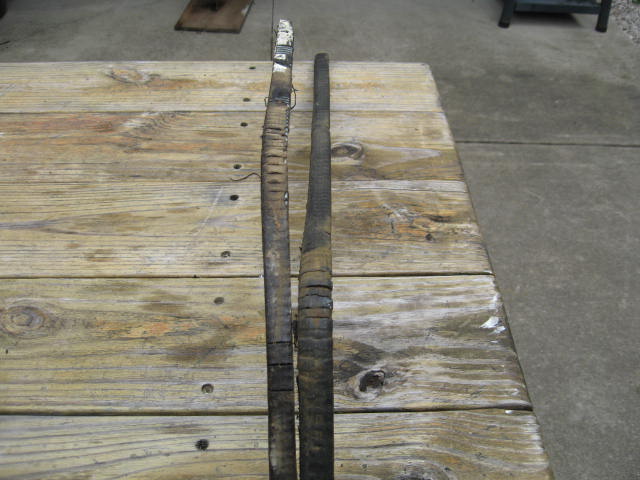

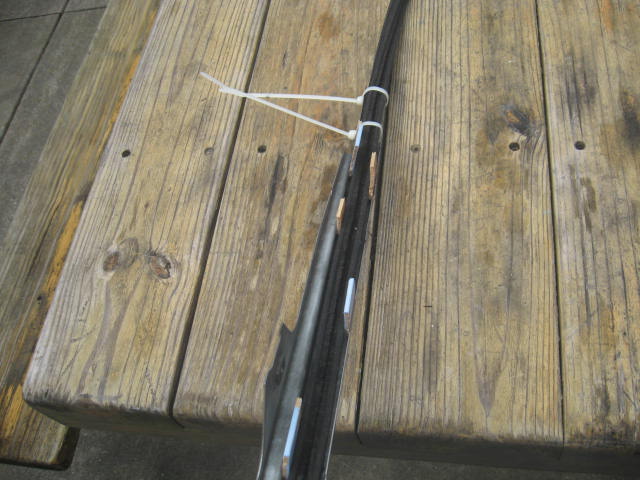

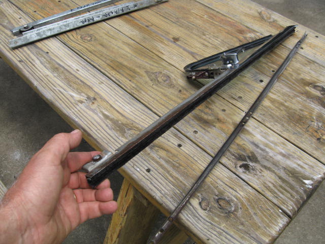

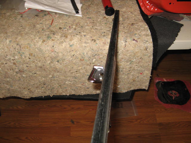

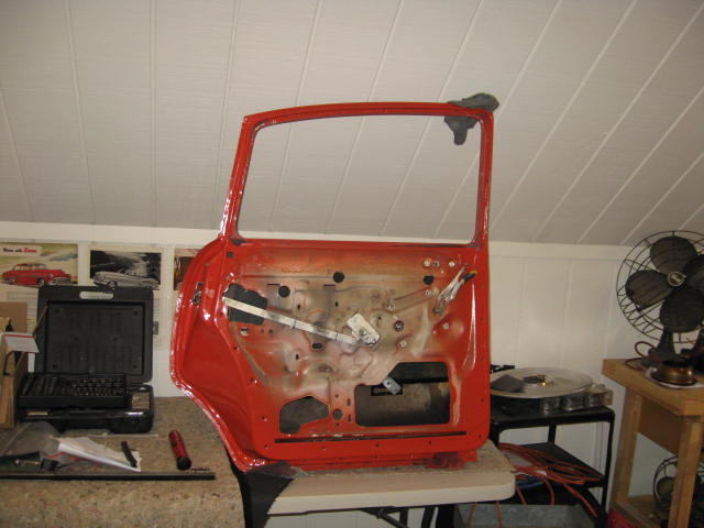

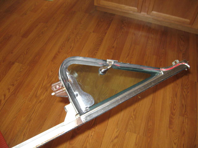

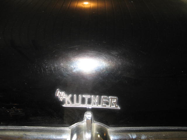

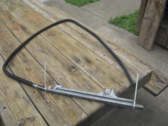

Well I am making A stab at the vinder schliders. Useing 3m weather strip adhesive.The window channel I got from gary goers is narrower and I can not find wider ones.I used tywraps and shimmed it with pieces of A paint stick to center it after I glued it. Later I will use either screws or possibly 2 holes and thin wire to secure them further. The right and left rear doors have different window channel, both are very old but one is wider (the correct one) more indication of some kind of accident very early in it’s life(hence the window stop was missing as well, and the windlace on the right side does not match the left, and was “stuffed” in).When I get out of my chair you can see what happens my cat takes over,always involved in everything I do and is like my shadow. He was A throw away, I picked him off the road tossed out as A kitten I thought he was dead. That was 11 yrs. ago, I would not trade him for anything (my buddy).On another note this is for DAN.My Buick came from Philadelphia 6 yrs. ago.I understand you are from Philly. All original originally purchased from Kutner Buick. The badge is still on the back of the car. The original owner name was Thomas Demi 4286 Penn st. Kutner Buick was on Castor and Friendship st. It was the 3rd largest Buick dealer in Pa.I think they went out in 98 and moved to L.A. and became King Buick. They originated at the Philly dealership in 1948. The Buick was built at the Wilmington Del. plant which closed in 2008 and was building Pontiac Solstace.Just thought I would toss that out there Dan if it means something or may mean nothing. Mark
Mark, I remember the dealership well! It was actually at the intersection of Castor and Cottman Avenue in “The Great Northeast” (Northeast Philly). Friendship Street is a bit further down on Castor; perhaps parts or service was there? Don’t remember.

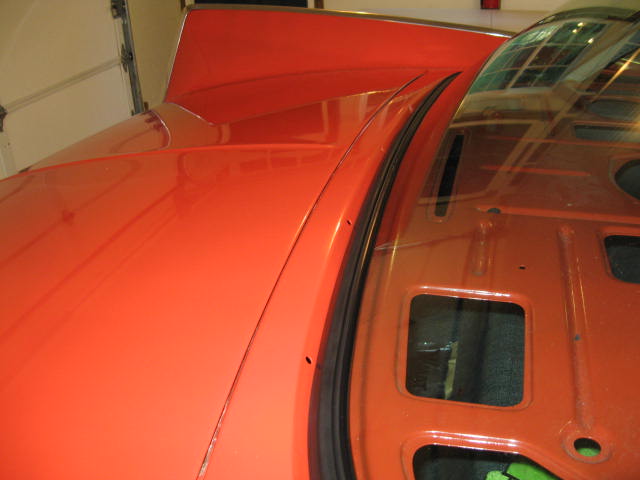

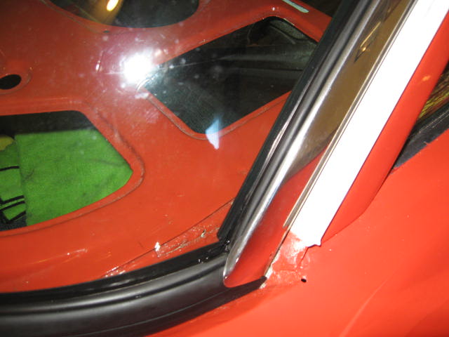

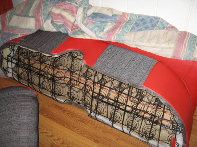

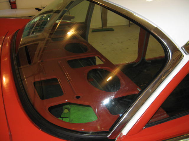

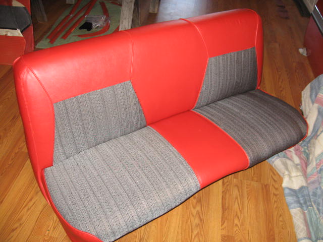

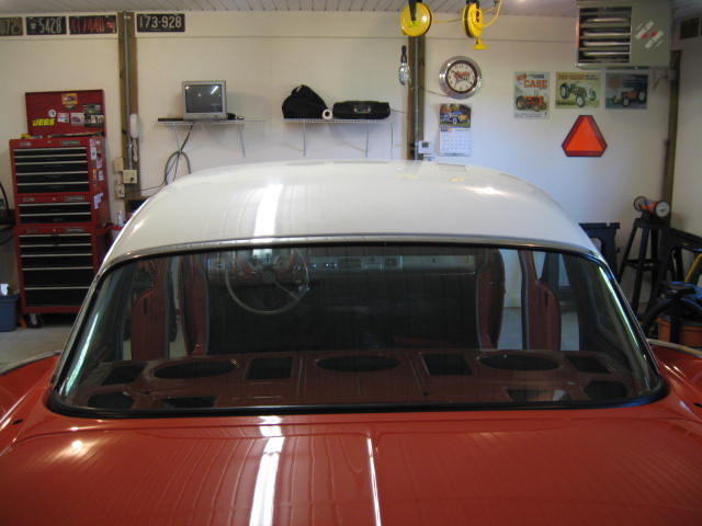

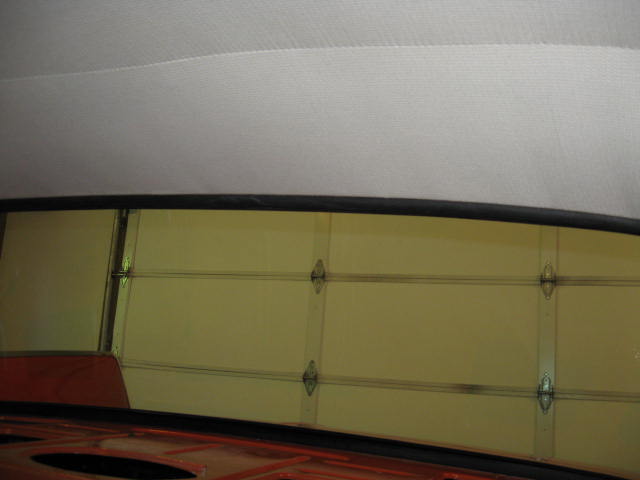

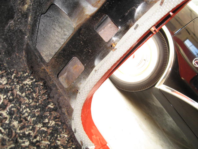

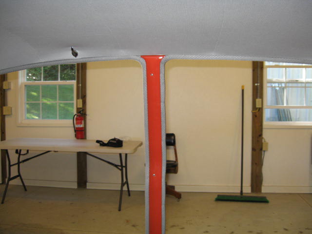

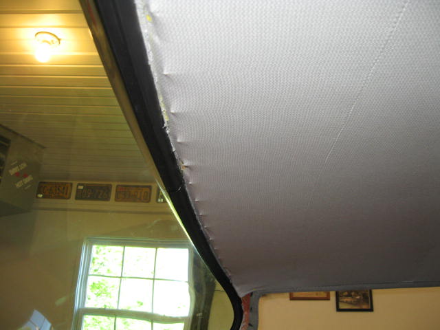

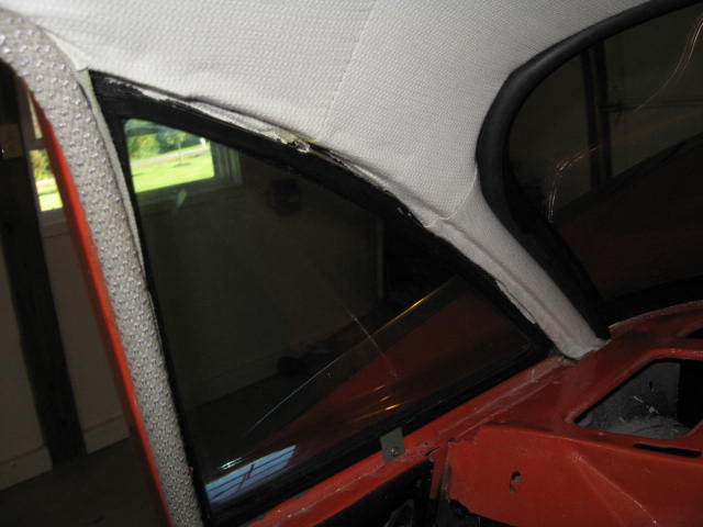

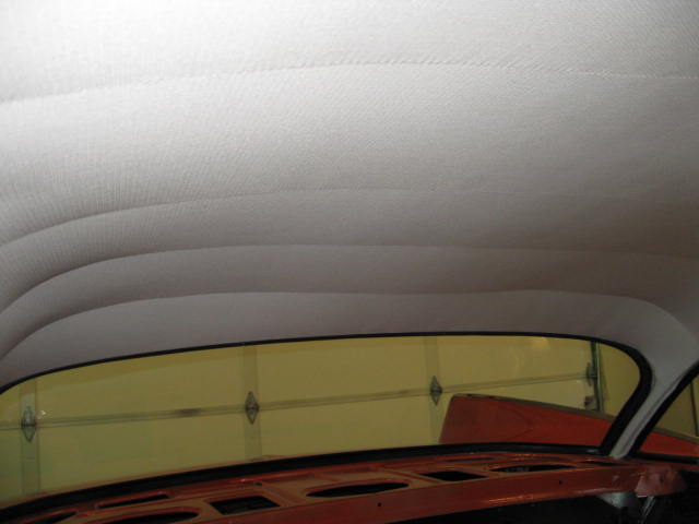

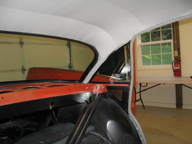

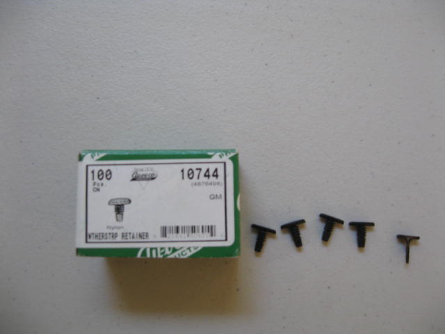

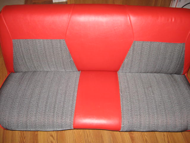

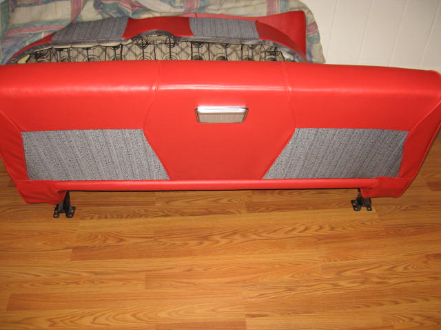

Back at it again. I was off awhile and was laid up due to foot surgery (joint),and too much H E A T !!! Got the seats back and they turned out well.I did the wind lace myself and had A buddy do they headliner. He has done many and it turned out well.I hired A glass guy to do the back glass even though I did the windshield myself and the back is easier but I wasn’t up to it.One problem was when I ordered the rear gasket from Andy Bernbaum it came as 2 piece( upper 3/4 and the 1 across the bottom) I thought it would be A 1 piece. I knew I cannot get A moulded one. So it took A little trimming and some adhiesive but turned out well.Going to start putting the inside trim on and the lower back glass stainless with my new rubber hose spacer gaskets.I got the windlace plastic pins from Cilps and fasteners they worked out well,I think the box was like around $5.00 plus ship.You need alot of them as my old metal one were not too good.Another thing when I got the rear gasket it did not come with the glass lock strip (A thin band of rubber used like A wedge after the install) I don’t know if they forgot to ship it or I can’t get it, but my glass guy had an extra in his truck and it worked well.I am going to slow the pace down on the car and stretch into winter as it will not be going out this year anyway. It gives me something to do while it snows!!! Later Mark
Lookin’ good, Mark! Good to see you up and about again. The seats look great.

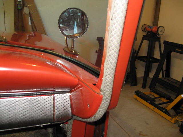

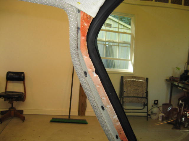

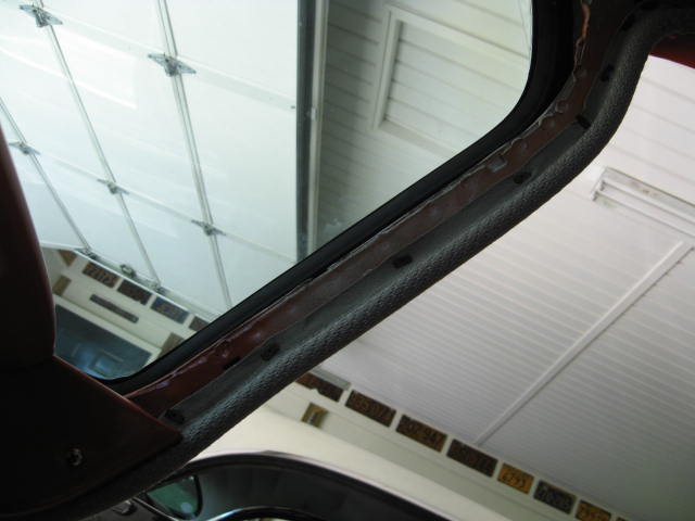

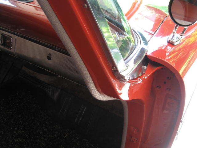

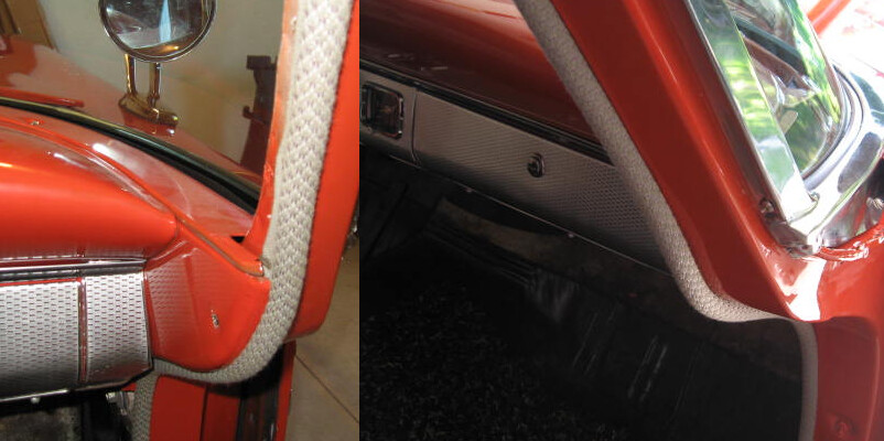

How did you get the windlace so snug around the dash? Did you install it with the dash out?
I love that style of windlace - where did you get it? Gary Goers only has the sewn vinyl now.
Clips and Fasteners - that’s new to me, I’ll browse some.
Dan; I did the windlace with the dash in.I wired it through, the I think 3 holes, that are hard to get to and pulled it tight. I did it under the dash and took the side screw out and it created enough gap to see the hole locations.The windlace is from SMS,so is the seat fabric,vinyl,and headliner. Thanks Mark
Thanks for the tip Mark, l did my red car with the dash in not knowing there is a small metal plate that holds the windlass tight at that radical bend with screws. Mine is sagging pretty bad and l certainly do not want to take the dash out. The convertible was a snap because the dash was out and l could see how it was held in with that small piece of metal. I will give your method a try. If you could, please detail your method a little more. Glad you are back in gear, your upholstery looks great.
