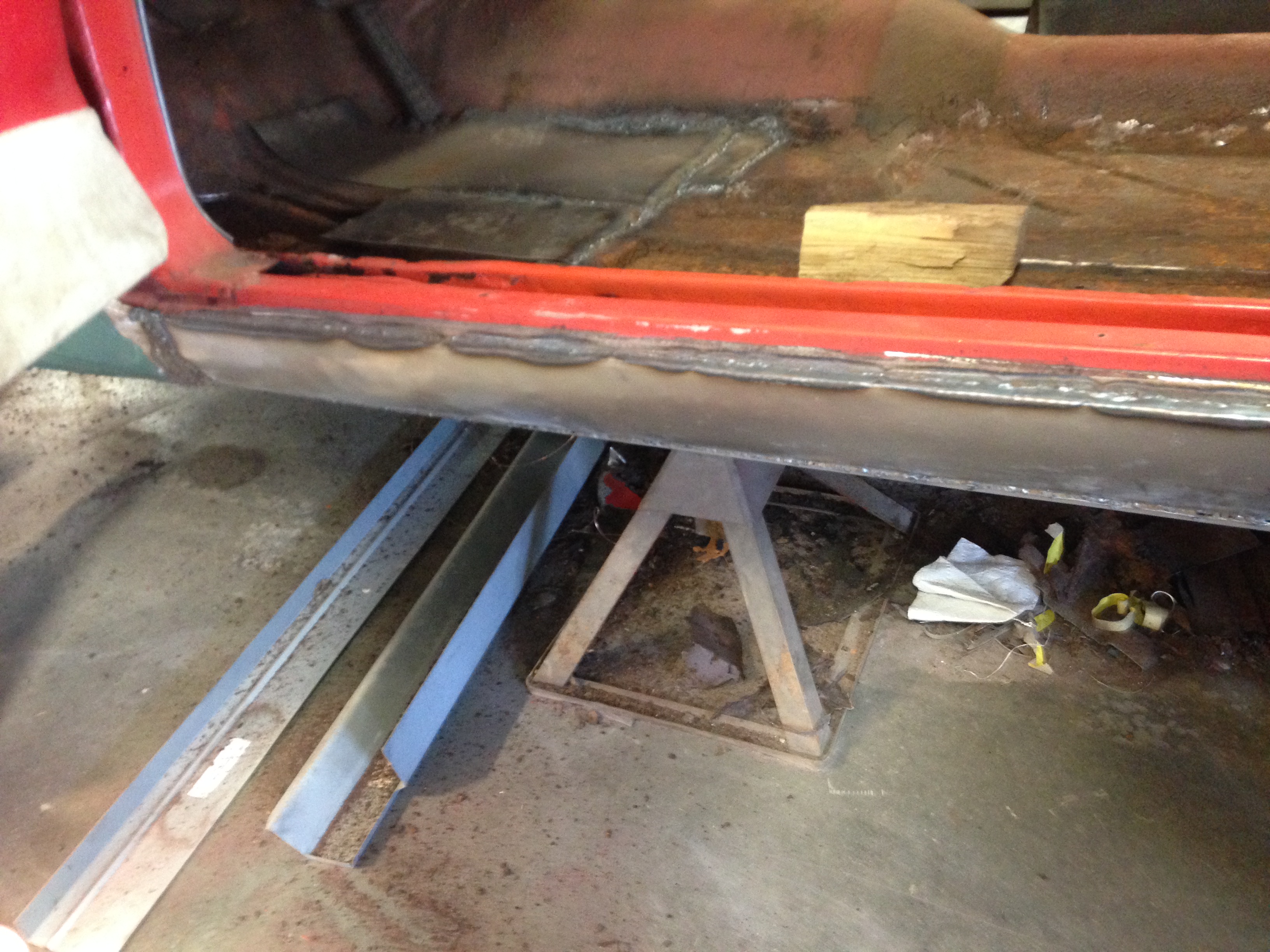

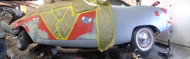

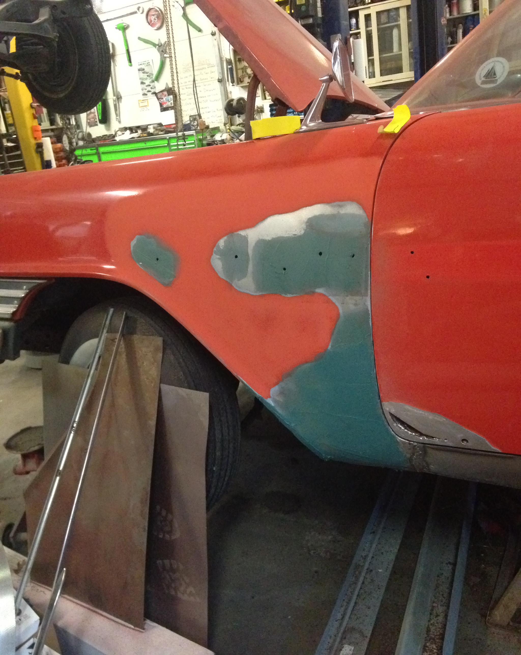

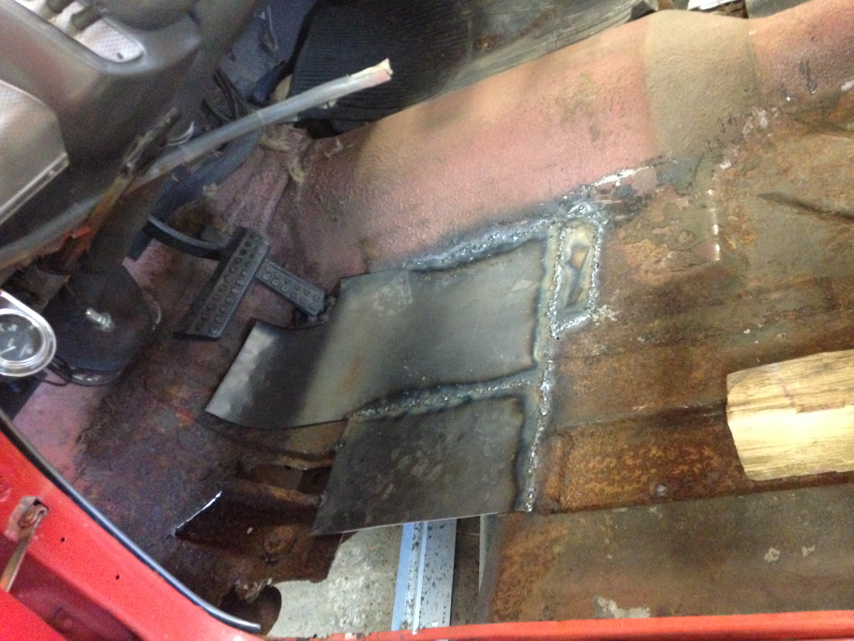

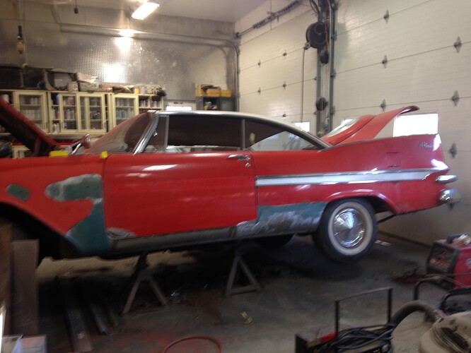

Some of the rust repair pics.

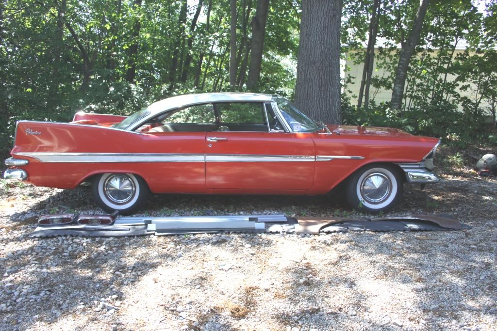

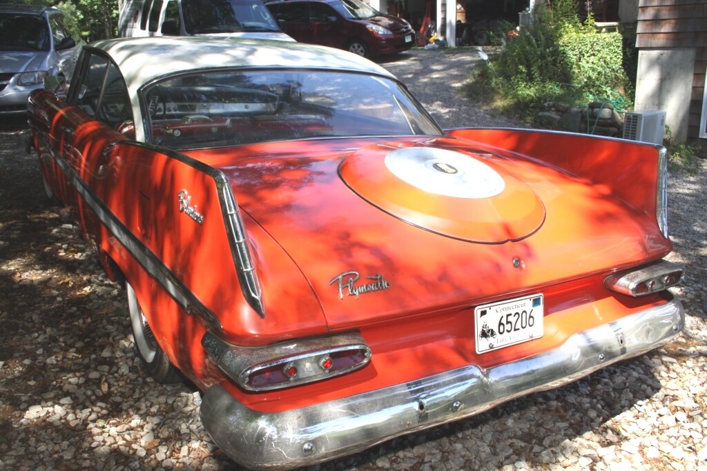

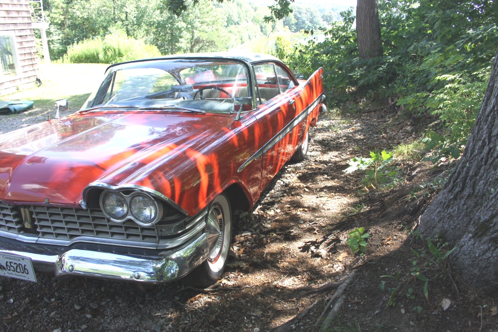

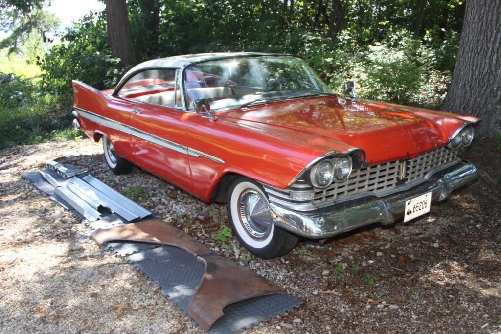

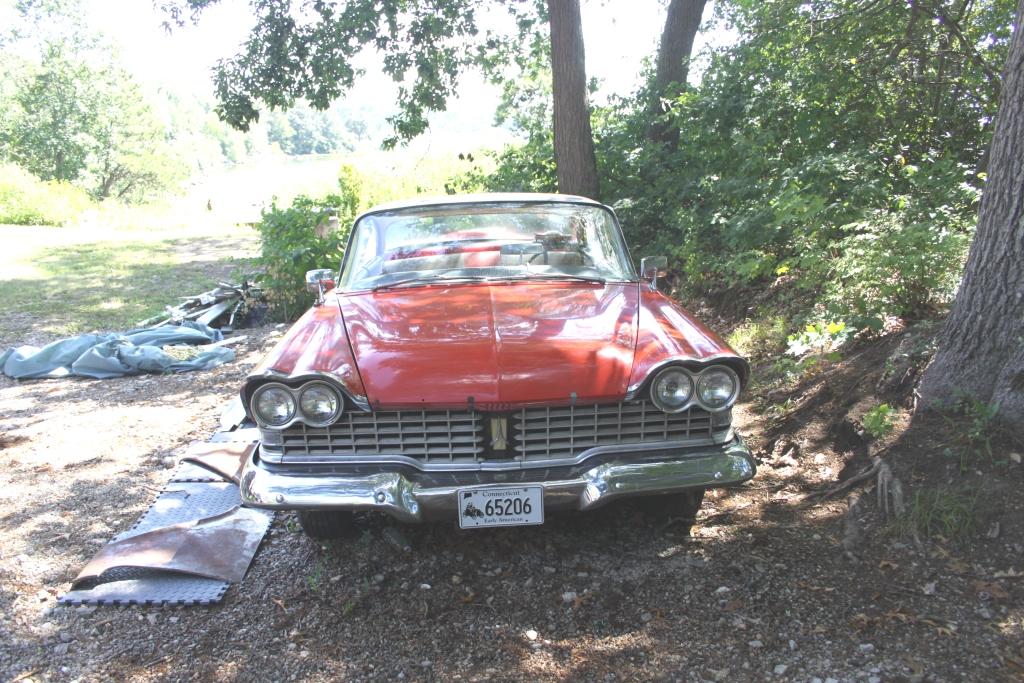

Next round of pics. these were the ones I took where it was sitting to send to my son to see if he was interested in going in on it. It was a 20 footer then (Looks great from 20 feet). The parts laid out beside it were inner fenders and inner and outer rocker panels, which couldn’t be used because they were to a 57’. Still have em’ if anyone is interested.

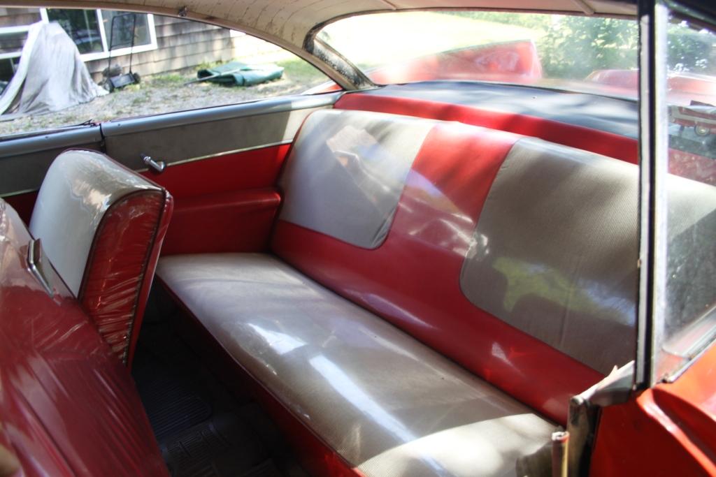

More pics!!!
Ok, let’s see what we have here!
VIN: M256122474
M - model year 1959
2 - Plymouth, V8
5 - Belvedere
6 - build in Detroit
1 - sequential number
22474 - 22474th Belvedere build in Detroit
Body - 252: Belvedere 2 door hardtop, V8
Schedule - 0421: scheduled build date April 21 1959
PNT - paint - XN: flame red body and iceberg white top
TRM - interior trim - 314: grey seat and red bolster
For options I see:
Sport deck (fake spare wheel on the trunk)
Full size hubcaps
White walls
Powerflite 2 speed automatic
Radio
Heater
Cigarette lighter and ashtray
Looks like it has aluminum inserts?
Can’t see if it has back up lights and variable speed windshield wipers.
Other then that:
2 non original mirrors
Missing the gold V on the trunk
Missing front valance?
Wow, too cool! Thank you so much. It has one speed wipers with no washer. It has clear lights in the center of the tail light assembly, but back up lights dont work if their there. (Does this thing have a fuse box?) I cant find one anywhere! I have 2 valences for the front, one in better shape then the other, and a smattering of badges and excess trim that can go on after the body work.
Back up lights were an option. Check with the taillights on the inside of the trunk. There is a connector with 2 wires and if there is another single connector with a white wire you have back up lights.
