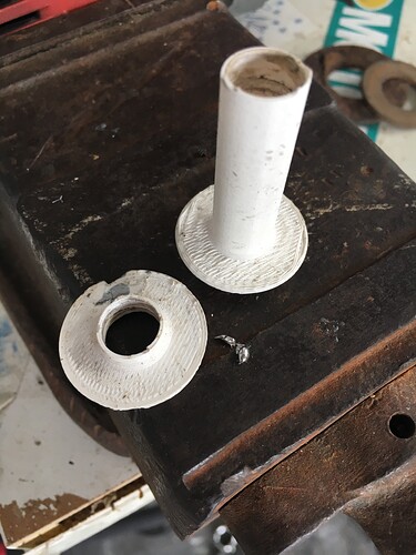

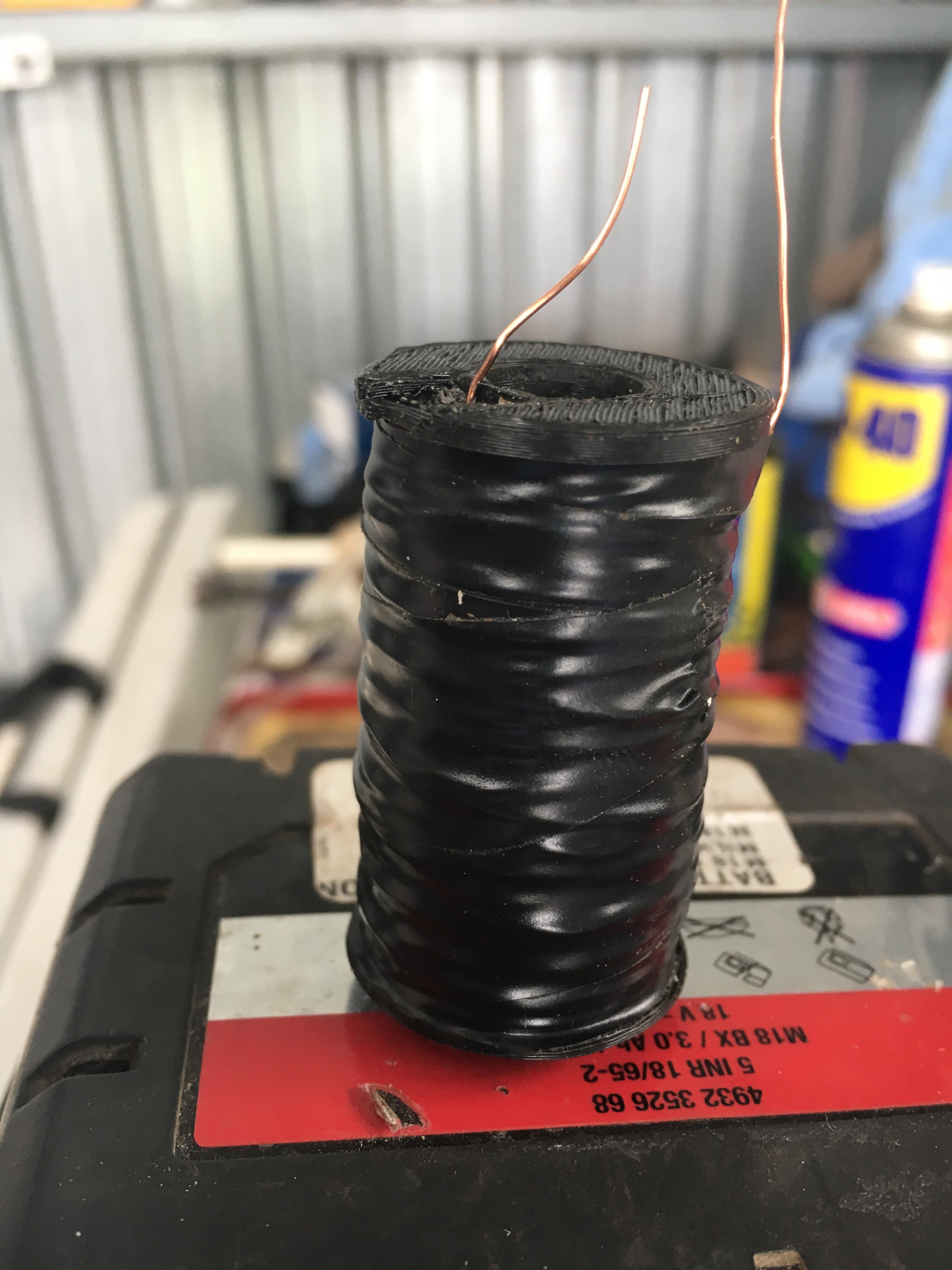

Finished a coil then realized the wire had sliced thru the plastic
Tried the second one and same thing
Getting new ones made with a thicker wall
See how we go
Coil complete and installed
All working well
Ended up getting the coil wound professionally as my homemade version just wasn’t producing enough current
Details on the card for future reference

The 3D printing cost me $40 for the first prototype and then $10 for 2
The winding cost me $100 ( reckon I can get this down to about $50 as they now have the specs)

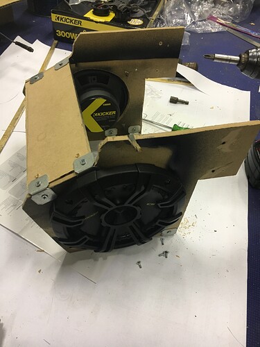

Decided to hide the front speakers behind the record player
Made a frame to hold them and brackets to support both back of record player and speakers
Also made a tweeter holder as well
As you can see trying to hide as best I can so as to not detract too much from the originality of the dash
Will paint the holders either black or brown so as to try and blend in

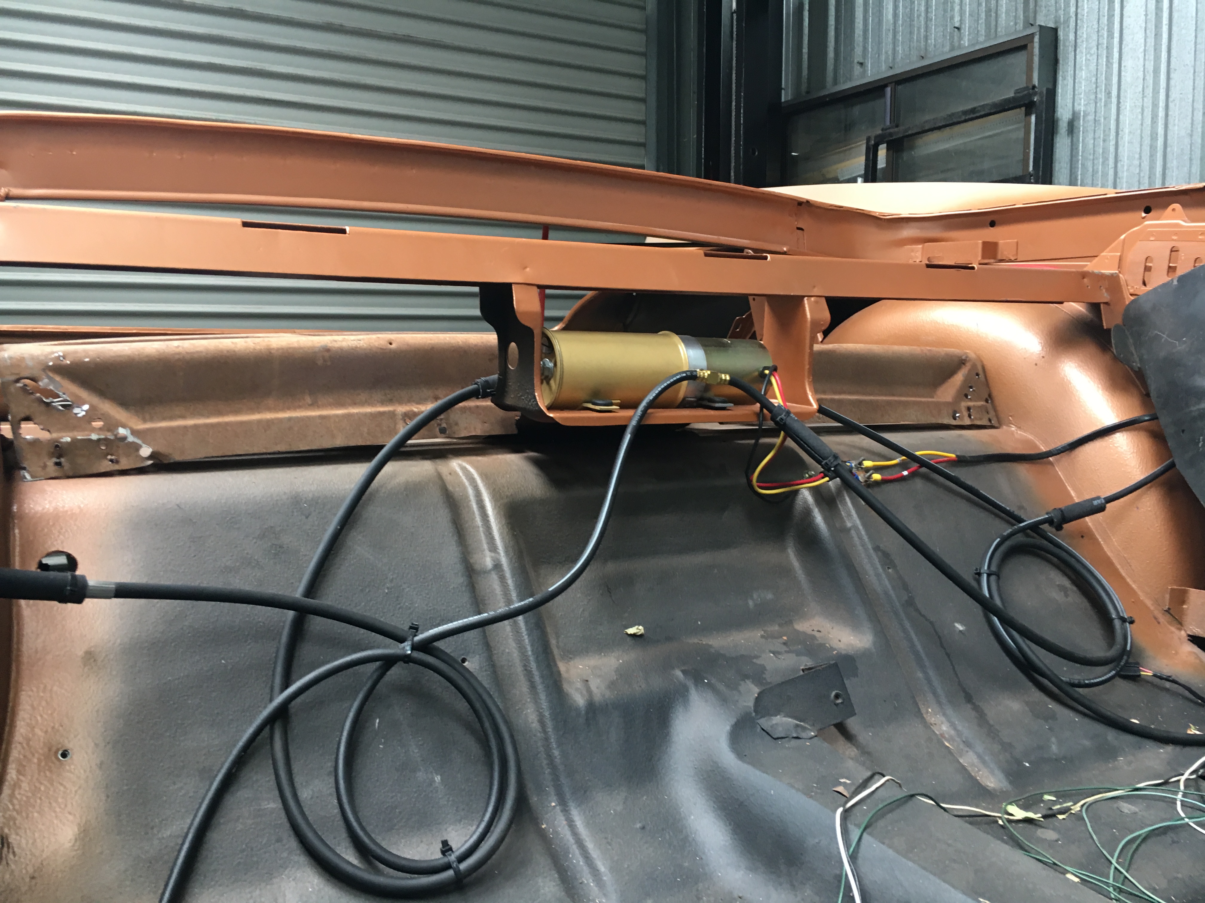

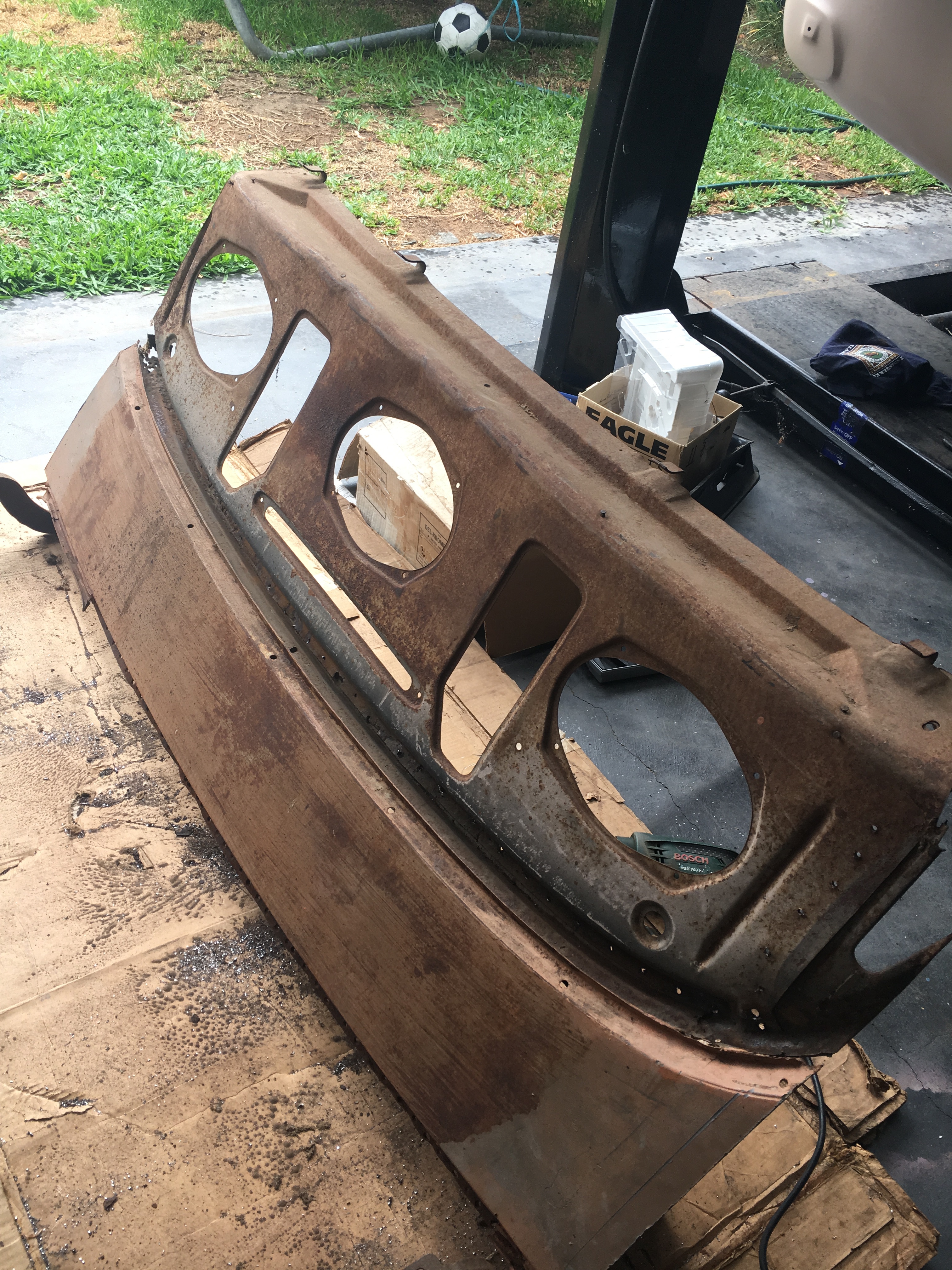

Wondering how much space there is in the trunk when the top is folded into the well
I am thinking of making a parcel shelf using the frame from a 4 door hard top
Just need to now how far down I’ll need to set it
Plan to mount my speakers and amps below it and then finish it off almost like a hard top
Some pics to show what I mean

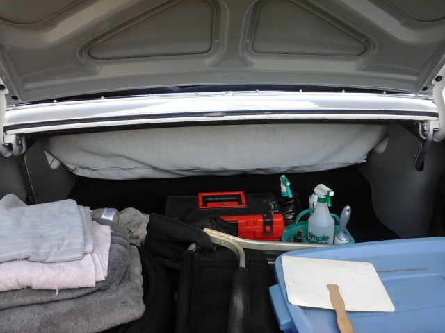

Hi Vic - excellent idea. I ordered my top well and boot from Gary Goers and they both fit perfectly. The well hangs down with only an inch or two from the floor. You will have to mount the shelf much lower than your pictures indicate. I will lower the top on my car and let you know how much clearance there is. Give me an hour or two.
OK Vic - My trunk floor is carpeted and the top well just touches the carpet. With the top down l measured 5-1/4" between the carpet and what l felt to be the top lowered into the well. I’ve included a picture of the top well in the trunk and another of a junk box l always carry with no problems. You may want to consider mounting the speakers in the beauty boards on each side below the fins.

I managed to trim down the parcel shelf and have it sitting at 4inch above the well floor
Now just need to work out how to finish it off cosmetically
Thanks for the input

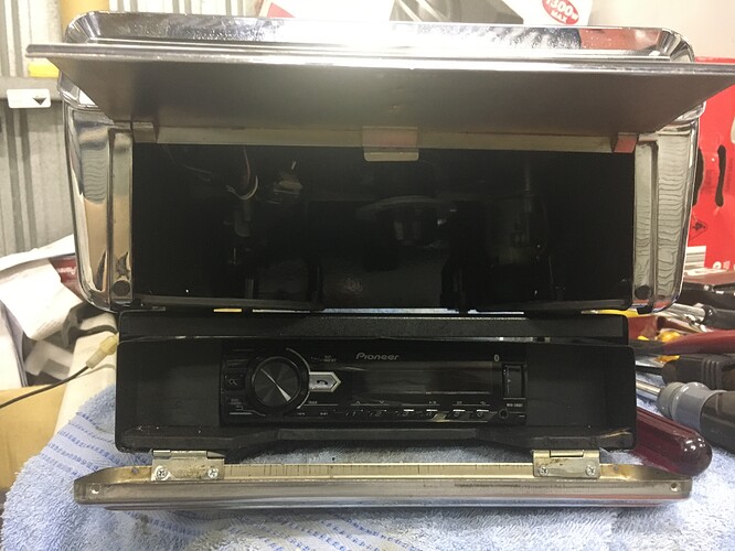

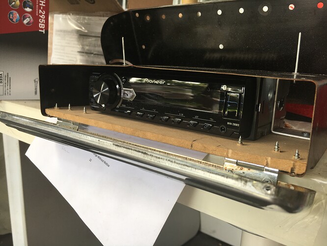

Received my tissue box holder this week
Have played around and turned it into a holder for my new car radio
I’ve now got to cut screws and paint it black on the inside

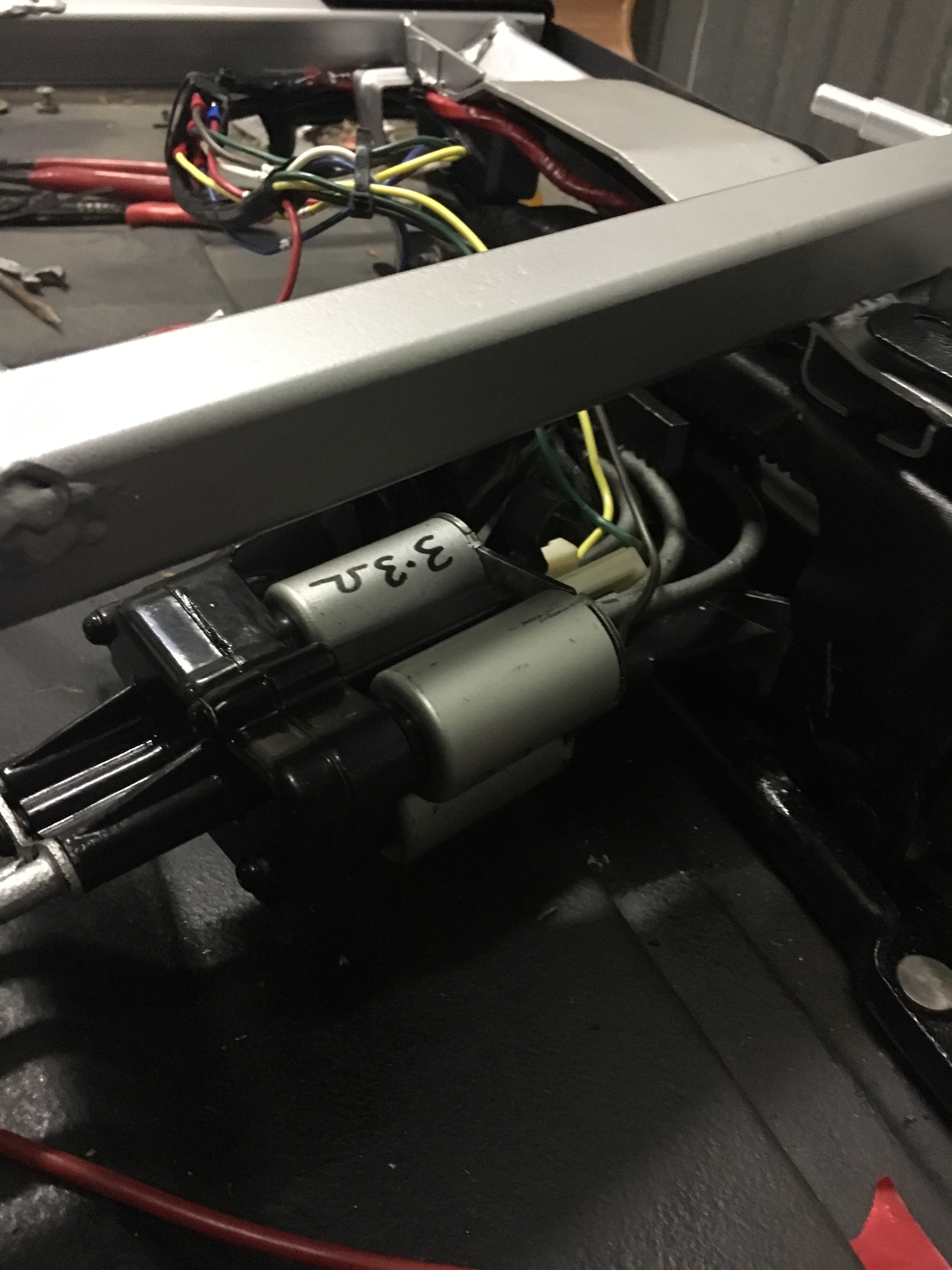

Got my record player back today
Would you believe I couldn’t find a #44 lamp here in SA so had to order from the USA
Without it the record player wouldn’t work as it basically acts as a fuse
