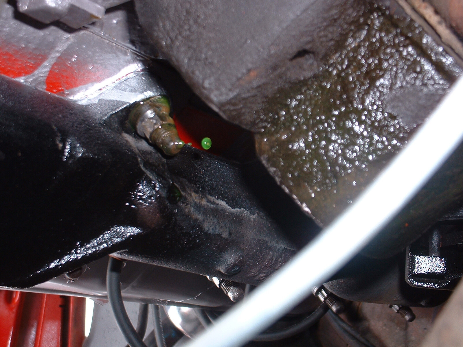

But here’s what I’ve been up to: When I pulled Faulkner back into the garage, I put him up on ramps so I could inspect the leaks I’ve got. Yup, the lower power steering seal is definitely shot, I’ll put that on my todo list. And yes, the radiator continues to leak, that will need to be recored. But, uh-oh – shades of 7/2006 – I see that I’m leaking antifreeze from several of the exhaust manifold bolts now, just as when Matthew snapped this remarkable picture two years ago, right after the rebuilt engine install. I wrote about it here:
I thought I was lucky, and got away with only one leaking. Now it looks like I’ve got to pull them all… Fortunately, they look accessible. Maybe this will be a job for Ed Ober’s friend, Bill. Get the radiator recored at Burton’s, have Bill replace the steering seal and permatex the manifold bolts. Hmmm…

I realized, when I popped the hood to show Bill – that there are ears on the exhaust manifold below and above the manifold.
I know the lower bolts pass throw the water jacket, and need to be permatexed. Does anyone know – do the upper bolts also penetrate a water jacket? I’d like to know, so I can pass the info on to Bill. If there’s no need to pull the upper bolts, so much the better.

all I can say is the longer studs go thru the wall and into the water jacket…which studs they are, I dunno, and can’t find it in any manual.

permatexed the manifold bolt leaks
