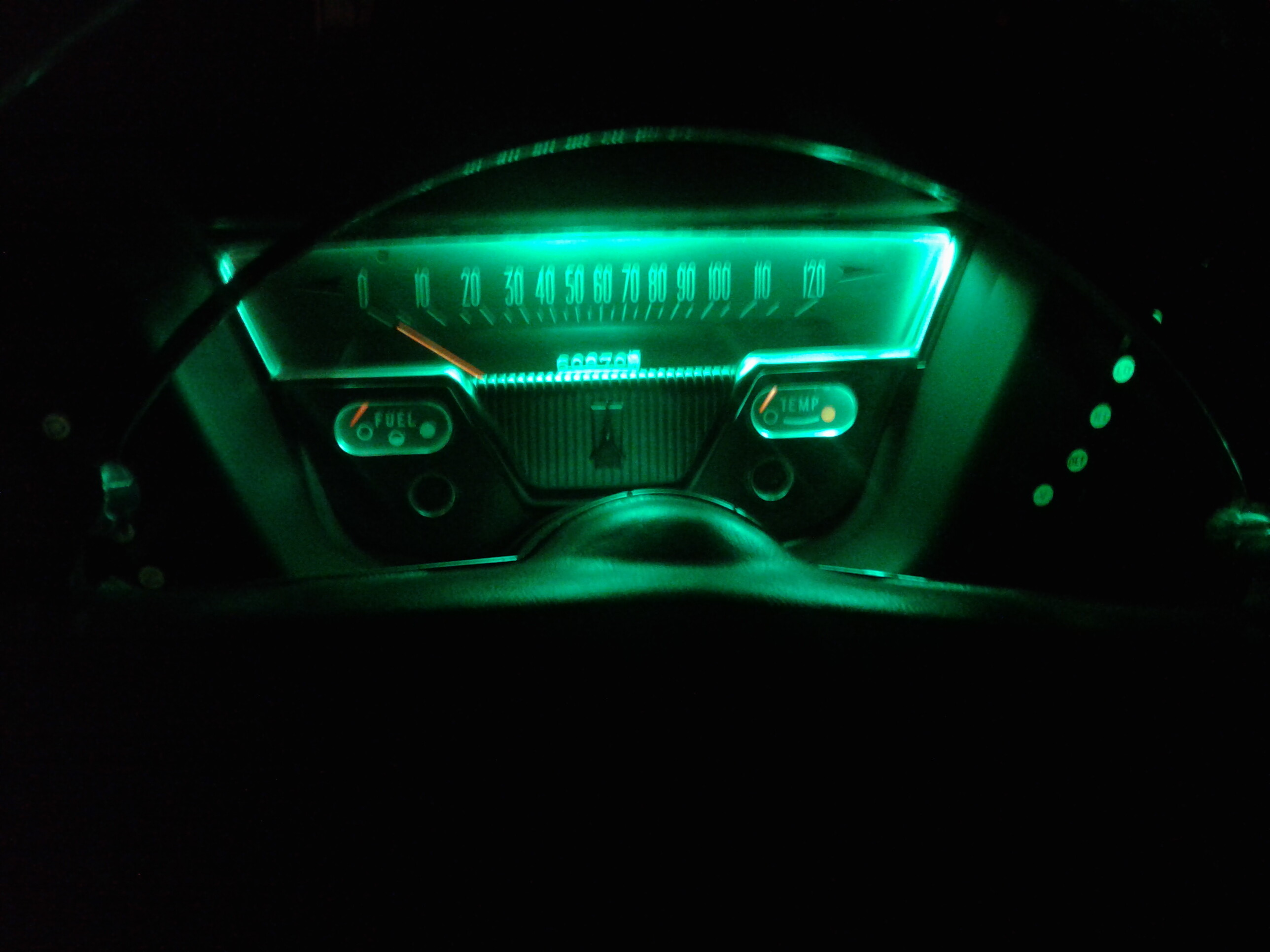

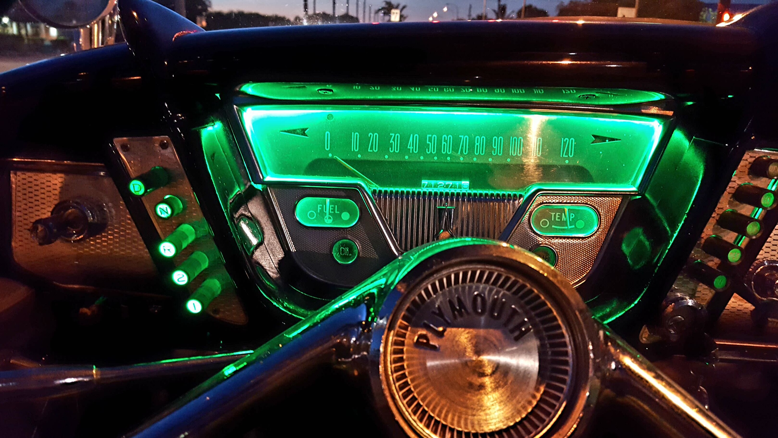

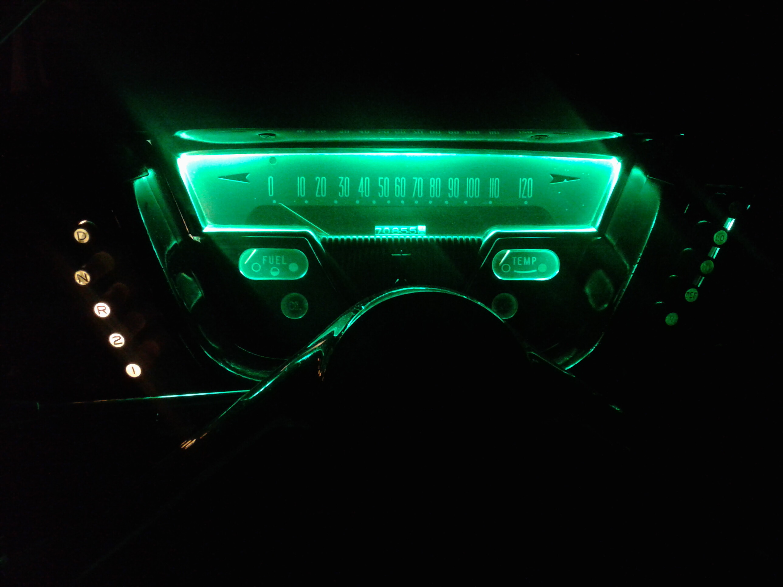

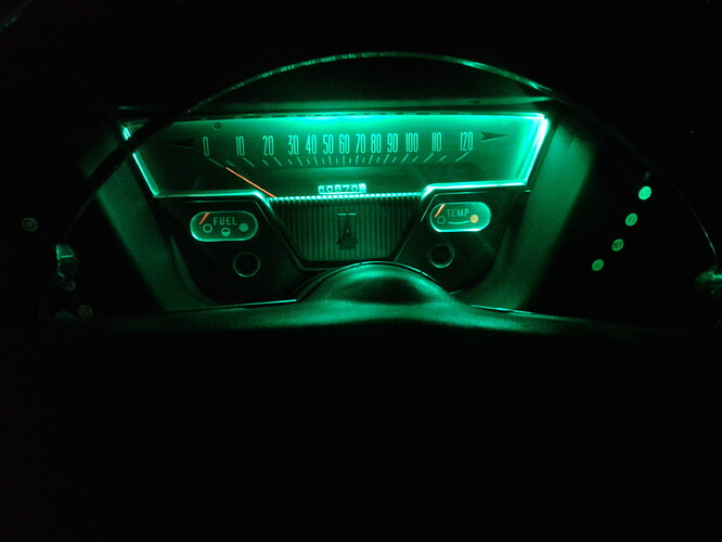

My dash lighting on all my cars seemed rather dull and dim so l replaced all the three top #57 bulbs with LED lights. HUGE DIFFERENCE. I didn’t change the turn, hi-beam. Oil or generator bulbs because they were pretty bright and seldom are on. See the pitchuhs.

I’ve seen the pics, it looks great.
Can you still dim the leds?
Yes Matthew, you can still dim them. John Q. Wanted so numbers for the LED’S. I tried to post pictures here an email them to Dan but they are to large to send. Thats why the pictures are on facebook. I purchased them on line at about half the price you can get them at Advance auto or Pep Boys. Go to www.superbrightleds.com link to your car and they list all the bulbs you use and the LED equivalent.
#57 = BA9S-GHPS GREEN
#57 = BA9S-RHPS RED.
#1073 = 1156-CW18-T COOL WHITE.

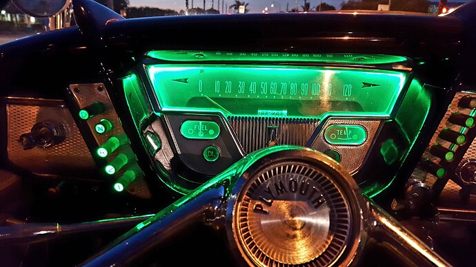

Question if I may
How does the heater controls get illumination
Is it via the slit on the side of the main dash housing?
I’ve got a bulb on the trans button selectors and its obviously brighter on that side
Cheers
Vic
Vic -The instrument panel has clear plastic windows on the sides that let’s light transfer to the pushbuttons themselves, a reflection of sorts. Normally where the bulbs plug into the back of the instrument panel there is a green dome the gives the panel a green tint with a regular bulb.. On Greenie the green dome on the shifter side is distorted from heat and the LED bulb is to long to fit with it distorted like that. I think I’m going to break the distorted dome and just use the green LED bulb by itself. If it brightens the buttons more l will do the same on the heater side. The shifter buttons that are very bright on my Convertible is because l used the shifter from my 59 Desoto parts car and it brightens the buttons with its own bulb mounted to the front of the shifter. I just haven’t replaced that bulb with a green LED bulb yet. Hope this clears it up.

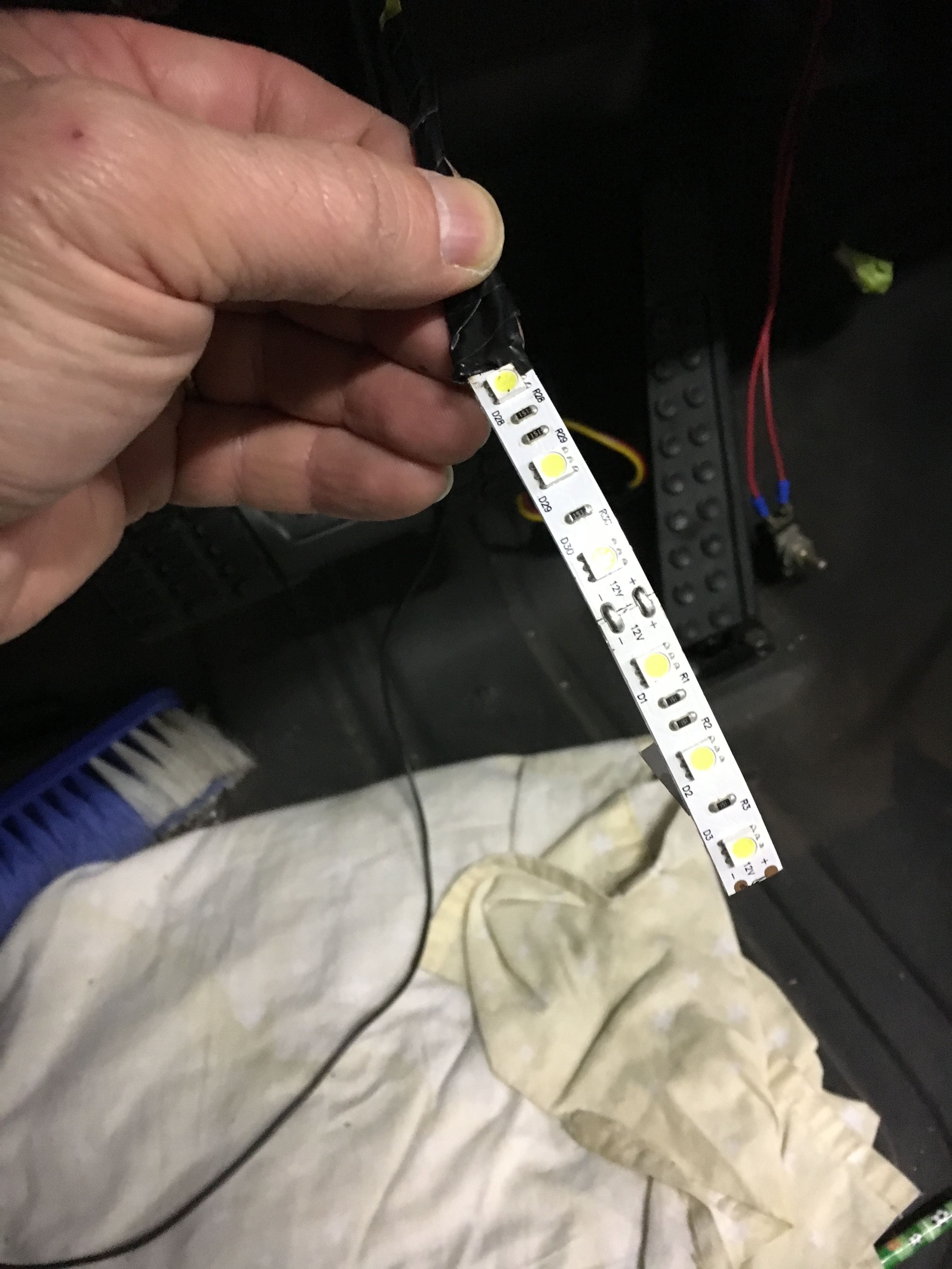

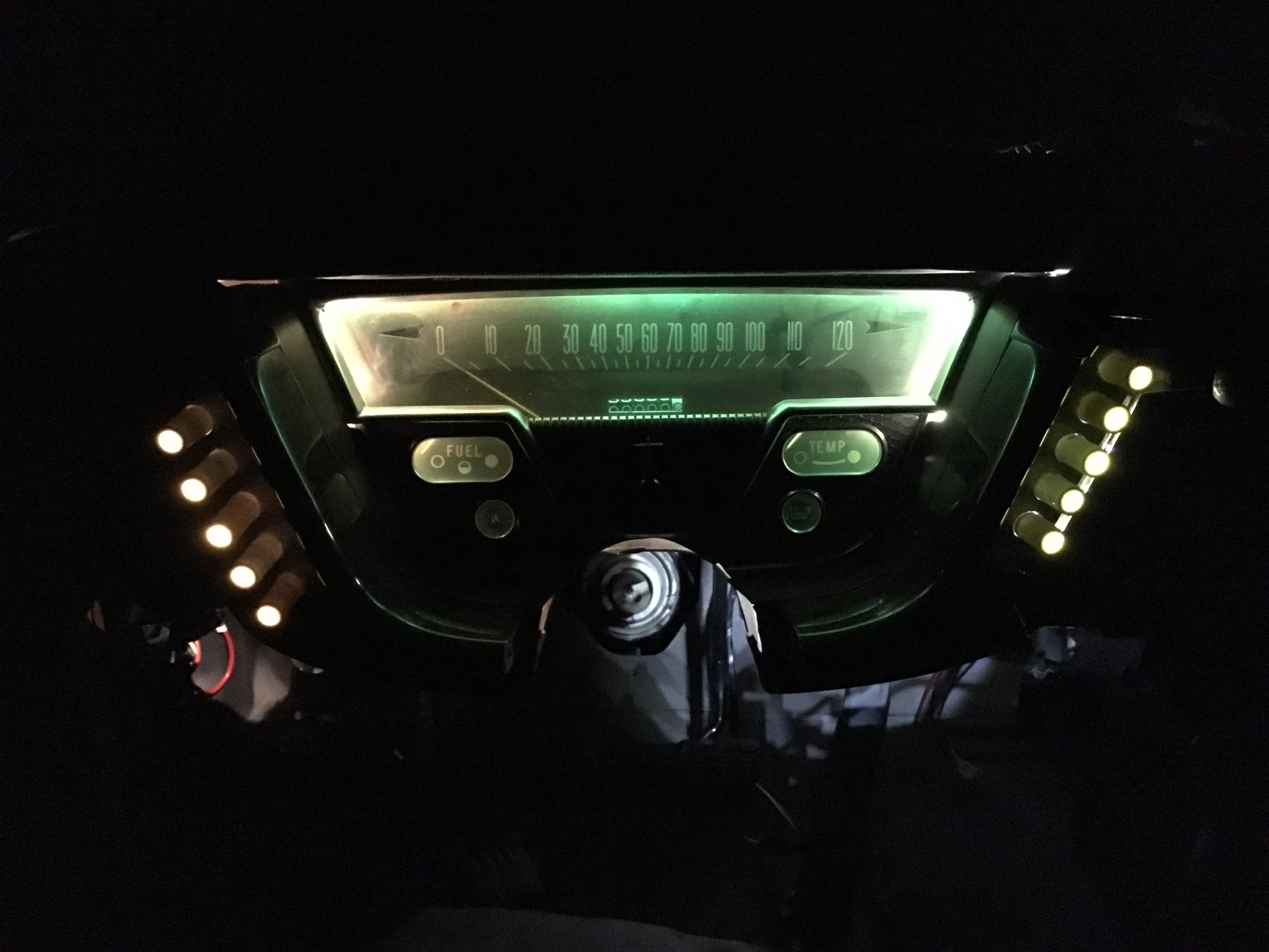

I’ve ended up getting an LED strip light and mounted it between the instrument panel and the heater control panel
Came out not to bad
Will just need to blank out the rear as it casts light onto the fire wall
Before
After
LED strip light
That looks good and bright, where did you find the strips.
Vic - Are those strips available in colors and are they dimmable. The bulbs l used are dimmable. How are they connected electrically.
Howdy
It’s just a typical electrical store called Jaycar
Runs a simple positive which I powered off if the light switch and then just earthed it to the housing
Cheers
Vic

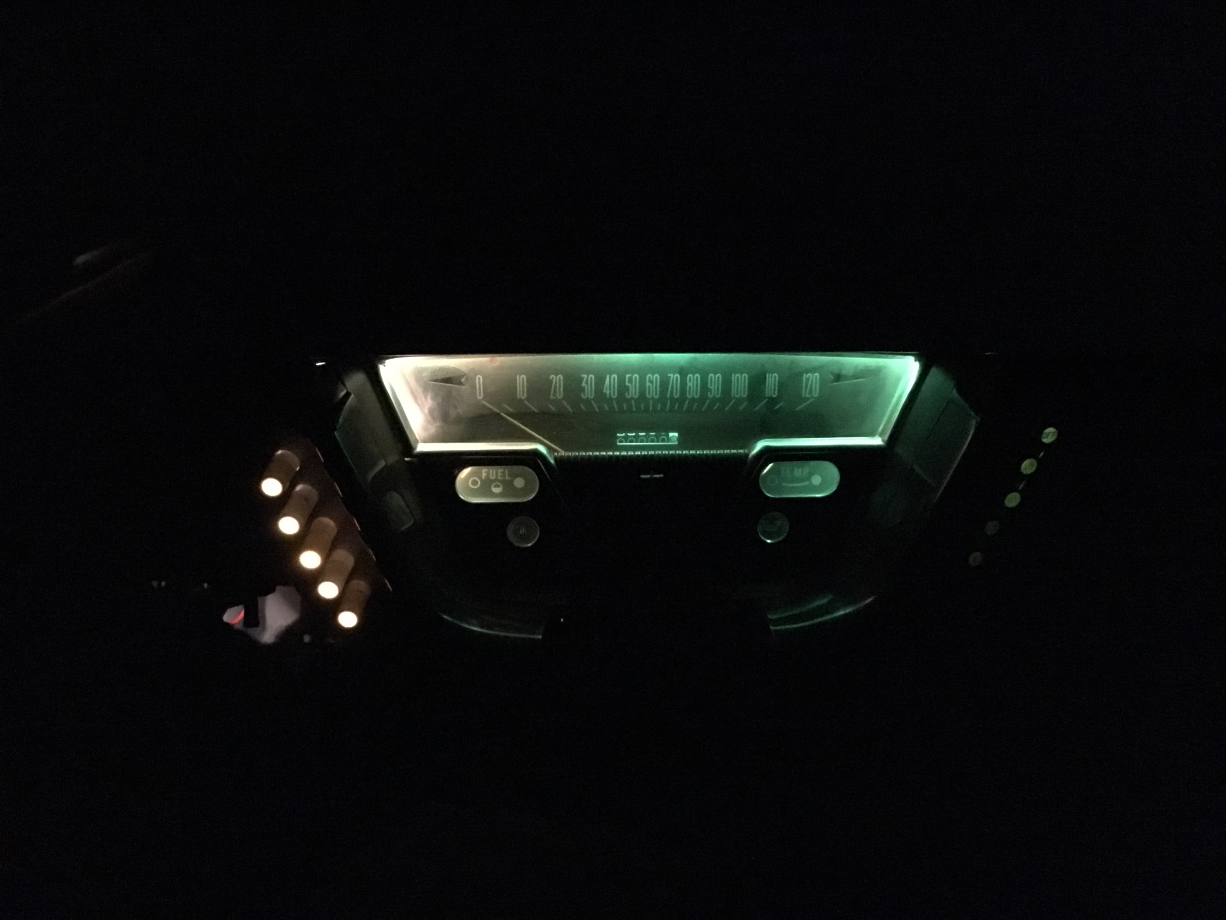

My concertible has a 59 Desoto shifter that has its own bulb mounted to the front of the shifter to light up the plastic pushbuttons. I replaced the bulb with a green LED bulb and oh my gosh, take a look. Will try a strip on the heater buttons like Vic.
Awesome
With the strip in place it will look even
Be sure to get one with a self adhesive backing
I then placed it in line with the plastic cutout
Bit of a tight fit getting in there
Cheers
Vic
Me again
I assume you could get colored ones
In terms of dimming they work well when I turn the dimmer toggle
