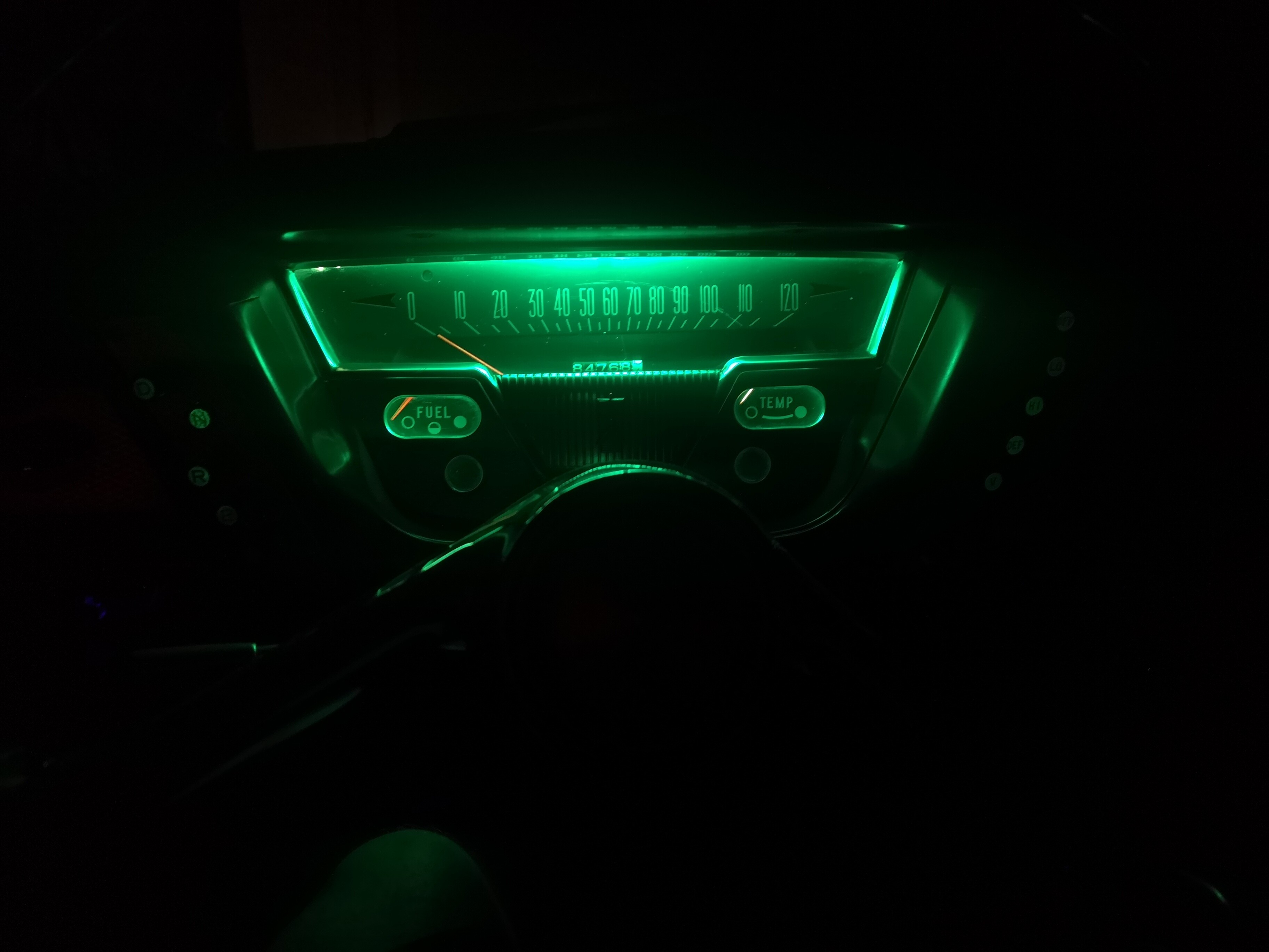

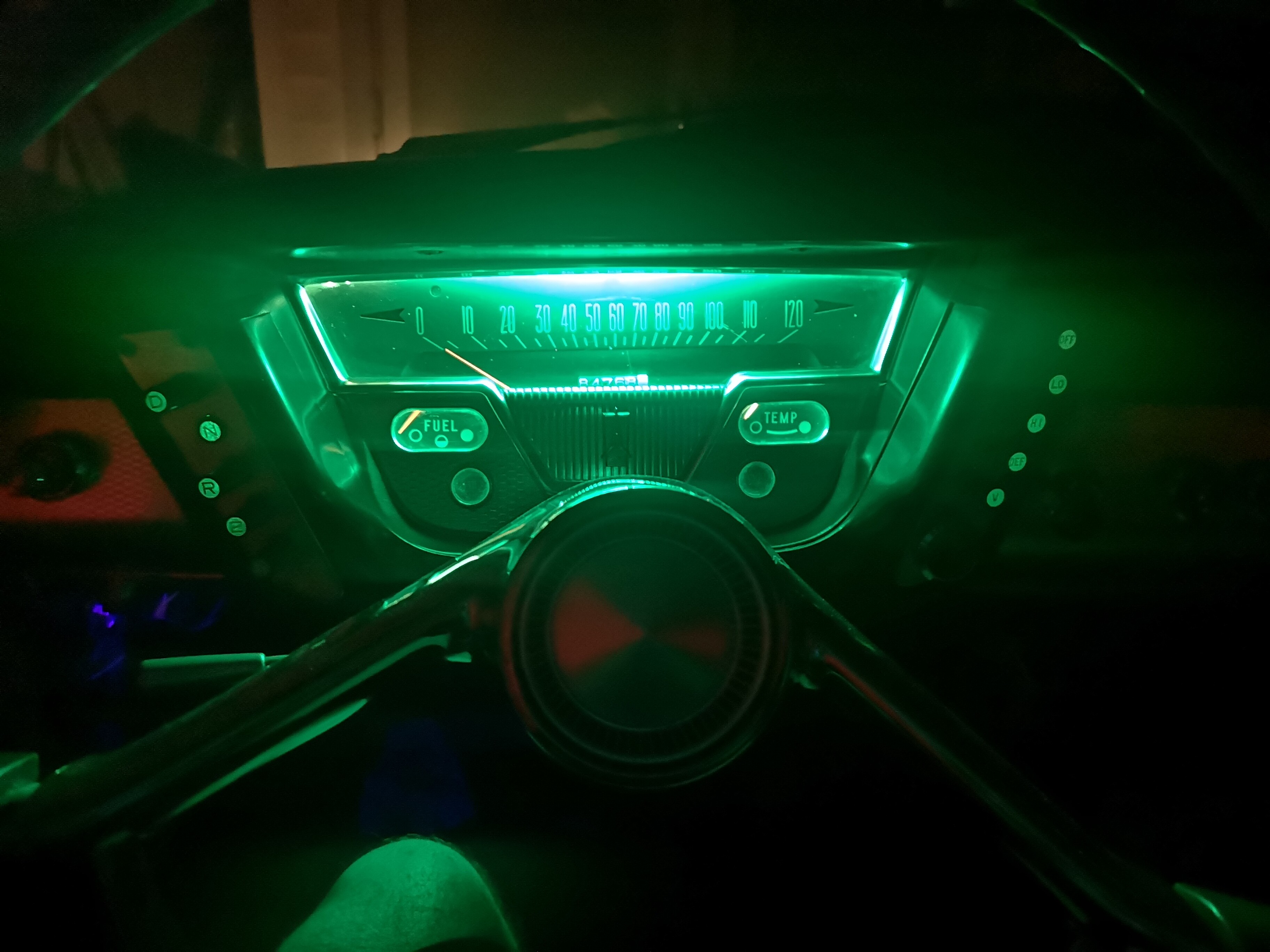

I changed out the bulbs with LEDs. You don’t retain the dimming feature with LEDs of course, but hopefully last longer so I don’t have to deal with that again for some time!
