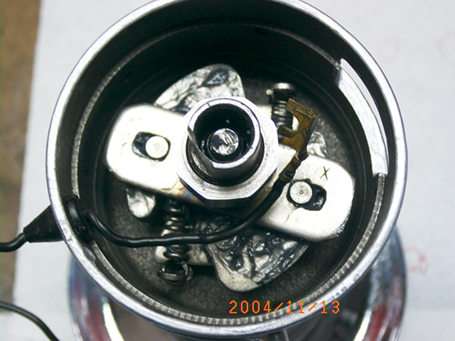

You have an un-original distributor, fitted with Pertronix, correct?
Distributors are designed for specific cars, so maybe you have a compatibility problem..Sure, it physically FITS, but what about the specs?

Hi Dan & Roger - Dan, I have the later distributor in my 59 Plymouth and my 60 Desoto, they are the same and take the same Petronix Kit #1381A, they are both working great.
Roger - My green 59 has an original dual point distributer. I installed a Petronix Kit #1382 and it also works great.

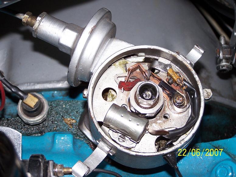

Let’s see if we can bring a little light into this darkness. The distributor has one mechanical advance (weights and springs inside) and one vacuum advance.
Looking onto the distributor it turns clockwise. When the shaft turns faster the weights are forced outside and turn the rotor cam a little forward (also clockwise) That way the breaker opens a little sooner and delivers an advanced spark. So far, so good.
Your (and my) carburetor now delivers low vacuum at idle (no vacuum advance) and more suction at higher rpm’s. That way the vacuum advance pulls now the breaker plate a little back (counter clockwise) and allows the breaker to open even sooner.
Means the vacuum advance supports the mechanical advance in the same direction. Sounds logical, doesn’t it? If the carburetor would have high vacuum at idle and low at higher rpm’s then the vacuum advance would work against the mechanical and equalize the effect, and that wouldn‘t make sense. Am I right or did I miss something and do I tell nonsense?

the shop manual explained it. The mechanical weights RETARD the timing.
The vacuum advance ADVANCES the timing, whichever is required for smooth running. It doesnt take much vacuum to move the points plate.
Start your cars, let them warm up so the idle is down, then pull off the vacuum connection and hear the engine speed change.
Since Dan has Pertronix, I dont know if this applies to his car. Is the Pertronix attached to the original breaker plate, which in turn is moved by the vacuum advance? (I dont mean to get off-topic)
Yes, it is – the only thing Pertronix does is eliminate the points. Everything else is the same, including the mechanical and vacuum advance.

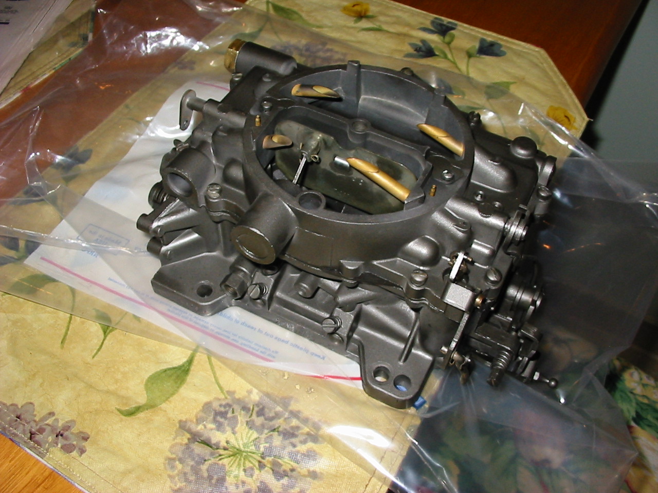

Let me tell you about my carburetor rebuilder. He’s the third generation that’s been doing this (Palacio’s – Cuban? Dunno). He’s holed away in a little storefront on North Broad Street in Philadelphia. Got two yappy dogs that guard the counter while he’s in the bad yard tinkering (the back of the store is entirely open to the yard. Charged me $140 to rebuild – painted the entire carb with lacquer, his own special mix of metallic silver and black. Looks gorgeous – like brand new, doesn’t it – but does it work?! I asked about putting anything on the gasket, he suggested a little bearing grease – which I did.
I put it back on the car, warning Marie that I would have to crank it for a while because I needed to get gas into it; and that it may not run right until I adjust it. I turned the key – varoom! It was instantly running!
As before, I had to crank down the idle screws because I was running too rich; I also had to turn down the idle (a bit too much, I’m afraid, I’ll have to nudge that back up). But Faulker was running smooth as silk.
And inexplicably – I’m still getting virtually no suction at idle, Stefan. I’m not sure I’m getting any at higher RPMs, either; and at idle, when I remove the vac advance from the distributor, I get no shift in timing whatsoever. So, I dunno. It’s a mystery to me; but machts nichts – it’s running great now.
