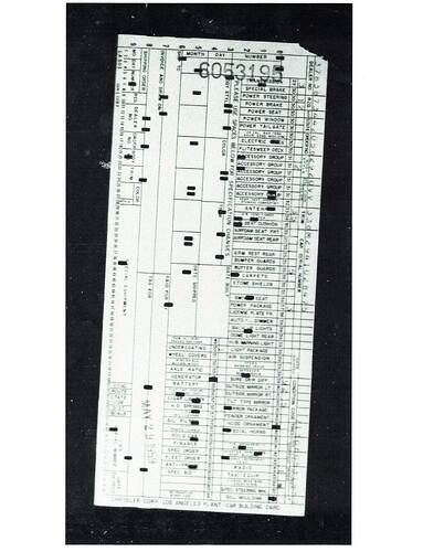

Looking for some Info On my 1959 Sport Fury.I just received my Punch Card from Chrysler and I think I have some of it figured out but would love some one to check on my work and get more info on the car.thanks
Here is what I have translated.
Sport fury 2 door hardtop base price $2927.25
293-torqueflite 3 speed automatic $ 226.90
301-Power Steering $ 76.60
302-Power Brakes $ 42.60
312 accessory Group(backup lights,windshield washer,variable-Speed Duel Electric Wipers)$ 27.85
333- Dual Rear Antenna $ 12.45
345-Heater Hot water with Defroster $ 74.40
355-Buffer Guards (Frount and Rear Rubber Inserts) $ 13.50
373-Golden Commando 395 Engine $ 86.50
399-Sure Grip Differential $ 49.70
402- Remote control Mirror ,Left side Only $ 17.75
405-Mirror Matic rear view mirror $ 16.10
441-Push Button radio with Antenna $ 73.00
501-Undercoating with fiberglass pad under hood $ 12.85
Total $ 3657.45

Hi Speekfreak1984 (real name?), I took the liberty of rotating the card and cropping it here:
Will is right, Matthew is our resident decoding expert. I’ll give him a headzup and ask him to comment.
Saved and I’ll print it in a minute.

Printing was not a success so I went over this quickly on my phone. Next post will have some more info!
Body style - 292 = Sport Fury Hardtop
Trim - 338 = Copper interior
Paint - VV = bronze body and top (copper)
VIN - M294102847
M-1959
2-Plymouth, V8
9-Sport Fury
4-Build in L.A
1-sequential number
02847-2847th Sport Fury build in L.A
Options:
Tires - 13 = 8:00x14 4 ply whitewalls
Transmission - 293 - torqueflite
Power steering - 301
Power brakes - 302
Accessory group - 312 (back up lights, windshield washer, variable speed windshield wipers)
Antenna - 333 - dual rear antennas
A/C-heater - 345 - Hot water heater
Buffer guards - 355 - rubber bumper guards
Power package - 373 - Golden commando
Sure grip - 399 - probably a 3:31 ratio
Mirror - 402 - remote control, left side only
Tilt type mirror - 405 - mirror matic
Radio - 441
Undercoating - 501 - also has the underhood pad
Solex safety glass, tinted - 466
With these options, you might have more but I need to dive into the build card, this car was $3755.00 back in the day
There’s more coming! I checked the punch codes and it also has 466 which is solex tinted glass.
Updated the decode post with the solex glass and corrected the price! Any more questions about your car? :mrgreen:

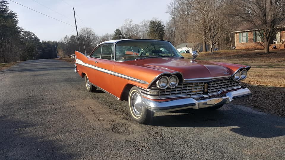

Post some more photos of your car, I’m dying to see more of it and hear where you found it!!

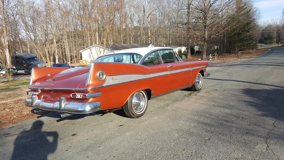

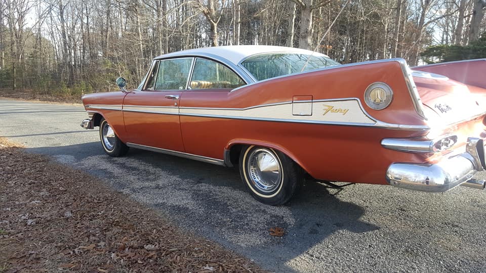

Thanks for the info.Here is more pics of the car. You can also follow the project on youtube.

The fabric inserts on the seats and door panels are non original and it’s missing the buckles. Dash pad has been replaced too as it needs to be black to match the black dash.
The clock and ash tray + lighter are standard equipment on the Sport Fury.
It’s looking really good though!! What are the plans for it?
I know this is a Plymouth forum but that cts-v :astonished: that’s awesome
The guy i bought it from had the interior done so i thought there was some things that were not original but they did a good job.The motor was rebuilt in 1990(I have receipt). My plan is to get all the bugs ironed out of the drive train and drive it on the hot rod power tour this year.Just pulled the transmission last night and looks like I have coolant getting into the transmission. :angry:

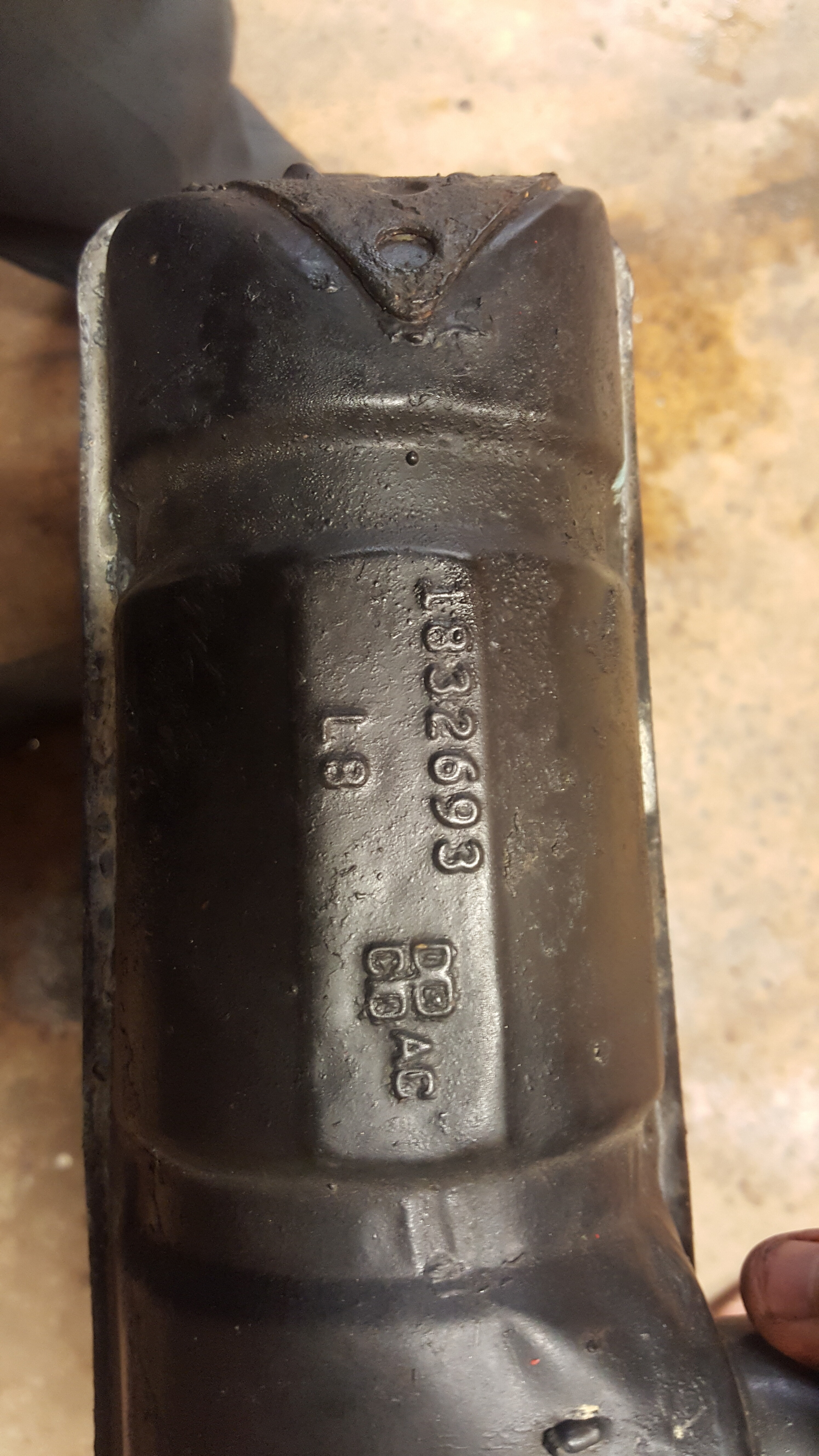

Does Anyone have the radiator number available so I know if it’s original?Could also use the number on the transmission.Thanks
According to the parts manual the radiator is part number 1832 691 with an automatic.
High capacity radiator is 1832 298.
Radiator with A/C is 1832 897.

Do you know what year this radiator came out of. It’s what was in the car
