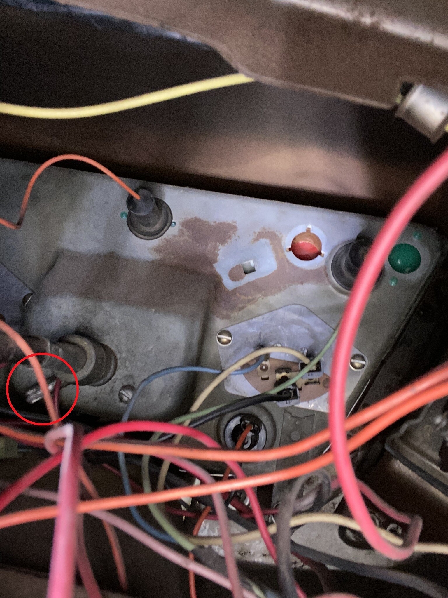

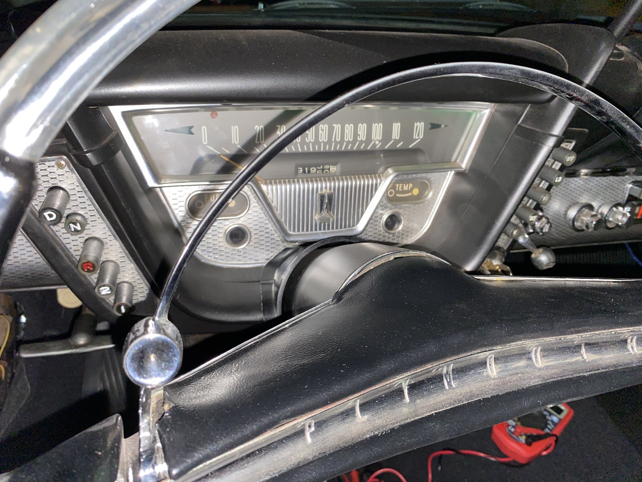

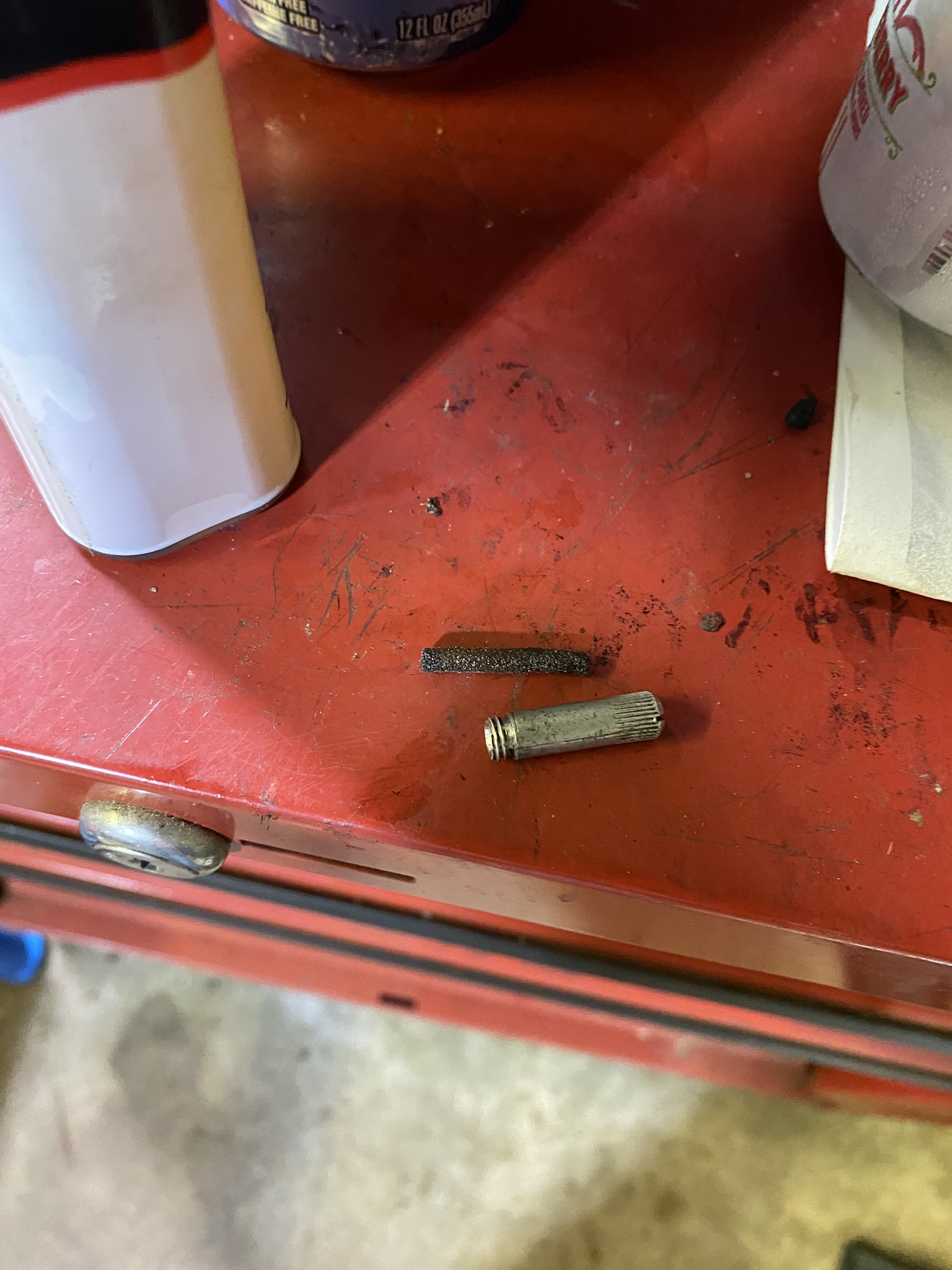

On a test drive, I noticed that the speedometer was a littly jumpy; I removed the lubrication wick holder, and found that the wick was bone dry. I doused the wick in 3-in-1 oil, and went to put back in… And that’s when I nearly lost it. What a royal b*tch! So much easier to remove, than to put in. The holder is angled both down, and away from the housing - and it’s a fine thread. I dropped it several times and had to get out my light scope to find it.
wick holder circled in red
Fortunately, I had a spare panel with a wick and holder. I decided to use my spare, and after another hour of cussin’ and fussin’ I got it to take. The jumpy speedometer is gone, but I can tell you, I’ll never be doing that again - those are many hours of my life that I will never get back.

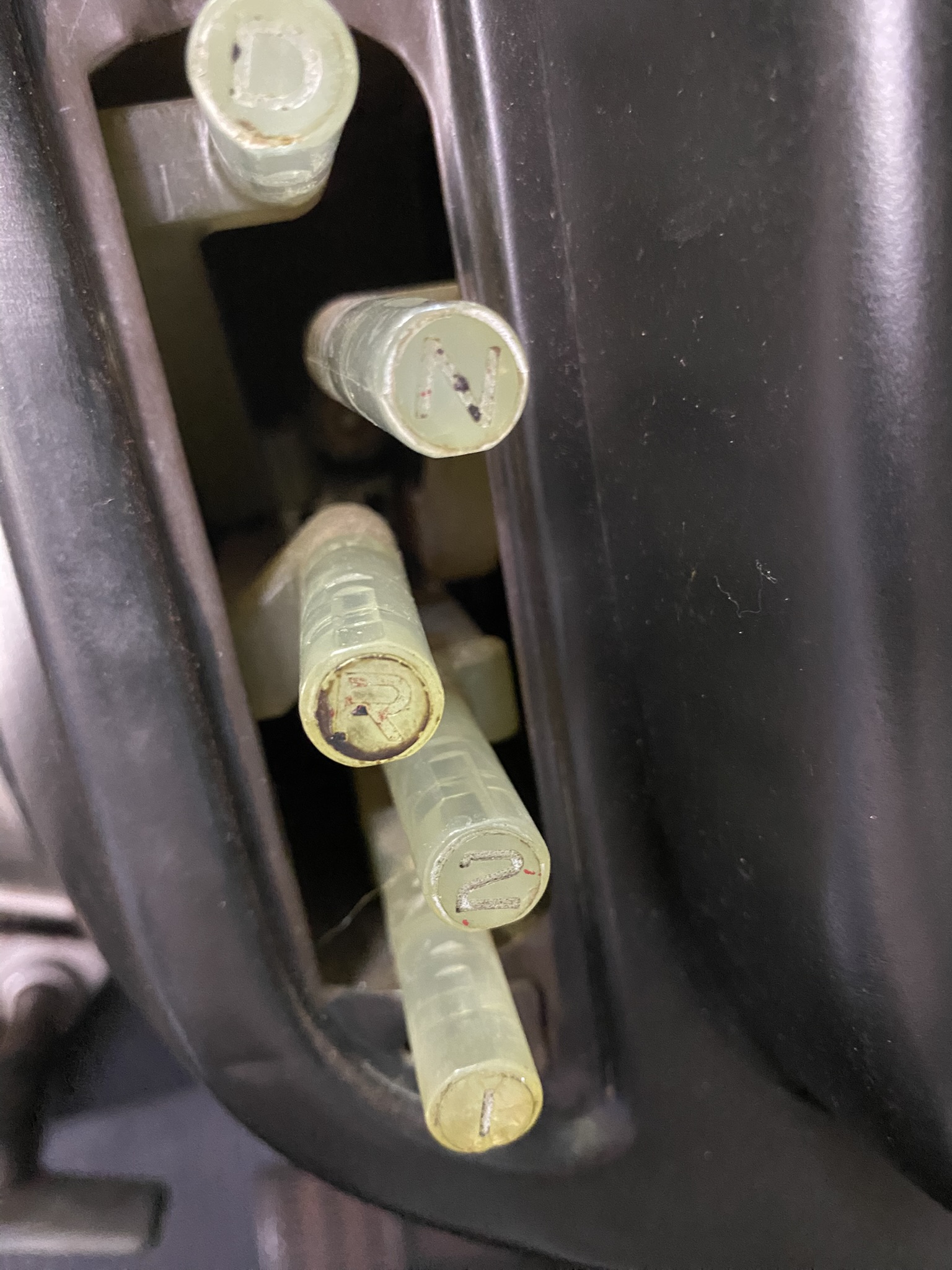

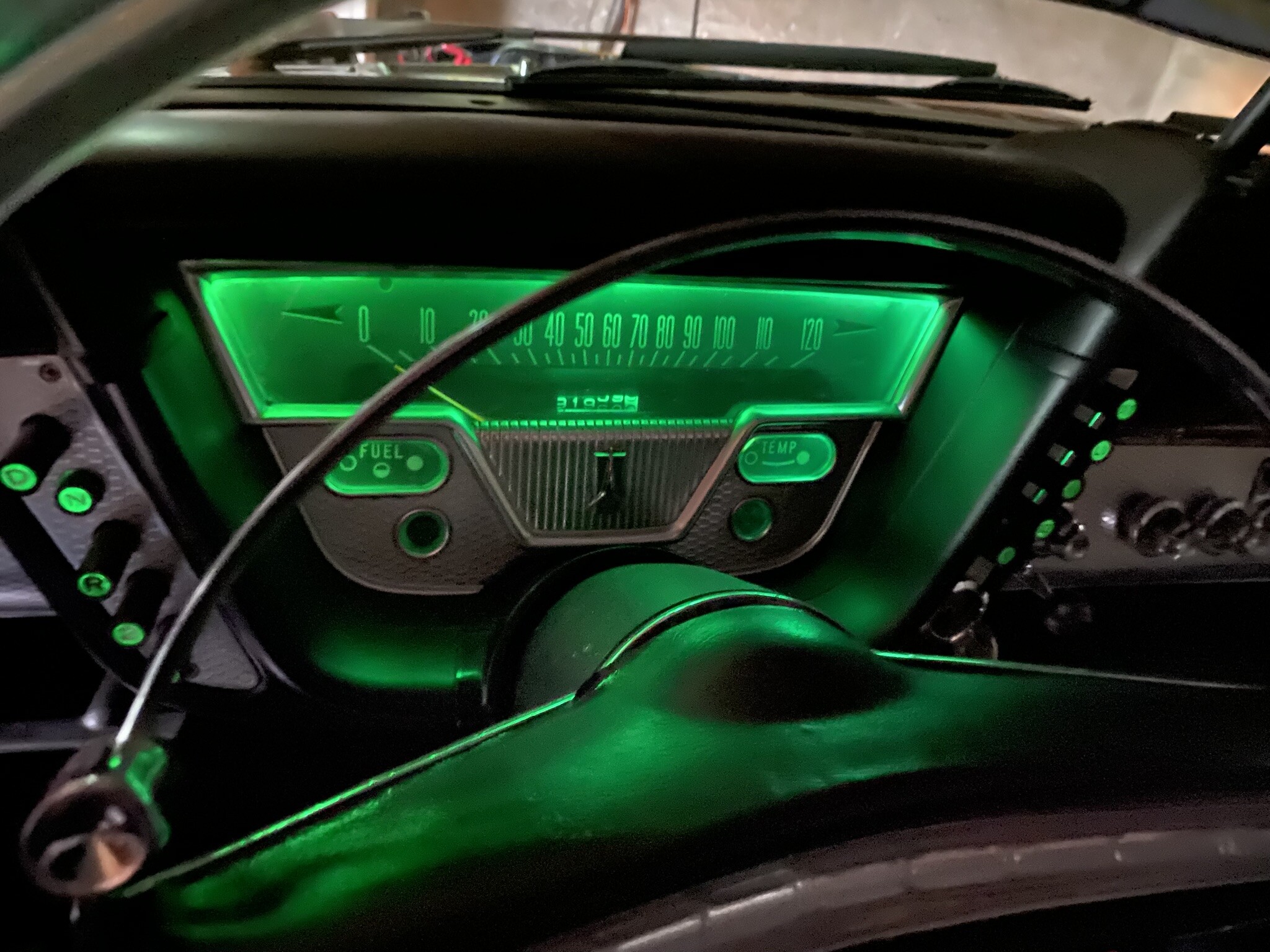

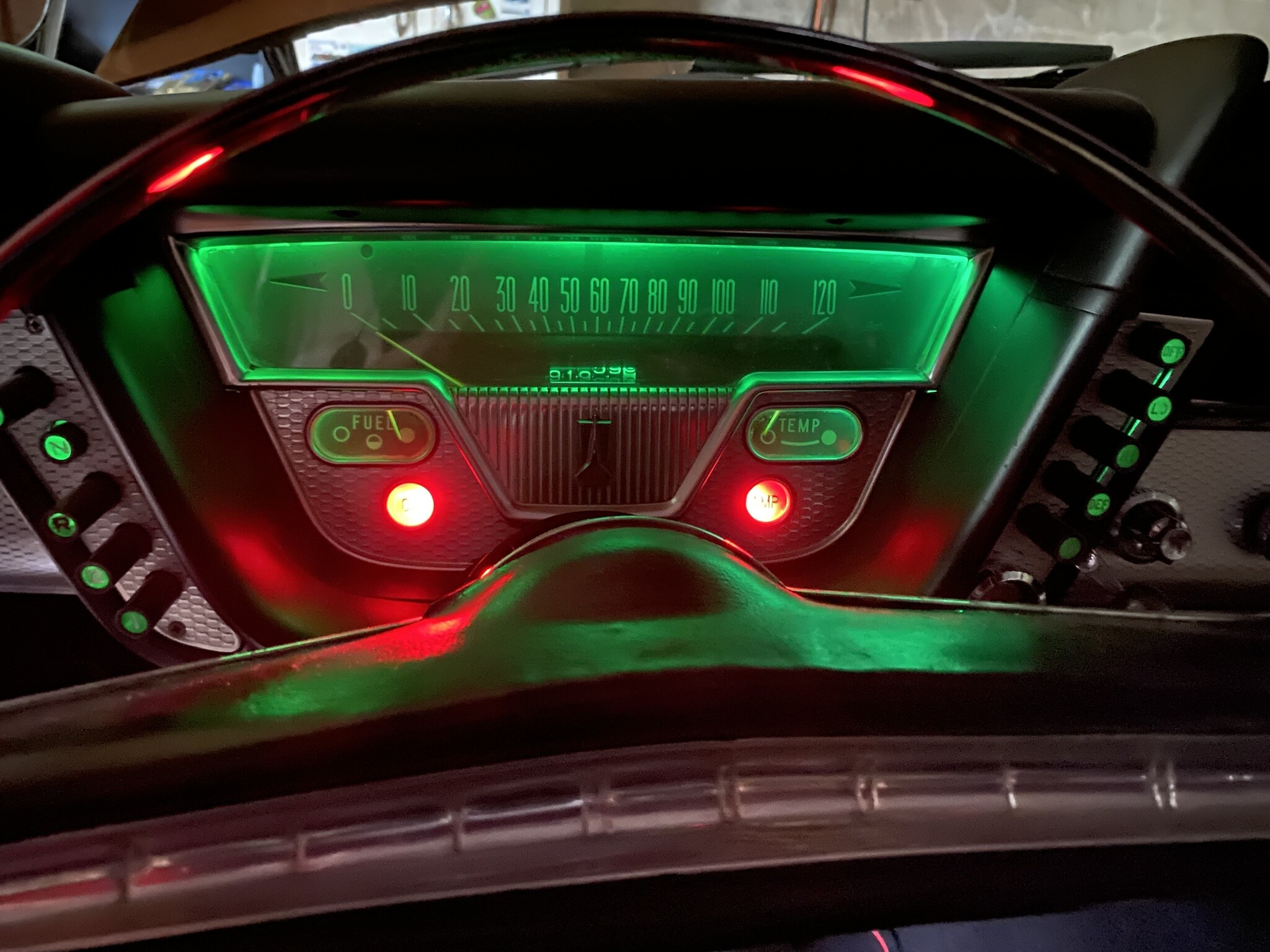

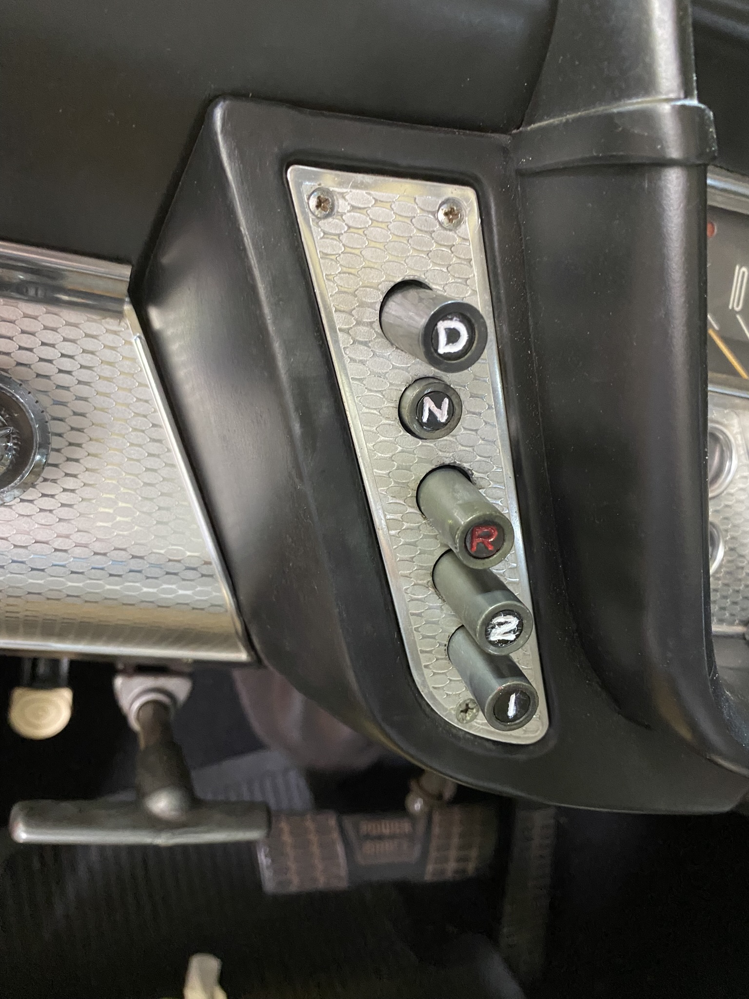

Years ago, Matthew had given me a bag of red and green LED bulbs for my dash. I finally got around to replacing them. Also, Dick had graciously given me a set of torqueflite pushbuttons that he had made - time to put them in too.
Pichuhs. Getting some of those bulbs in was no walk in the park either.

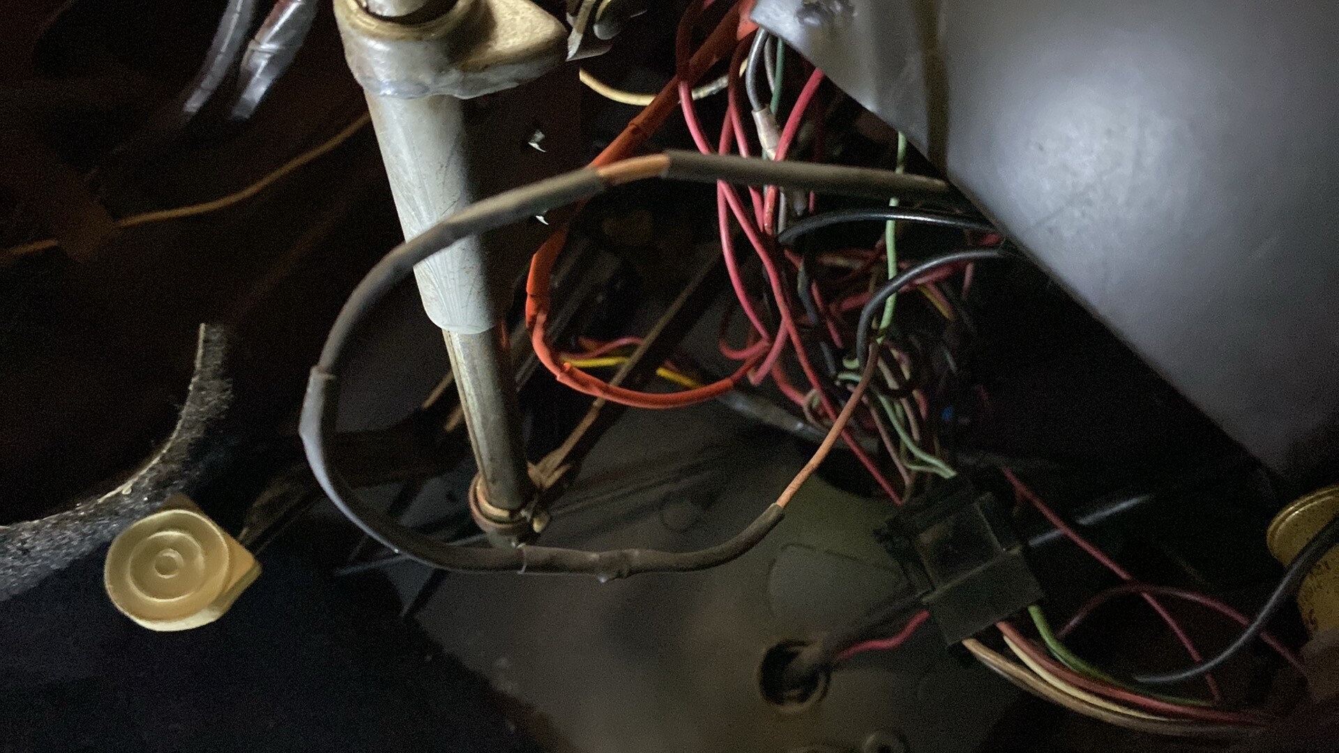

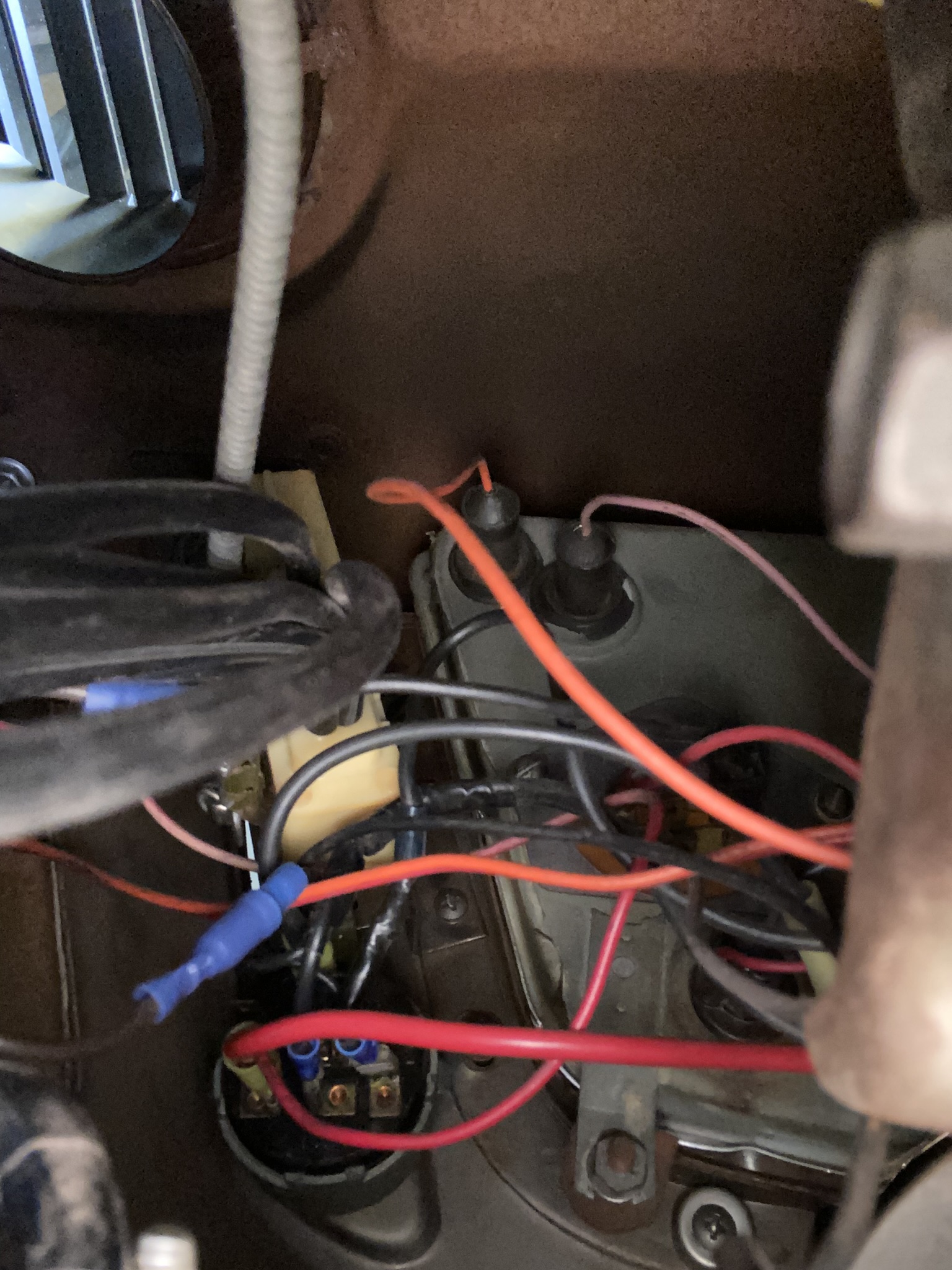

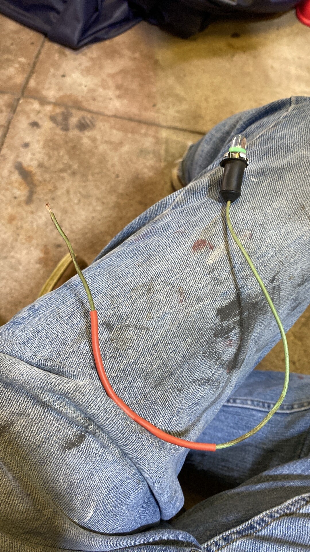

While I was under the dash, I found some wires that had been taped up, obviously after melting together :imp: I cut out the bad sections, slipped on heat shrink tubing, extended wires where necessary, soldered all connections and shrank the tubing. Came out pretty well, I think.

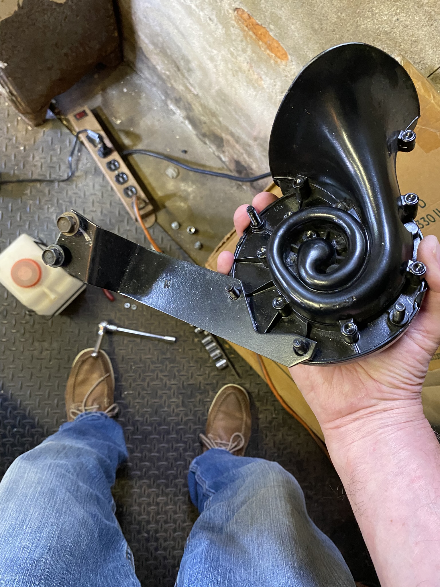

I gave fixing the horns another try, this time cleaning the contacts with emory paper. Well, they work; but not all that well. This one remains on my “To Do” list.

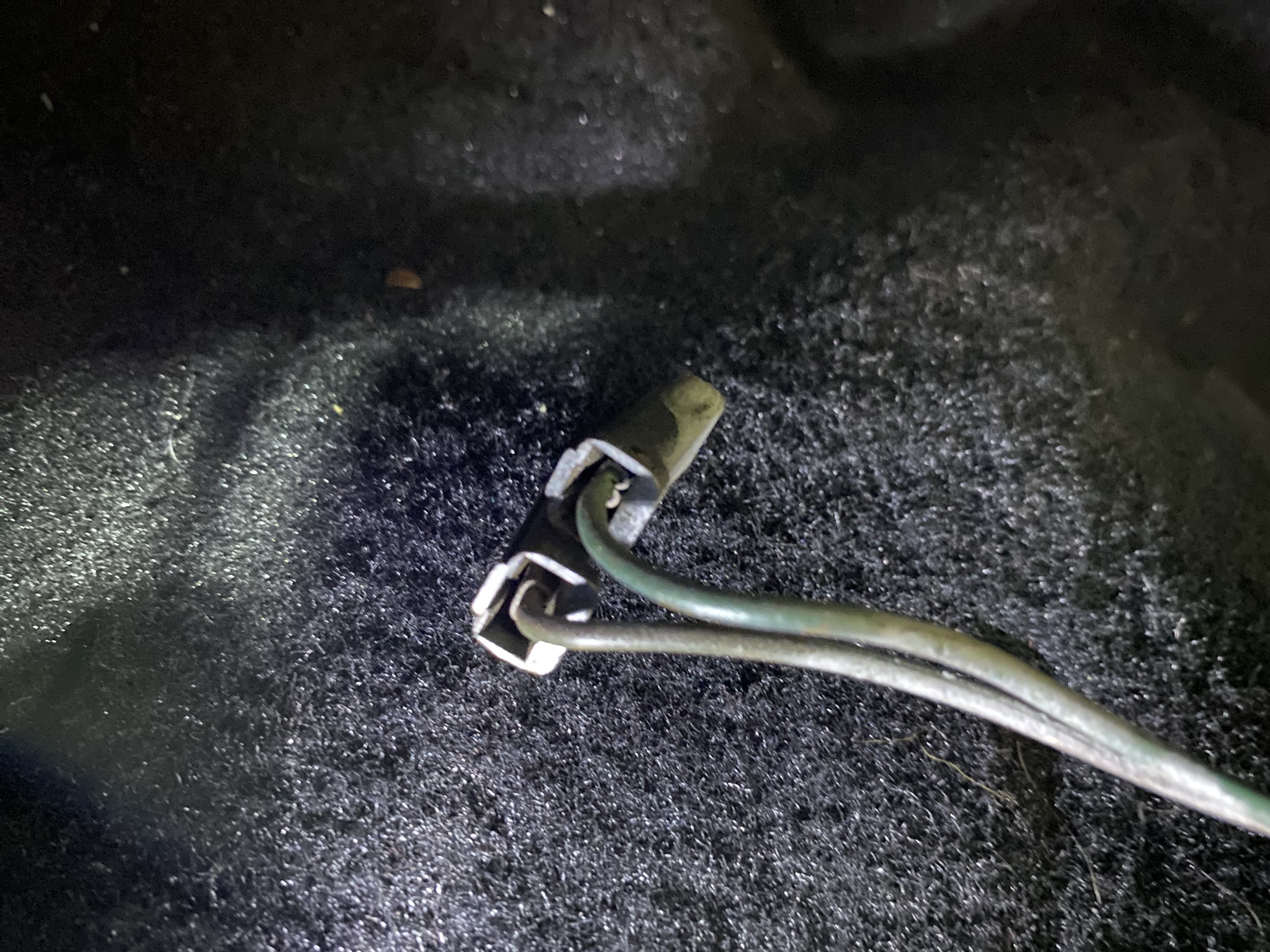

I found the blower motor connector tucked behind the vent. This goes to the vacuum switch

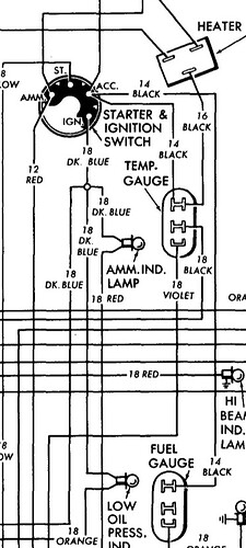

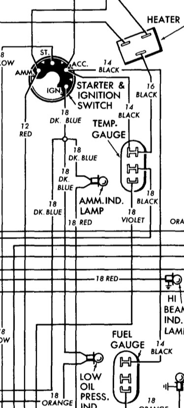

But very little else about the wiring made sense…
…certainly, things were not connected as shown in the shop manual

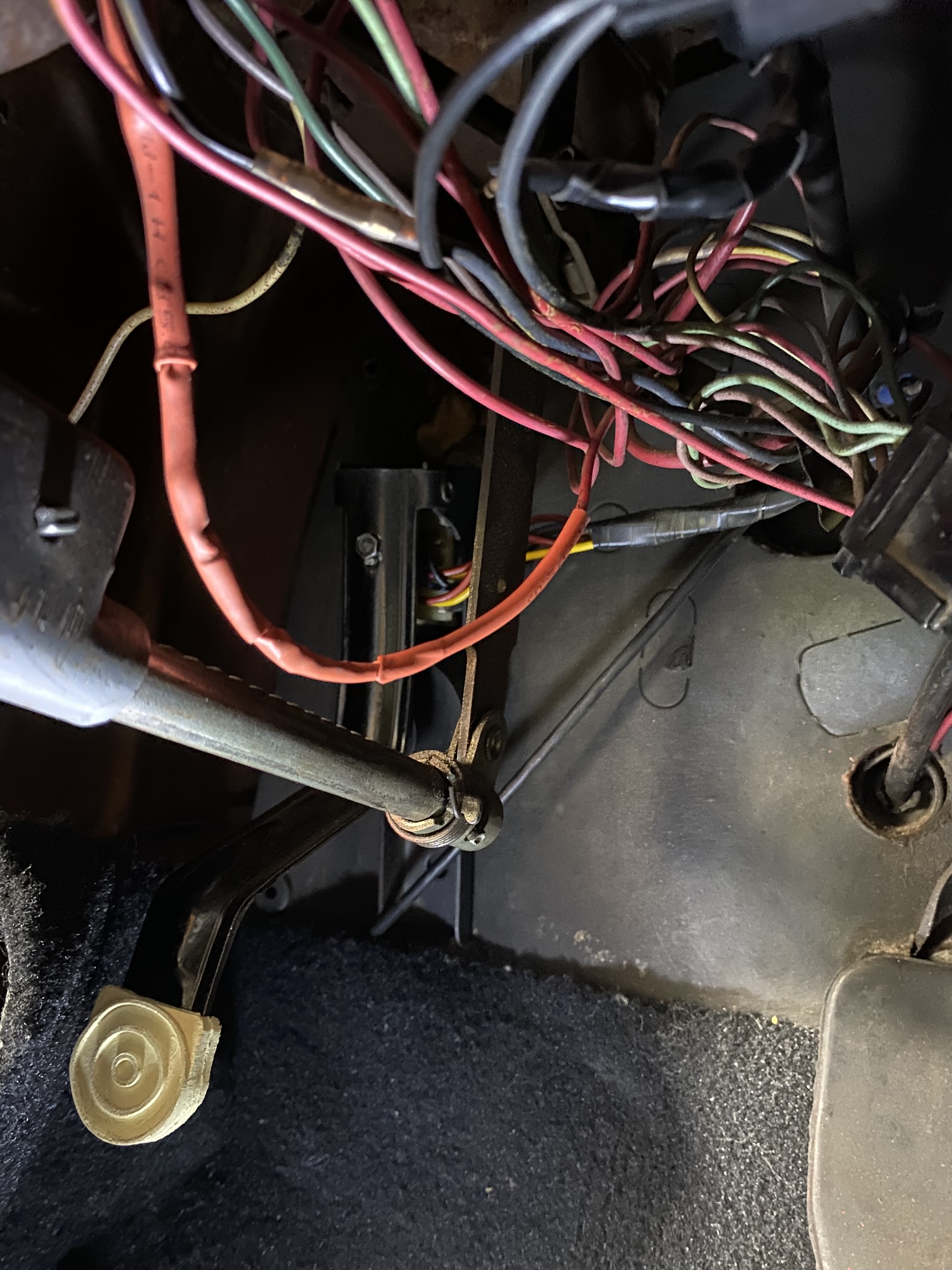

I determined that the power to the blower came not from the ignition switch, but from a spare tab on the temperature gauge (which in turn received power from the ignition switch). This wire was missing, so I made one.

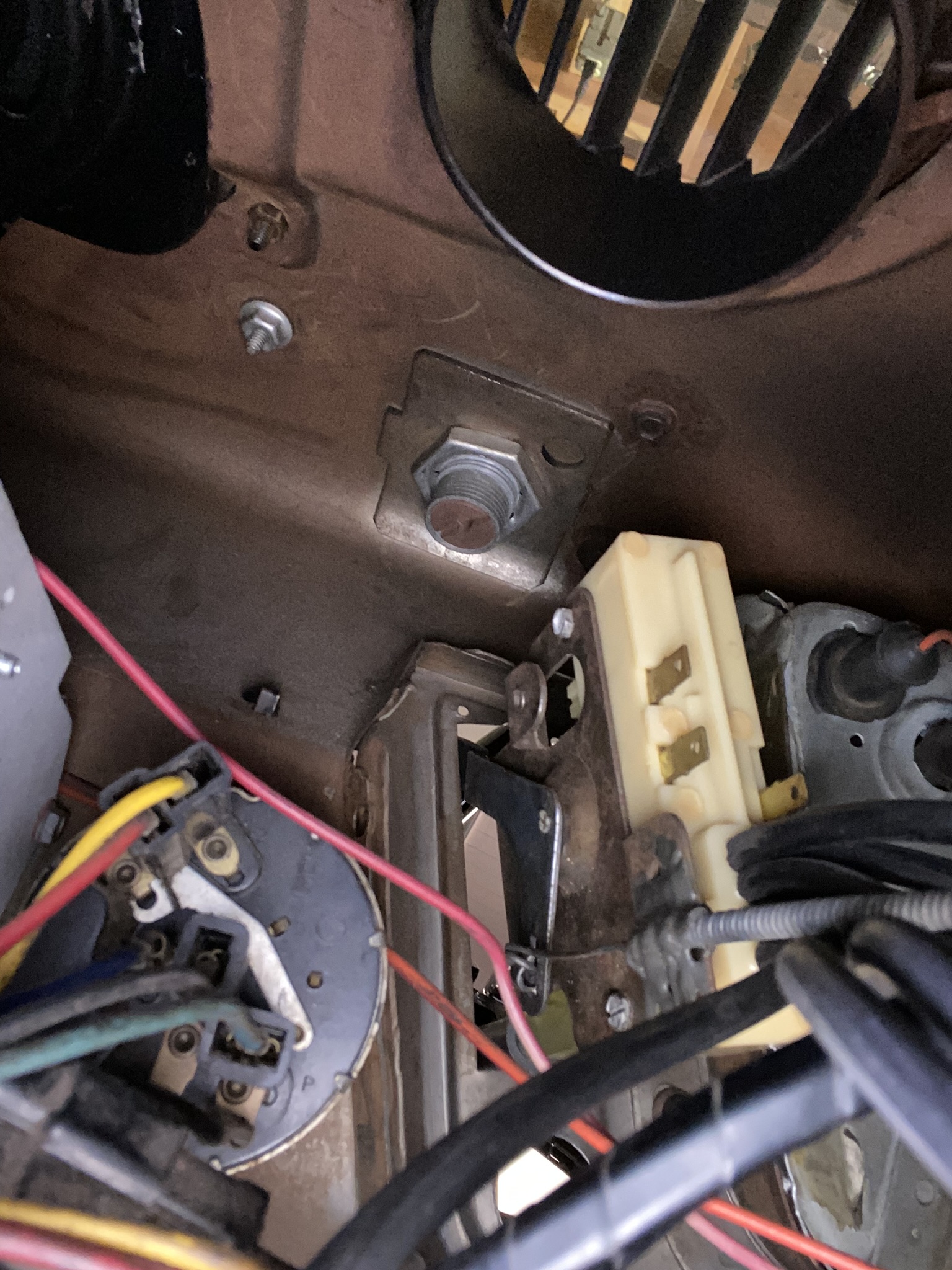

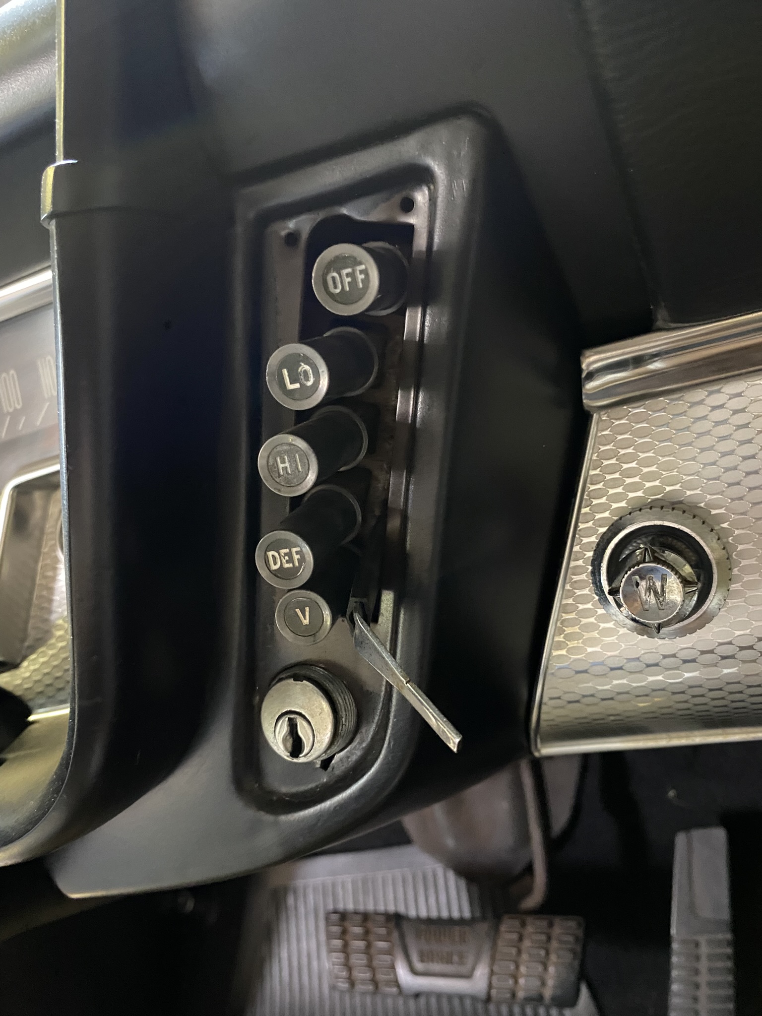

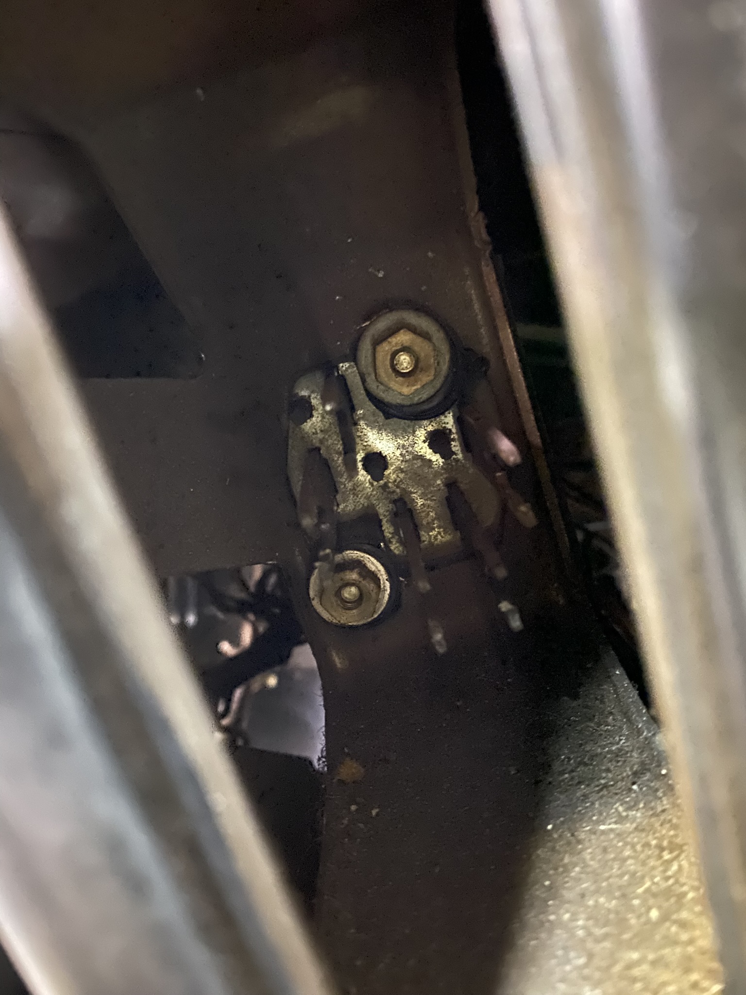

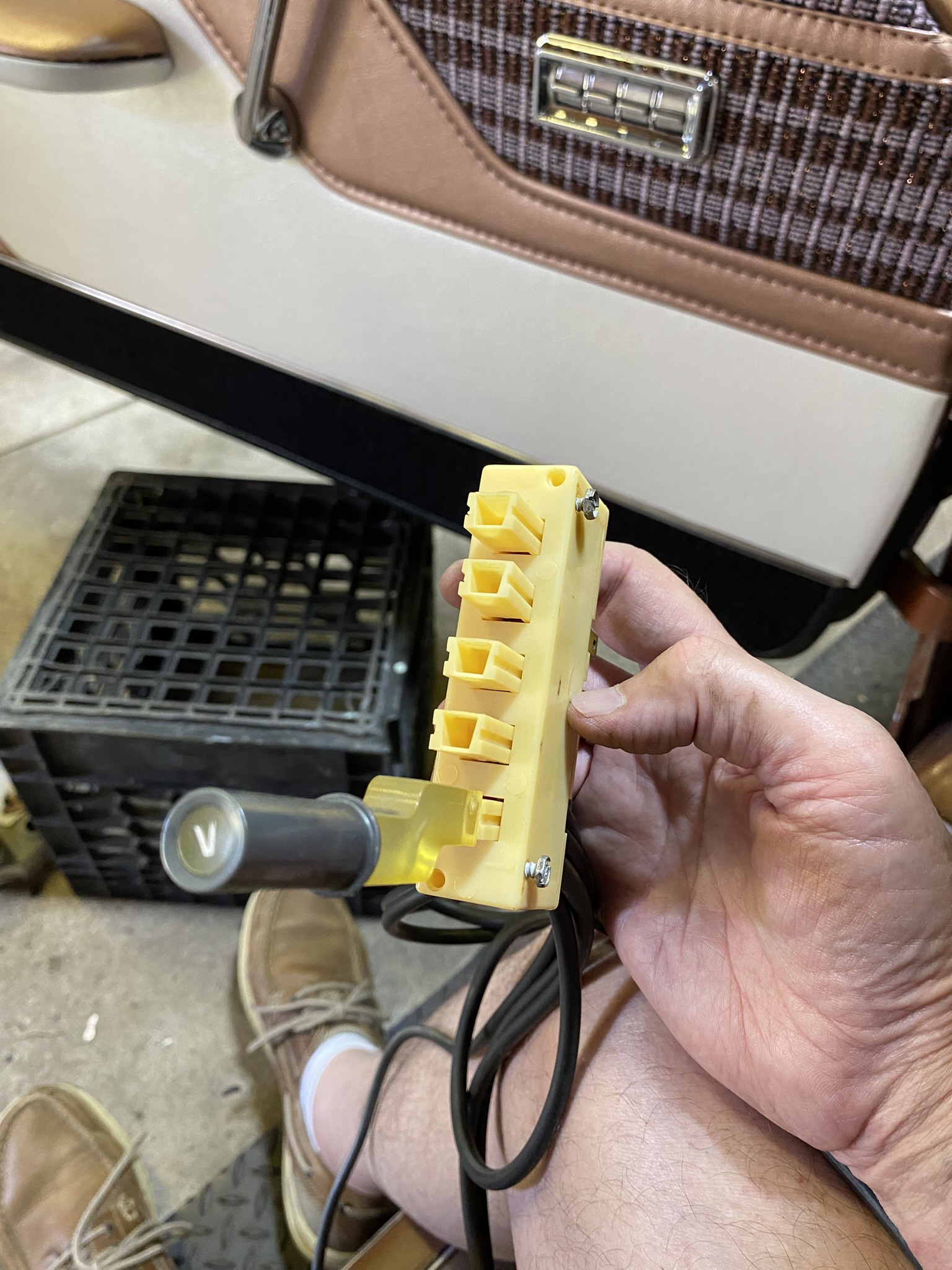

I was able to remove all the buttons except for the bottom V(ent) through the face of the dash, but the lip of V caught on the dash. This will have to come out with the switch
I was able to twirl a 1/4" socket on the top and bottom screws into the vacuum switch plastic, that holds it to the bracket
…and the switch is out! The rebuilt one went back in the same way
