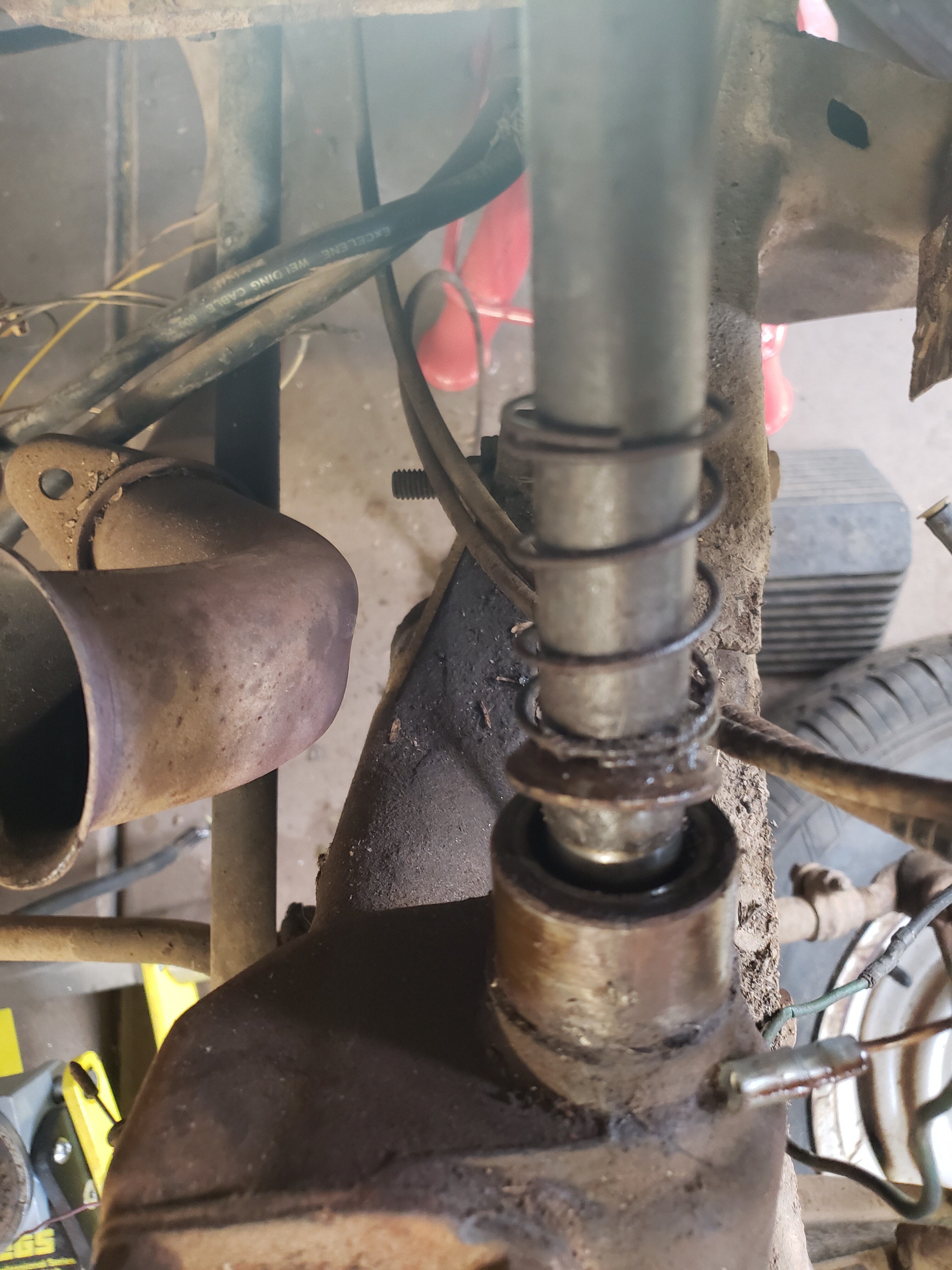

Old thread but only one i came across. On a manual steering car, once i have the tube off etc. How do i get the shaft out? I dont see a snap ring or roll pin on the manual style?
