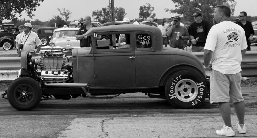

Thanks for the welcome guys. Gotta be careful about asking me for more pics. You don’t know how many you’ll get!! I’ll start off easy. Here’s one of my 31 Pontiac. It’s got a 354 that I ran with 4 stromberg 97’s before the 671 bug bit. I whittled the pulleys for the v-belt drive myself. Ran a best of 13.21 @ 102.3 with the Strombergs and a 12.10 @ 115.10 with the blower.

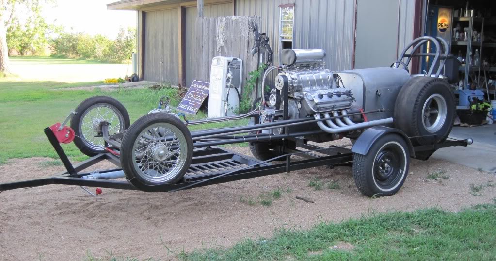

And here’s the digger. It’s a copy but not a pure recreation of a early 60’s Dragmaster Dart. My only real concession to modern stuff is the shorty Turbo350 although I did beef up the cage in the back. I just couldn’t afford what a good slipper clutch and bell cost. I’ve gotten down the track but not all that gracefully yet. Not trying to be competative, just trying to get some early sixties seat time. Got some bugs to work out. I’m addressing a couple of broken 1/4" pushrod adjusters now by having my rockers converted to adjustable (5/16 cup) and will make some 3/8 pushrods to length. The rockers hit the mail tomorrow.
