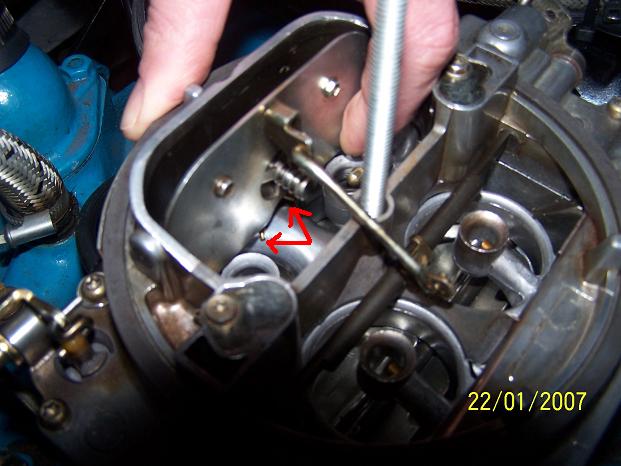

Hello Dick,
Your problem sounds so familiar to me. Here’s what I think about it:
  1. Acceleration Pump. Before you buy a new acceleration Pump check the current one. Just remove the air filter housing, push the throttle and lock into the front butterflies of the carburetor. (I’ll take you a picture tonight.) There are two little jets. If there is fuel coming out with a strong ray then you don’t need a new one. The 3 holes in the bracket allow you to adjust the amount of fuel that is injected every time you hit the gas pedal. The closer to the carburetor housing, the more fuel is injected, but this doesn’t cause black smoke.

Hi All,
John is probably closer to the cause of this problem. I assumed that the carburetor was properly rebuilt. Anyhow, here is the promised picture.
Stefan
