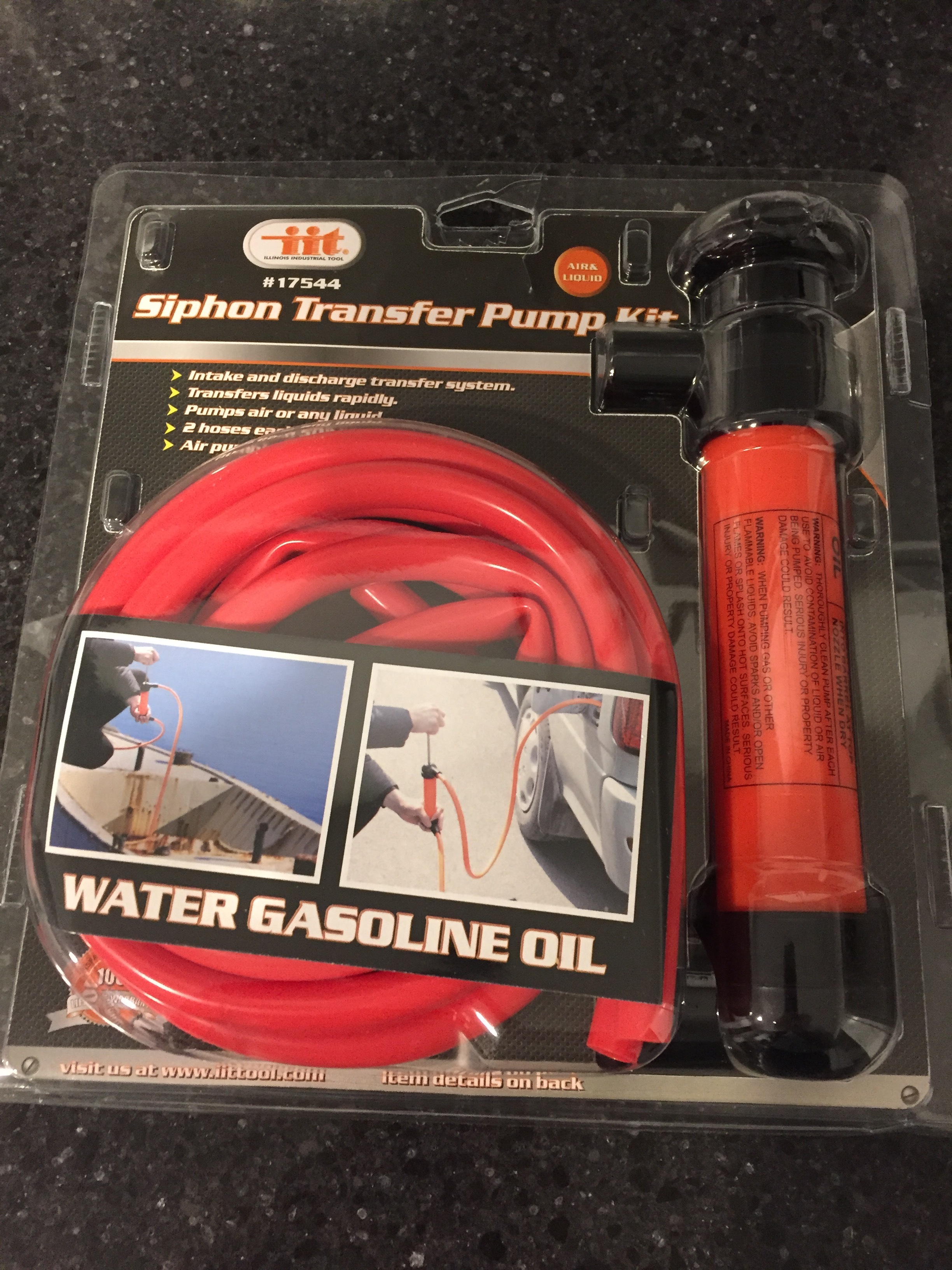

I ended up buying a transfer pump from Amazon - here’s a link.

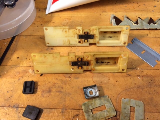

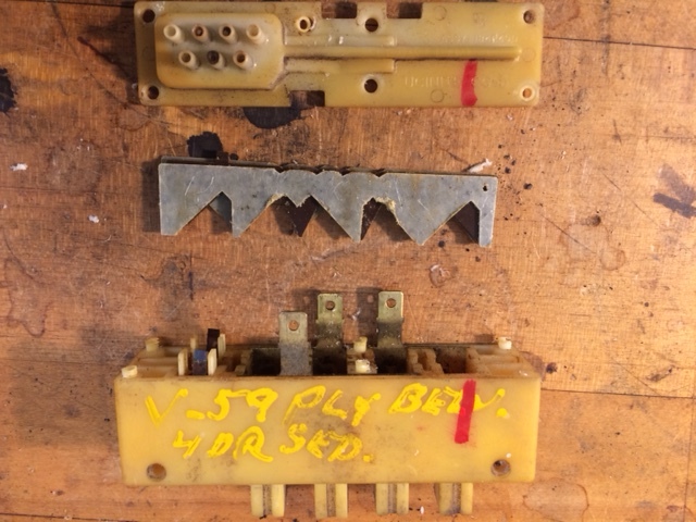

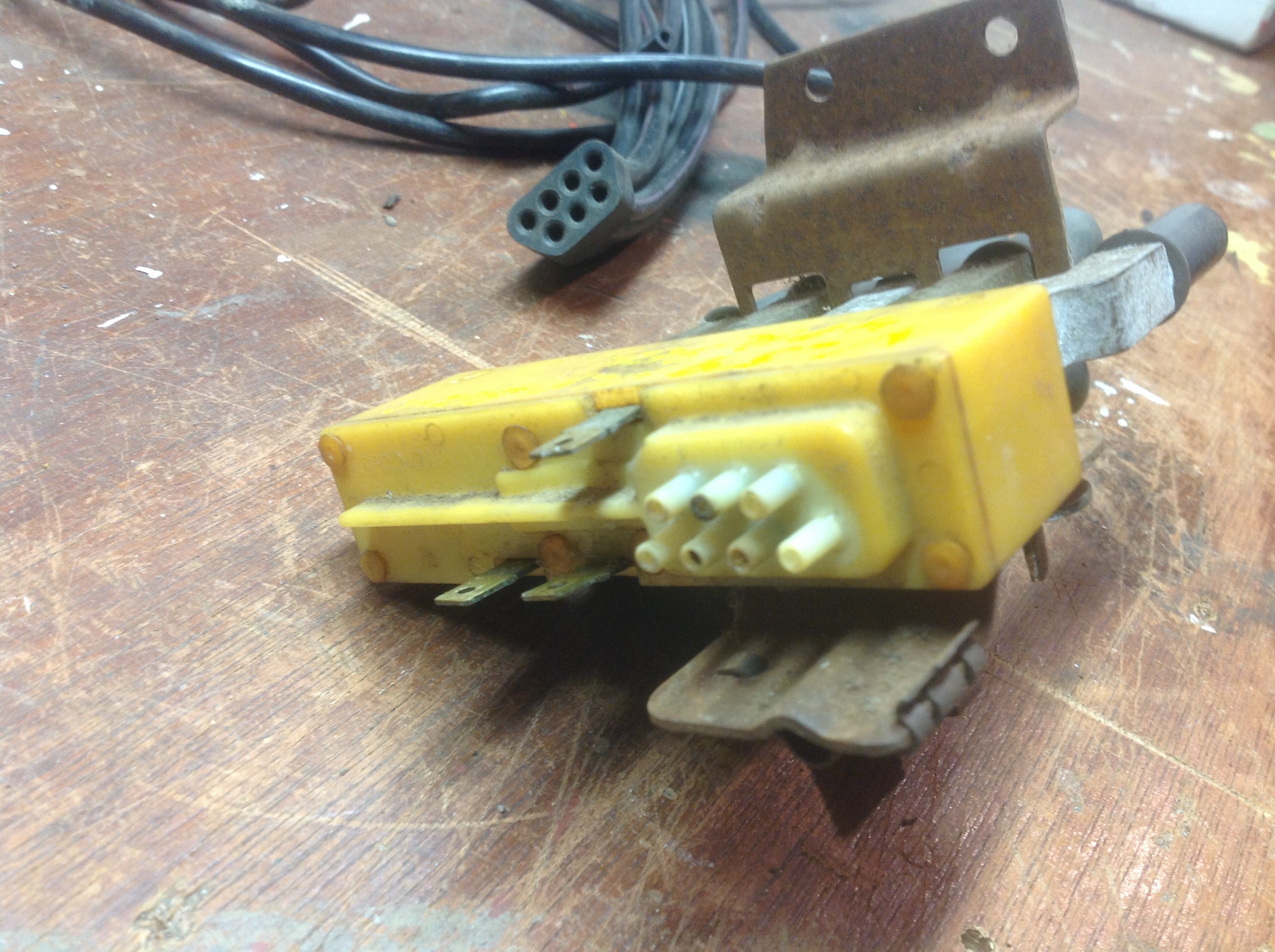

I’ve attached pix of two units I have, I think the first is better than the second, but I’m not sure what might be going on in the inside. Both have all their pins, and no sign of melting. Should I send them both to you to evaluate? Do you need me to send the female connector as well?

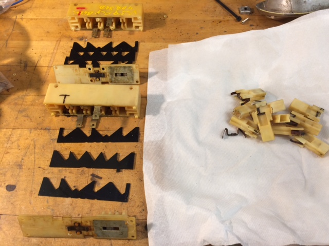

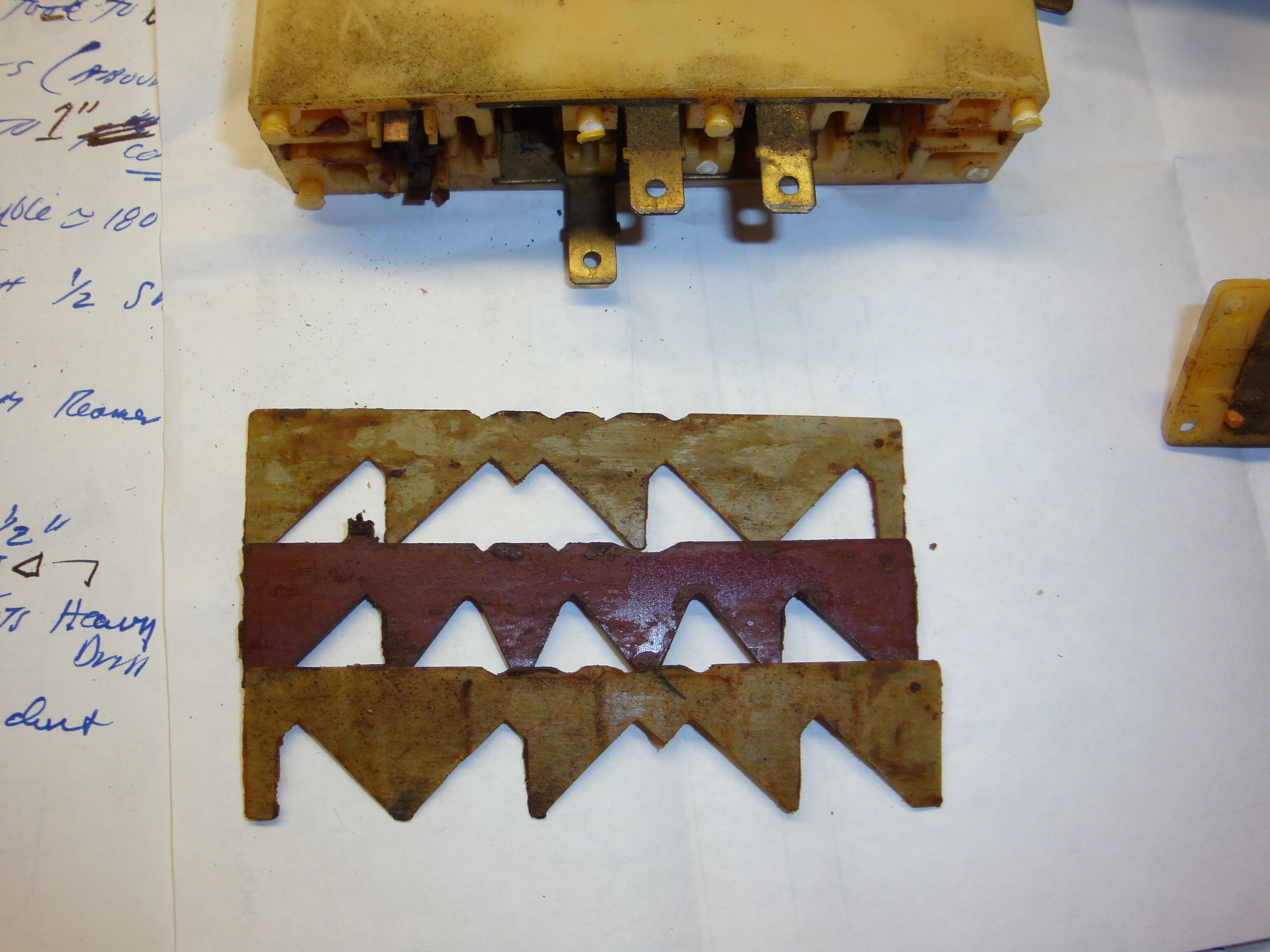

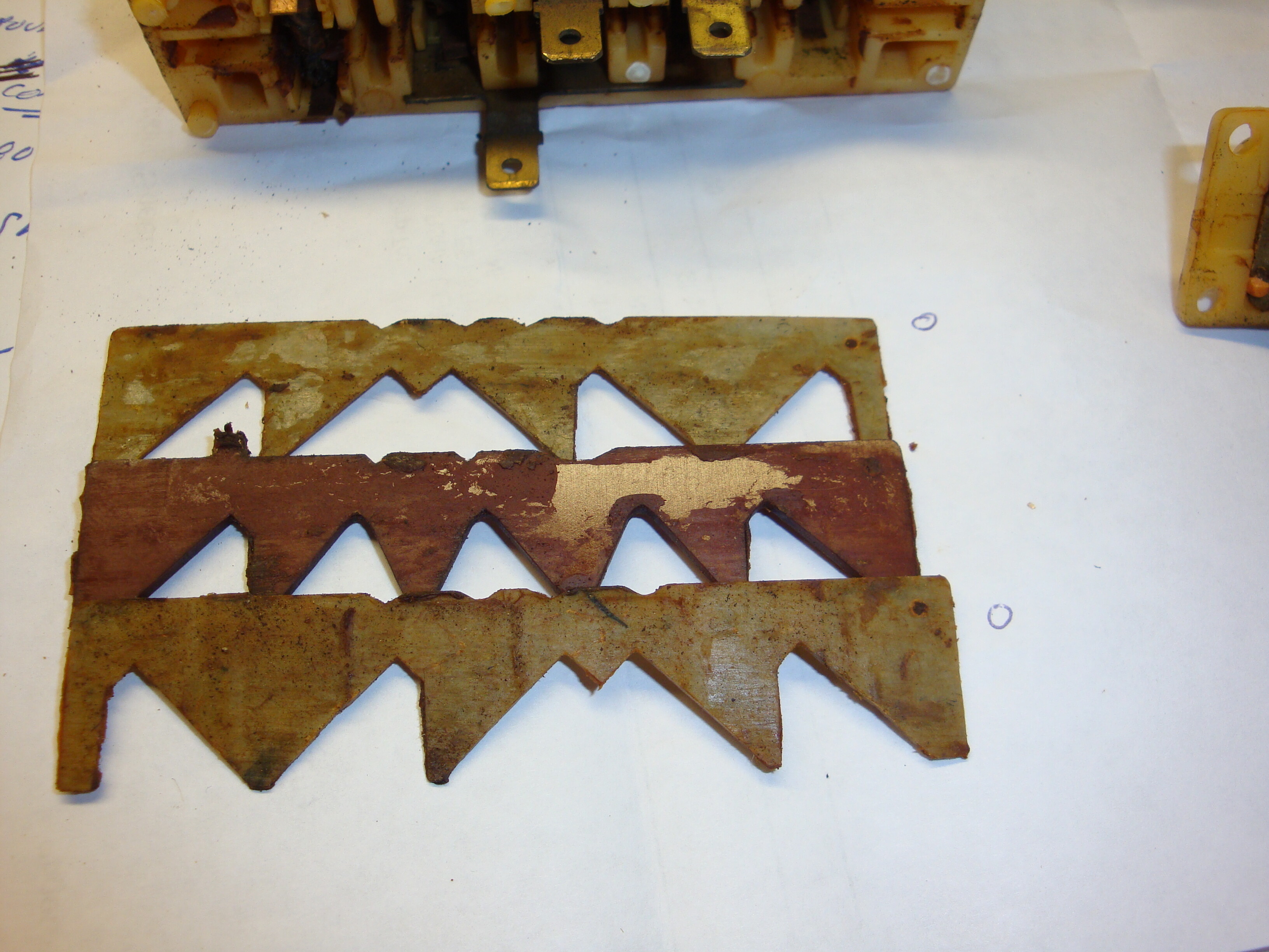

Hi Dan

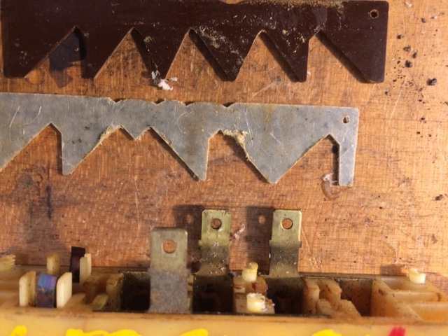

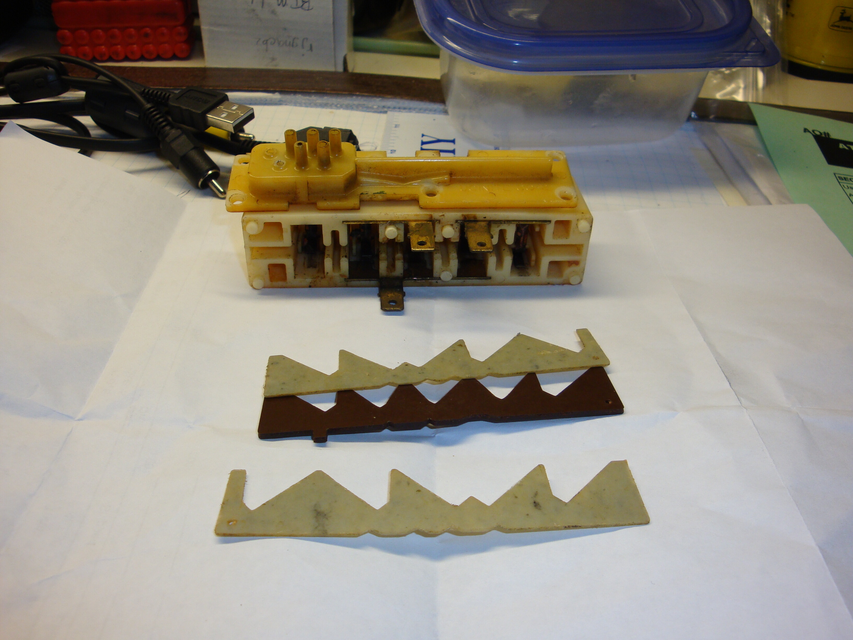

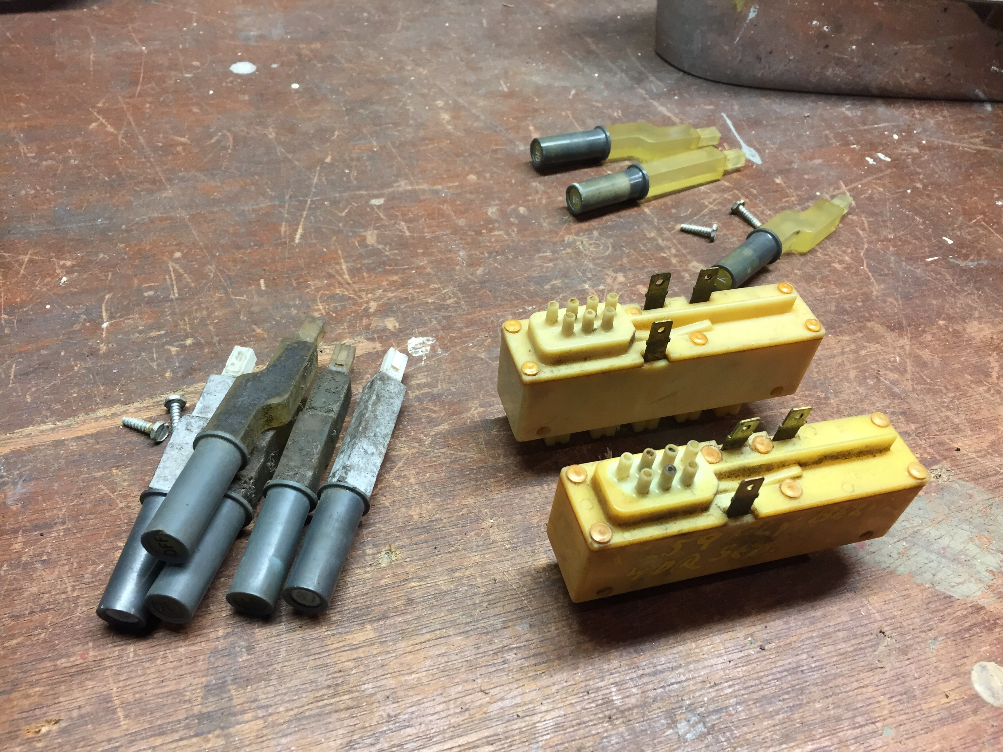

Perfect, what goes wrong with them is the fiber board cams they use break down over the years due to the grease inside getting hard. Then the cams will not slide and they get destroyed. We CNC > [computer numerically controlled] > machine new cams out of delrin and clean out the vacuum ports and electrical contacts. See attached for an idea of what’s inside. The button extensions you should be able to pull off with a slight side to side motion. If you want to send them along I will open them up to confirm but normal rebuild without vacuum nipple replacement is $85 plus shipping.
Keith

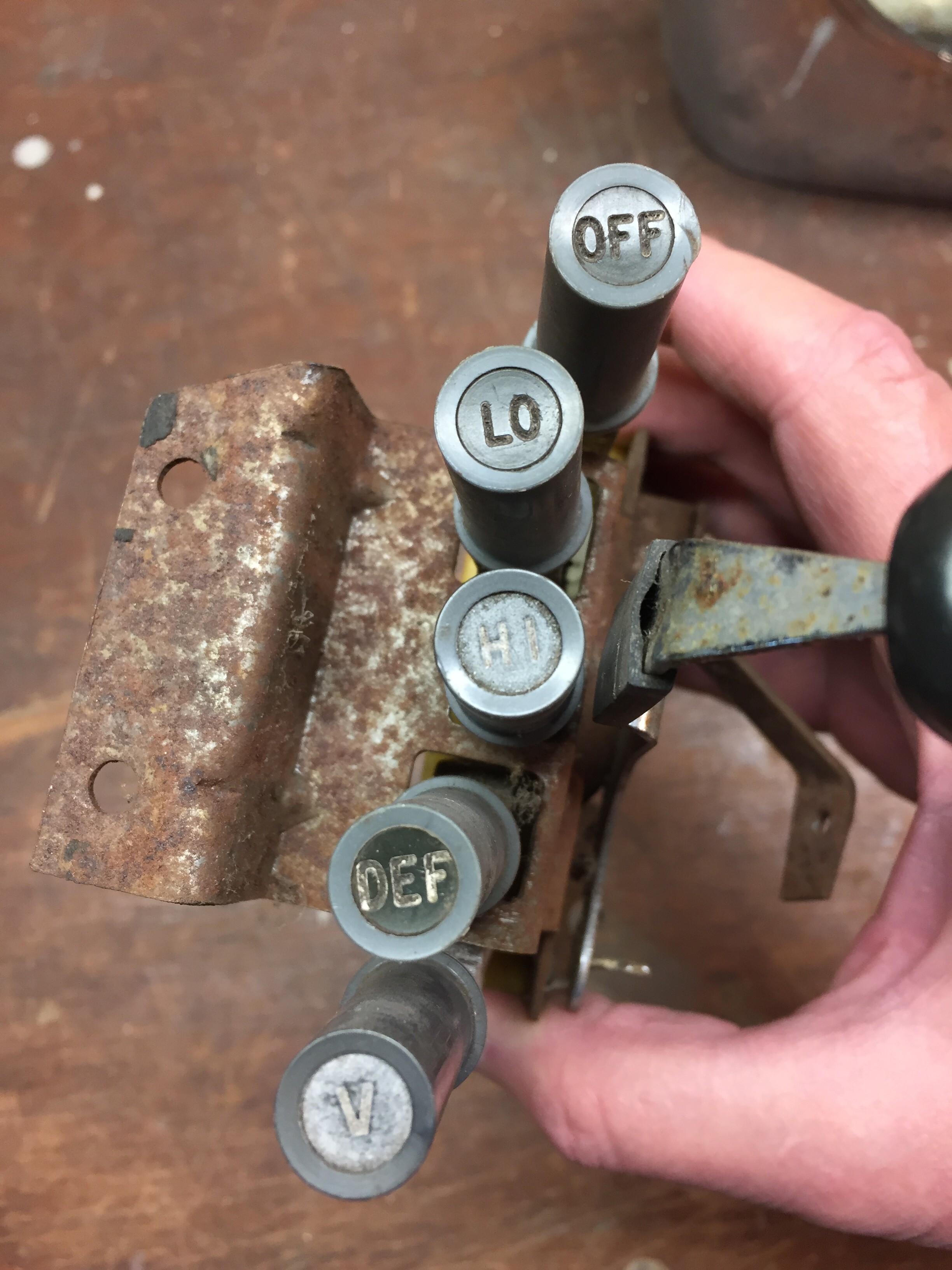

Off they both go in tomorrow’s mail! I’m pretty sure the one still in Faulkner’s dash has the pins snapped off, but I may recycle the buttons - I will see.

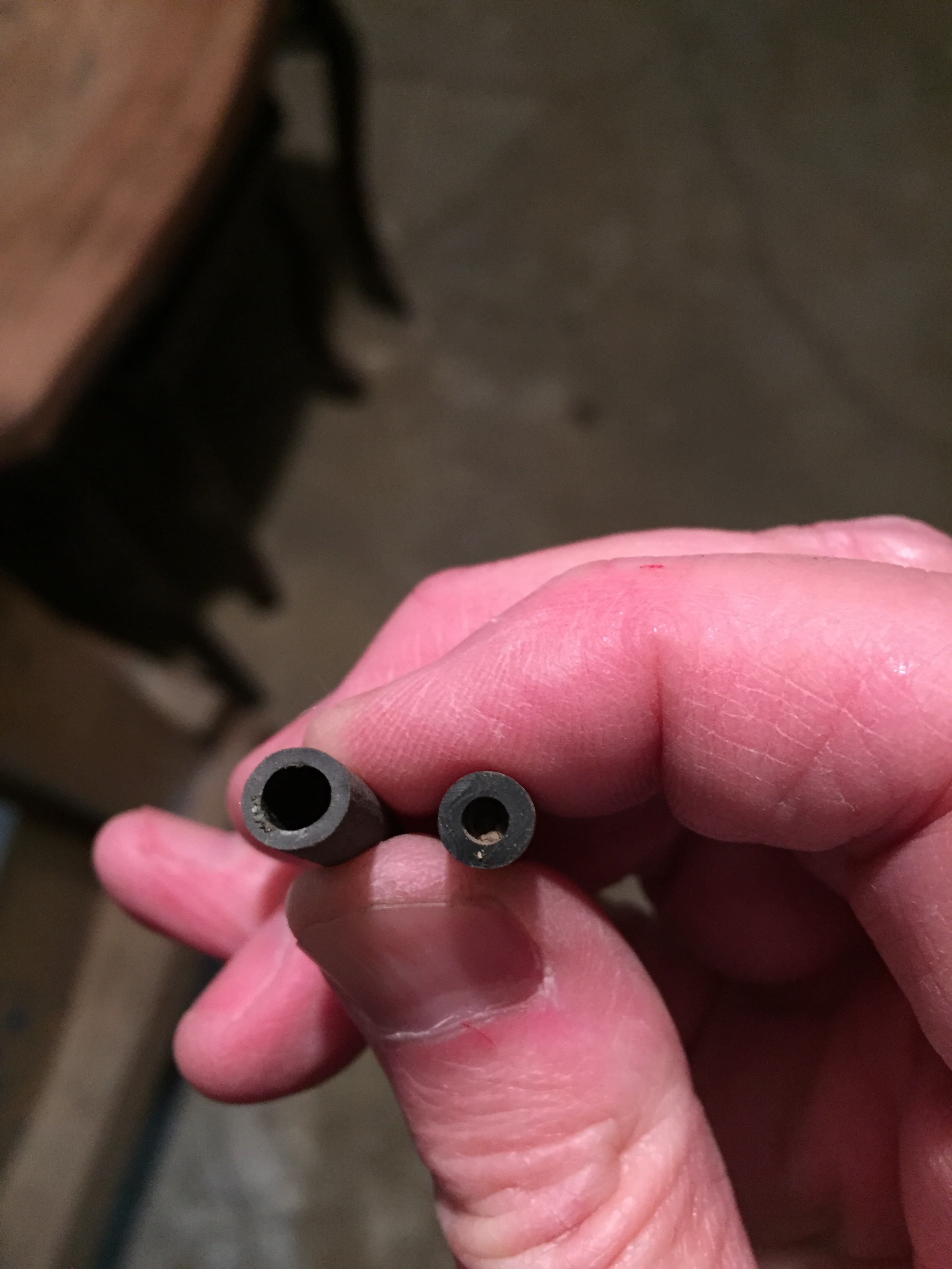

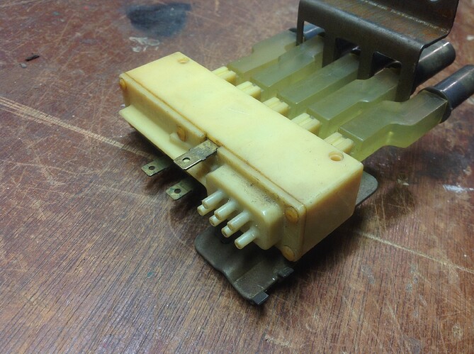

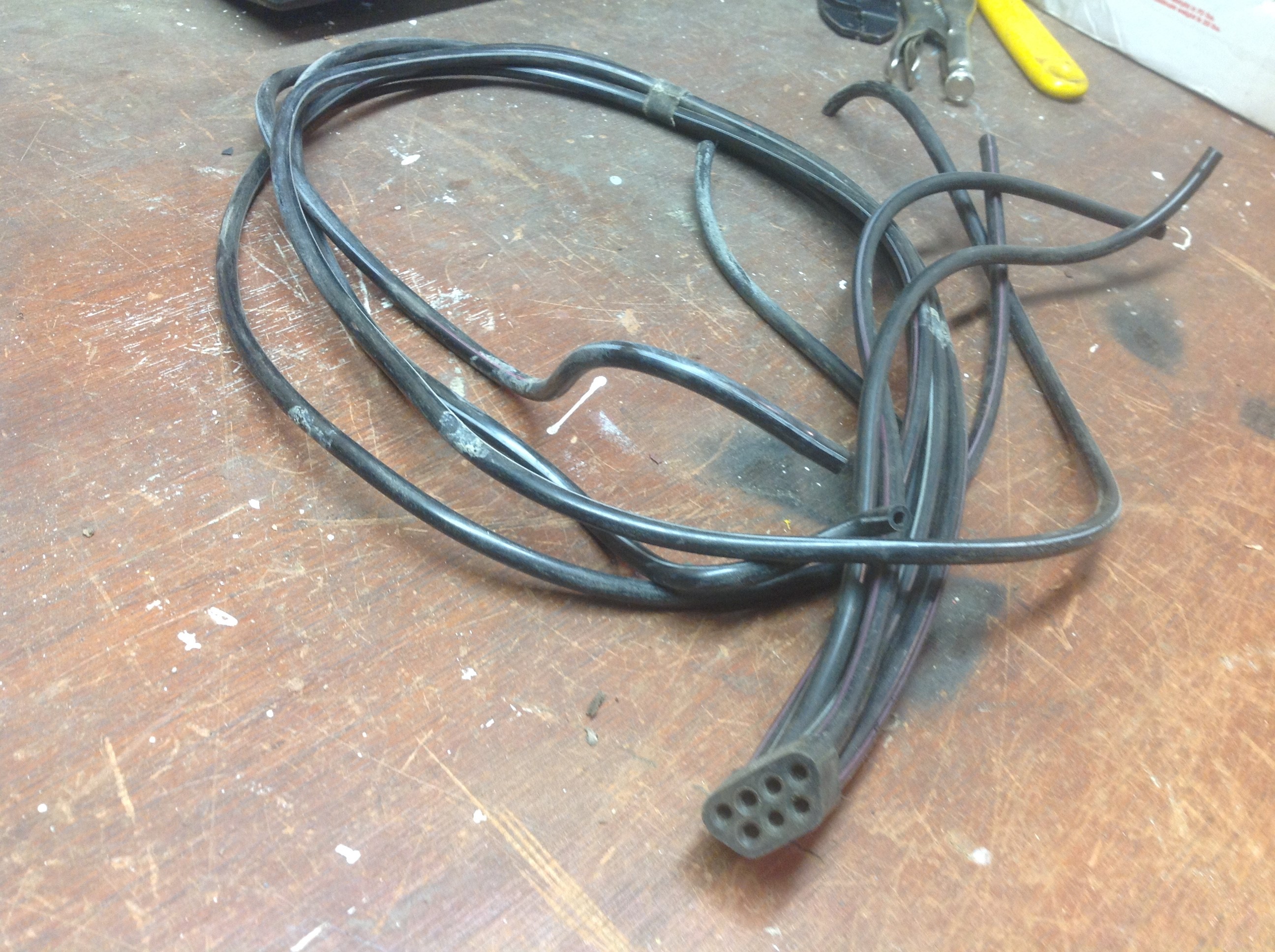

Will do! I’ll be testing the switch like in the video, with all the vacuum motors, and using the transfer pump that came yesterday. The black tubing on the left is what came with the pump, the one on the right I snipped off of a spare connector - I’ll need to get a coupler at Ace or AutoZone to test the motors.
(Note to self: This is how the buttons go back!)

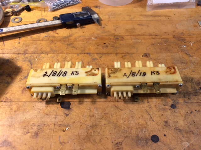

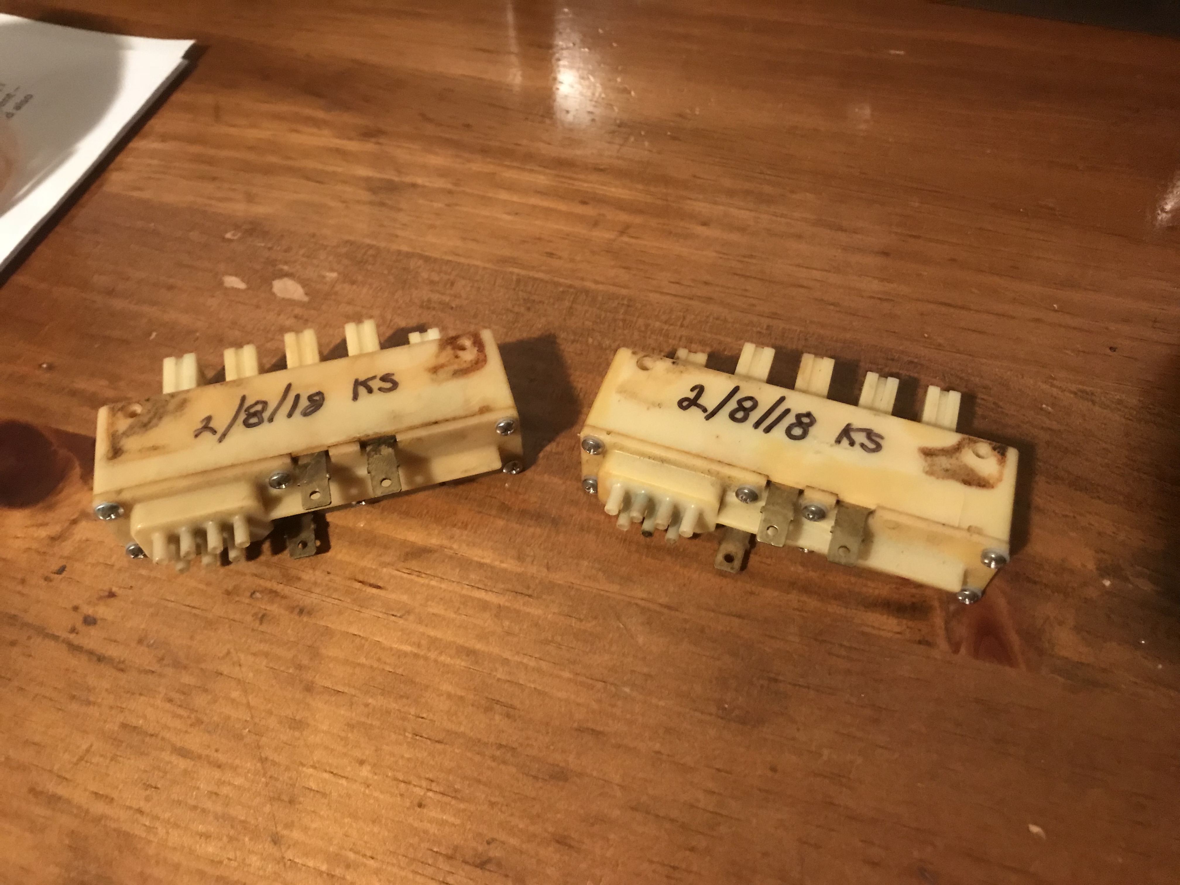

The heater vacuum control switches arrived today, and they operate beautifully! So smooth… I’ll install one, and put the other in inventory - but if there’s another owner out there who desperately needs one, let me know. I know Dick doesn’t need one - what’s the temp on the back porch, Dick? :unamused:
