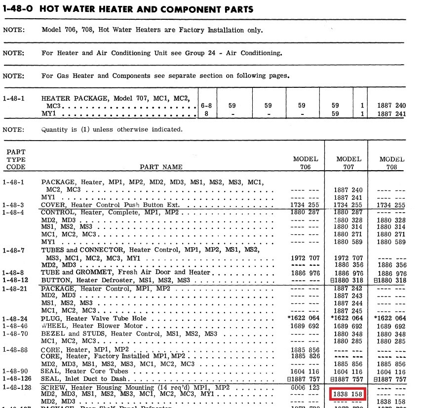

There are no ridiculous questions, just ridiculous people! :smiley: But, here’s a ridiculous answer, from the Parts Manual:
So, we have a MoPar P/N - 1838 158. What does that tell us? Nuthin’! I’m Googling and checking some NOS sites, will let you know if I turn up anything…
Hi Dan,
Thanks for the reply! I have that manual too, and you’re right - that number is basically meaningless! Let me know if you find anything - I couldn’t!

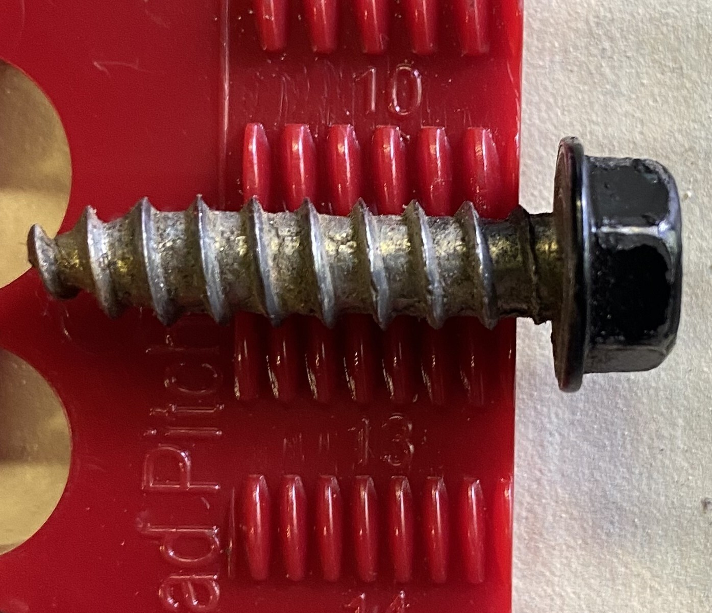

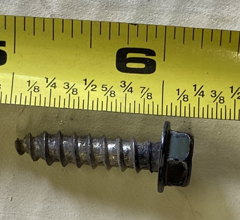

Because I’m such a mensch, I took one of the screws (not bolts) out of my housing for measurement:
The screw is 1" long, the shank is 3/16", overall width is 1/4", the TPI is 10. The head takes a 3/8" socket. Howzat?!
Fantastic! I do thank you for your time and effort! Definitely a big help!
Dan - You the man.
That would be you, Dick! As Ace’s Ace Hardware Guy, would that be a #10 screw?
