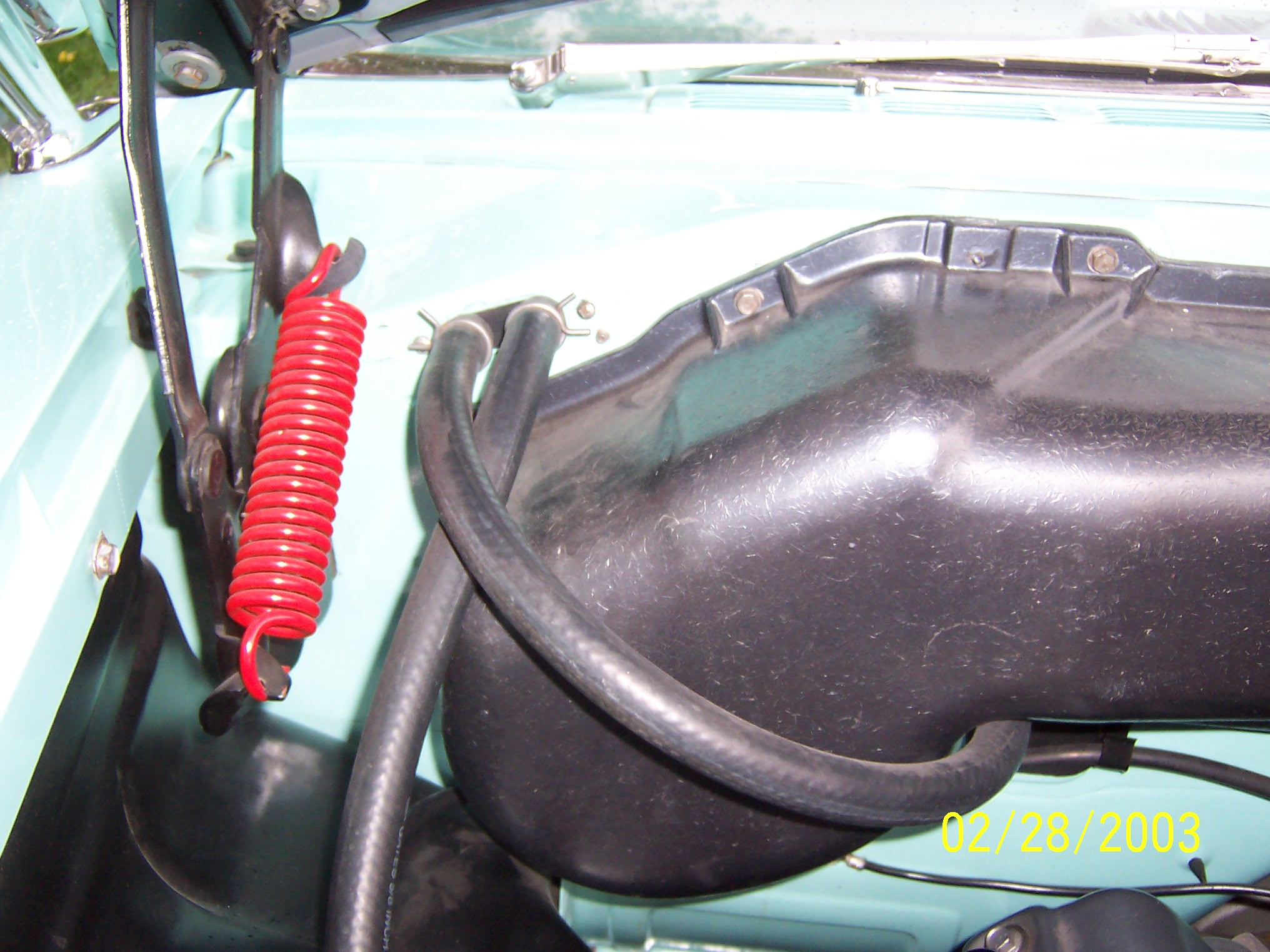

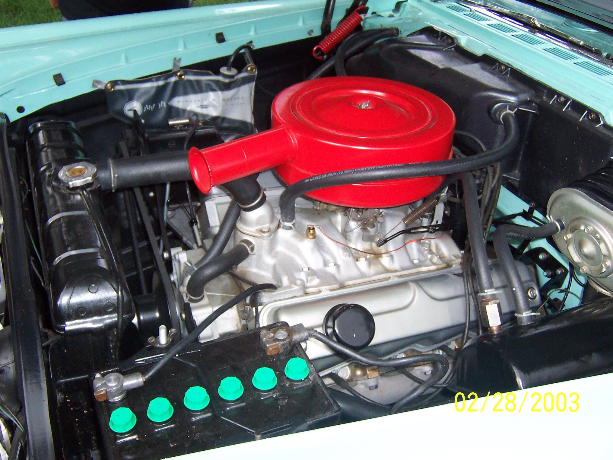

After doing this from my tired head I checked some pics.
I have to correct t myself.
The outer connection goes to the lower connection.
The inner connection goes on a connection between the carb and thermostat housing.
The connection on the water pump goes to the connection on the heater box just behind the air cleaner
The far-left pair of nipples lead to the heater control valve.
it would appear your car’s previous owner bypassed the original heater control valve entirely. That valve is operated by the dash-mounted slide arm. Those valve seals get old in time and fail. But they can be re-built.
It sounds like the hot-water circulation has been directed straight to the heater core, bypassing the control valve, thus you will be getting hot air whether you want it or not!

Picture is worth a thousand words…
Pictures are from Tom Fox’s wonderful Belvedere Convertible, 318 Powered Gem.
