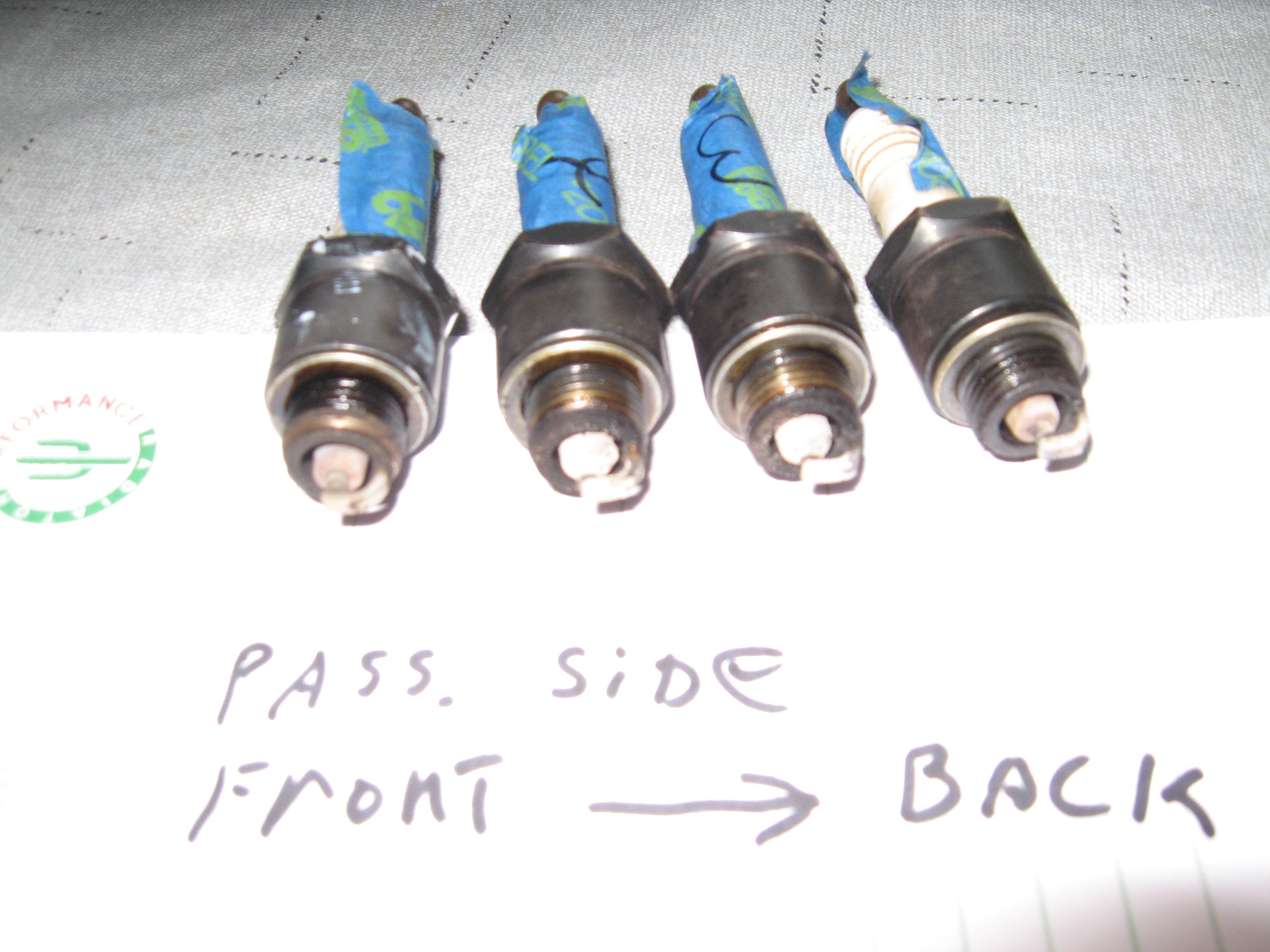

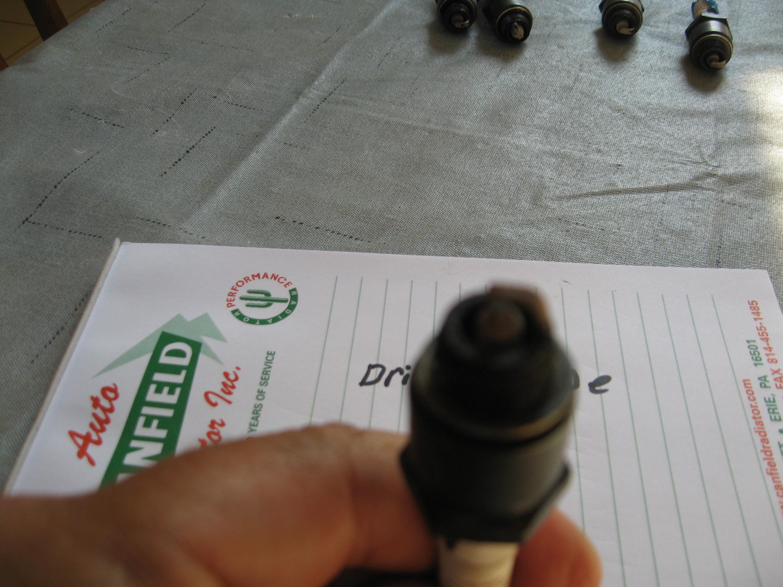

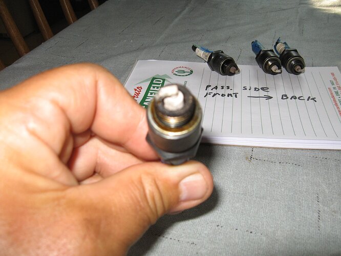

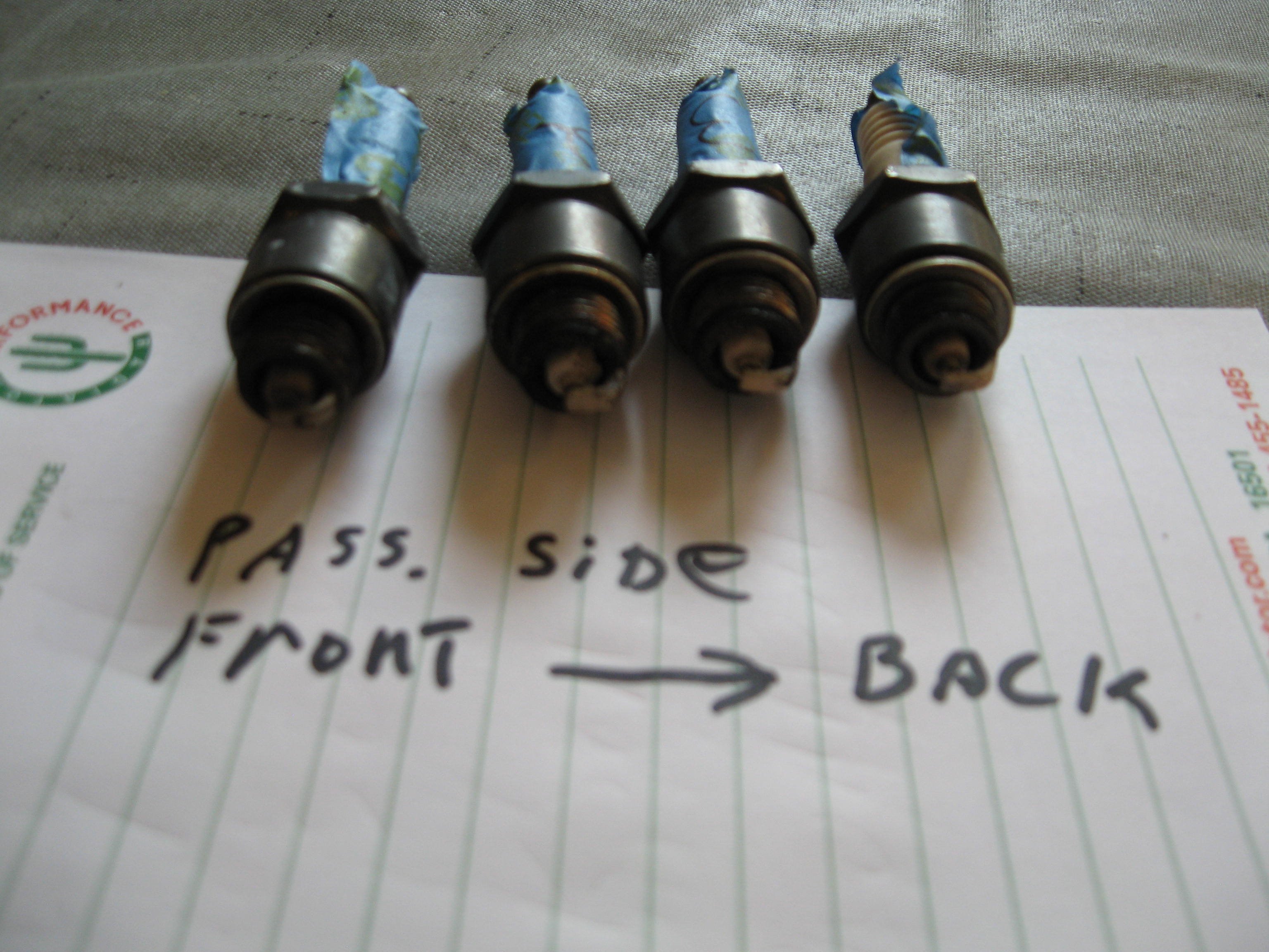

I was in A parade for the 4th yesterday, A very, very, hot day, excessive idling, no air flow, etc. and the right side exhaust was producing wisps of light grey smoke, It smelled like burned rubber. I pulled out of line and headed home. It did none of that all the way home, in the garage I raced and revved and nothing. I then pulled the plugs from the passenger side and they are burning white, I then pulled A plug from the left side and is light tan and normal. The engine has 8,000 miles since the rebuild and should I have re torqued after the break in? I am thinking it may be A head or intake leak that developed when it got on the hot side (it was still in the “normal” zone but I have never ran it that hot before). Carlisle coming up I am going to do A compression test and retorque the head and intake bolts. Kind of stuck on this one drive it anyway? I think it was burning coolant to make the plugs turn white. Any thoughts. Mark

It’s unlikely to be a head gasket, as the 125 PSI compression would force the radiator cap to spew coolant.
Most likely it’s the additional heat has cooked some old residue in the exhaust system, or undercoating on the muffler.
John, how do you explain the white residue in the spark plugs?
If a cylinder is burning hotter than another, by being leaner or such, it will appear whiter on the plug porcelain. There are also additives in the fuel that can leave residue.
Coolant entering a cylinder, will cause steam, which shorts the plug out, causing a misfire.
It didn’t sound like the car was actually overheating, or coolant would have boiled out of the radiator cap noticeably. Modern head gaskets do not need to be re-torqued in most cases, that was more so back when steel or copper head gaskets were used.
Main thing I’m saying, nothing points to a head gasket issue, so I’m doubtful.
All is well !!! I did A vacuum test cranked the engine and got 10 lbs. did A start and run the engine and it was A steady dead nuts 21 lbs . I took the vacuum source at the power brake manifold nipple. My engine is healthy !!! So what have I learned ??? My cat fixed it last night while I slept, Matts prayer to A Nordic god worked, Some kids in the side lines of the parade tossed A smoke bomb under A 60 year old car to watch A 61 year old driver get out and shit his pants, or as I am aging I am going knuckin phuts !!! John thanks for the reply. I crawled under the car and it is possible some under coat may have flaked and burned. All other possibilities you suggest are also possible. What time is breakfast Saturday ? Thanks Mark

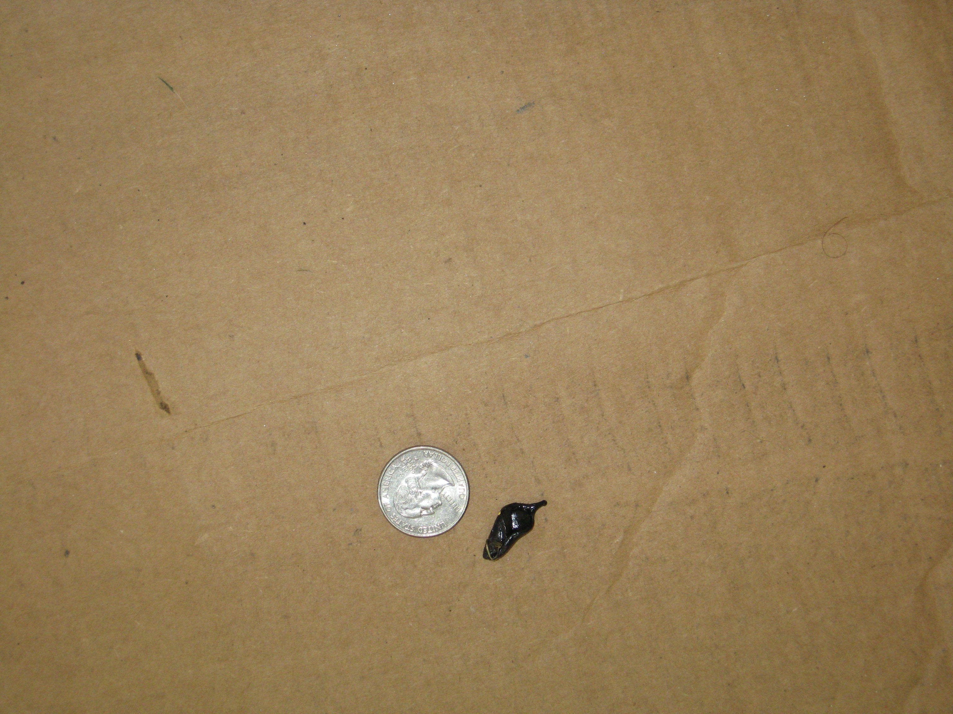

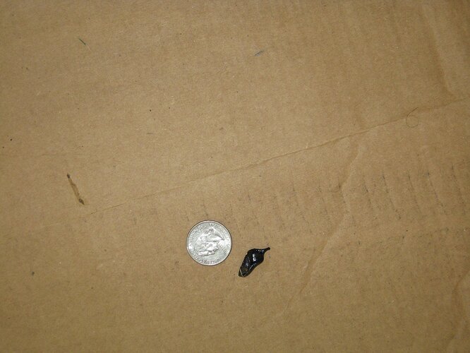

I think I found the culprit, John hit the nail on the head. I found this on the garage floor after I came back from Carlisle. It is A small piece of x mat in the shape of A drop, the size of A quarter. Must get hot and melt from some exposed area near the exhaust and drip out. I put it in under the carpet when I did the car. The car got hot from idling too long and A small amount dripped on the hot pipe and smoked, I thought it smelled like burned rubber !!! Mark
