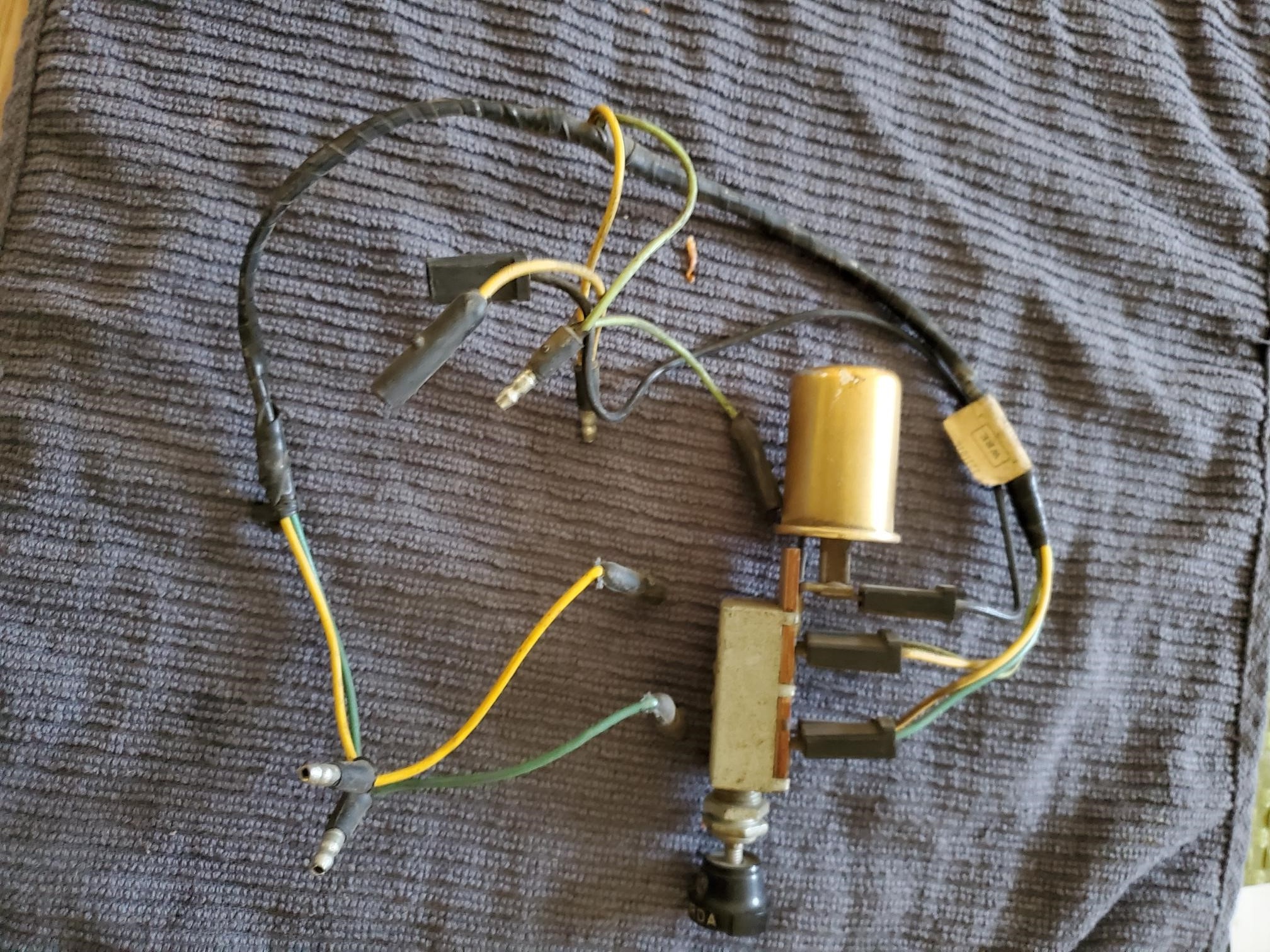

Went out to an old cars parts and storage, found this gem; a four way flasher system complete, from a 1966 D200. These used to take me about 20 minutes to recover and re-attach the wiring, embarrassed to let you know what it actually took me today. We mentioned these earlier in this thread.
Post Script; She has a 1962 part number?
