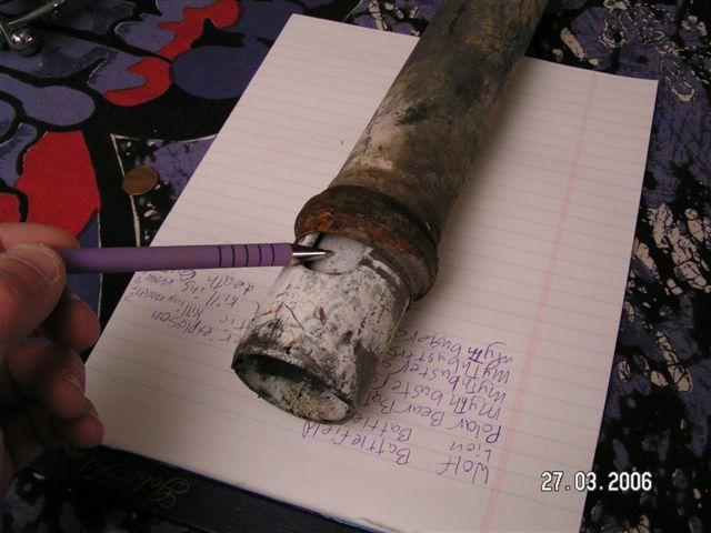

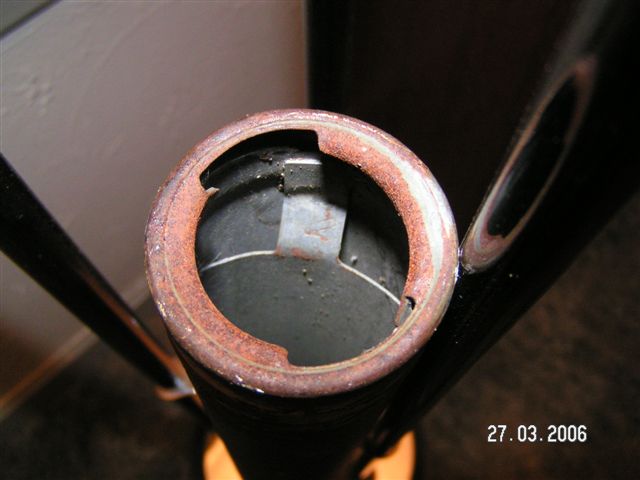

Stefan and Dick,
Here are some filler tube photos. There IS an internal “burp” line..the main tube has a portion divided off. Dick, look at your filler pipe..the “baffle” should be “up”..at the 12 o:clock position, so that when fuel goes in the tank, the air comes out above the fuel. Perhaps your filler pipe was removed, then re-installed incorrectly (rotated).

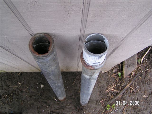

Hi Stefan - Old age is a bitch, I just remembered I have a tube I took out of a 4 dr. parts car I have. Its the same as I described previousely, the exterior of the tube is plain, no air vent tubes on the outside or the inside, again nothing like the tube Roger sent pictures of. I was lucky to save the tube because the tank only had sides, no top or bottom.

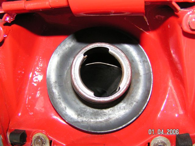

I am sending you a picture of my car’s filler pipe, and a pic of the two parts pipes. Sorry, I keep forgetting the address to post pics to the Forum, and my daughter and dog are both nagging me to go outdoors
Dick,
I took a closer look to my filler pipe this afternoon. It’s the same like on Roger’s picture/car. Yet we have the problem and Roger not. Well, it’s got to do with the air bubble in the top of the fuel tank.
