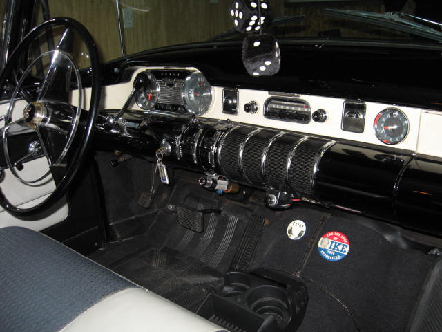

John Q; thanks for the info,it helps alot!!! Iwill try to get some pics up,I am the one that bought the plymouth from the “detroit” area red 4dr sdn.I am"55 survivor" because I also own an unrestored 55 Buick.My wife purchased the plymouth,we both love the look,it is a very beautiful car!! Erie has N O N E !!! Lots tri 5 chevys chevelles,camaros,corvettes etc.etc.etc.etc.etc.We have been to many many shows and never see any late 50’s mopar!!! I have a photo of my wife standing in front of her fathers 58 plymouth when it was new,she was 2 yrs old [awesome].Thanks very much for your help,you will be hearing from me again thanks Mark

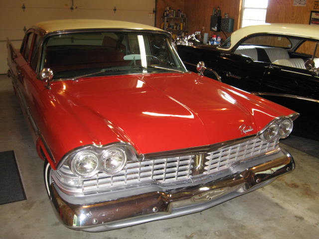

Hello; Matt,Igot a few pics,the numbers are as such SCHED0602,NO3056,MODELMP2H,BT263,PTXX,TR324,SP–, VIN# M264105576 Thanks Mark P.S. What is the correct tire size[bias]and correct white wall width,rim colors,possibly paint code # ? Thanks agian!!!
PIC
Handsome car! You should be able to get answers to all your restoration questions here. :smiley:
Mark, Looks like you (your wife) scored on the 59 and it is from the Detroit area is even more of a miracle due to the use of salt during the winter months. Your 55 looks good too! But a red 59 can’t get much better then that!
Keep asking questions and you will get almost everyone answered! People love sharing their collective knowledge to help a fellow Forum member.
PS I see the factory/Dealer back up light kits for sale all the time on Ebay. I will keep an eye out for the next one that pops up. It is an easy option to update. It will take a little acrobatics to get the reverse back up light switch installed on your Automatic Push button assembly, but after that it is a breeze!
Nice!!
Looks like a perfect cat with the hard to find front valance.
Do you have some interior shots? Think I see a deluxe steering wheel in there. Post some engine shots too and I’ll send you a nice list.

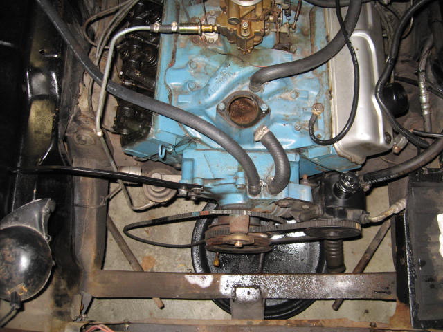

Hello;I started to pull the motor and tranny,it runs,don;t knock or smoke,has a rear main leak,but 113,000mi. she is a little tired.Grabbing the tranny also and have it done.I’am looking for a motor builder and want the same components to go back to the car.It is a little more than I bargained for but when done it will be a driver.While it is out I’am going over the front steering[motor gone Ican 'camp out ’ in there].Alot of the rubber is toast,probably replace the control arm bushings,ball joints etc.Iam sure I will be doing the car justice,the interior will have to wait,plus it will give me something to do this winter!! I sent some pics of what I have going on,including a bonus,my Buick. QUESTION Were the all dashes padded? Mine is not.Thanks for your input,i give them alot of wieght,I don’t know as much about 59 plymouths as i do about 55 buicks but I do know the plymouth is easier to work on!! Thanks Mark

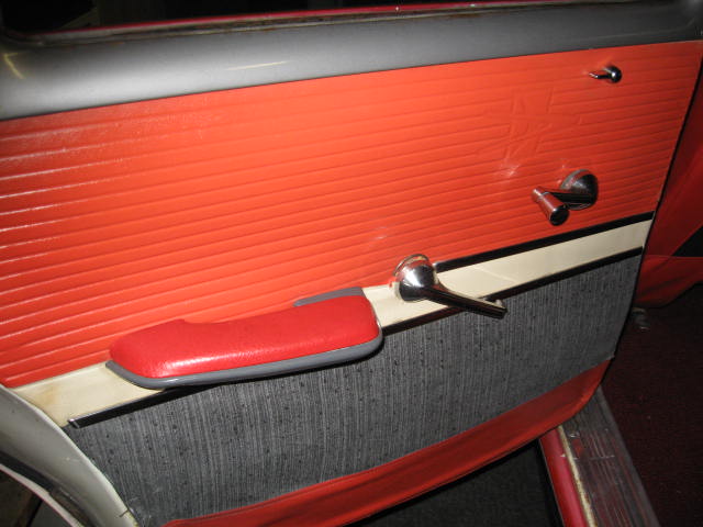

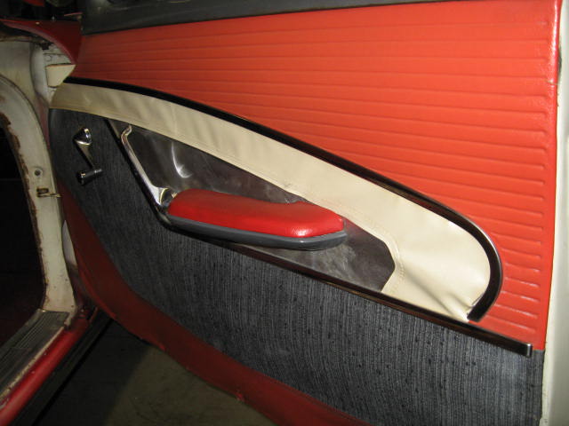

The interior looks pretty nice for un-restored!
