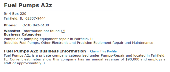

I bought a fuel pump from these guys, years ago… Seems to me they sell glass fuel filters and accessories too – they used to have a website, but not that I can find now. Still in business?
